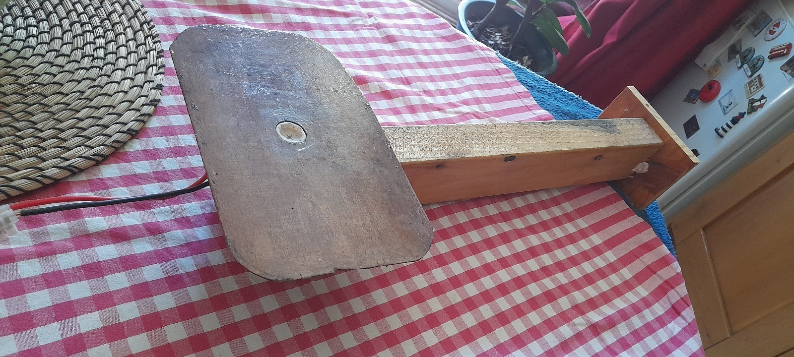

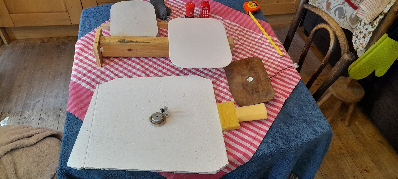

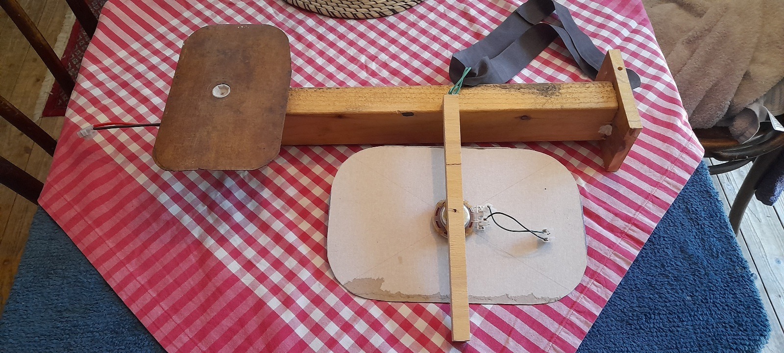

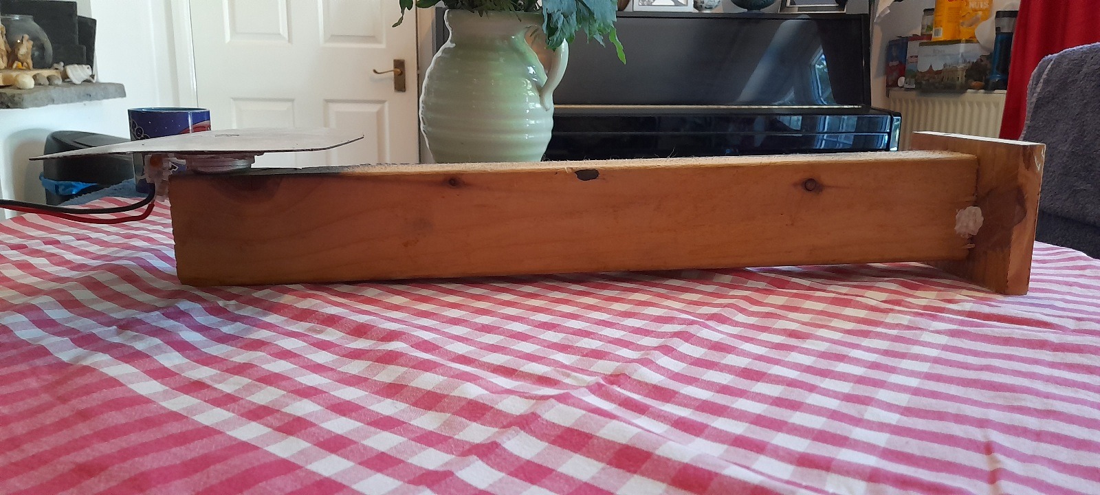

A few pictures of the sort of mountings I have used for my various small panels.
In the last picture I include the original 3mm xps pizza base panels (no longer made in this country)I used to use many years ago over on NXT RUBBISH.
Plus the larger HD grade eps panel, which was square, but I cut one side at an angle, and glued it back on to the side shown so that now it does not have parallel sides🤗 and no waste (this panel cost money).
I will eventually do this to my square graphite panel for comparison.
Steve.

I wonder your panels with peel edges don't they cause flapping noise?
And did you measure and weight your HD grade EPS their actual kg/m3? I have no idea HD grade actual density. Thanks!
Hkguy6.
I purchased the high density eps about ten years ago, they are now coated in vinyl silk paint.
with a hole in the centre of the coil area.
I can't even remember where I got them from.
I might still have a 5mm HD that I did not use somewhere ?
the edges of the card does not peel or buzz ?
If that is what you mean ?
Steve.

I just curious the western standard Low Grade, HD, UHD their exactly weight. I got my EPS weight by measure their actual volume and weight to get the kg/m3. Even the shop(China) labeled as 25k but actual just around 18-20.
The peel I mean is your first pic the ply panel, especially the top left corner. Or you applied coating to fill the cracks and peels?
Thanks.
OK I understand now.
Well spotted.
That panel is a 1mm veneer which was from a very old draw in my shed, which peeled off .
It started to split when I rounded the corners .
I mentioned all this some way back on this forum when I built the panel.
I had to apply several layers of pva to fill the splits.
