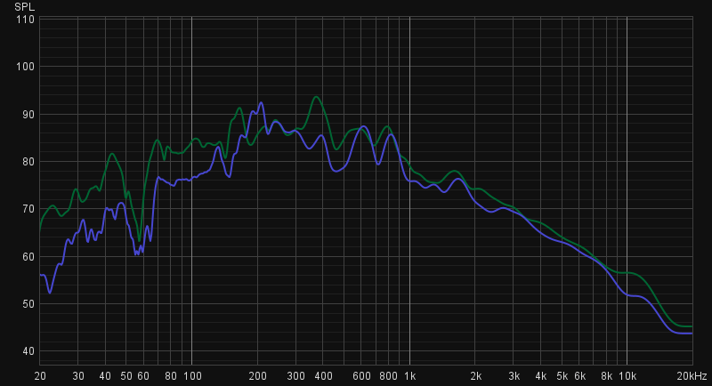

Here are graphs for the 500x330x25mm Neopor (green) and Styropor (blue) plates:
I tried running the tests from my laptop, but got the same bass dropoff I saw with the printed plates. Both the EPS and printed plates does reproduce the bass, but for some reason when measuring on my laptop everything is highpassed even if I hear the low end in the sweep. So instead I ran it from my desktop, and now see the sub bass as well.
They are measured at different positions in the room, so that might account for some differences between the individual plates, especially the different peaks and valleys in the bass to low mid. I can't say I notice the louder bass on the Neopor when listening, and that doesn't seem like a room mode since it is consistent over a large range, so a bit confusing to me.
Otherwise the response is similar to what I get with the printed plates. The same HF slope, but a bit smoother curve overall, which I'm guessing is mostly down to the larger dimensions.
But efficiency is really much better.
I will print another plate with the carbon fibre filament and my updated settings, and record that from my desktop as well to have a comparison. While distortion looks good for the styrofoam plates, much lower than my Tannoys for example, the printed carbon plate had the lowest distortion I have measured so far, so might still be interesting.

Your measurements don't make much sense to me ?
Bog standard 25mm eps should be pretty flat to about 10k
So 10db down by 2k and 30db down by 10k ?
You can't be measuring correctly or there is something wrong with the exciter of mounting ?
your other measurements also have similar heavy roll off also ?
This cannot be a coincidence
they should not have similar measurements.

Hello LeobHere are graphs for the 500x330x25mm Neopor (green) and Styropor (blue) plates:
Strange... With EPS, strange that your 10k level is 30dB below the "main level". To have the 4k/5k 10dB below the 300/800Hz area seems common but not 20dB with a slope like if some high pass filter was acting.
Your 3D printing panels are completely new so it was difficult to say but here it is really
Come back to #4903 or #4651 (where I introduced the spectral contamination) There are more typical FR :
- a bass area which is a bit "insulated" from the rest of FR due to the 1st mode. Often lower than the 300/800Hz level
- a kind of hole in the 100/300Hz area
- a 300Hz to 2/3kHz "main area" possibly with some humps
- a drop off 4/5kHz
- a HF hump

The lack of treble is clearly audible during playback, and I think I can trust the measuring chain now. Measuring regular speakers I don't see the same slope.

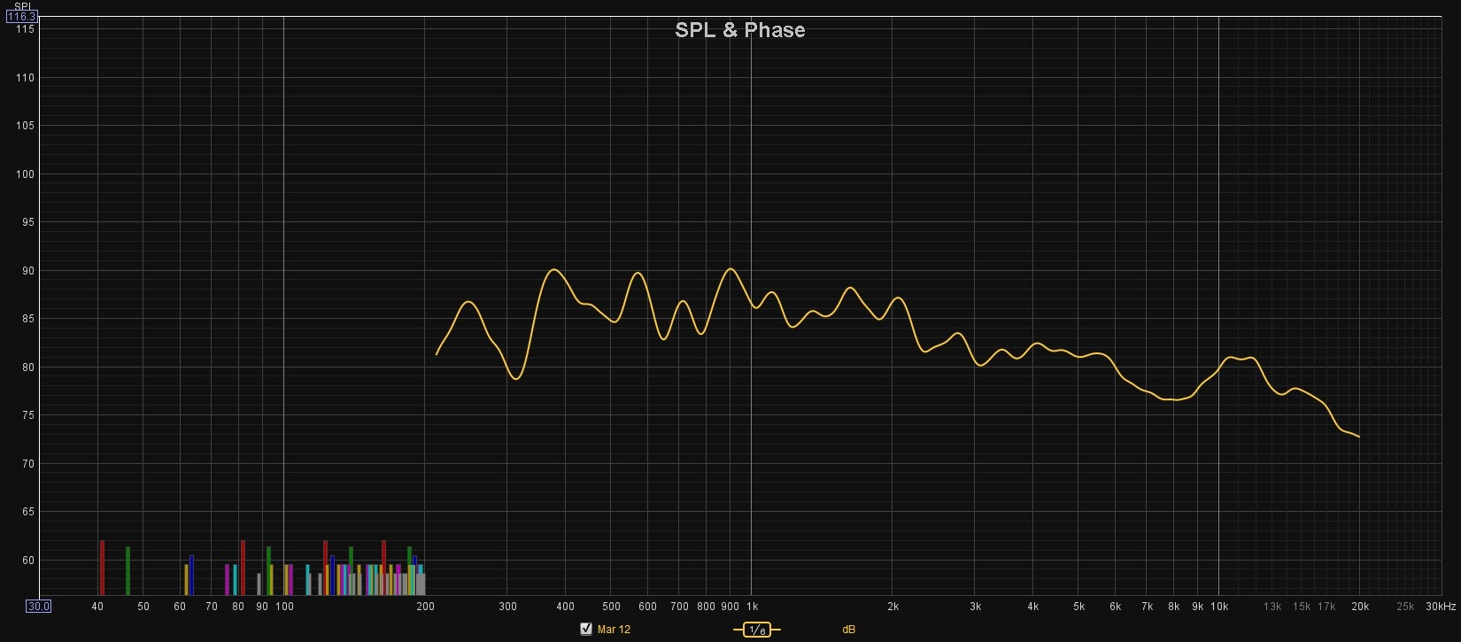

I would agree with Steve. This is a plot from my 30x40 2mm plywood panels using cheap Chinese exciters. They are not free floating, so when I return from holiday, I plan to make some more panels using the same exciters to see what happens.Both my laptop and desktop run windows.
