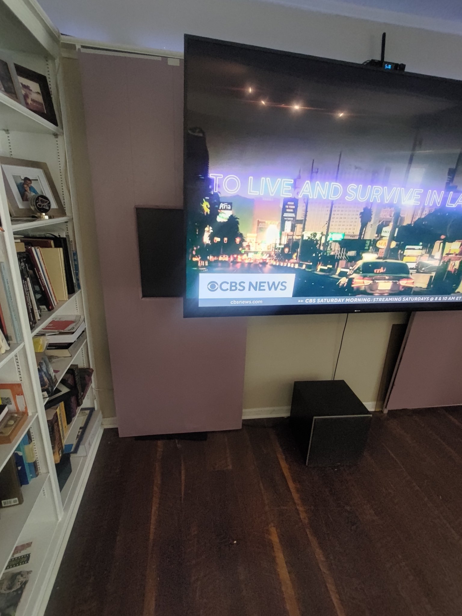

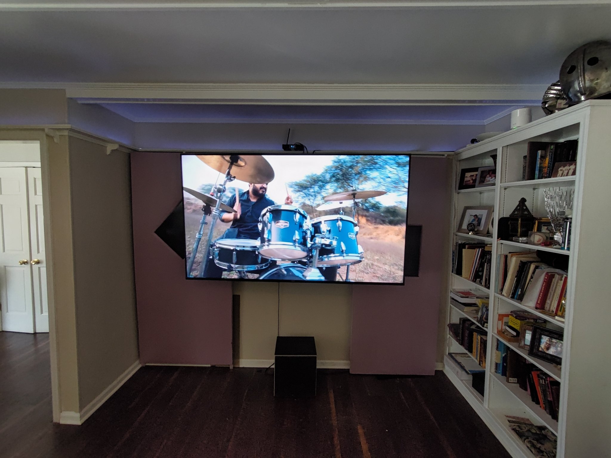

Here's the link again...0.5mm sikins on a 2mm foam core. They are light, but not as light as I expected, which I think is because there is a lot of resin in the foam, being spliced so thin.
It seems apples to apples the unsanded panel sounds slightly better. It's not a fair test though because the one I didn't sand has an area near the middle that was a slightly dry layup and I think that makes it better. I kinda want to make my own panel just to do a dry layup.
I'm sitting here now listening to....maybe version 6? I started with a full 4x8 foot panel and realized it's too big for the wall...my ceiling is apparently only 7'11” lol ...also the space next to the TV is a tad under 4 feet so as not to argue with the giant TV mount.

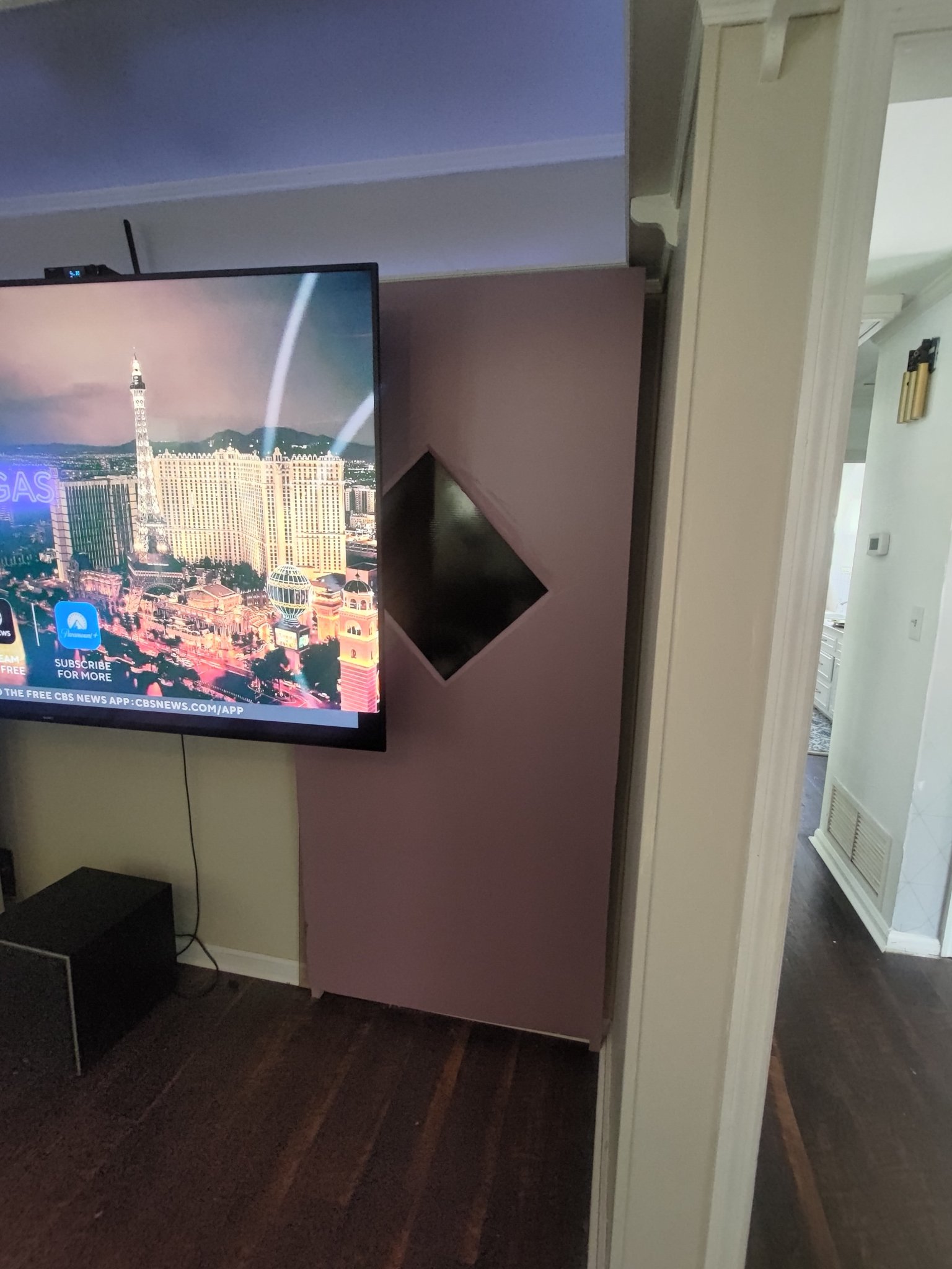

My left speaker at the moment is a roughly 2 meter by one meter 1 inch XPS panel with a window cut out and the CF sandwich mounted in the hole with carpet tape. It sounds decent but it lost a little tremble vs the free panel. It has 2 exciters, one Dayton "spider" (really 4 exciters on it's own) plus a "steel balanced" also Dayton, both 8 ohm wired parallel to give 4 ohms to the amp. I put a 150htz high pass filter on ONE of the exciters thinking it would take the bass but not eliminate it and maybe blend a bit with my sub...the bass is still super strong. In certain songs it scares the hounds and rattles some decorations.
The right speaker is basically just the CF sandwich with one exciter. Most of my treble is coming from that speaker. I've mounted it several different ways, including frimly to a small built in shelf which seems to give the best overall response and really nice low midrange but the wall causes some noticable suckouts so I tilted it to try and break up the interference. I carpet taped an XPS piece similar to the size of the panel to it as extra surface and it's an improvement for sure. I think the combo cancels some modes. It also improves the bass on that panel (which still lags way behind the left panel even though the right panel has no high pass filter.
Depending on what happens to my life in the next few months I may try making my own sandwich. Just a hand layup either fiberglass I have already over XPS or maybe I'll get ambitious and do single layer spread tow CF over nomex honeycomb. I bought a roll of thin woven fiberglass with the XPS specifically in mind.
Eric.

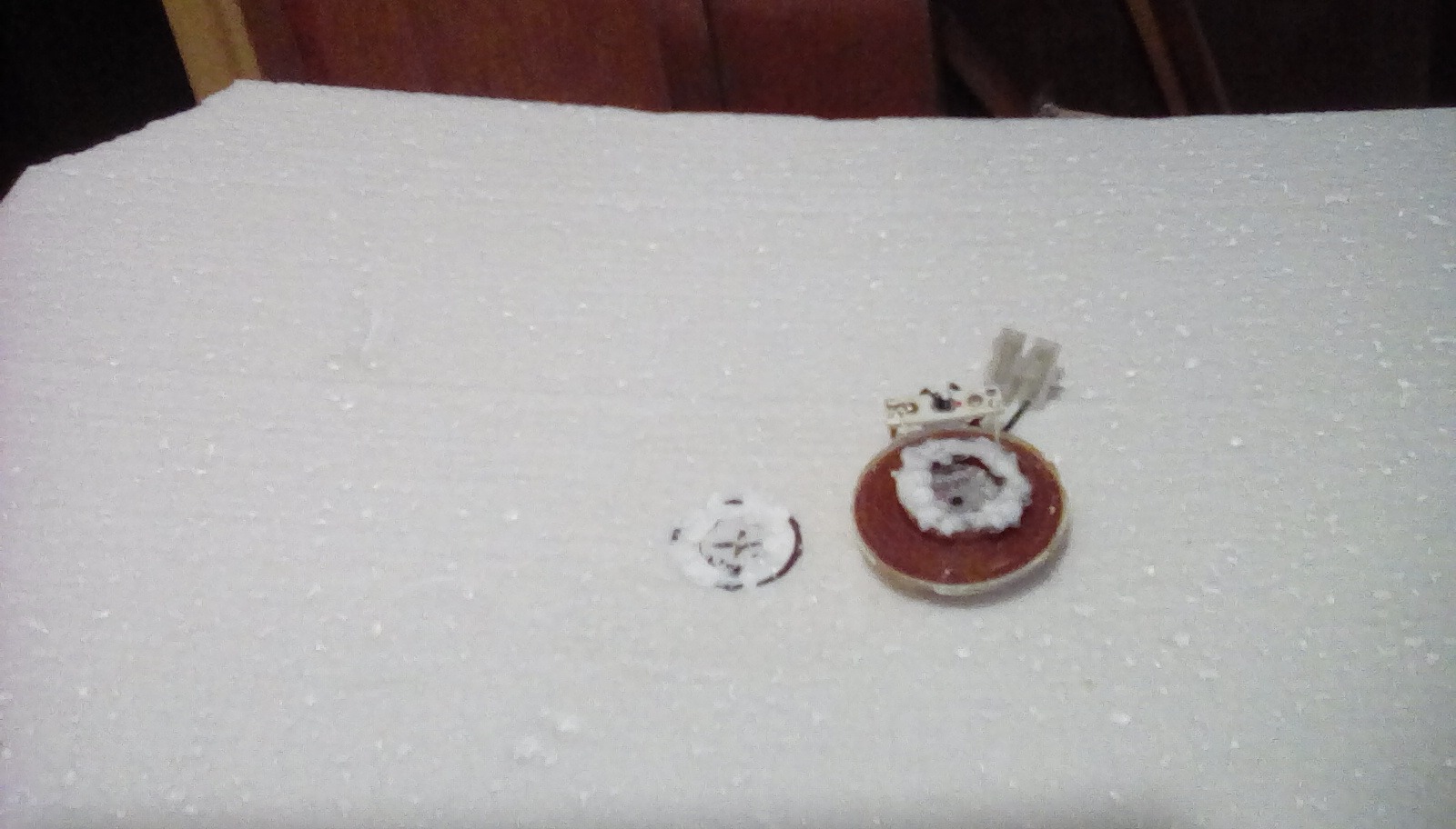

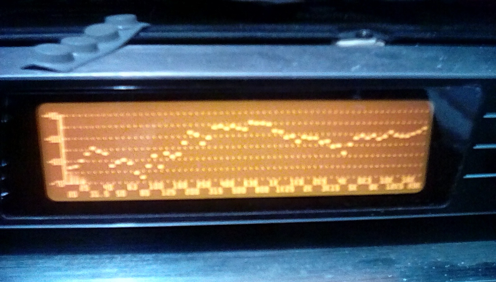

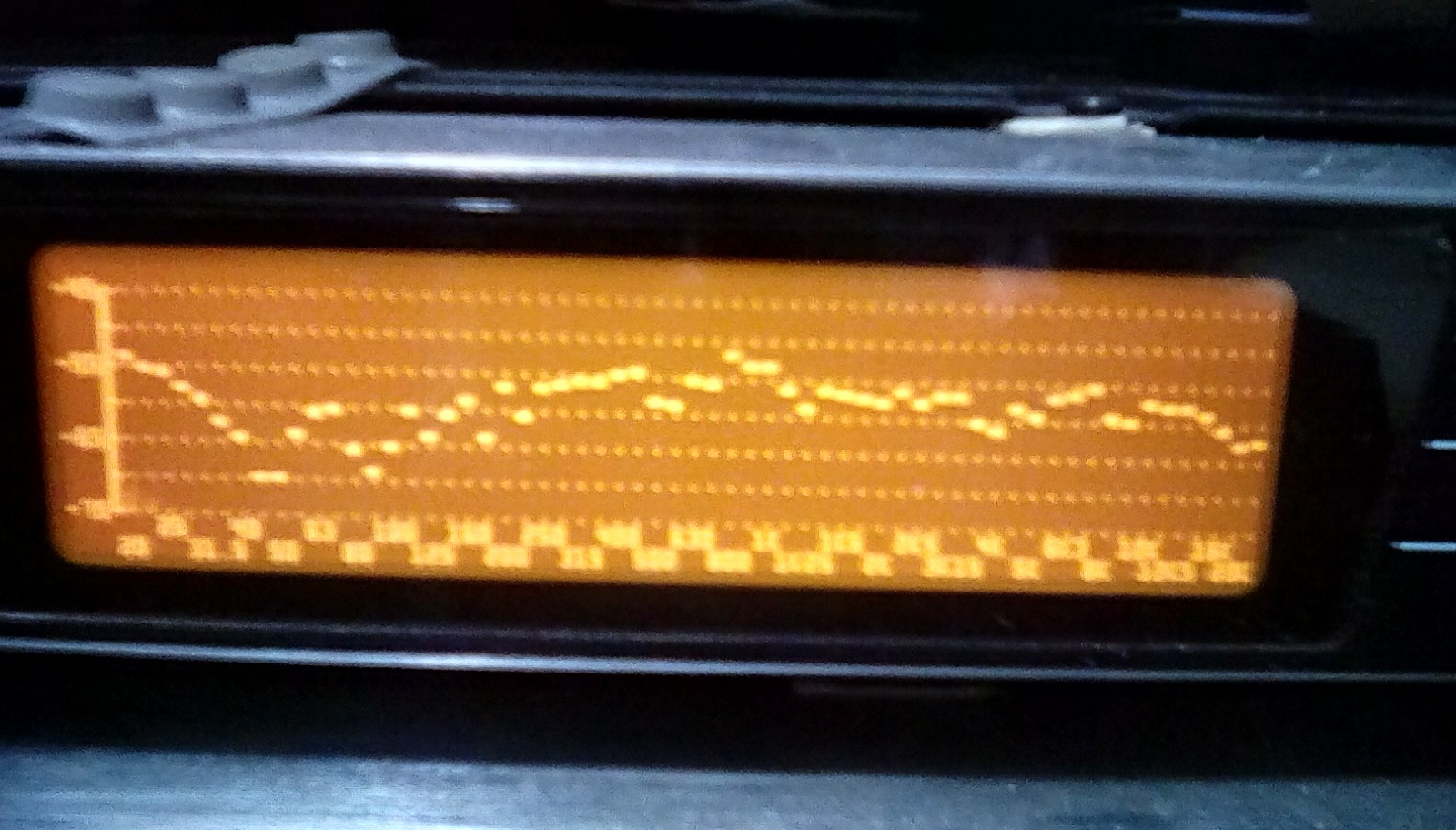

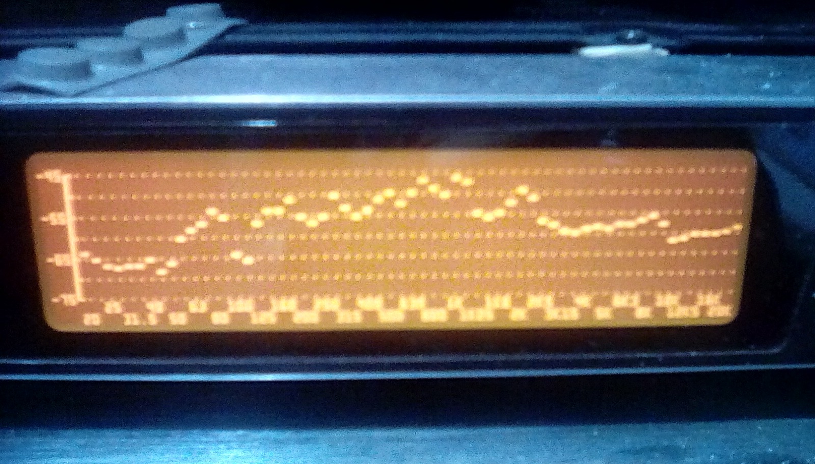

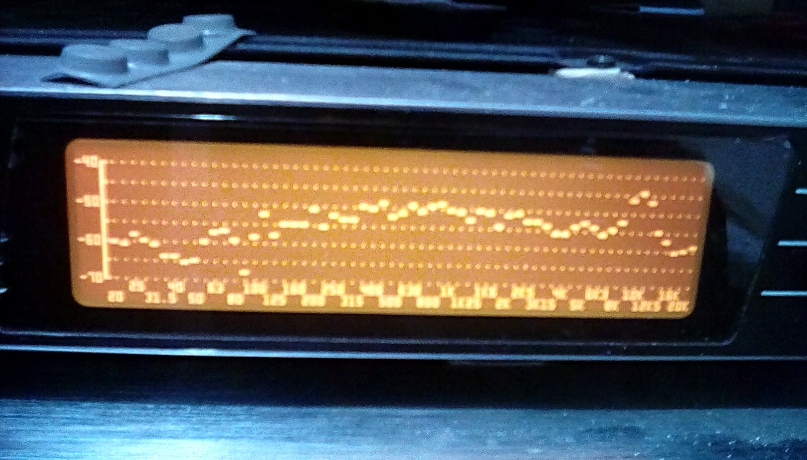

to prove my point, here is a plot of the low quality 70grade eps panel I have just put together, very simple and easy and very cheap to make.
The first picture is with The peak at about 13k .
The second is with this peak sorted.
Clamping depends on the panel used and if it has a poor performance.
If I clamped this panel in any way it's sound would be totally destroyed.
All my panels are designed without clamping, except my old full range very rigidly mounted ply panel.
If it doesn't need fixing ,don't clamp it.
Steve.

The web page changed a little bit since last week but the figures remain the same. I find a density of 605kg/m³. This is not light in the scale of material for DML. EPS at 30kg/m³ is very light. Plywood somewhere in 500 to 700kg/m³ (perhaps a bit more) is heavy in my opinion or at least I wouldn't go higher due to the consequence on efficiency. Acrylic is very heavy.
I had a little accident with my eps panel, which I will fix with a 50x50 mix of pva, no problem.

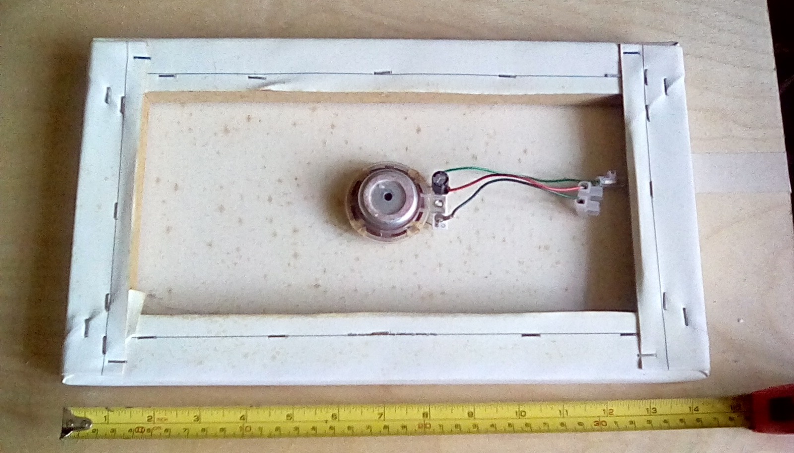

but in the meantime I'm using this canvas panel with just an exciter attached, I have now added a little back brace to support the exciter weight.
the canvas is too loose , it flaps around like a sail in the wind, I have tried soaking the canvas in water and a 50x50 mix of pva but it is still too loose.
the frame is not adjustable so I have either got to undo the canvas and re-stretch it or maybe expand the frame joints somehow ?
I think the printed front surface has a plastic coating ,which sounds ok so far, but adding pva is not an option.
even in this condition the panel has a good response down to about 130hz ,with a very natural sound,but more can be done I think.
if not using full range, I am coming around to thinking that the ply is not needed on canvas.
This panel needs more testing ,the smaller panel doesn't seem to affect the overall sound, I just want to get a little bit more Life into the sound.
At the moment I'm trying to do this without affecting the front picture, but may eventually have to add a dome ?
But I have a few ideas.
Steve.

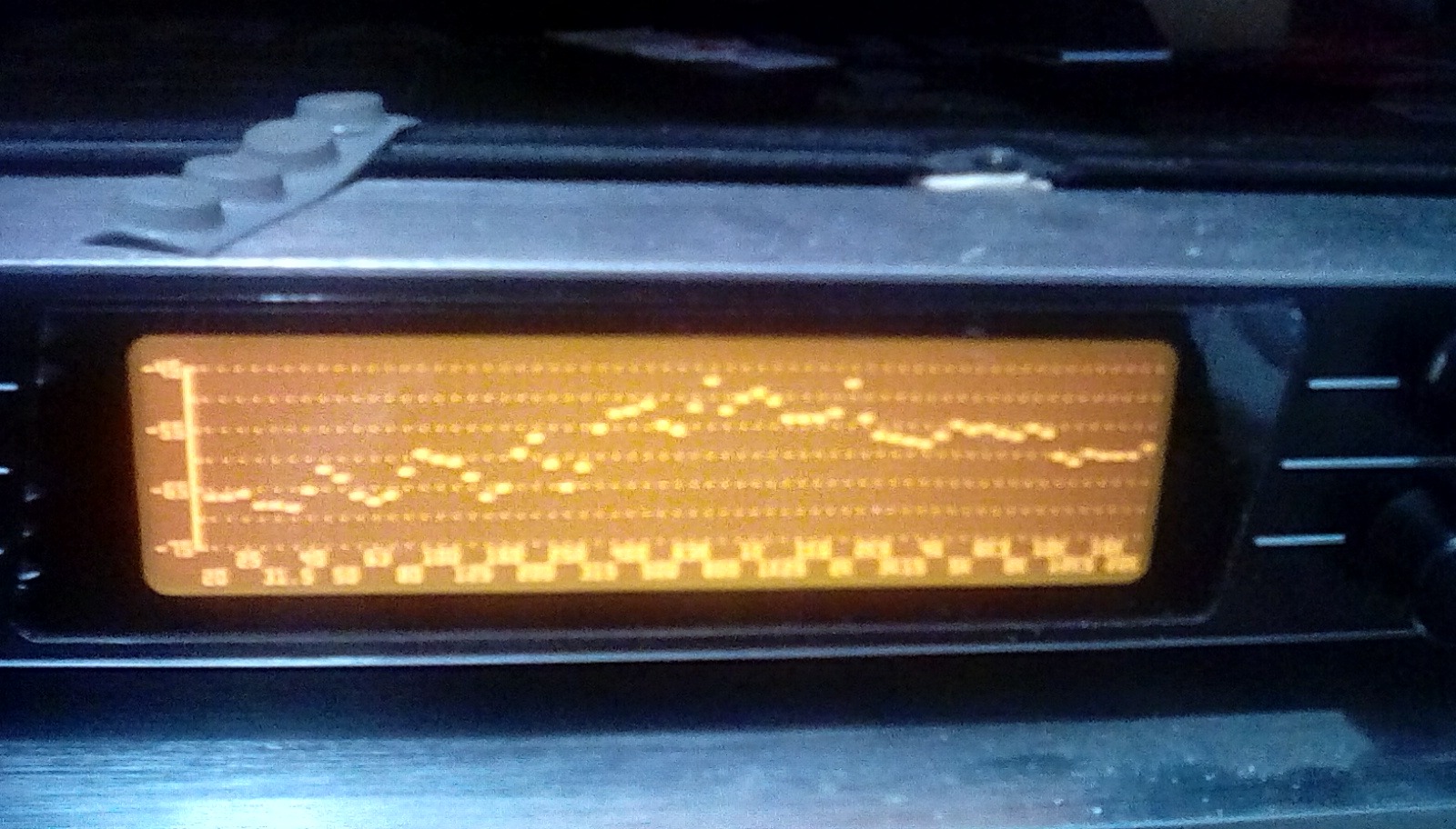

Just took some quick photos of the floppy art panel .
In the first picture, even in its present state ,gives a half decent response and quite good natural sound.
In the second picture I stuffed strips of foam between the frame and canvas, this tightened up the canvas a little bit and pushed the canvas away from the exciter coil, so not perfect, it did introduce a sound I didn't like ,but the response goes much lower now.
These canvas panels can be very flexible, different sizes seem to work ,with or without the ply panel, and with different size ply panels, small or large, depending on how you want to use them.
the third picture is of the larger canvas panel without the ply panel for comparison, the dip at 4k might be to do with the damage I caused to the dome ?
At the moment I am listening to these two panels with an XO at 100hz but as usual the sub goes up to 300hz.
Cymbals are sounding quite good, but the floppy canvas is causing buzzing on loud vocals.
So far they are sounding good, but as I say , I think they can be improved.
All measurements are at 30cm.
Steve.
