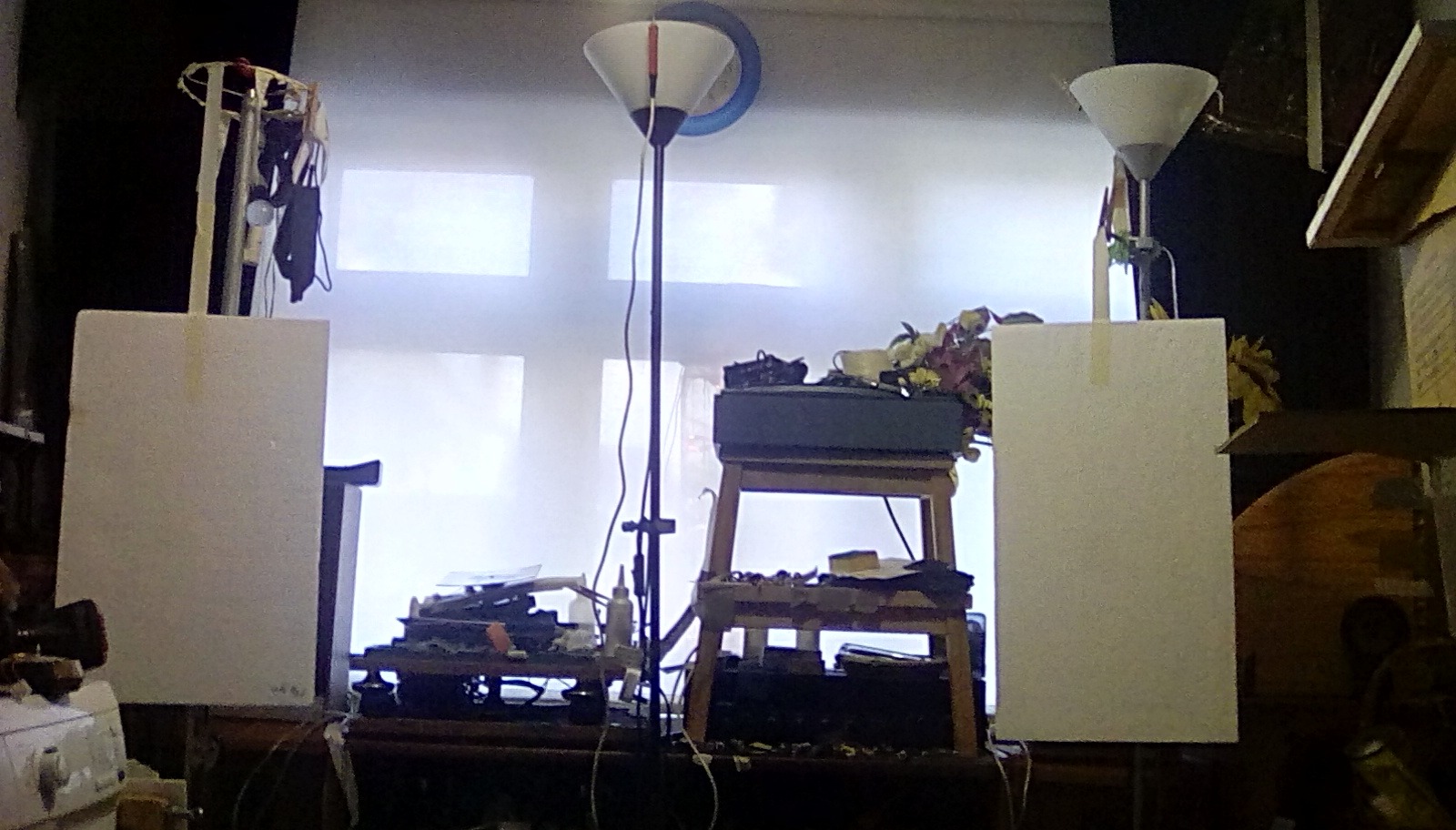

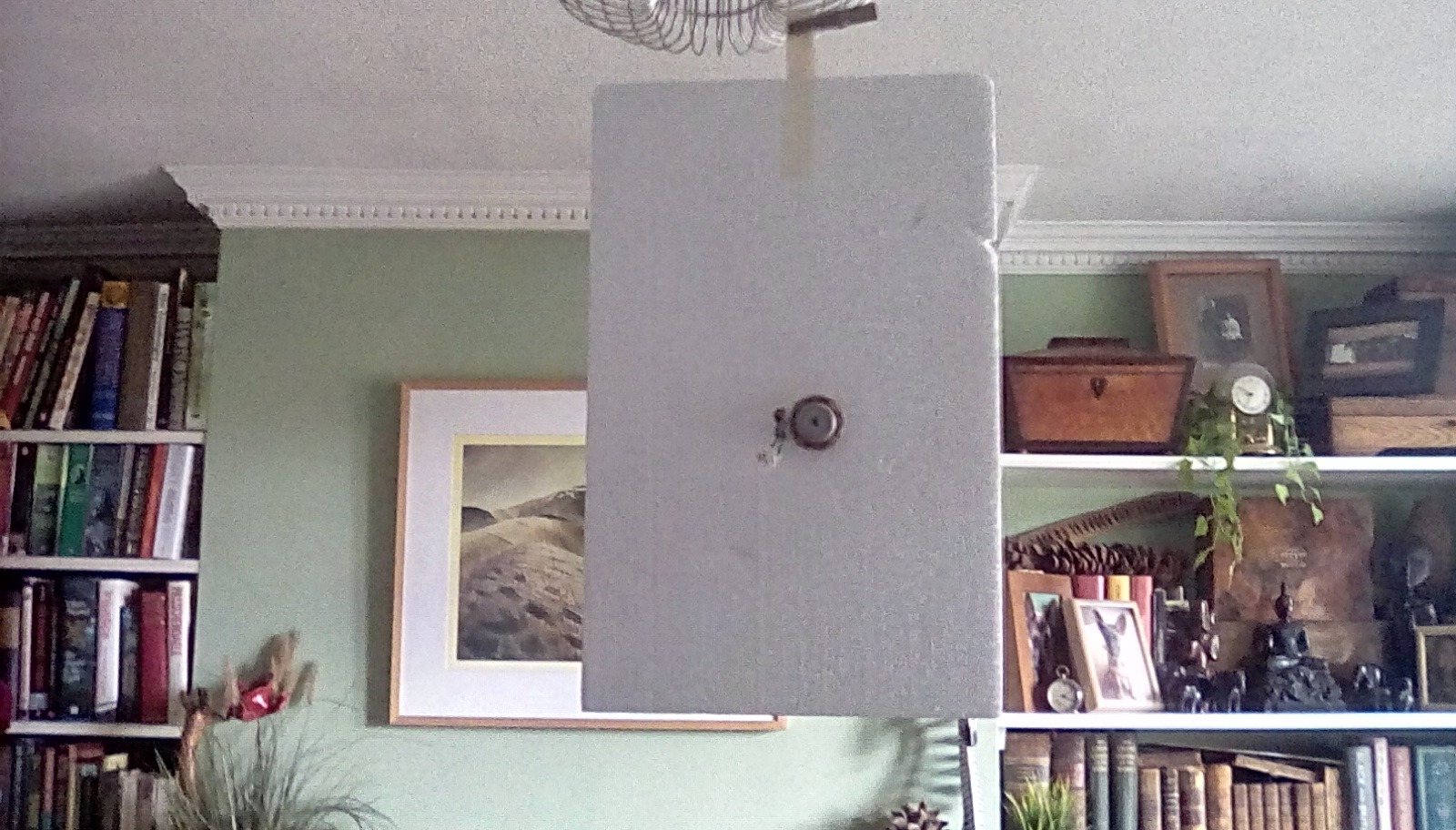

But now I have instead ordered an assortment with 10 and 25mm 25kg/m3 GPS (Neopor), 15mm 25kg/m3 EPS (Peripor) and 25mm 20kg/m3 EPS (Styropor)
I'm leaning more towards the shellac actually. With a shellac with low wax content and applied correctly it should handle moisture. Like with all natural materials with no drying agents you have to handle them correctly though. It will dry quickly in thin layers, but similar to linseed oil paint, paint it too thick and it will never dry. And using drying agents will make it too dry with time and result in cracking. But seems relatively easy to use. People just don't have time to wait 40 minutes between layers nowadays, which is why synthetic lac have become more popular.

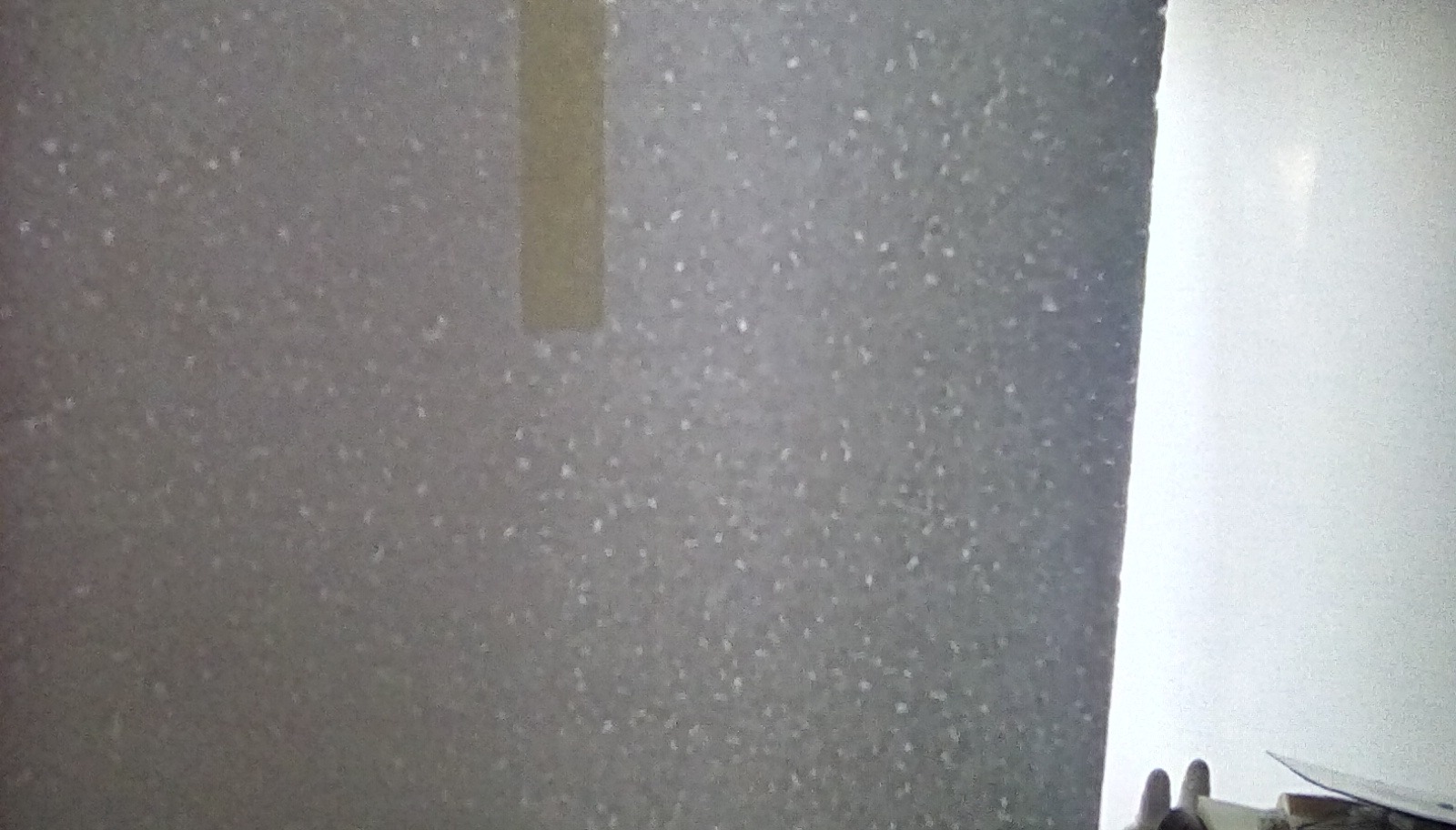

Maybe I should point out that the surface on the lower grade eps is softer than the higher grades.
Is this down to the cutting methods ?
I noticed that moulded eps also has a softer surface .
So if the panel has a soft surface already, there is no need to sand off the hard surface .
I've also noticed that different panel materials react differently will the sound within the coil area.
The more reflective materials seem to make the exciter more noisy , a little bit like the noise in a council swimming pool surrounded by tiles on the walls.
it is at least one of the reasons the exciter is noisy anyway.
I have not coated the inside of the coil foot , to see if I can hear a difference in the noise from the back of the exciter, will it reduce the reflections within the coil cavity.?
We shall see ?

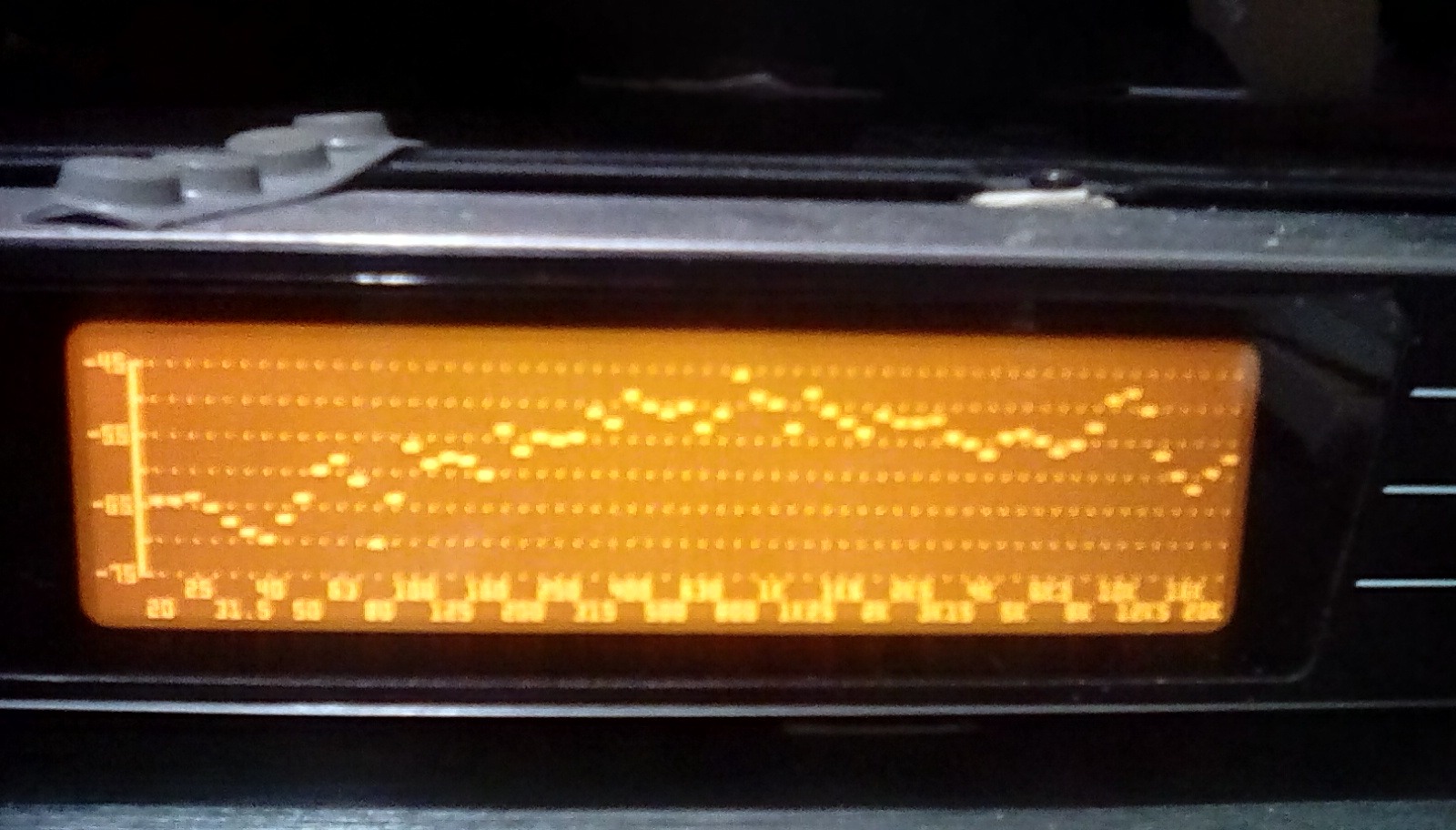

it is the hard skin caused by the hot knife cutting that is the problem, it produces a sound that is pretty awful.

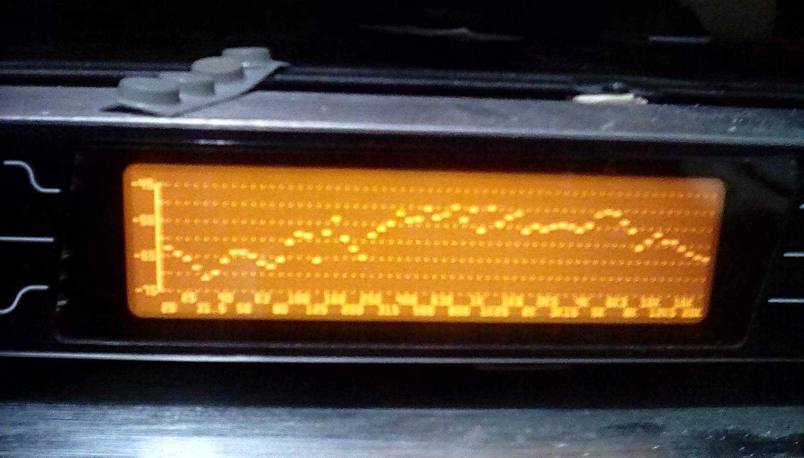

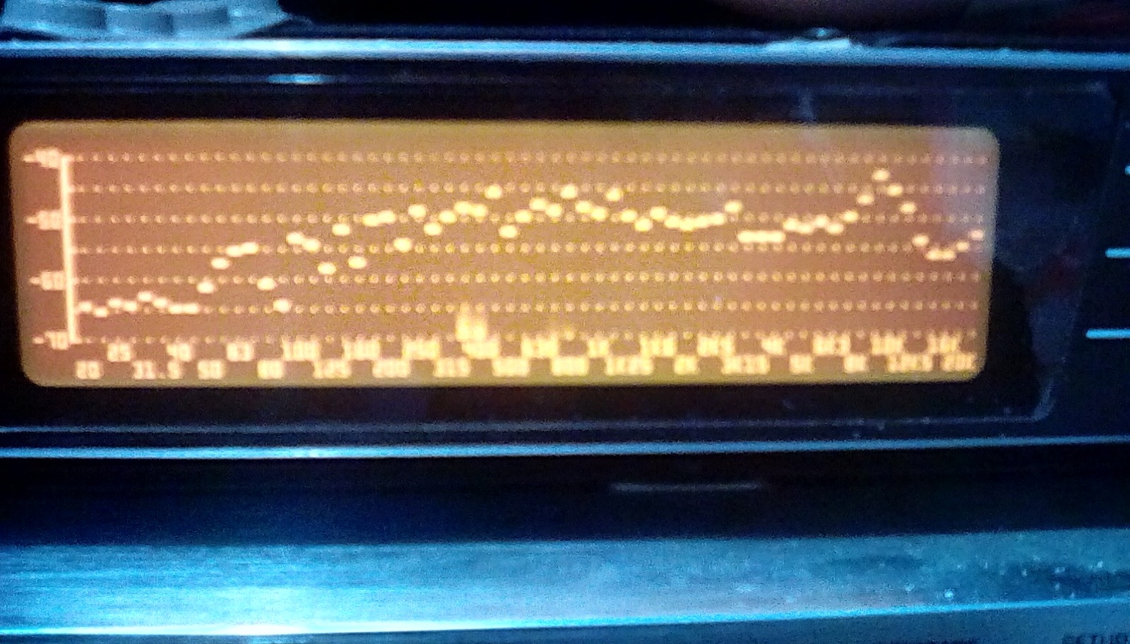

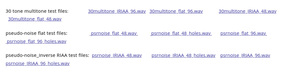

Reading your post, I thought you had download it already. No problemSorry, was not expressing myself very well....I was wondering if you have the actual audio signal you used in your tests?
Go to this page : https://linearaudio.net/downloads where are the free Linear Audio ressource.
Go down or search for the file 30multitone_flat_48.wav
There are recommendations just before. The more important : set the recorder (REW) on the same sampling frequency 48kHz than the track and set the RTA on spectrum with a 65536 point FFT. This to avoid any artifact (unreal frequencies linked to window leakage) from the FFT treatement.
The characteristic of the signal is a 1/3 octave spacing but more important the random phase.
I also set the RTA on average forever as I do for MMM (Moving Microphone Measurement with pink noise) so that the noise floor is reduced by averaging but not the frequencies from the speaker.
I made a stereo track from the mono original one.
I play it with Audacity while REW is working in RTA.

At the moment I am in the middle of testing the eps panels.
The first picture is the low grade panel drying near the fire after coating with pva.
The second picture is them playing before coating.
The third picture is the response of the 70grade eps panel before doing anything to it.
The fourth picture is the low grade panel before doing anything to it.
Both at about 30cm.
The peak before rolling off with the low grade is at about 8k.
And the peak before rolling off with the 70grade is about the 13k mark.
I will explain the difference in sound and performance at another time, as I have noticed certain things as I've moved along.
Steve.

I took this picture to show the difference a poor quality grade can make.
You can see the holes in the surface ,both panels have the holes , but the holes in the higher grade are smaller.
These are just cheap packing boards, this was similar to the cheap panels wickes started selling , but are back to the good quality stuff now, in my local shop anyway ?
They still sound good though, but I don't like the idea of mounting my exciter on a panel full of holes.
I didn't bother sanding the low grade panel as the soft surface didn't sound bad , but the 70grade even though it did feel softer ,still had that eps sound, so I sanded it, what a pain !
At the moment they both sound very similar.
I will continue to listening to them for a little while before making some more alterations.
Steve.

One of the first things I noticed when first listening to the uncoated panels and comparing them to the 6ft sanded panel,was that the cheap 70grade panel sounded boxy in the lower midrange a sort of resonance.
It was very obvious, I was wondering if this was the sort of echo Eric was describing ?
Sanding reduced this considerably and since adding the pva I have not noticed it, it now has a very clean clear sound.
The pva will take a few days to harden properly, so the HF might still improve a little more ?
Jangling bells and crashing bells already sound good though, eps always excels at this , and the ambience is excellent.
I am enjoying this .
The picture I of the 70grade with pva , it looks very similar to the eps skin but the sound is totally different.
Steve.
