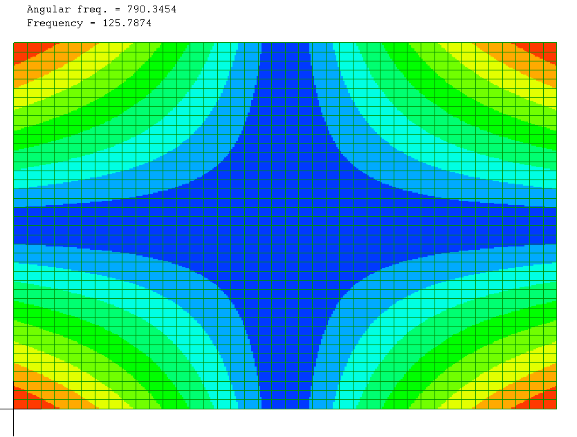

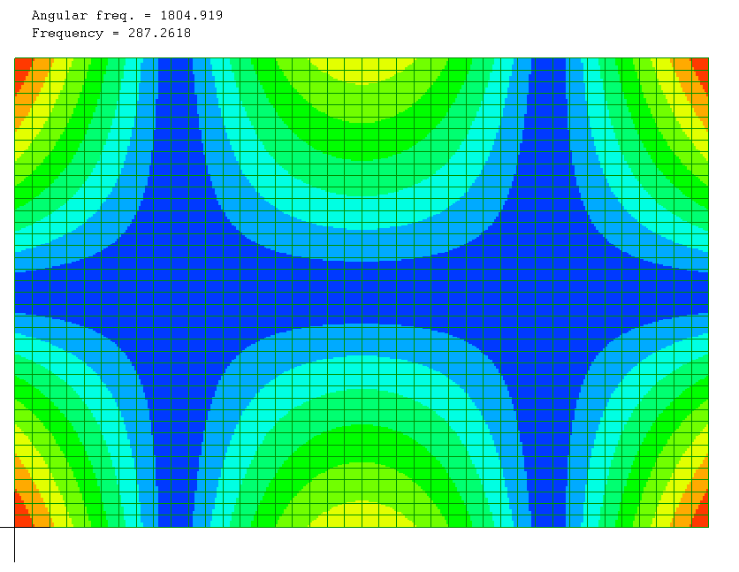

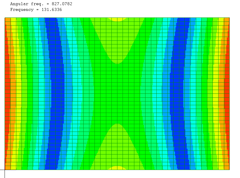

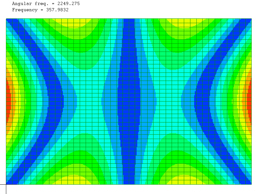

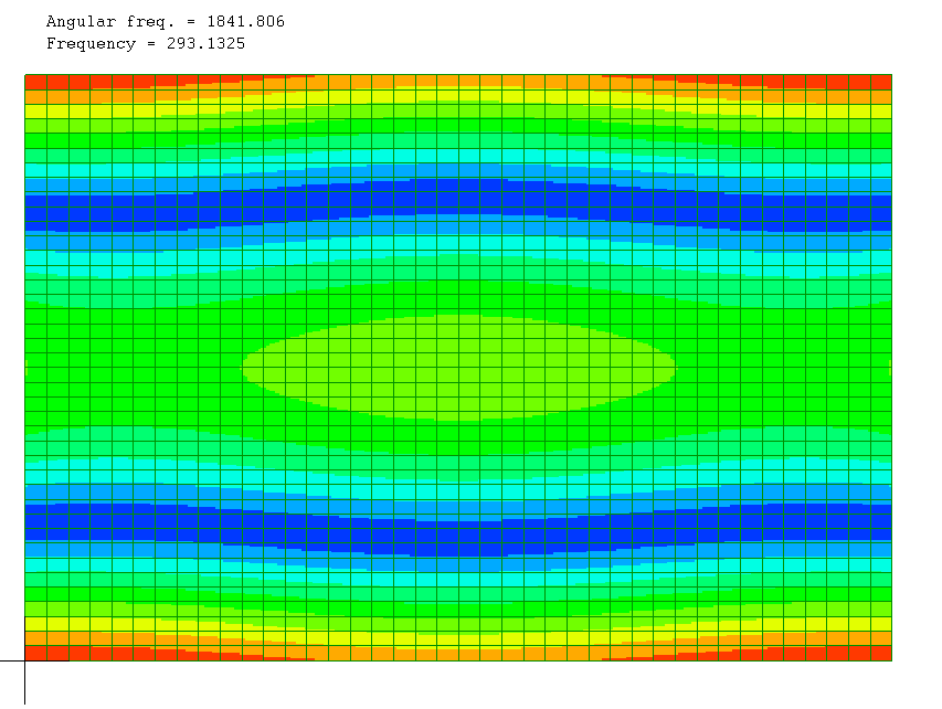

Hi EricChristian,
My second suggestion is to simply measure the resonance frequencies of your plate directly using the "tap test" that I mentioned in the other thread regarding the Impulse Excitation method.
The way to measure the resonant frequencies of a plates is to make a series of REW measurements at various points on the plate using the "tap" test. Each of the locations will reveal a different set of resonance frequencies.
For each tap location you:
1. suspend the panel a particular way, depending on which mode or modes of resonance you want to excite/isolate/identify.
2. place you mic very close to the surface of the plate (1-2 cm), at a particular location (again, depending on the mode(s) of resonance you want to excite).
3. tap the panel at the location of the mic
4. monitor the response in REW, (using the RTA function, spectrum mode, no smoothing and , 4,8, or 16 averages)
5. you will see several sharp peaks in the frequency response. Each one is a resonance frequency of the panel.
Below are images representing the first several modes. The shapes will be similar for most any plate with the same aspect ratio. These particular results are for a 20x30 cm plate, 4 mm thick with a Elastic Modulus of 5 GPa and a density of 0.6 g/cm^3. (Like plywood, but isotropic).
To measure the first mode (first image below), attach strings to the plate at the middle of two adjacent edges (where the image is blue for that mode), and place the mic (and tap) at any of the corners (where the image is red). I use alligator clips to attach to the plate, so the hanging locations can be moved easily. If the plate is light enough you can just use strips of tape. When you tap the plate, the lowest peak you observe in the REW spectrum is the fundamental in torsion.
To measure the fundamental in bending (2nd image), move the stings to one of the long edges, attached about 1/5 of the distance from each end (image is blue there). Position the mic and tap the panel along either of the short ends of the panel (where it's red). Now the lowest frequency peak you will observe corresponds to this mode. You my still see a peak for the torsion mode, but ignore that, as you already know what it is. You will also see many peaks at higher frequencies, corresponding to higher order modes.
Leave the strings in the same place, but tap and mic at one of the corners to find the frequency corresponding to the mode in the third image.
If you wish, continue the same way to get the frequencies of the next two modes. In each case, ignore frequencies that you have already "identified" from previous results.
Note, it can get a bit tricky as sometimes different modes can be very close in frequency. But by trying our different tapping and/or micing positions you can often figure out which is which. this is because tapping at "blue" locations won't excite that mode. So if you can find a place that's red for one mode and blue for the other, tap that place and the peak you get will correspond to the mode that's red at that spot.
Try it!
Eric
View attachment 1033313 View attachment 1033314 View attachment 1033315 View attachment 1033316 View attachment 1033317

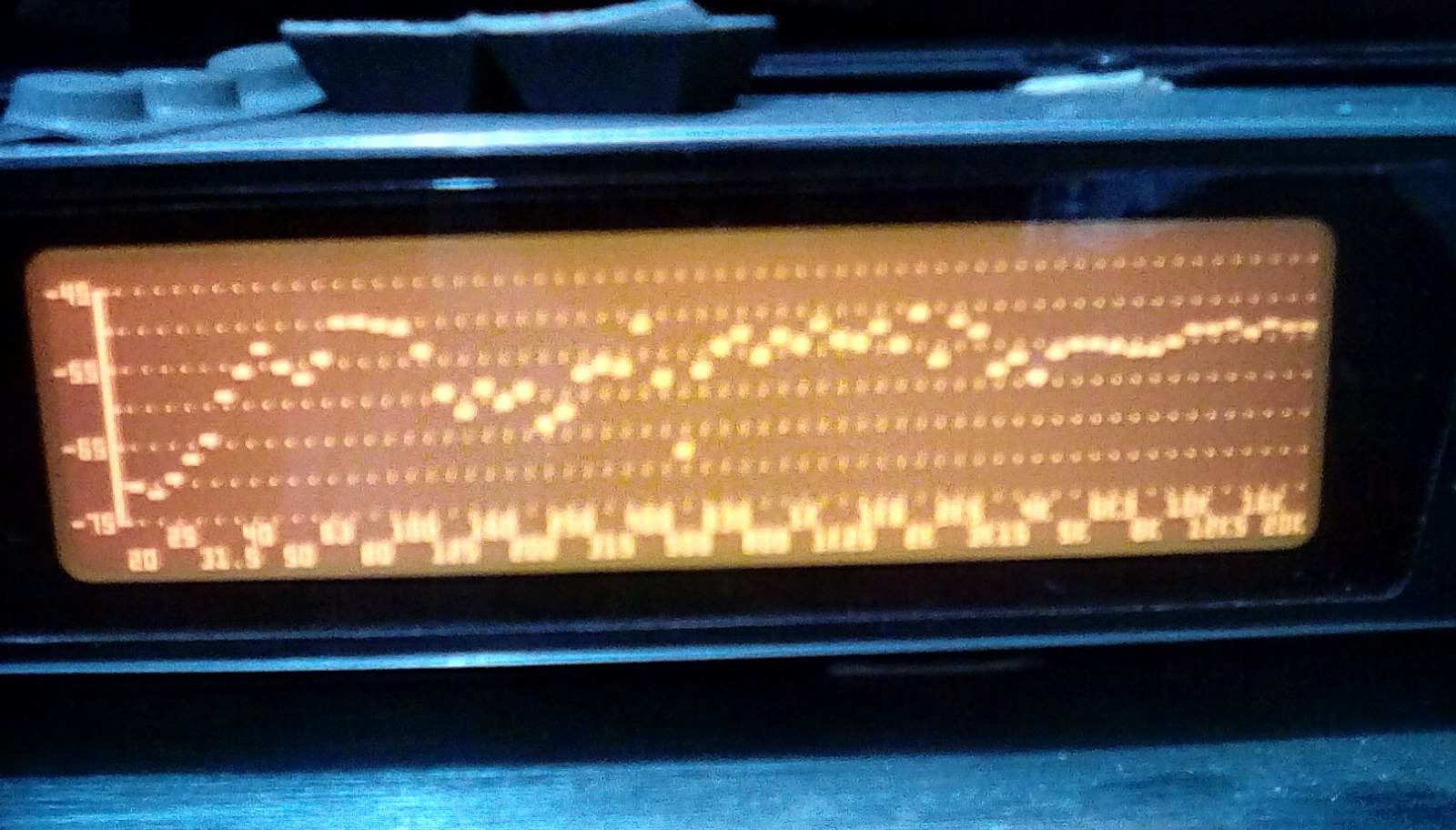

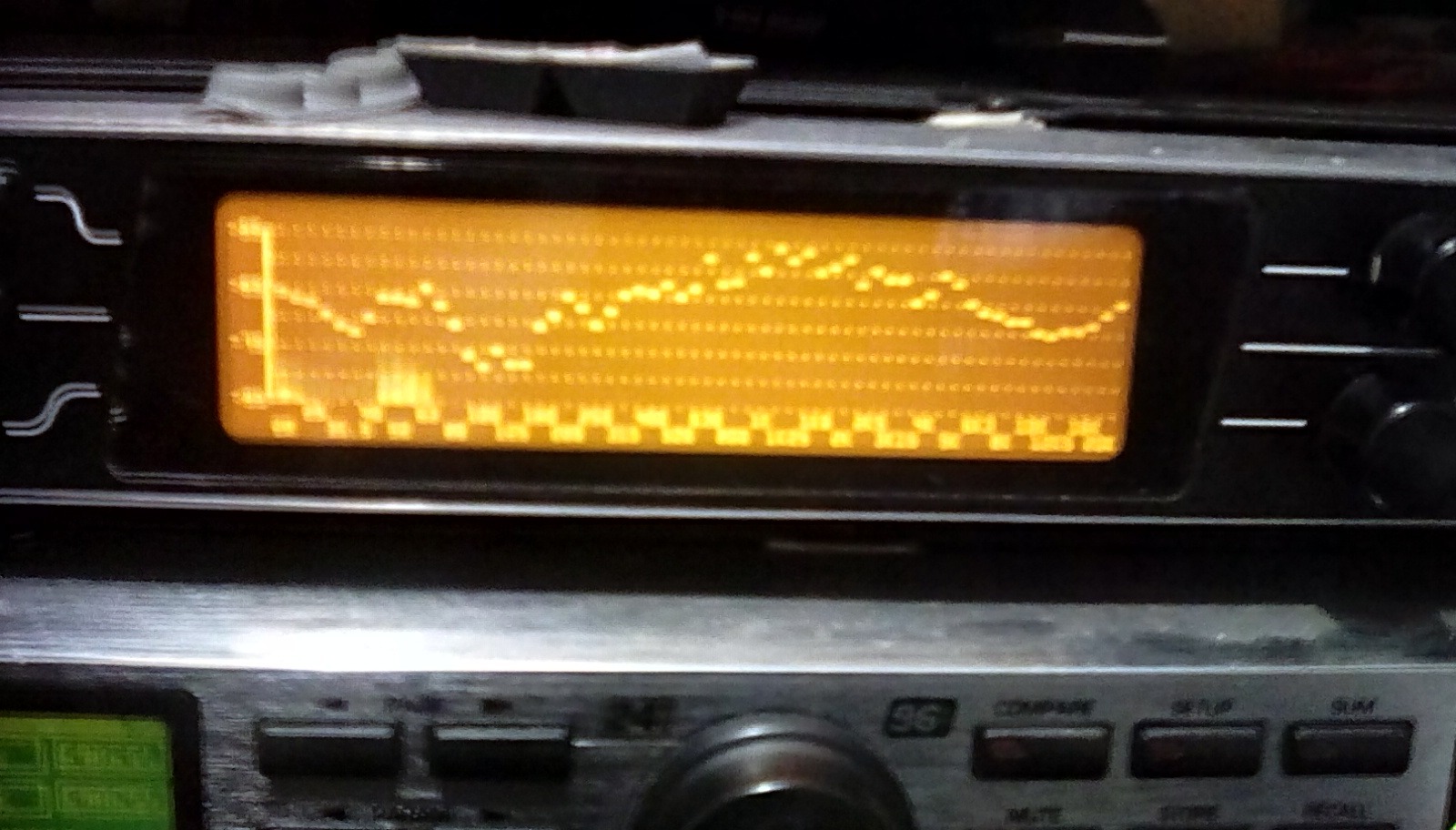

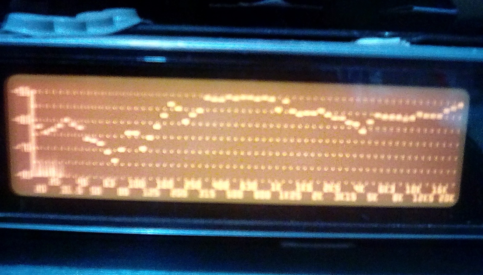

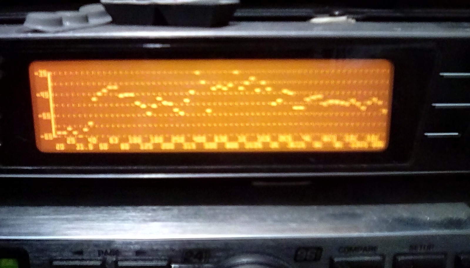

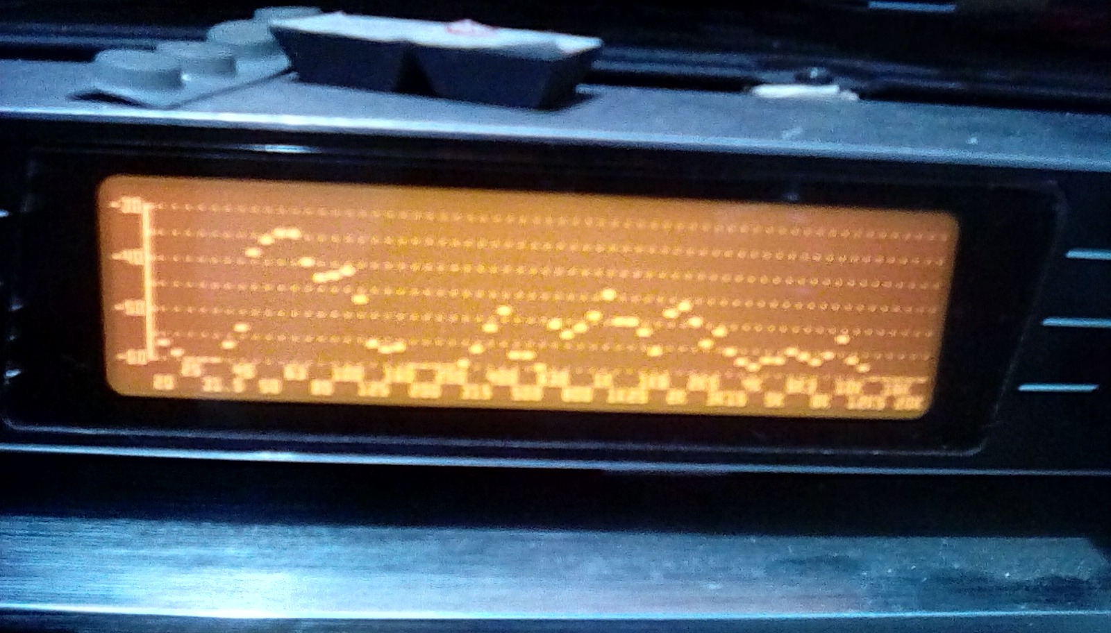

something you might be interested in.

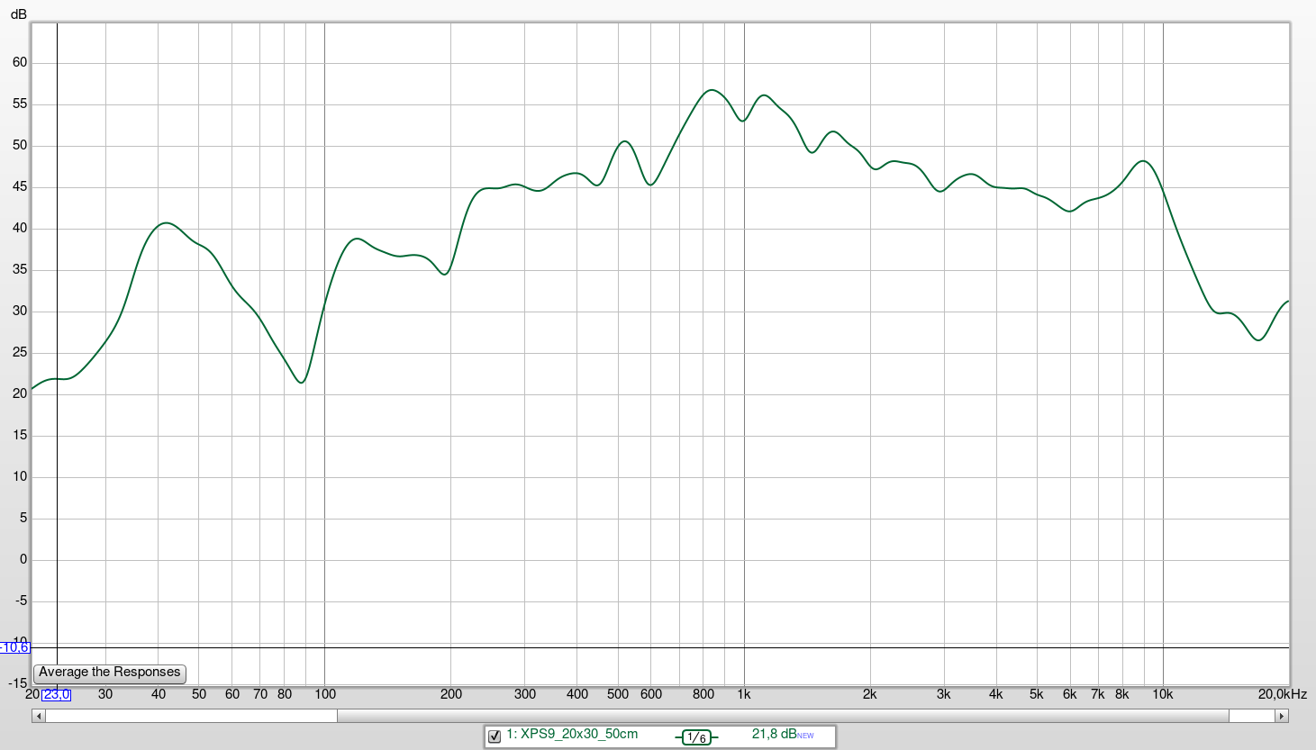

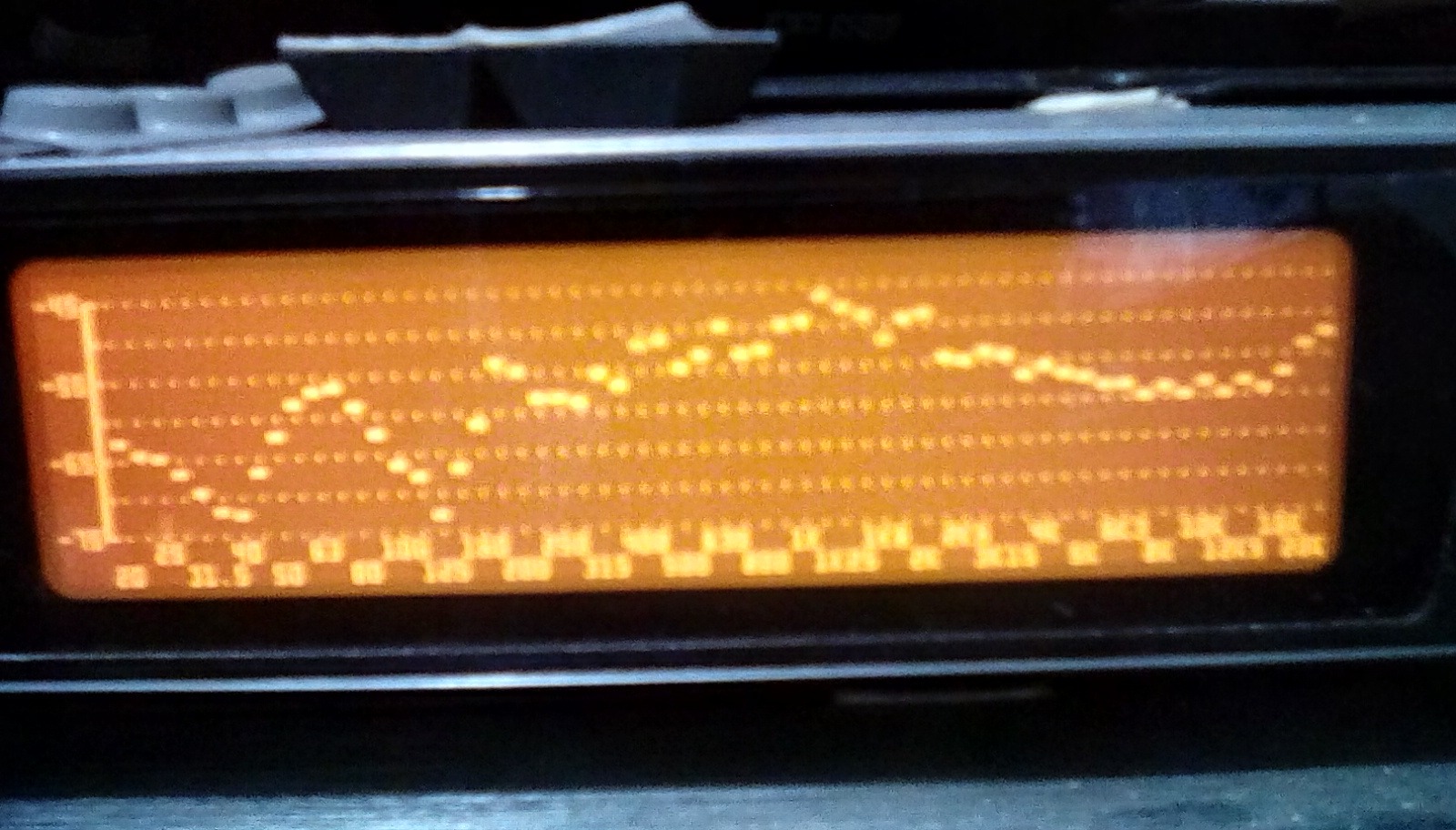

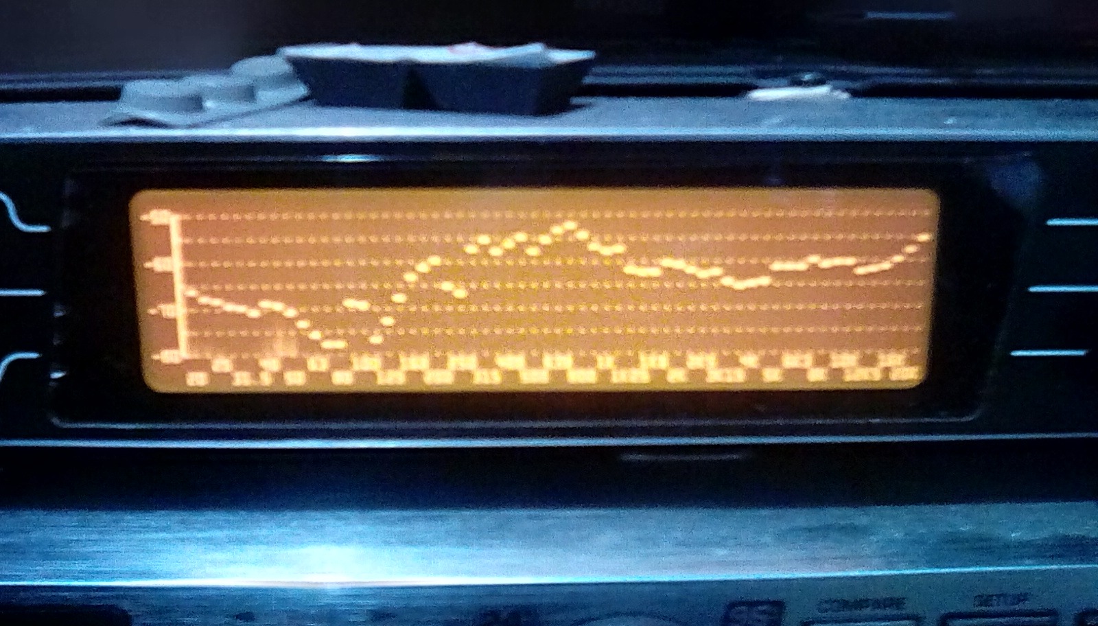

last night I was trying to sort out the low end on the two canvas panels.
the pictures show the problem.
The first picture shows the fr at about 30cm pink noise.
The second picture shows the response of a very heavy bass track,(Maxwell's urban hang suite)
The bass peaks at about 50to60hz about at least 10db. Higher than the rest .
The third picture is at 3m into the room , now the bass peak is more like 15db higher than the other frequencies.
This is causing the panel distress, flapping.
My remedy was to gently roll off the bass below 120hz like a tone control on an amp.
But I would normally not go down this far , but if I wanted to run this panel full range this would have to be controlled.
The flapping was mainly coming from the top and bottom larger areas of open canvas .
So I was thinking maybe making the ply panel bigger in the middle matching the 10cm side distance , or reducing the panel size.
So the ply panel would be 10cm from the sides.
That would hopefully reduce the flapping but probably not the peak?
Once again ,sorry for the poor quality pictures.
Steve.

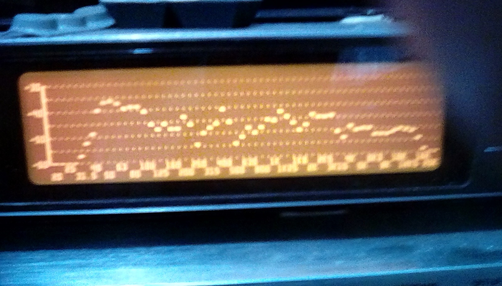

I've been having another play around with a couple of panels.
The first is the cascamite panel at about 1m playing the same track but with a butt 45db roll off at 61hz.
The panel is much more controlled , keeping the very low frequencies away from the panel , the hump in the midrange is the vocals and saxophone .
Second picture is of the 6x9inch 1mm veneer at 2m
The third picture is my 6x9inch 1mm veneer panel at 30cm.
The last tracks are are with pink noise.
I am at the moment playing both the art and veneer panel size by side.
apart from a little bass distortion from not being set up properly ,it's hard to believe that the subs are not switched on !
Steve.

I posted in Application of Impulse Excitation for DML Design and Analysis #6 the outputs of the method you described. I think it is the best place to discuss about it and here the general questions of the panel.
It gives some characteristics of the XPS : rho = 33kg/m³, E = 31MPa, G=14MPa
The starting point of my question was in the FR of the XPS 9mm 20x30cm (see below). It was just glued on the exciter (the exciter a little bit of center 8.5cm, 14cm from the corner).
When I asked if there is a way to calculate the modes, it is because I was surprised by the peak at 43Hz (is it from a mode?) and also in the medium at 850Hz and 1.1kHz.
Do you think your FEM simulation can help?
I saw in the other thread you wonder about the influence of the exciter on the modes. For light materials like that one, my opinion it is it can have a role by adding a local mass and a compliance.

I have not started trying to sort out the PS foam data yet. So far I was just looking at you plywood.
But just to clarify, is the FR above still for the free panel (i.e. no frame just suspended by strings)?
Concerning the weight of the exciter: I was a bit surprised to see that the exciter didn't seem to have any effect at all on the apparent resonant frequencies of my much larger and thicker (and frame mounted ) plywood panel. I have not tried done that comparison on lighter panels, but I would not be surprised if there was an effect.
Eric

Yes it is the free panel. XPS 9mm 20x30cm. No frame, no strings. The membrane is something like17g so just held by a double side tape on the exciter voice coil.Christian,

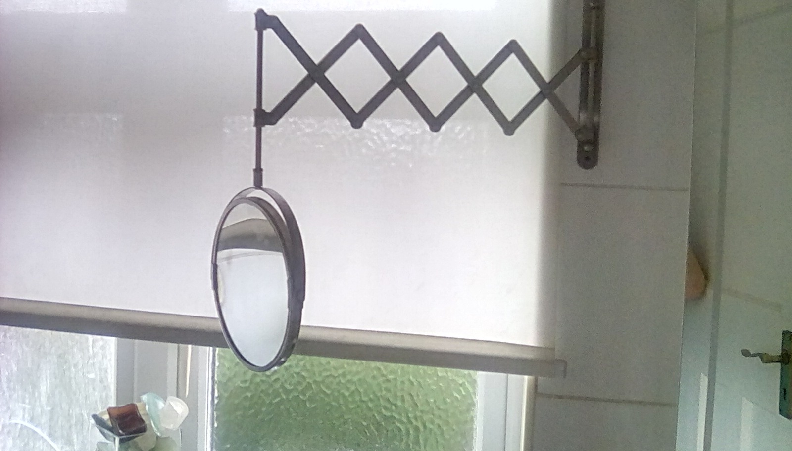

I also suggested using this sort of mounting for my smaller panels, see picture,
tilting inwards , any type of panel ,so that it is not parallel to the rear wall is always a good idea, to help prevent standing waves and cancellations.

A couple of days ago I was going to put a small panel on my naked canvas panel, it is just canvas with a dome in the middle of the coil.
I accidentally pulled the canvas off the coil while trying to pull out the pushed in dome .
anyway to cut a long story short, I realised I had not added any pva to the canvas, so have ,for completeness, decided to now add the pva and see what happens.
before doing this I decided to take some measurements at 30cm.
the first I took thinking there is nothing below 100hz only the road noise and my footsteps.
then realised I still had the xo on,
the second picture is also at 30cm ,now you can see that there is still out put down nearly to 20hz admittedly lower down in volume level.
but can this be built on?
I think I might prefer the sound of the naked canvas panel ? And the response is pretty good.
I'm just wondering how far down this type of panel will go without stress, although it is already well within the performance band I am interested in ,to fit in with my transmission line speakers which roll off at 300hz.
We shall see ?
Steve.
