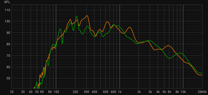

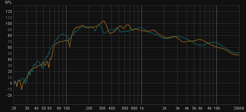

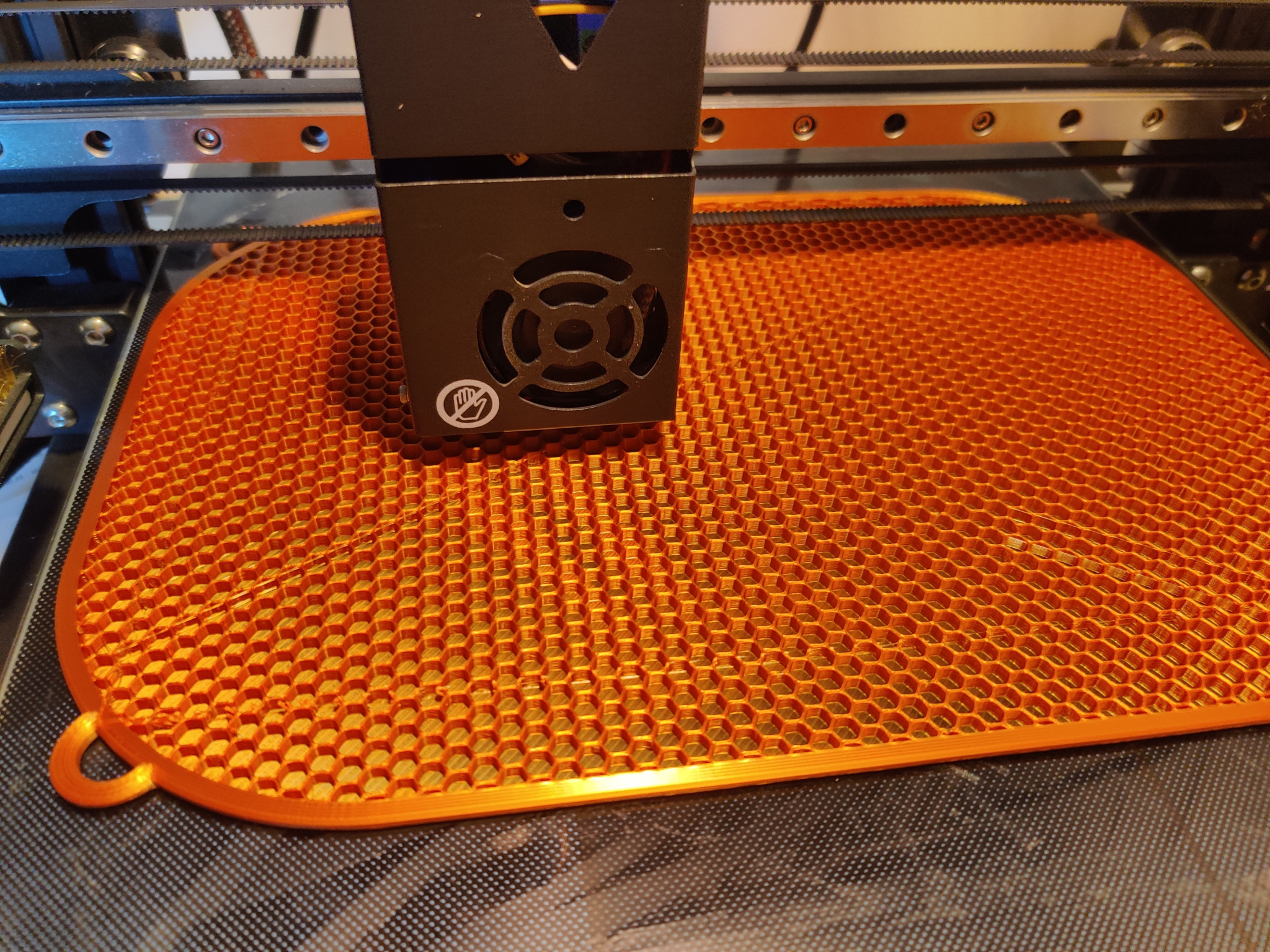

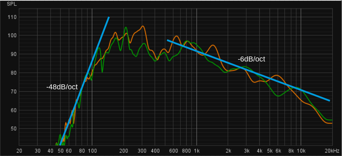

The 6mm plate will take a while to print and take a lot of material, but I have the 1mm and 3.8mm ready now with exciters mounted.
Size of the plates are 295x205mm, and the 1mm plate weighs 36g, and the 3.8mm 76.3g.
Both plates have one 0.1 layer at the bottom, which is the side the exciter is fixed on. The infill is 17% honeycomb, and at the top I have 3 layers a 0.1mm each. These settings was pushing it with the BioFusion filament, and the surface at the top didn't become fully solid everywhere, and little bit came off at the bottom of the 3.8mm getting stuck to the glass as I removed the plate. But it was the settings I found best for for the carbon filament, so used the same for these plates.
The extrusion with is 0.6 mm as nozzle size, but infill has 50% extrusion.
This is the 3.8 mm plate during printing to give you an idea about the structure:
Also you can see the thick walls. I added those for some damping. Maybe not ideal from a efficiency standpoint, but seems like some damping will smoothen the FR and reduce ringing, and I'm planning to tie it in all 4 corner mounts only for suspension.
First of all which is louder?
Using "check levels" before measuring the FR in REW, the noise registers as 93dB for the 1mm plate and 99dB for the 3.8mm. So as expected the ticker plate is loudest despite having double the mass.
Since this material is not that stiff to start with, the 1mm plate is very bendy though, and wobbles as you wave it in the air. The 3.8mm is fairly stiff, and takes some actual force to bend it.
When it comes to FR, the 1mm is surprisingly close I would say...it feels so flimsy that I expected it to be a disaster. Actually it is, but because it distorts badly in the low mids, more on that later...

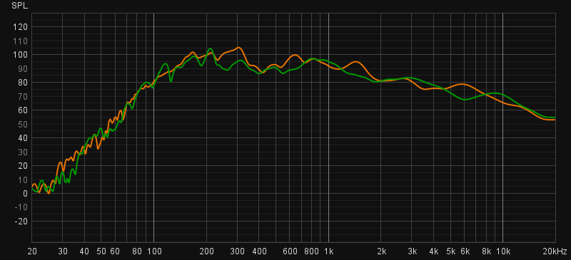

First I measured with them just hanging from strings, with orange being the 3.8mm and turquoise the 1mm:
The bass response is stronger with the thin plate, but some strong modes in the low mids makes the 3.8mm win in peak SPL.
To drift away in speculations a bit, this kind of response is what I seen before that makes me think why the thickness tends to push up those modes in particular. The lower bass frequencies depend more on pure wave bending of the plane, and hence become louder with the thinner plate. But the lack of body means weaker modes in the mids. That's my hypothesis anyway and I'm sticking with it! 😉
The plan is like I said to actually suspend from all four corner mounts, and to emulate that I pulled slightly at the bottom corner mounts while doing the test (orange 3.8mm and green 1mm):
We see that the bass response especially becomes smoother, and is much more similar for both plates. It makes sense if the damping constricts the planar wave motion, but we still see those mid peaks in the 3.8mm, and they don't seem to be much affected by damping the boundaries. This does seem to indicate that there are different principles at play here in different parts of the spectrum.
However, like mentioned before the 1mm distorts badly in the low mids. I'm not sure why that is, but think I want to revise the process and see if that can be fixed by printing the top layer separately and glue or iron it on. Improving on the 1mm plate might help improving the thicker plates as well.

Leob,
Thank you for this pictures and the FR.
My comments/questions :
  • The HF roll off : you have already answered suspecting some limitation in the measurement chain.
  • Is there really a 6dB difference in efficiency? The 3.8mm (orange) curve is above in some regions but they are really very similar. You might use a 5dB scale to have a better view. No need to show FR on a 140dB span.
  • The bass roll off are very similar despite the difference of mass and stiffness... like if another parameter like defines the limitation. The bass roll off of a panel in room remains quite high in my list of questions about DML
I had a quick test today with a 20x30cm piece of XPS 9mm (probably Depron) to have an idea to what happens with a panel of the dimensions you have. The measure was at 50cm. The bass roll off is less stiff. I went back in my measurement records and see the same material in a larger panel 60x80cm shown a bass roll off similar to yours but starting even higher in frequency.
What is the distance panel/mic in your measurements?
Christian
I don't suspect the HF roll off is a measurement issue. I'm just careful drawing to much conclusions about the details in the HF response with a cheap mic. The overall slope seems correct to my ears at least, and the printed plastic is a bit duller than the cardboard and PC.
I was surprised how close the graphs where after doing the noise measurement, so redid it a couple of times with same result. Indeed I should zoom more. The difference in the graph is 10dB in several places, and perhaps comparing noise and a sweep is not really the same? Can try to do a FR with noise and see if it makes a difference.
Here is the dampened version with more zoom
Indeed bass response is quite similar. It is more uneven in the thinner plate, but that can be the distortion messing up the graph as well. But if anything is tied to mass it is not obvious in the bass region, and the flexibility of the plate seems the most critical factor.

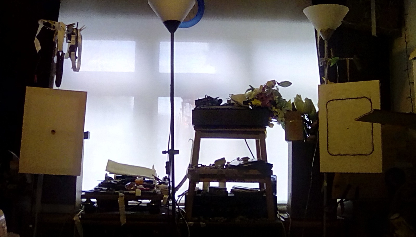

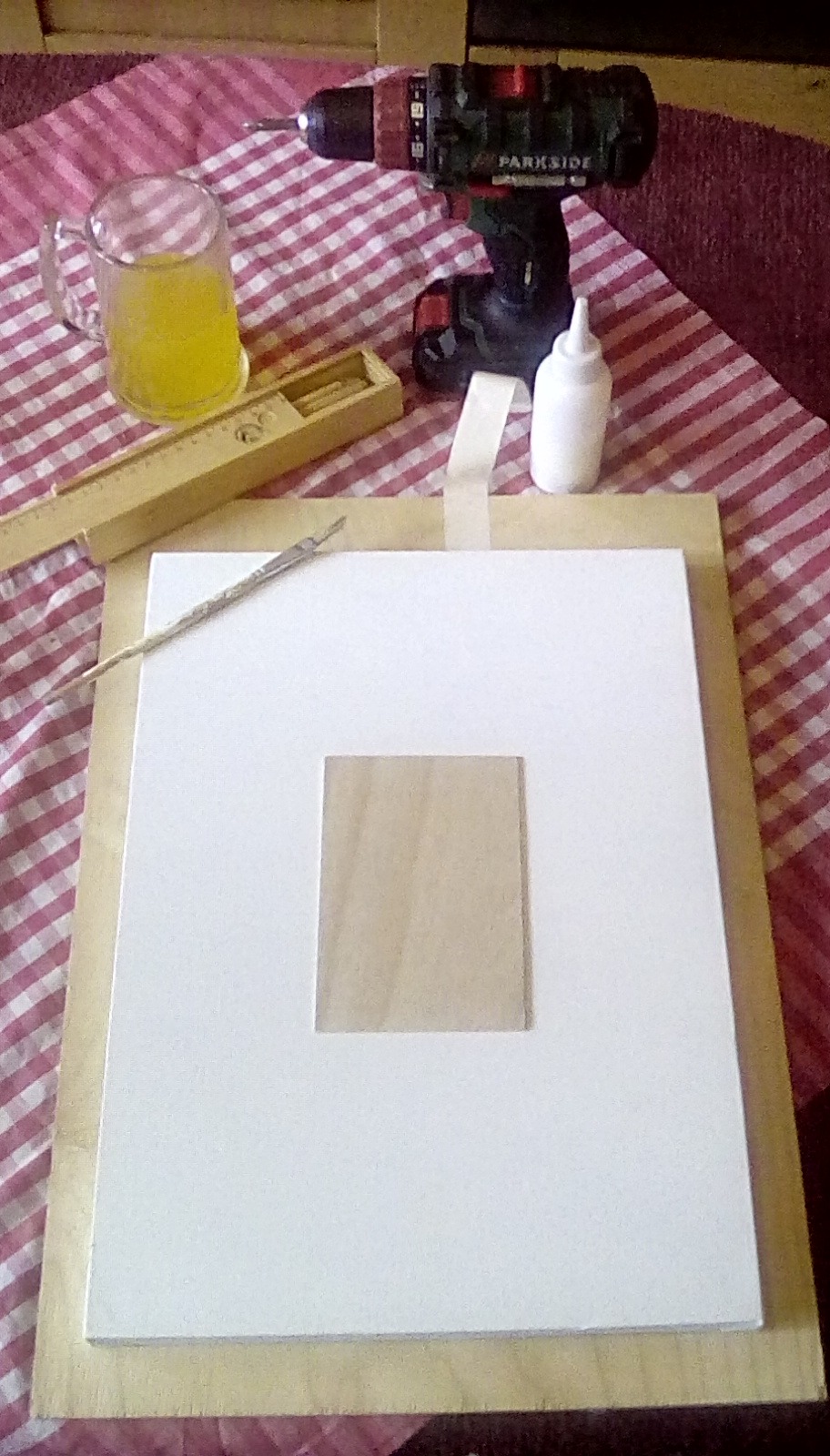

My wife is in London today, church watching ? so I will be able to make up the art panel, which will not take long, I should be able to have a listen tomorrow.
I'm just going to drill the hole in the ply and glue the panel and exciter to the canvas using neat pva.
Just to start with and see how that sounds.
It's as easy as that.
I will be making comparisons with the cascamite panel and the canvas only panel with dome.
Maybe I should set up these two panels today and get used to the sound a little ,to help with comparisons tomorrow.
Thanks again , for reminding me.
Steve.

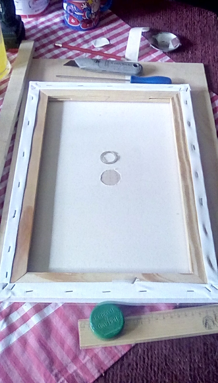

While I was setting up the art panel I suddenly remembered that my next test set-up I was planning was going to be with the panel on the front as in the picture.
I'm in a bit of a quandary as to which to go for.
the idea was to try and get a little more detail from the ply on the front side and maybe cutting a larger area of canvas at the back for less damping ?
it doesn't look too bad , in fact I like the look.
I will only have one panel left to experiment with after this panel .
I got the four panels very cheaply in a 4 pack .
Mmmmmm.
Steve.

Ok , I've made up my mind, I've glued the ply to the front of the canvas panel but without the hole for the dome, but I've cut a hole in the canvas so that the exciter will mount directly on to the ply.
This is going to take a lot longer now as I have to wait for the canvas to dry before gluing the exciter on.
I've placed weights on the canvas and ply to keep it flat and stop it bubbling.
Leob,
What is the distance mic/panel in your measurements?

I am also keen to try out a Natural Product and Canvas is very attractive, especially after hearing recordings on this Thread with it used as the DPS.
There is one more itch to scratch for a use of a Natural Material and that will be a very thin wood material with a soaking of Shellac, as I have seen in other threads where damping is a required property for a material that a Shellac Soak Coating can enhance the measurements recorded for damping and dissipation of a material.
Shellac is as Natural as it gets, as it is produced from secretions from the Lac Beetle insect, it is very stable and long lasting.
It also has very minimum elastic properties and is resistant to UV break down.
Most importantly, and to really get the party going, Is there any 'Exciters' I could purchase from a UK members redundant parts?
Leob,
The HF roll off is not very steep so why not but the bass roll off is unusually steep. Almost the same for both panels is also strange. There is perhaps something to check.
