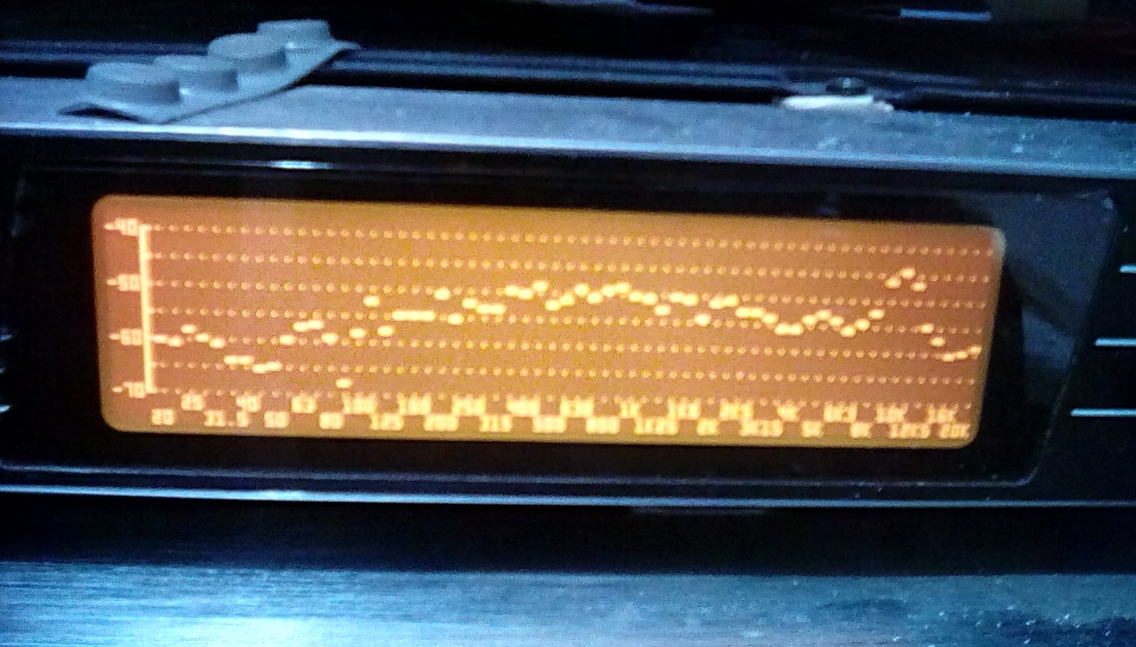

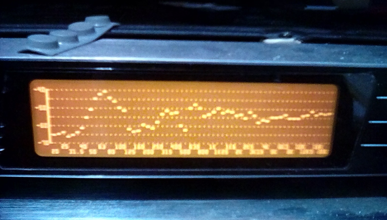

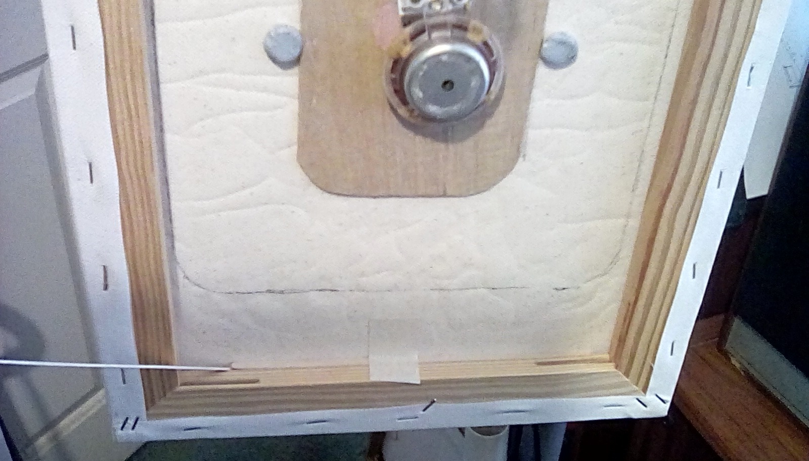

While the eps was drying, I thought I would try a way of improving the art panel .
In the first picture I inserted a strip of wood in the top and bottom to reduce the size of the open canvas.
This reduces the area so that the inner ply panel is 10cm from the outer edges.
The second picture is the plot without the strips of wood at 3m distance
The third is with the strips of wood, note the higher bass peak, but the panel handles this better .
The problem is the suckout in the 100hz to 300hz.
I was wondering if a larger ply panel was used , one that reaches down to 100hz before attaching to the canvas ?
This is getting very close to a ply panel with a roll surround ?

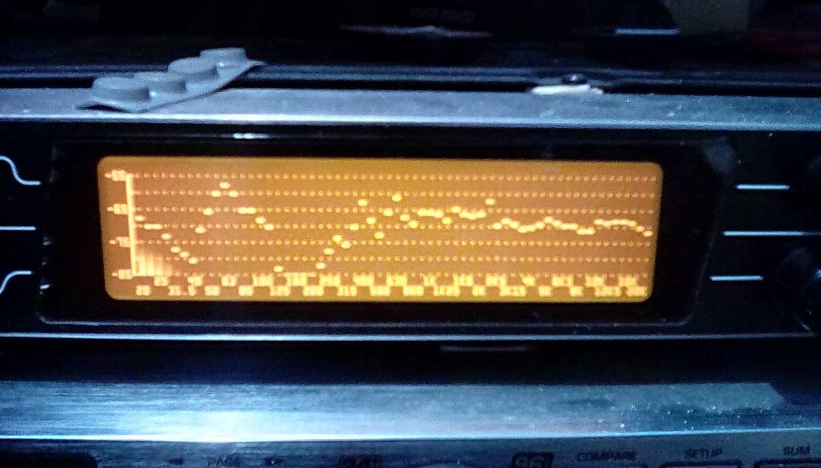

The fourth picture is of the panel with the strips at a distance of 30cm.

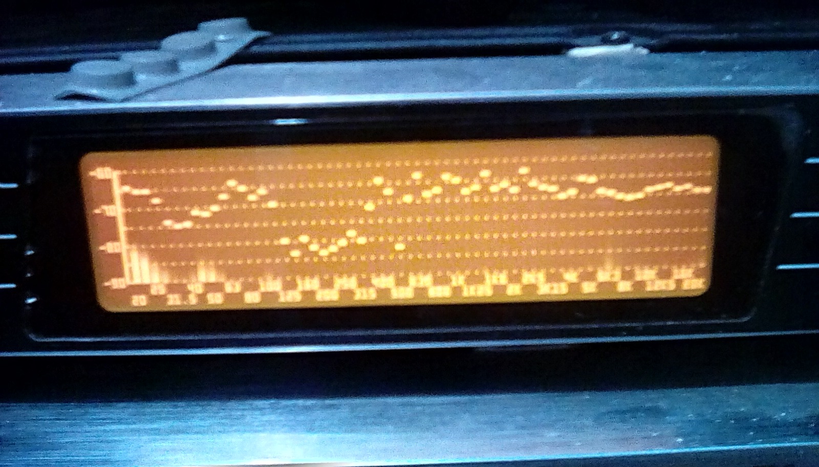

The fifth picture is of my low grade 70grade eps panel at 30cm ,it looks like the glue has dried some more , as the peak at about 13k is now much stronger.
I will be dealing with this problem later.
It does not show a suck out problem at 30cm but at 3m it will.
Steve.
Steve.

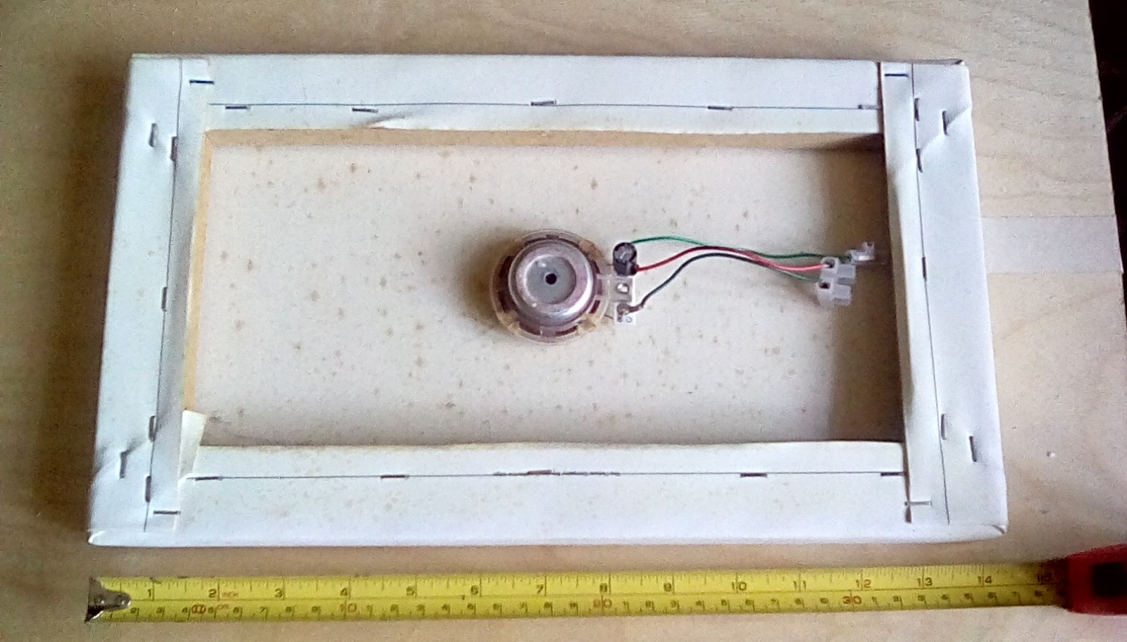

This is a 14inch by 8inch art panel that my wife says is too old and asked me to take down.
I've had my eye on this for some time.
I was going to glue a larger ply panel to this panel and see if I could increase the response in the 100hz to 300hz area.
but I do not have that size ply at the moment, so I decided to just quickly glue on an exciter.
5 minutes later and it was done, it's that quick.
I will wait till tonight before listening or maybe tomorrow just to be on the safe side , not sure I can wait that long .
I'm expecting a similar low end response as my larger art panel without ply, which is about 300hz or so I think ?
We shall see.
I might even see if it can go on a wall as the low end will already be restricted ?
At some time I do intend to try a larger ply panel on one of my art panels ,but first I must make sure the panel on its own , goes down to at least 120hz before serious roll off, at 1m let's say ?
If nothing else, it should be interesting.
Steve
