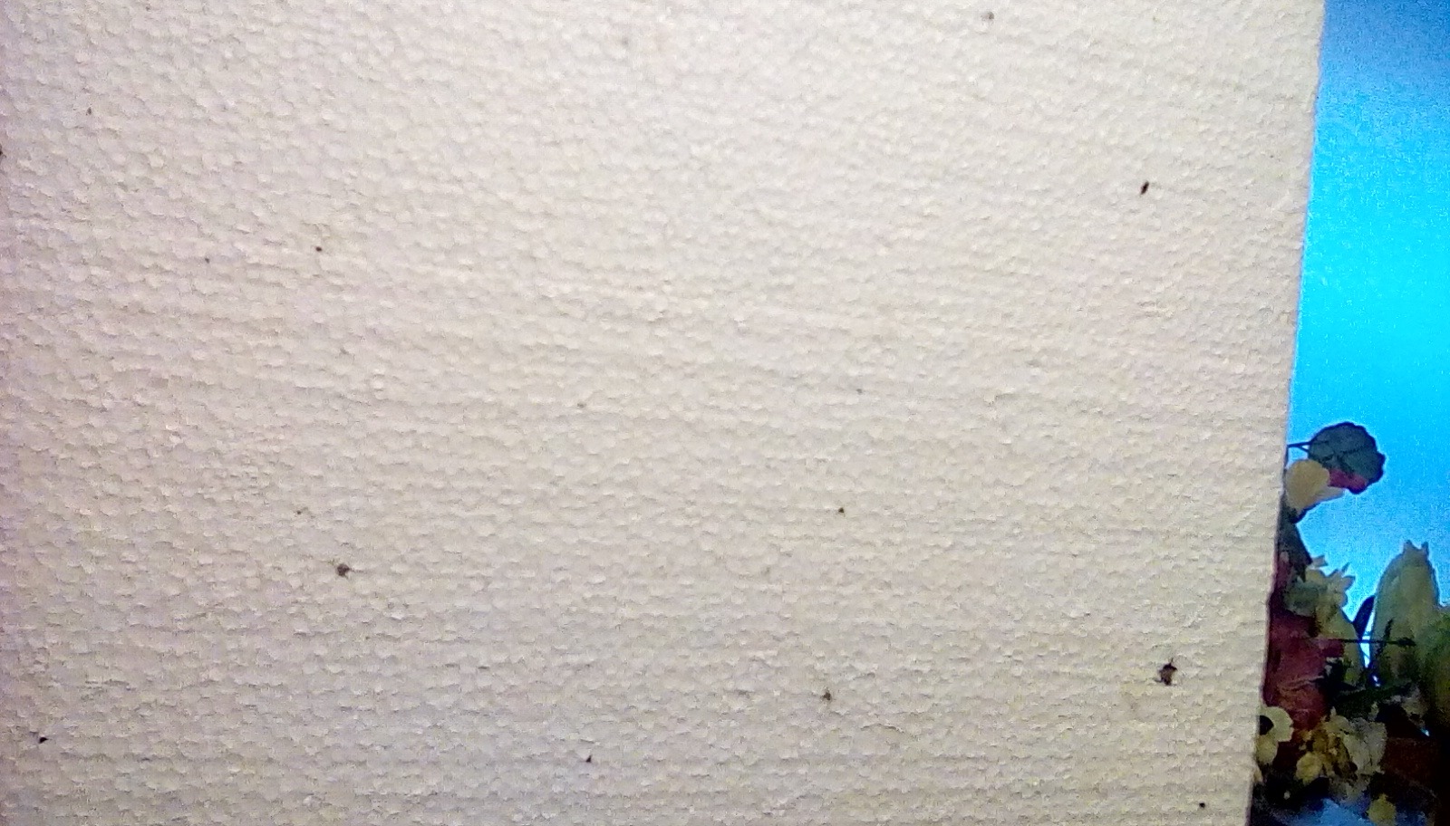

do your panels have the hard melted eps surface or are they smooth and soft without a skin ?
If they are smooth and soft without a hard skin ,there is no need to sand them .

No streaks. I do think he moulds the plates directly into the correct size, and doesn't cut with wire. Not sure if I would classify the scratch sound as hard and brittle really, and sounds the same if I scratch on an exposed area where some of the surface is gone.Leob.
If it was cut with a hot wire it would look like this picture, probably with streeks in it ?
And if you scratch it with your finger nails , is it hard and brittle sounding ?

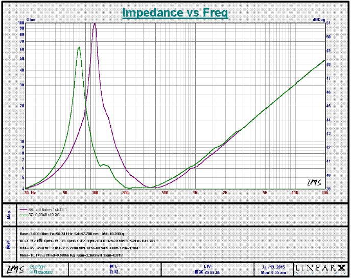

I had a look to your exciters (this link : https://www.alibaba.com/product-detail/50-100W-Powerful-8ohm-Flat-Panel_1600078111958.html ?)
It is not a standard quality specification to me : no information about the force factor (BL), the voice coil mass, its inductance, no impedance curve, no FR.. do you have some documentation?
A curious point is the nominal impedance : 8Ohm @1kHz and DCR = 3.6Ohm what I interpret as a 3.6Ohm resistance and some inductance in addition so that the impedance is 8Ohm at 1kHz which sounds like that as a strong high pass filter.
Could you confirm the DC resistance?
An impedance measurement would clarify the role (or not) of the inductance. Possible with REW and a sound card.
Christian
DC resistance is 7.8 ohm. Could very well be that they forgot to change it when they copied the information from the 4 ohm sheet. It is of course a chance to buy from a less well known brand, and even if they did have graphs I don't know if I could trust them.Leob,

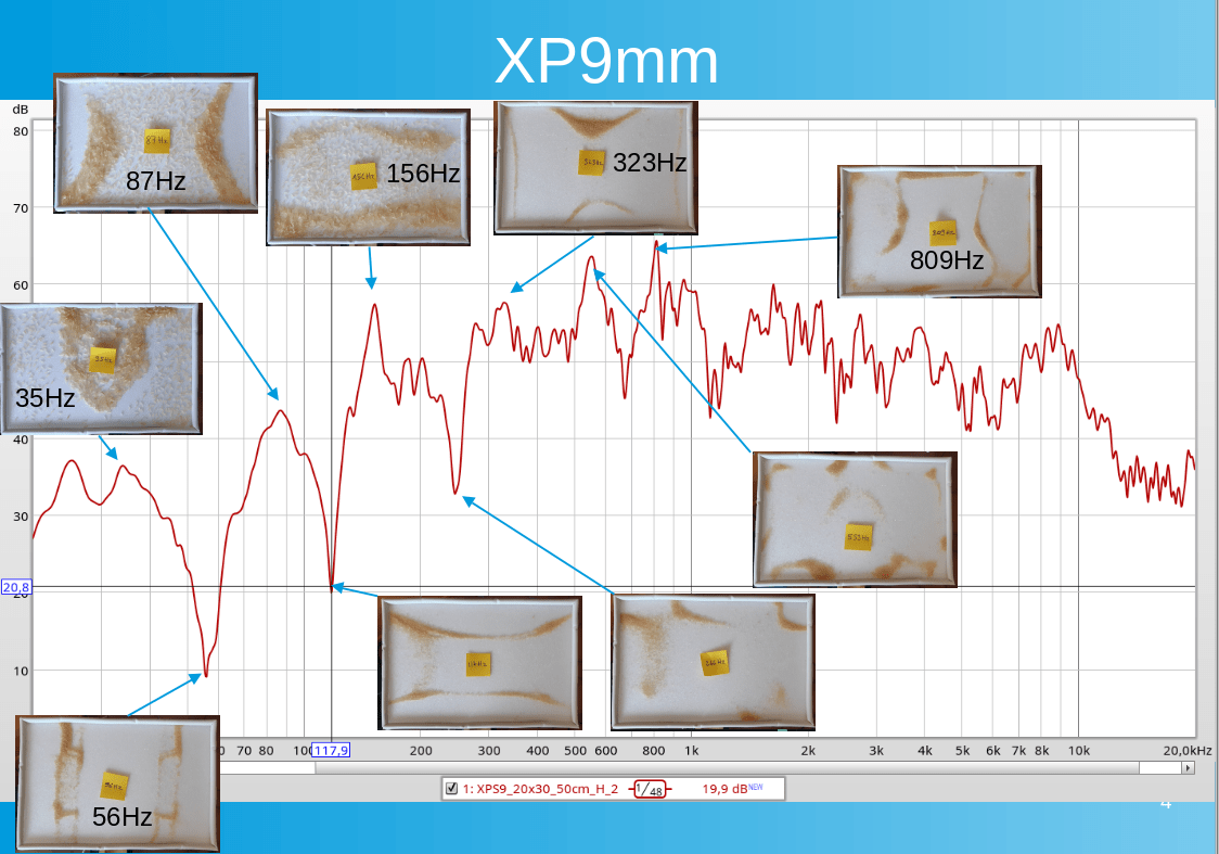

Just to share a test to see where are the nodes and the type of modes. More detail in Application of Impulse Excitation for DML Design and Analysis #48.
In the family of the basic tests, this one shows that some modes can have mechanical vibrations with no sound
It shows also that the humps in the hundreds hertz are linked to modes or combination of modes.
Need further investigations but promising

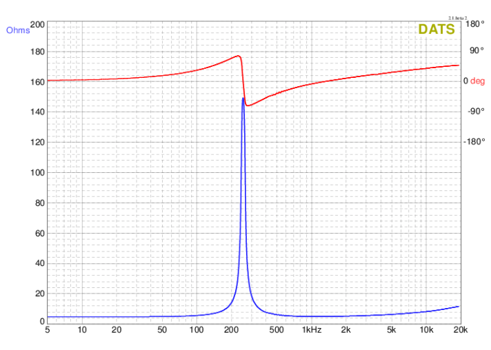

Would yours be more this one which is 8Ohm? RMD003215K02-BS
The hypothesis of a too high inductance seems serious.
The impedance graph of this exciter says 50Ohm @20kHz so something like 0.4mH for the 4Ohm, 95Ohm @20kHz for the 8Ohm so 0.8mH. In both cases this produces a Low Pass filter at 1.6kHz.
I wrote it before : my criteria to choose the DAEX25FHE-4 was low moving mass, high BL, low inductance. It was not clear for me but the idea was not to comprise the HF. Its inductance is given for 0.1mH which is not so low if we think in low pass words giving a cutoff at about 6.4kHz or something like 15Ohm @20kHz (4Ohm DC)
