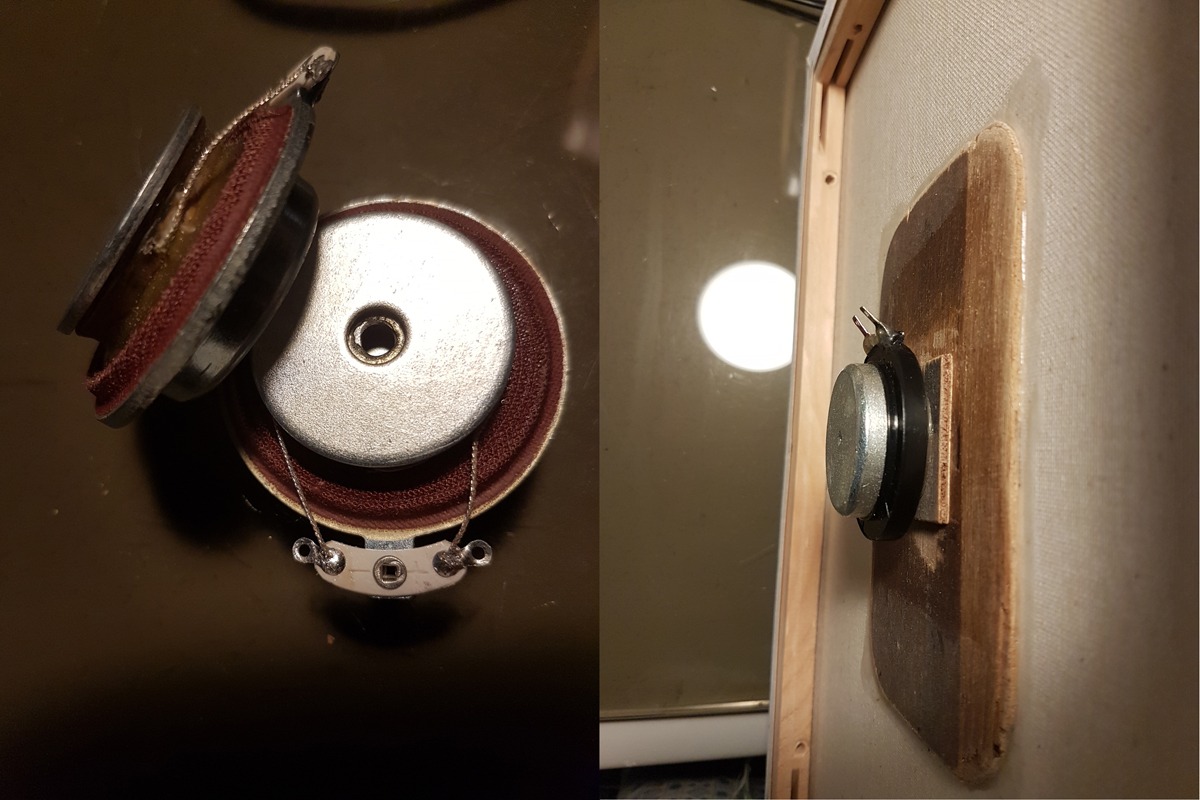

Hi first post here. Want to share my exciter attachment method. Sorry for my English.
My DML journey started from the youtube videos, I tried the XPS DML and felt quite disappointing. I was impressed by the soundstage but not the tone. I tried surface sanding, round corners and different panel size and exciter position. But the sound still like a toy.
So I've gave up this project and thought it's just another hype train.
Then I visited this forum and thanks for all you guys I pick up the dusty exciter attached on a piece of EPS. I can't believe what I'm hearing! The sound is so smooth and premium. I'm not expect this big different because the EPS seems cheap, or cheaper then the XPS.
So I retry the XPS again and sure that is not a settings problem. EPS sound really far better then XPS.
I further try the canvas and polywood and love the sound also. However I always feel suffered by the exciter attachment process.
Double sides tape is not the way because you don't know when it loose. PVA is great but difficult to remove and caused quite a damage on the material. So I used hot gun...... until I got this exciter (pic 1).

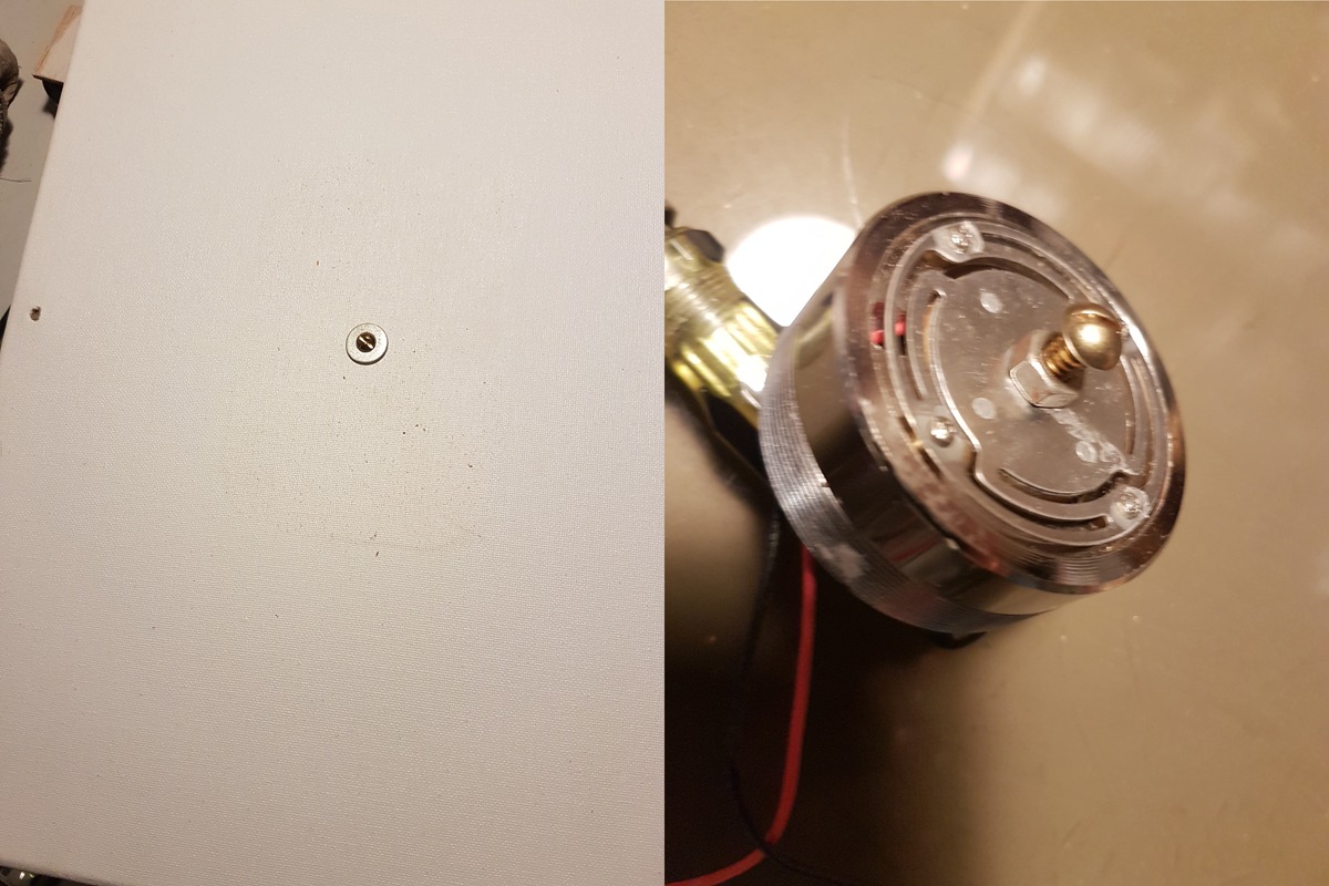

This exciter has 2 parts, the exciter body and the attaching disk. I can bolt the disk to the panel using 3 bolts. Then joint the exciter to the disk. No glue no damage anymore.
Then I further think can I bolt the exciter on the panel without the disk? So I find a bolt the size fit the exciter center hole. And attach the exciter with one bolt and a metal washer (pic 2). It works really good! Now I can attach the exciter on any panels just by one center hole drilling.

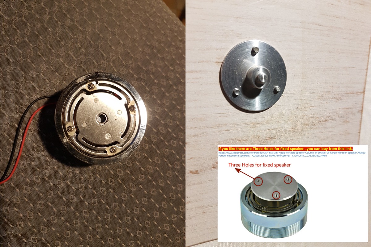

Step further I'm thinking apply this system to other "normal" exciters (pic 3).

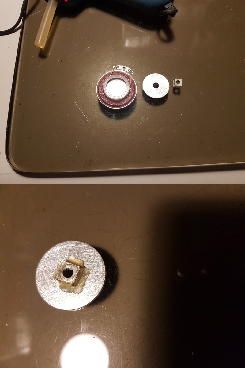

I find a metal washer with the similar size as the exciter ring. Then Glue a nut on the washer's inner surface. Then glue the washer onto the exciter's ring.
Now I can attach any exciters on any panels under the same system within seconds!
You can see the pic 4 right side I used a piece of polywood square instead of metal washer, if you can't find the right size washer.

This was my suggested mounting method for the Aiyima exciter, hopefully for a better sounding performance ?
Do you have any measurements of the difference in performance of the two mounting methods ?
And any idea of the art panels performance with this exciter ?
Steve.
Hi Steve.
Sorry I have no measure tools, just my humble ears.
I didn't find much sound different between 2 metholds. But the bolt methods sometimes will cause noise if the washer not fully attach flat and tight on the panel. On some case the panel material surface not smooth and flat, then I will add one nut between the washer and panel. Smaller attach area will solve the problem. But have to prepare a longer bolt for this extra nut.
The Aiyima (local branded as iLouder) 50mm exciter not suitable for canvas. Because it's too heavy (268g each). It act like a heavy damping on the canvas center. This largely affact the efficiency and sounds dull. I just use it on polywood. Which has the best natural timbre and smoothness sound.
Now I use 3 different model of exciters. The iLouder 10W I think is similar as yours. And also a PUI Audio 20W.
All 3 DOES has sound different on a same panel.
The 10W works best with EPS, they match the speed! But the timbre is not quite natural. Not good for acoustic music.
The PUI sound best on the canvas. And has the most holographic 3D imaging.

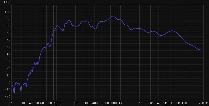

Done some prints with GreenTec Pro Carbon (https://www.extrudr.com/en/products/catalogue/greentec-pro-carbon_2410/), and it is definitely an improvement over the BioFusion and PLA.
And with 0.2mm skins over honeycomb they seems to actually become quite sensitive. For example when getting 84 dB on the polycarbonate panel with my uncalibrated measuring mic, same signal to a carbon panel gave 92 dB. I also found a piece of 4mm plywood, and it was somewhere between in loudness.
Conclusions from initial listening is that sound is more focused than both the PC and plywood. However I would also say it is a little bit less open and more boxy. Overall I prefer it of the materials I tried so far. Despite being smaller plate than PC and ply, they can be driven harder it seems before bass start breaking them up.
Analysis of FR confirm a peak around 700 Hz, and quite unsmooth response in general.
Top end also drops off, but less than with PLA or BioFusion.
I will do a proper post eventually with graphs measured at consistent distance comparing the different materials I have at hand as well as some more optimized prints.
What I wanted to get a sense of for now if is the printed carbon seems viable at all, and indeed it seems to be able to produce good sound as well being sensitive. I still have some tweaking to do since I noticed significant differences when it comes to overall thickness, honeycomb density and skin thickness. Both when it comes to sound quality and sensitivity. Also been modifying the ratio to even out the peaks in FR. I do like to maximize the surface area, but the small size seems to create strong modes in the low mid, and using the same ratio as Tectonic on the DML500 makes for a smoother response than the 94% ratio I tried initially by spreading them out a bit.
Still trying to find some XPS to try out, but seems like I have to buy in bulk or manage to cut from thick boards. For those of you having success with EPS, what hardness do you have? Here we have EPS 80, EPS 100, XPS 300 etc which signifies how much pressure it can handle, not sure if that is a worldwide standard?
For fastening the hairspray seemed to work really well. It was about as hard to remove as the PVA gluestick I used before, and held up my 200g exciter shaking like crazy without support for a couple of days without issue. Will try it again to see how it affect FR, but now got a roll of 3M 9088 that been working great. It can also hold my 200g exciters without problem and my impression is that HF response is as good or better than with stock adhesive, but haven't got any measurements to back that up yet. Although the hairspray dries quickly, when moving them a lot for testing I still like the speed of using tape.
