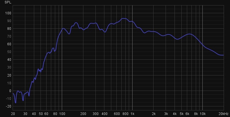

Hello LeobDone some prints with GreenTec Pro Carbon (https://www.extrudr.com/en/products/catalogue/greentec-pro-carbon_2410/), and it is definitely an improvement over the BioFusion and PLA.
And with 0.2mm skins over honeycomb they seems to actually become quite sensitive. For example when getting 84 dB on the polycarbonate panel with my uncalibrated measuring mic, same signal to a carbon panel gave 92 dB. I also found a piece of 4mm plywood, and it was somewhere between in loudness.
Conclusions from initial listening is that sound is more focused than both the PC and plywood. However I would also say it is a little bit less open and more boxy. Overall I prefer it of the materials I tried so far. Despite being smaller plate than PC and ply, they can be driven harder it seems before bass start breaking them up.
Analysis of FR confirm a peak around 700 Hz, and quite unsmooth response in general.
Top end also drops off, but less than with PLA or BioFusion.
I will do a proper post eventually with graphs measured at consistent distance comparing the different materials I have at hand as well as some more optimized prints.
What I wanted to get a sense of for now if is the printed carbon seems viable at all, and indeed it seems to be able to produce good sound as well being sensitive. I still have some tweaking to do since I noticed significant differences when it comes to overall thickness, honeycomb density and skin thickness. Both when it comes to sound quality and sensitivity. Also been modifying the ratio to even out the peaks in FR. I do like to maximize the surface area, but the small size seems to create strong modes in the low mid, and using the same ratio as Tectonic on the DML500 makes for a smoother response than the 94% ratio I tried initially by spreading them out a bit.
Still trying to find some XPS to try out, but seems like I have to buy in bulk or manage to cut from thick boards. For those of you having success with EPS, what hardness do you have? Here we have EPS 80, EPS 100, XPS 300 etc which signifies how much pressure it can handle, not sure if that is a worldwide standard?
For fastening the hairspray seemed to work really well. It was about as hard to remove as the PVA gluestick I used before, and held up my 200g exciter shaking like crazy without support for a couple of days without issue. Will try it again to see how it affect FR, but now got a roll of 3M 9088 that been working great. It can also hold my 200g exciters without problem and my impression is that HF response is as good or better than with stock adhesive, but haven't got any measurements to back that up yet. Although the hairspray dries quickly, when moving them a lot for testing I still like the speed of using tape.
You are going fast with this unusual technique for DML. 8dB above acrylic is a good result.
The FR has common points with other FR shared here. The bass extension is good. There is a loss of level from 2k to 8k we have with different materials. It will be interesting to have the opinion of other DML builders about the peak at 700Hz. Is there a possibility of an effect of the boundaries like a rear wall that might increased some characteristics?
To have a side some plywood is a good idea : the plywood can give a smooth response with a good high frequency extension. So even if it is not your target it is a good support for comparison. As you did for efficiency or to check if the exciter mounting technique is good.
The key point in my opinion is to understand if it is possible to increase the level above 10k.
For the PS, what I remember from previous posts is to find 30kg/m³ density. Here (France) in DIY store is it quite easy to find XPS of that density in 20mm thickness but I was not satisfy with the result. I haven't found easily EPS of this density. I have 20mm thick EPS 15kg/m³ which seems not work well.
I think the spectral contamination test (see #4656) is interesting to evaluate the quality of a material. Really easy to do.
Christian

Thanks for the input Christian. Will include spectral contamination test when I do a proper comparison.Hello Leob

Yes, room is small and untreated, and it is a cheap uncalibrated mic. Most issues in the room are around 300-400hz though and the peak around 700 I have only seen in this panel. This is a 295x205mm plate, and with 295x273mm the peak was around 300-400hz instead, but with larger peaks and dips in low mids in general. I'm guessing that the peak at 700Hz is the resonance of the short side, which before was placed very close to the peak of the long side making the response less smooth.
About the FR, I agree that the only major issue is really above 10k. I don't want overly bright sound and, and if I EQ out the peaks in the low mids the overall response is just about right...apart from above 10k which would require much more heavy handed EQ to fix.
It also seems like when attempting to improve efficiency by having as thin skins and sparse and thin honeycomb, what happens is that I get stronger mids, but not much stronger treble. Sounds like the plate resonates more, but mostly in the mid to low frequencies, resulting in stronger mid peaks.
So if I go with printed probably I need to be mixing with other materials in different plates to get an overall nicer response. Or do like in the PL11 and use ribbon tweeters, but I rather not.

Hello Leob,Thanks for the input Christian. Will include spectral contamination test when I do a proper comparison.
A cheap mic is not by itself a problem. The question is more the knowledge of the complete measurement chain performance. I use 2 kind of mics : one Umik1 (it performance is known) and cheap omni electrets with a Zoom H1n hand recorder. I know this second chain has a limit in high frequency compare to the Umik. It is in my plan to investigate the reason but not done. In case of mic input in some devices like phones, it might be not easy to disconnect the different filters. For test you can build a resistive divider to input a signal and check for attenuation. See for exemple Audio loopback dongle .
Your panels show in a certain way the same incredible quality of the DML that we have with a 41x33cm canvas panel which is the possibility to go quite low without enclosure.
This reminds me my canvas have also an unexplained peak at about 300Hz... not as high as yours but nevertheless present. Your hypothesis about the role of the dimensions is interesting. I tried to investigate in this way by baffling my canvas panel (some important surface all around) but I have found nothing...
About the FR correction by EQ I agree even if I haven't tested it yet. If you have the possibility, check also the spectrogram in parallel of the FR to see when in time, a peak appears. When it is close to time zero, probably no problem for EQ. Later, additional investigation probably needed.
With plain membrane, I am in the opinion (meaning I have no proof and no experience of honycomb) for now that the HF behavior is a characteristic of the material by itself. I plan to try to investigate around the frequency absorbtion. Spedge wrote several time that the frequencies are not spread the same across the panel according to the material.
One big quality of DML is the possibility (even if difficult to reach) to be a wide band loudspeaker so I don't like the idea of a tweeter which might not go well with the DML because of important dispersion differences.
Christian
For now, I don't know a (direc ?t) link between efficiency and treble response. The efficiency is driven by the bending stiffness, the density, the capacity of the xciter to transform the current in force. Some papers show a high frequency filter between the voice coil mass and the panel mechanical impedance but I was not able to have evidence of that... I have in fact evidences going the opposite : cardboard with a low mechanichal impedance and a good HF extension, small thickness acrylic with a high impedance but a lack of treble. Hmm?Actually, one thing that strikes me is that the trade-off between efficiency and treble response I suspect from my printing experiment could explain the differences in sensitivity between the PL12 and DLM500. With the DML500 they are not using a ribbon tweeter, perhaps sacrificing sensitivity for better response so they can use only DML.
Christian

I guess what I'm saying is there is still a lot to experiment with rather than write off.
I should also clarify my goals....I am not looking for a "warm" speaker. I want precision on the voice range with enough clear treble to not need a separate tweeter and I'll run a powered subwoofer at 180 crossover (because that's as high as mine goes). I'm more interested in avoiding distortion and hot frequencies than I am in output levels. I'll be using them with my 84 inch TV in a rather smallish and oddly shaped space that is hard to treat. There is a fireplace on one side and an open wall to a larger room on the opposite side with a kitchen behind it...clarity and management of bad room dynamics is part of the draw, hence wanting to avoid a separate tweeter.
- Full Range
- A Study of DMLs as a Full Range Speaker
