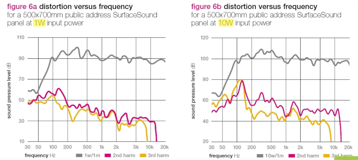

Actually to be specific, as I understand sensitivity is typically measured as 1w at 1m. Efficiency is a bit harder to measure, but they do go through in to it in one of the videos. To measure efficiency you would need to measure lots of different points in a sphere around the speaker. Obviously a DML becomes far superior when it comes to efficiency, however it is both complicated to measure and although sensitivity ignores what is a big advantage of DML, efficiency is is typically not so useful to measure either since usually one cannot really make any good use of the sound radiated backwards.
So maybe no need to measure the whole sphere around the speaker to get the true efficiency, but certainly more than one location needs to be measured to give a good idea about the performance of a DML.
Just got a measuring mic and carbon filament, so gonna do some experimentation!
Don't have a SPL meter to calibrate against, and not sure how to calibrate against a known speaker. Are you thinking to it based on their sensitivity rating? Unfortunately I cannot find a rating for the speakers I have.

I would say that to get a practical efficiency it would depend on the application what you should measure.
There are some applications where 360 degrees of dispersion are desirable........ I am in the middle of building a PE Executive kit and I kind of want to do a DML + OB setup instead since I will be using it outside. Getting the same sound all over my yard as I chase my kids around would be nice.
I think 1 measurement on axis is OK for comparative purposes though. Yes DMLs have better dispersion but I imagine many of us are listening from fixed positions. So the W/SPL at that point is the main thing from a practical standpoint.

Typically you have a room with seating positions in front of speakers or a crowd in the middle between speakers, but for installations and sparsely populated spaces it might be a nice idea sometimes.
We always surround the dancefloor with speaker stacks, so in your example say you either have a square of panels in the middle or one in each corner of the dancefloor. If you ware in the middle of the dancefloor surrounded by stacks you would have 4 panels directed at you 100m away from each direction the way we set them up. If speakers are in the middle instead and you are at the edge of the dancefloor you will have a lump of panels from one direction, also 100 m away.
This is one of the reasons that I really like to try making DML PA...most audio pros will frown at using multiple speakers pointed at each other due to the inconsistent sound over the dancefloor with phase and timing issues, but I think it is worth having four stacks for the immersive experience anyway. DML not only provides more immersive sound in general, but also seems better suited for that kind of setup.

LeobWas watching some Tectonic videos, and found some interesting parts:
First you can see him handling one of their actual plates in the very beginning. Hard to tell if it is 2mm or 3.4mm thick nomex, but not thinner than 2mm I would say.
Also they claim 104dB sensitivity!
That is insanely high and some 10dB higher than I expected. I'm not expecting a home made panel to equal theirs in sensitivity, but with those figures, even if I can get half the sensitivity (101dB) I would be more than happy.
Also I think in part two of that video they mention challenges creating a 100w exciter, so it seems like indeed they do have some extra powerful exciters they reserved for their own products.
