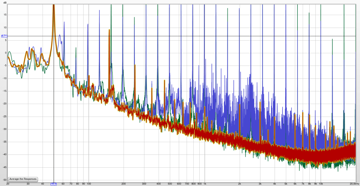

Today, I made a quick experiment with a 5mm XPS with 2 Kraft paper skins glued with watered PVA. No hope to find the holy grail just the possibility to collect data and see how it fits in the overall picture.
In addition, as I applied the PVA on the XPS, the paper got some wrinckle. Poor realization quality.
The panel was 20x60cm.
I will be able to use the information about the efficiency in one week. No balance at hand here...

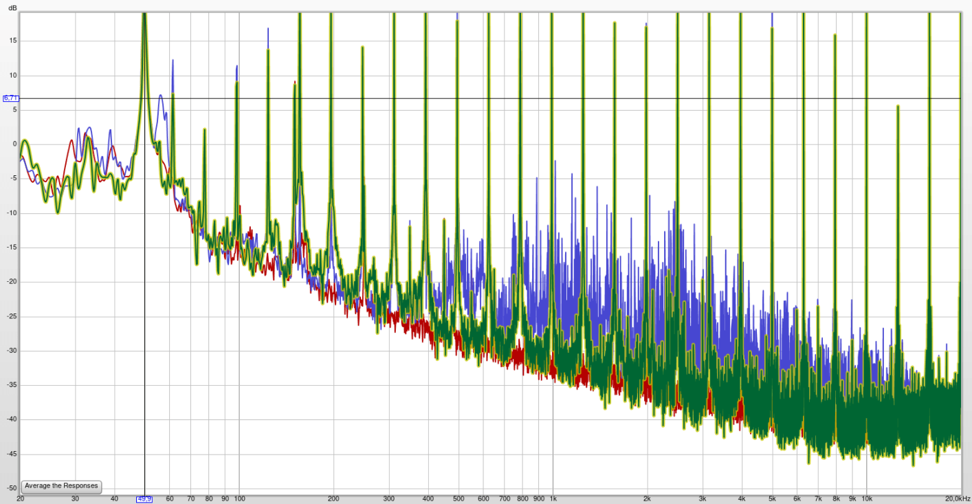

Here are 2 other measurements.
The spectral contamination. The worst of all!
blue in background is the panel under test, red the noise floor, green a Visaton FRS8 as reference.
This test really easy to do seems good to assess objectively of the material quality

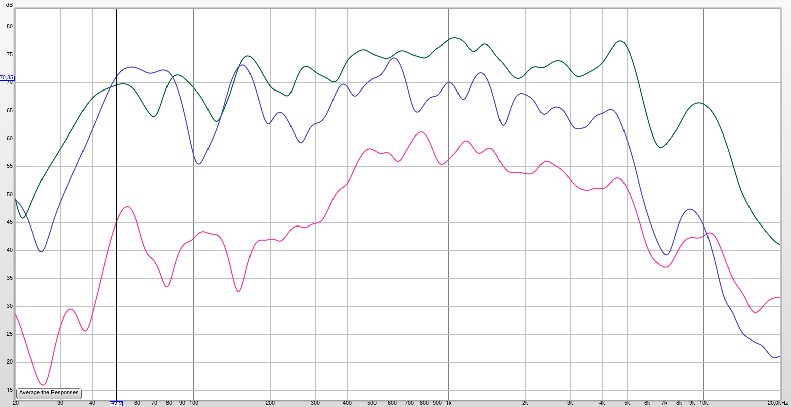

A look to the FR
red is at 1.5m, green is at proximity of the exciter, blue is at proximity of the membrane 20cm from the exciter. I can't say the distance from the panel is the same for the 2 proximity measurements.
Some quick observations :
A look to the FR
- Both proximity points show low frequencies that are not at distance. It was already seen. The previous panels measured outdoor show an increase in low frequency compare to indoor. So there is a mechanism of the front and rear waves recombination for which I have no theoretical model. Does somebody have?
- The slow decrease from 1.5k in this case seems resulting of the increase of loss at distance from the exciter
- At higher frequency, the loss at distance is even higher.

I tried to show the plot of the spike from the rear vent but it was being swamped by the wide band noise coming from the exciter.
which looked very similar to your spectral contamination in blue on the plots you posted ?
with small panels ,you do not have a large barrier(the panel) blocking the airborne radiation from the back of the exciter.
So this sound is easily heard.
with large panels you may only hear the reflections from the rear wall ?
but these noises (distortions) will also come though the panels ,how much, depending on the type of panel used.
And of course these same distortions will be transmitted through the coil former to be radiated by the panel itself.
we have to make a distinction between panel noise and exciter noise .

The treble level is incredibly (unbelievable?) high. Does somebody else knows this level of trebel for acrylic? Something wrong in the set up like a control on?
Christian.
The acrylic is easier to drive in the high frequencies than in the lower frequencies.
Some panels have a downward sloping response to the high frequencies.
This panel has an upward sloping response.
Some panels have a hump in the mid frequencies.
Steve.
