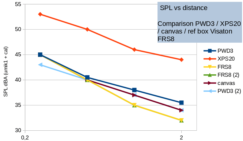

I don't remember if it was mentioned before but one interesting characteristic of DML is the level decreases with the distance more slowly than with a cone... at least in a living room. I have line arrays and it is about the same : -3db when doubling the distance compare to -6dB. Probably DML are better to that than line array because there is not the problem of comb filtering, interference because of the distance between the cones. the condition is probably to have only one panel with several exciters close to each other.
Below : SPL vs distance (up to 2m) yellow and green are standard loudspeaker (FRS8). the other are panels.

Can I ask, what signal did you use for that graph?
It makes sense that if you measure right in front of a speaker, the SPL is a result of the travel of the cone or panel. So if the cone moves 1mm at 1khz and the panel does the same, the SPL will never be higher on the panel due to a larger surface. But even if the waves are not stronger there will be more of them, resulting in more air moved even if the compression of the waves are the same.
The drop-off at 2 meters looks like around 8dB for XPS20 and 13dB for the FRS8. 5dB is a massive difference over a still relatively short distance!
Outdoors with a big area with many people, the effect visible in that graph will probably be multiplied many times.
I'm also interested in DML for home use, but I guess it can hard to quantify the effect of reducing the panel size. There I care more about perhaps relatively small differences in the perception than the loudness. If one want to feel like one is bathing in sound, perhaps a larger panel will help? Until I get some XPS to do my own experiments I'm just speculating, but my guess is that the smaller you go the more like a cone it will sound? My 500x400 PC panels certainly sound larger than my 300x300 printed, even if the printed sounds tighter and louder, but of course that is probably mostly due to the materials.
What is quantifiable and seems clear from your graphs over different size panels is that the small panels has a more jagged FR, so one would think they would sound a bit worse.

Those tests were done with a pink noise probably (sorry I didn't keep note of that) with a limitation in the low frequencies to limit the possible effect of the different loudspeakers bandwith or of the room modes.
The difference in the drop-off comes from the different nature of the loudspeakers. A DML behaves more like a line array. It is interesting because for a given listening level, a lower power is needed.
I should have perhaps made a measurement at 3m in addition (this living room is relatively small) to show the level in far field.
I have no experience of outdoor acoustics but my understanding of those curves is they are linked to how the pressure wave expand (spheric expansion for a true point source) this linked to the nature of the source. No link with the space or how it is occupied? This should be checked...
About the dimension of the panel, a bigger panel for a given material, a given thickness, will have a lower first mode so a higher mode density after which is good for the smoothness of the FR. With a bigger panel, the waves travel for a longer distance so get a higher attenuation before reflection. It might help in the smoothness. I have no evidence of that.
But I think the first main effect of the dimensions is on the bandwidth in the low frequencies which is visible on the plots. The smallest panel has the shortest bandwidth. For now, I have no good idea of the mechanism behind.

Some posts ago, we have spoken about an unused data from the Tectonic panels : the efficiency. With the heuristic proposed in post 4682 (efficiency = 83 + 5.log10(D/µ³) ), 91dB is a D/µ³=40
So to keep simple values : µ=0.5kg/m², D=10N.m give fc = 5800Hz, A.fo = 8Hz.m², D/µ³=40. For a 378x478mm area, f0 = 44Hz and 90g for one membrane and if I remember, the thickness is said to be 3mm in a video.
Christian
