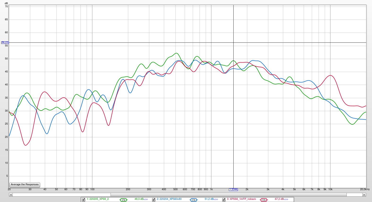

I had the possibility of some tests this afternoon.

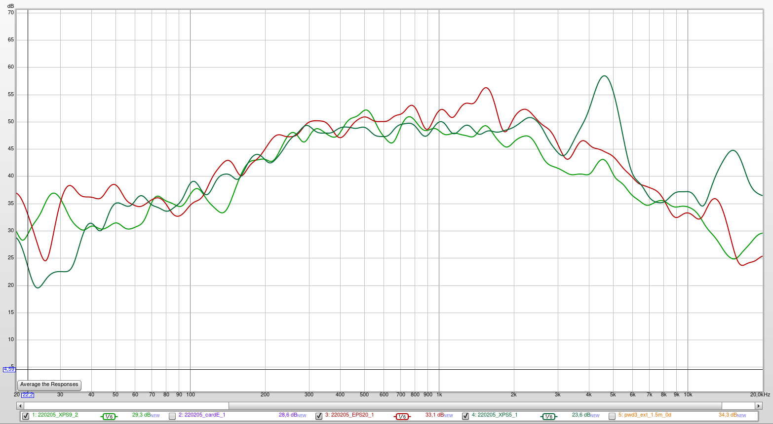

First part of the tests : adding some damping or mass at the center of my canvas panel.
See below
1- red : the original canvas (with the peak 40dB@10kHz)
2 - green : with a self adhesive disk of felt (20mm diameter to put under legs of chairs)
3 - light blue : the felt plus a small ball of blue tack (or similar)
4 - brown (+15dB offset) : only the small ball
5 - dark blue (-15dB) : a small 1.2l closed box with a Visaton FRS8 at the same position in the room than the canvas (as a sort of reference)
My conclusion at this time :
So next step will be to have this while the canvas are playing. I am afraid the peaks before mask the effect.
Additional information (it is part of the goal of those tests) : there is a gain of +4 or +5dB in SPL in favor of the canvas compare to the FRS8 (which is said for 82dB@1m). No change of volume setting during the test. The mic here was at about 2.2m from the speaker so a little bit in front of the listening position.
Christian

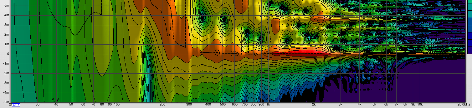

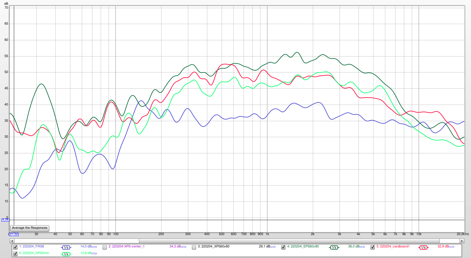

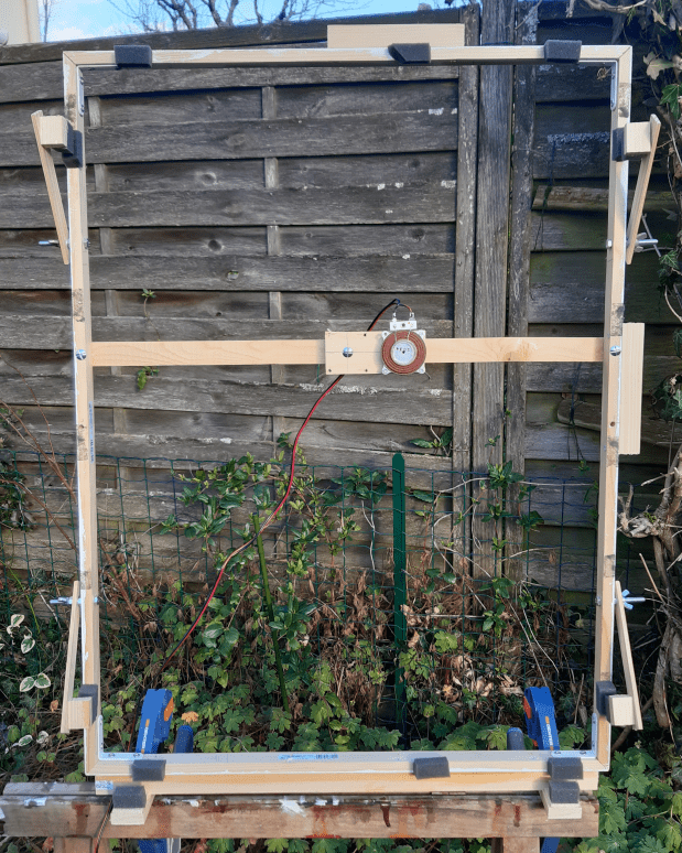

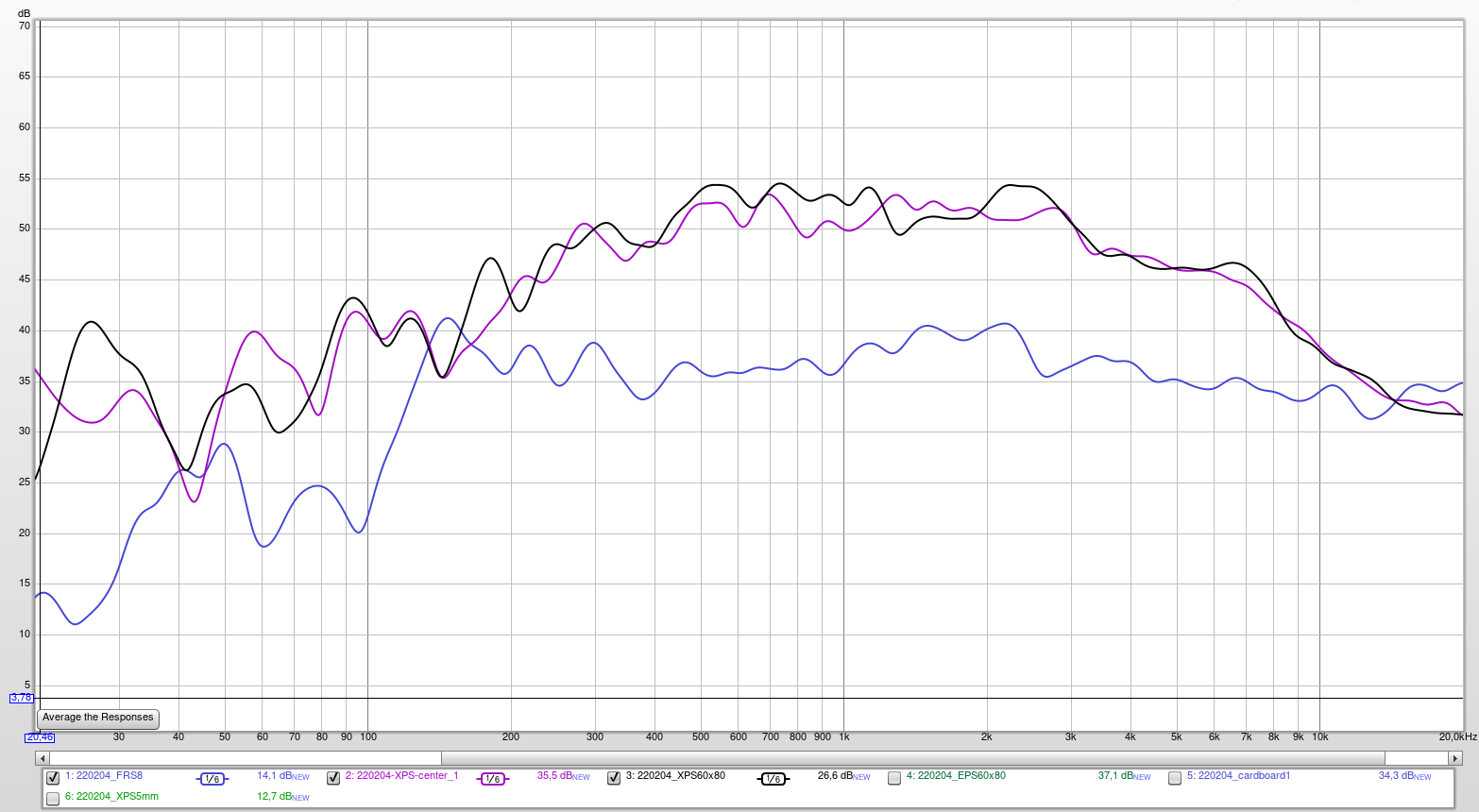

Second part of the today measurements... for those one help and advice welcome!
For that I have adapted a 60x80cm frame built some month ago and not used in order to have the possibility to easily change the panel to test different materials and different exciter positions and other things...
As starting point, I choose the 9mm XPS which made my second pair of panels and was a failure. So first goal is to try to understand why it is a failure (if possible).
One characteristic of this panel was to have the exciter right on the center. So today, I tested :
1 - pink : exciter at the center. The behavior seen and heard with the prototype is confirmed. no low freq, no high freq.
2 - black : exciter at 2/5. The exciter position is not the reason. Hmm... For the high freq ok but for the low freq it would have been a nice explanation. It isn't!
3 - blue : the FRS8 has level reference. The XPS is 12 to 13 db better in efficiency.. ok on a small band.
Somebody has an idea?
I am not sure it is the same XPS than the one coming in 20mm thick and larger panel. It seems more airy, like a foam. It is also shiny.

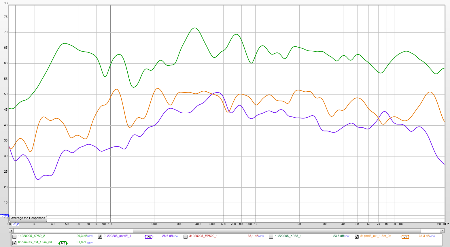

Next, I have changed the material
4 - dark green is a 20mm thick EPS (15kg/m³). No low freq, no high freq. What's happen? not expected from EPS
5 - red is a cardboard E flute (2mm thick). Well there is a small portion flat at 10k but 10dB lower than the mids; I am not used to see so important difference.
6 - light green is a 5mm XPS like the one to put under a floor. Its aerial mass is very low
3 - blue : the FRS8 has level reference. The unexpected thing is the level of the 5mm XPS. It is the lightest one and not the highest SPL. Again what's wrong?
Somebody has an idea of what happens?

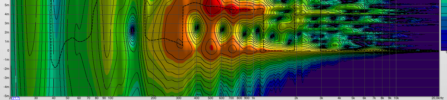

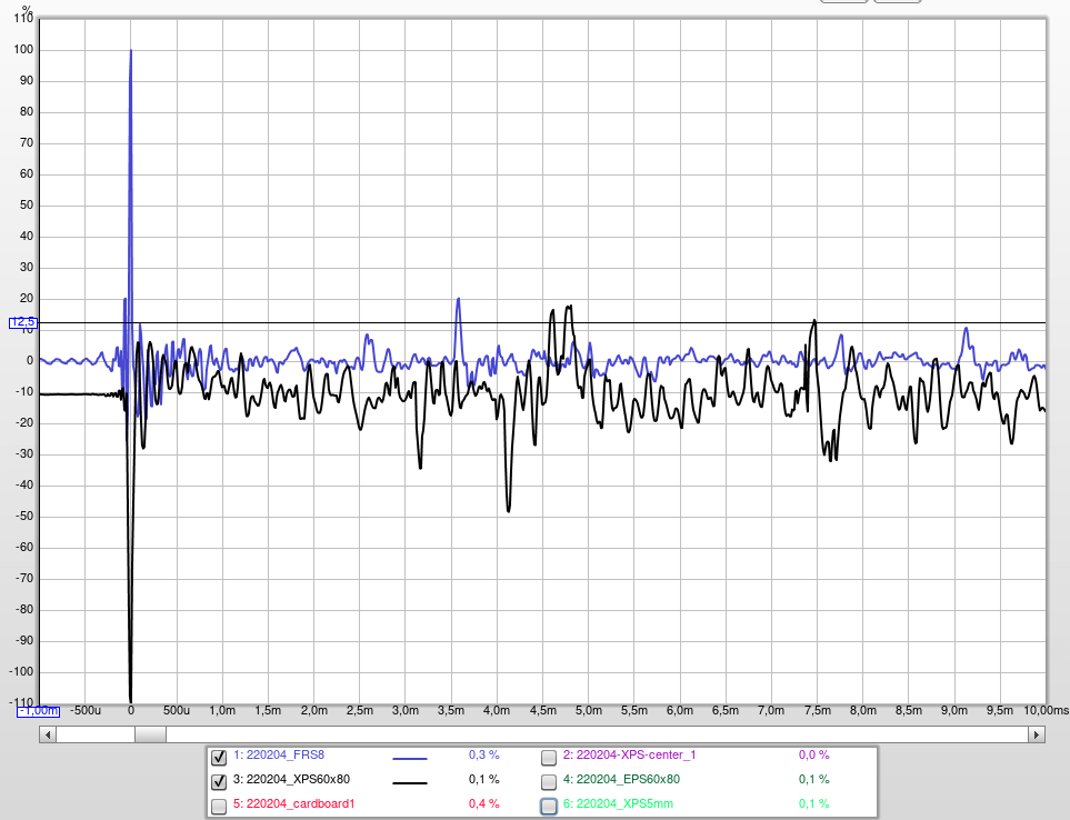

Just as a curiosity here are 2 impulses responses :
Also because it is not often share, here are 2 spectrograms ( wavelet time). I like wavelets.
The FRS8
The 9mm XPS
The level in the area 4...5ms is really high. Would it be the internal damping of the panel not high enough?
I thought to make some outdoor measurements to "eliminate" the hypothesis of room reflections but the weather was not good enough and not really the time for..; so let see next time.
Additional information : all the panels except the EPS are raw. No PVA coating. Is the coating that could make the difference? This said, the EPS FR is not really nice. When I built the prototype with the 9mm XPS, it was PVA coated... no good results.
Christian

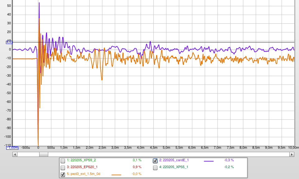

- blue : the FRS8 (Visaton cone full range); some peaks after the 2 first ms; Most probably reflections.
- black : the 9mm XPS. Typical of a DML. Many peaks for a long time. An it gives a pretty good sound; sure not this one but even the best one I know have this signature. It is reported in paper like the one from M Azima.
The FRS8
The 9mm XPS

Christian.
In answer to your post 4542 first.
You must show detailed photos of your test set up and how the panels and exciters are mounted .
If you know that the exciter you are using can output up to 20k , then by looking at the similar hf response of all the panels, I would guess that there was a problem with the way you are sticking the exciter onto the panels?
If I saw this response on one of my panels, I would think the exciter was about to fall off.

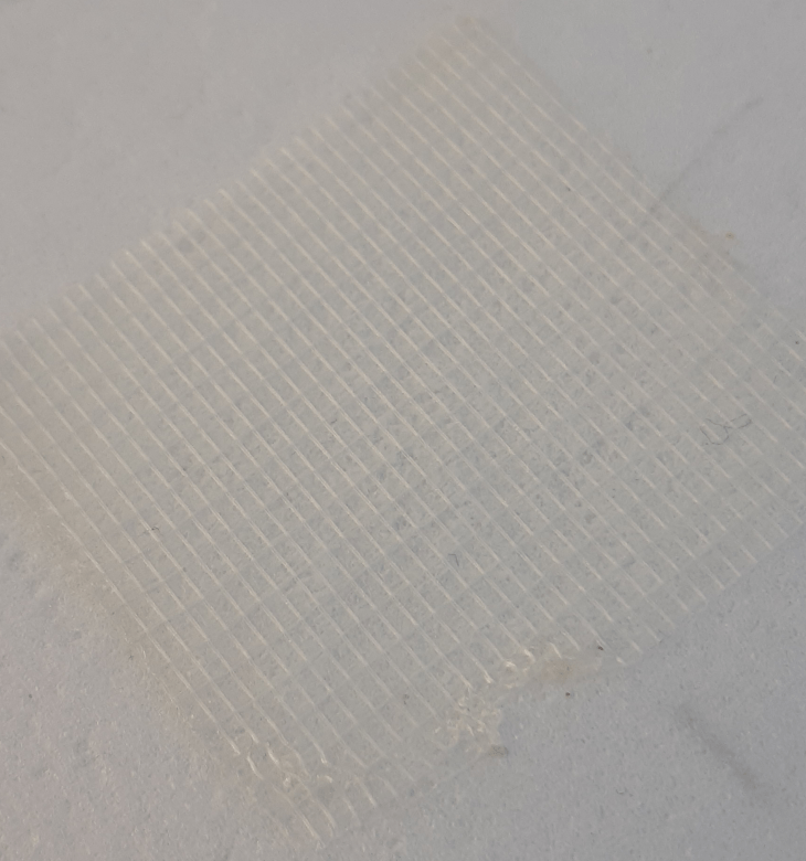

If you're using the ones that come with adhesive, I would replace it. It's a 3m product that I work with often, and it's an excellent adhesive but never cures and remains gummy and very elastic. I really don't think that would be very good for high frequencies... or at all for good conduction. Try a proper epoxy and see if that helps.I would guess that there was a problem with the way you are sticking the exciter onto the panels?
Oh yeah, and it's also a pressure sensitive adhesive that needs pressure you cannot put on a voice coil.

in response to your post 4542 .
As I would have expected the felt is trying to damp everthing.
yes it looks like there is a little too much blu-tack ,the spike has come down at about 10k and the dip at 15k is coming back up.
If you are listening with music I would recommend using female close mic recordings that have a lot of sibilance.
If you have you RTA set up at the same time ,and set for peak hold ,you can see the difference to the 10k peak has on the sibilance, which always happens at this same frequency.
The huge peak between 300hz and 400hz looks a little odd as does the roll off there after ?
And the hump in response at about 2.5k is still there.
When I first looked at the responses I hadn't read you post so i thought the lower blue line was a panel.
Which I thought was very good , but I could still see the hump in the 2.5k area, in fact very similar ?

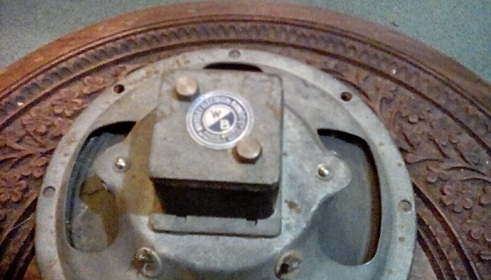

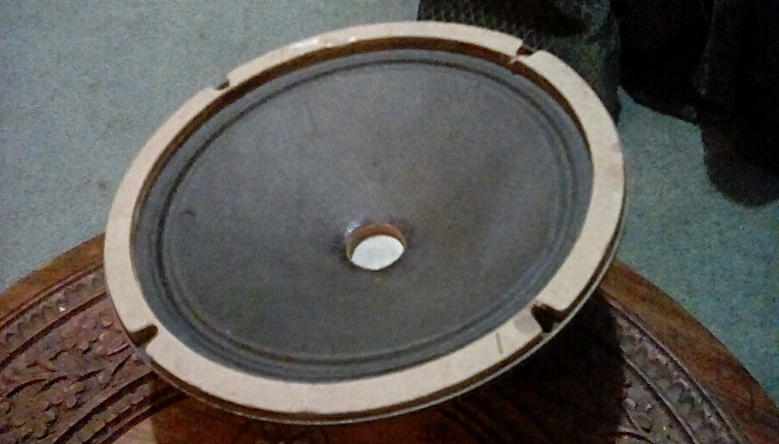

Is this the spider noise or the cavity noise or both ? From a cone driver ?

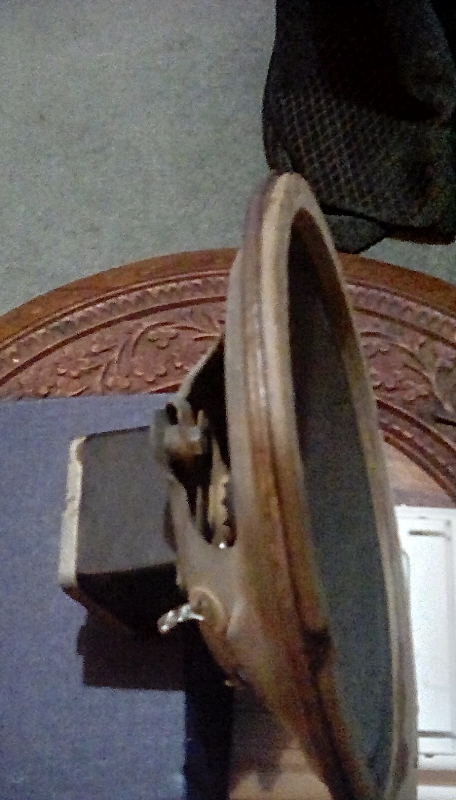

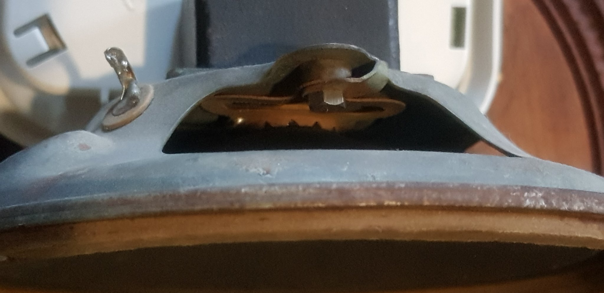

I suddenly, remembered I have a very old 5inch driver under my stairs ,I've taken some pictures.
Sorry about the quality(still have not got around to buying a new phone) but in the first picture you might be able to see the different type of spider used in this unit.
It looks like it is made from card and is about 2mm wide ,it is made into a ring on each side.
I would expect this spider to make far less noise ?
The spiders we use now days are great for long throw use, but I wonder if for midrange use they should be using something like the old drive unit ?
I don't know if the old unit lost its dust cap or if it never had one, but would expect without these two problems ,that this unit would not suffer from the same problems as my exciters and modern drive units ?

@spedge , @Pontos
Thank you for your feedback
The exciters I use are Dayton Audio DAEX25FHE-4 which come with the 3M VHB. So when I use new one, it is with the 3M tape.
For my last tests, the exciter was already used, the 3M original tape was removed. Unfortunately I haven't found 3M VHB in the DIY store close to me. Sad... it introduces a new variable in the game. In addition, my goal is to make comparisons between different materials in a "short time" (say 1 hour or 2). The reason of that is not changing something else than what I want. In the family environment even if there is a nice tolerance to my game, it is better to have not too long test cession, with everything put away at the end.
So I looked at the gluing more carefully. Yesterday the adherence to the panel was poor, much better at the voice coil, so I prepared a 10x10cm PVA coated area for new test. I also bought another double side tape which is said "extra strong" but in fact with a lower adherence than the previous one. So in fact, the tape of the post 4542 is quite strong but its main characteristic is to have a wire mesh so I think it has its own behavior changing what happens above 6or 7kHz.
Below the picture of the test frame, the tape with its mesh.
After 3 measurements of the 9mm XPS
My canvas panel are glued with epoxy and show similar HF behavior has with the original 3M VHB, so I don't think for now the 3M tape acts as a filter. do you have some "evidence" of that?
In addition, I made outdoor measurements of the other materials... need more time to have a look at them.
Christian
- 1, green : outdoor measurement @1.5m
- 2, blue : indoor post 4542
- 3, red : indoor (in june, other room) @1m
Christian

IR and FR are 2 representations of the same reality. REW is based on the IR. The "trick" is the use of a logsweep to get the IR with an excellent signal to noise ratio (from M Farina's works if I remember). The FR is the result of mathematical operation (FFT) and then filtered. This is my understanding. It is a bit different of an RTA that shows directly the output of filters. The spectrogram in REW works also with filters or equivalent (wavelets).
The point is we can read FR or spectrogram but in a much lower level IR.
In my opinion, the long tail IR shows that the energy is circulating in the panel for a long time which should lead to peaks in the FR or spectrogram with high Q (slow decay time).
To continue in the curiosity, below the IR of my outdoor tests.
1 - light green : XPS 9mm
3 - dark red : ESP 20mm (medium density)
4 - dark green : XPS 5mm
2 - purple : cardboard E flute
3 - orange : plywwod 3mm
It is like the "long tail" effect is linked to the thickness.
Already reported?
Christian

Here are some outdoor measurements. The idea I have with outdoor measurements is to reduce enough 1st reflections in order to see what is a characteristic of the material, not its interaction with the room. The materials used here are probably not completely relevant for a direct use or at least like that (ie the 5mm XPS with no coating).
I have split the measurements in 2 set : polystyrene, others.
Each has a 10x10cm PVA coated area centered on the exciter. The exciter is @2/5
1 - light green : XPS 9mm 60x80cm not coated
3 - red : EPS 20mm 60x80cm PVA coated
4 - green : XPS 5mm 60x80cm not coated
2 - purple : cardboard E flute 48x77cm
5 - orange : poplar plywood 3mm 45x120cm. currently my reference
6 - green : canvas panel 33x41cm (my version!), also good.
Plywood and canvas were measured an other day so no link in the levels. The canvas has +15dB offset.
Seems like the low frequency downfall from 200/300Hz is directly linked to the panel dimension.
Exception is the canvas which is the smaller one but have the property of having bass.
Up to now, I see the geometry driven the modal properties of the panel but nothing explaining the high pass effect. I miss something?
The group of polystyrene shows a low pass effect from 3kHz.
Hopefully, I will put again an exciter on my XPS 20mm panel (coated and acrylic painted) to get the same kind of outdoor measurement.
Seen like that, the cardboard is good candidate as standalone material. The HF extension seems good. It as the reputation of a"cardboard sound"..?
Does that mean the polystyrene needs a skin, by any mean like added layer or coating?
An other observation is that the IRs of second group don't show a long tail characteristic. This is probably linked to there quite extended FR that is mirrored in the time view by a concentrated pulse.
I have several ideas of "simple" steps; The question is to decide among them what is the next one...
@spedge : for the canvas, you are right, the peaks are far to be cured or even explained like the in the 300/400Hz area.
Christian
Christian
I have recently found a tape that works especially well for temporary mounting of exciters. It's 3M 9589.Unfortunately I haven't found 3M VHB in the DIY store close to me. Sad... it introduces a new variable in the game. In addition, my goal is to make comparisons between different materials in a "short time" (say 1 hour or 2).
https://www.3m.com/3M/en_US/p/d/b40070392/
It is a bit expensive (about $70 for a roll 2 inch wide x36 yard long), but I expect a roll will last a long time.
You can cut out out a 2" square, apply it to the panel, remove the release paper, and then press the exciter onto the tape.
After you are done testing, you can easily slide a thin putty knife or similar between the tape and the foot of the exciter and pry the exciter off the tape. Usually, neither the exciter nor the tape is damaged. You can leave the tape there on the panel for later re-use, or peel it off the panel and place it on the panel in a different location, and remount the exciter in the new position. Dismounting an exciter and remounting in a new position probably takes about a minute, I would guess.
Sometimes I cut and apply a longer strip, and then move the exciter along the strip in increments of 1/4" to 2 inches. That way I don't have to reapply a new piece of tape for every position I want to try.
And just for you Christian, I tried the tape on a piece of scrap PS foam I had. It stuck well, but I was also able to pry the exciter off the tape and then peel the tape of the PS foam panel without any damage to the panel, just like for plywood.
I have bought some VHB tape in the past, but it was even more expensive (per use), and it always gets destroyed when you remove the exciter.
I have not made direct comparisons of the 9859 tape to the VHB, but my impression is that it's no worse in any way. With the 3M 9589 there's no obvious roll off at either end of the frequency range. It may even be better, in fact. It's a 9 mil (0.2 mm) thick HDPE carrier, so it's actually much more firm than the soft, rubbery VHB.
It may even be perfectly good for permanent mounting too. I have not tried it that way, so I don't know for sure how long it will hold old on. The VHB doesn't hold exciters forever either, anyway, at least not on plywood, without a spine. You can probably guess how I know that!
I suspect that if used with a spine, this tape would work perfectly well for permanent mounting.
Eric
Christian.
I was looking at your plots of the canvas panels on post 4541 and 4558 and apart from the large hump at 400hz there seems very little similarity ?
Below 1k you now have two large humps, and a far higher output in the low end ?
They look like two different panels ?
On the other panels , the polystyrene plots all seem to mirror each other ?
also the frame foam mountings you have will have a profound affect on the sound of the polystyrene panels.
I have mentioned that just touching a polystyrene panel with your fingers will alter the sound greatly.
The roll off after 3k reminds me more of foamcore from years back.
The roll off at 3k just sets off bells in my head ,that something is wrong ?
I would always measure a panel free floating ,without any obstructions to the response, how do you measure the pressure of each of those foam pads are applying to the poly panels ?
It's all a bit confusing ?
Steve.
