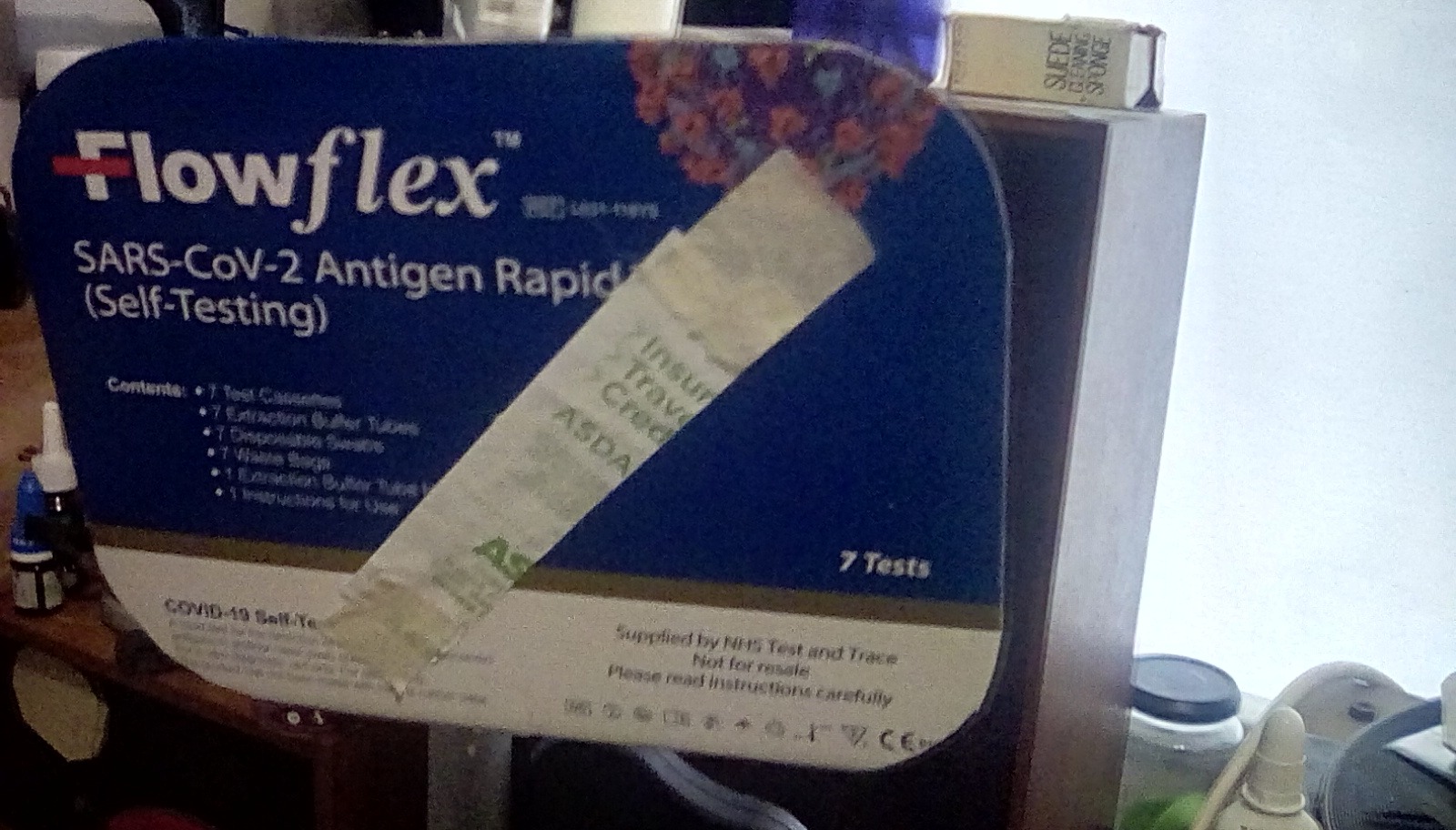

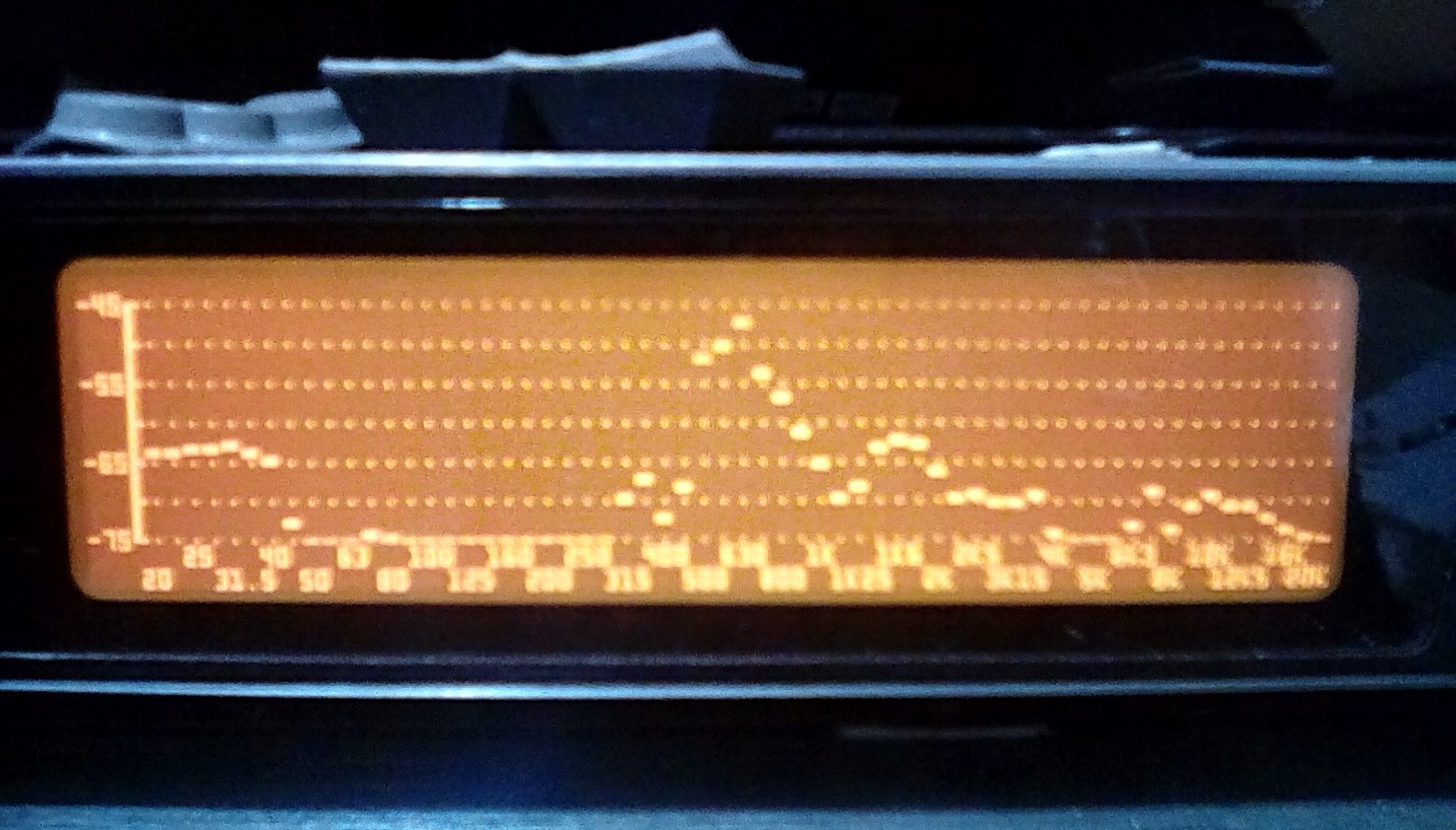

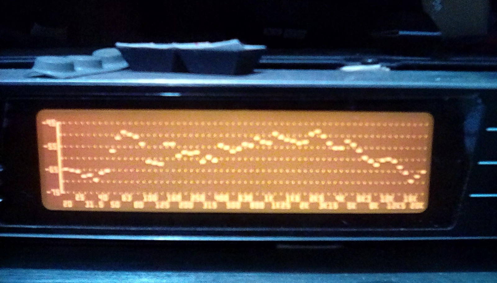

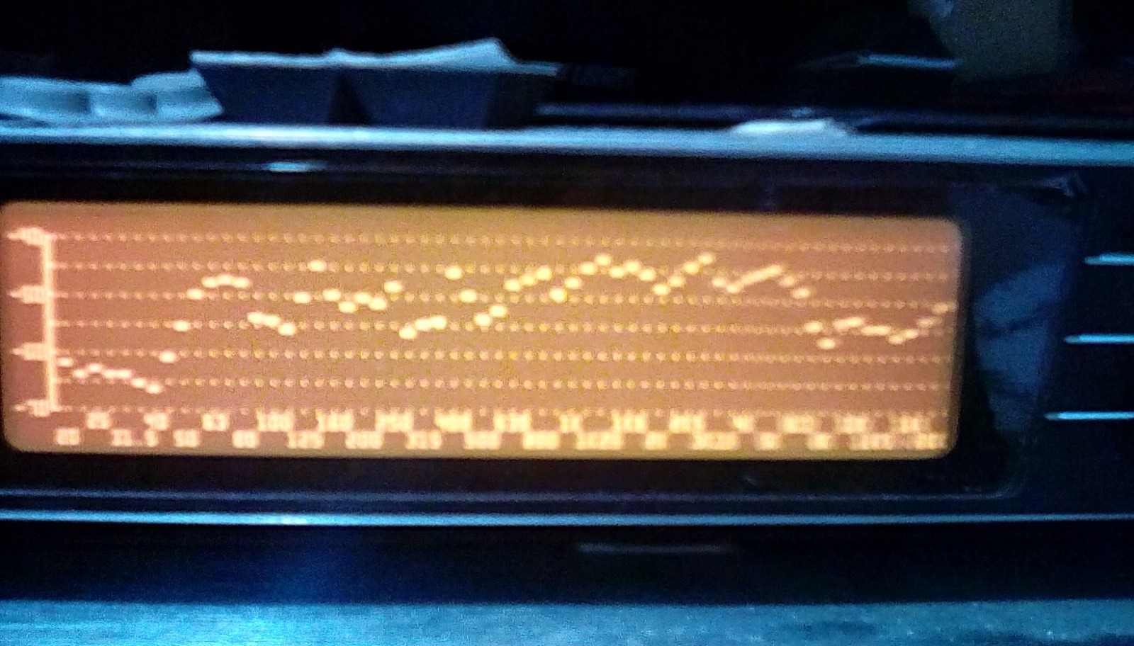

Yes I think I tried using masking tape at one point .
If you are using a hard panel type like ply , you could try my method of using a 1inch max strip of printer paper .
I'll post a picture , it's a lot easier.
You have to get it in the right position which can be very fiddly .
But the edge of the strip will be somewhere near the middle depending on panel and exciter ?
I have to look at the response on the RTA in real time to make sure it's in the right place.
Using my ears so close to the panel does not work.
I just quickly stuck this on to show the general position , it does not have to be tight up against the panel , in fact I used to put spacers to hold the paper off the surface slightly.
I did at one time just have a square inch of paper held at one side of the exciter With masking tape ,which also worked well ,I think ?
it's not just that it can flatten the frequency response, but mainly it improves the air and dynamics a little.
The paper becomes a bit like a passive radiator as well as blocking some of the cancellations in the central area ?
Steve.

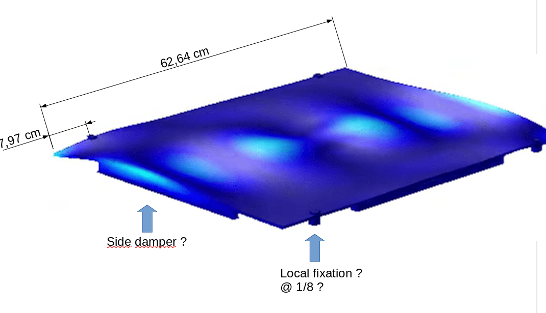

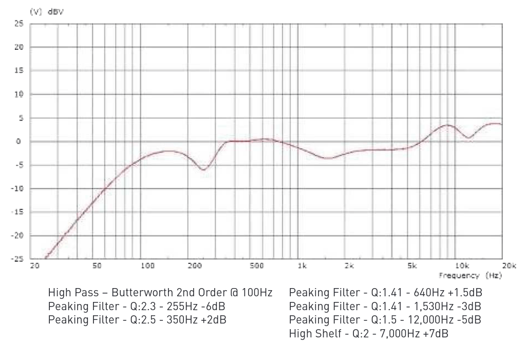

While you explained the techniques with central mass, I was thinking about the drawing below of a Manger driver. I thought a mass was attached at the center but in fact it is more sophisticated with a kind of central suspension but seems the mass effect is here.
About Tectonic fixation, here is below what I have in my notes. See at the beginning of this Tectonic video "deeper in DML"
The EQ is also documented. Around the topic we are speaking about : the high shelf at 7kHz (most of our panels have a loss here) and the dip at 12kHz where you propose a mass as counter measure.
I would be interested by more information about added mass. It is something I have never seen or my attention was somewhere else...
Christian

Well, the exciters are right next to each other, and the microphone was 1 meter away, so I think it's fair to say it was equally in front of both exciters.Eric.
i was also going to ask, on the ply panel, did you place the microphone in between the two exciters or in front of one of the exciters ?
i only ask ,as there will be cancelations between the two exciters and across the panel surface and peaks of course.
this is one of the reasons i never use two exciters on one panel.
steve.

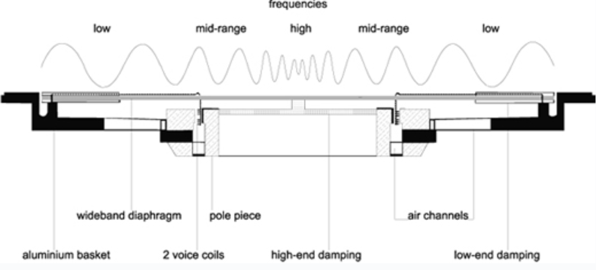

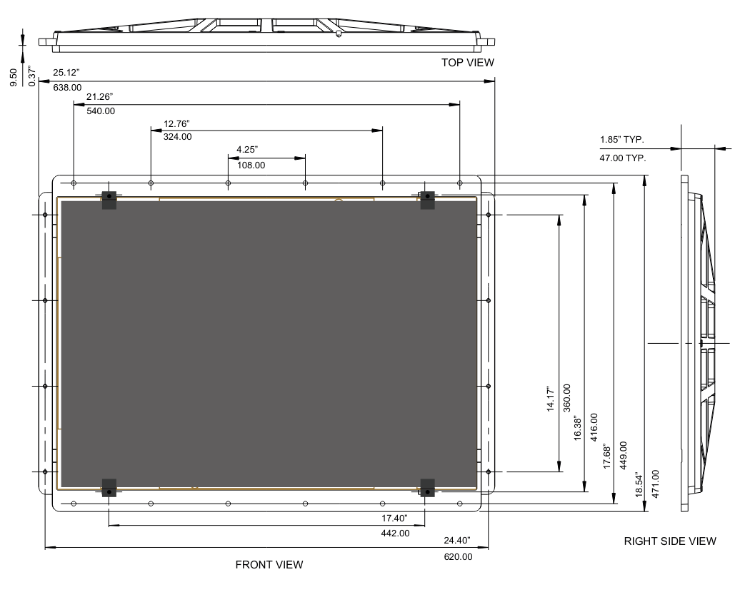

Christian,From all the views I have in mind of Tectonic DML (simulation or drawing or picture), it seems they have a suspension method by only those 4 points.
I've always assumed they actually have some kind of elastic support in the center 60% or so of all four edges, in addition to those 4 points of firmer support. If you look closely at the animation in Steve's link, you will see some rectangles underneath the central portion of the two edges that are visible. It's hard to know how hard or soft they are, but the fact that there are significant deflections along the edges in thos regions suggests the support is pretty soft, like foam would be.
As Steve pointed out, it kind of looks like the panel "bottoms out" along at least one edge, but I'm pretty sure that's just an effect of the animation, in which the deflections are grossly exaggerated to help show how the panel deforms.
Eric

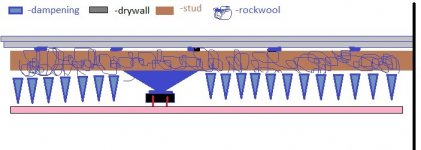

on page 152 I made three recordings of an hdn8 exciter on a stud wall, and a few pictures.
there is no reason screwing into a ceiling stud would be a problem, except for someone sleeping up stairs !!
the volume on my tablet was very low , but a computer and headphones should do better.
this was very loud when I recorded it in my room.
so turn the volume up and enjoy.

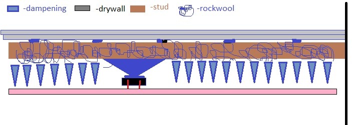

Actually it never occurred to me to put the hdn8 on the ceiling and turn the ceiling in to a dml speaker .
But if you have a void with no sleeping quarters or neighbours, it makes sense.
I don't think I made measurements of the room response but as I said in the recording ,the response was from below 40hz to about 18k and the wall actually went loud, which I was not expecting.
And attaching to the actual stud sounded the best ,to my ears !
This would have a very small footprint and probably not need for a sub ?
Not sure how it would sound on the other side of the ceiling in a roof void (invisible) and how to stop any buzzing from loose ceilings .
My walls are not perfect but I didn't notice any buzzing
Holding the exciter up against the stud wall worked far better than I thought it would and had a pretty decent sound.
I could try and take measurements if anyone is interested ?
I'm sure there are better exciters or shakers out there that would do a better job .
I must admit I am a little tempted to put the two hdn8 drivers on the ceiling in my room ,just for fun 😁
I was going to throw them in the bin ,but maybe they could have a use ?
Steve.
Steve.
Ok curiosity got the better of me.
I screwed the hdn8 onto my ceiling , I now have quite a big hole where the exciter screwed into the plaster but was not long enough to go into the stud wood !!
I managed to get these measurements before it fell off 😕 leaving the hole😠
The first photo is with the microphone about 30cm away from the exciter , I waved the microphone around about 30cm to get an average response.
The second photo was with me walking around the room with the microphone in front of me at about chest hight.
There was nothing below 40hz everything in the plot below 40hz is wind noise as I was moving around.
Interestingly the third photo shows the 600hz noise I noticed ,while the exciter was lying on the side !
This is a massive peak, but I found that if I held it tightly between my fingers ,the peak disappears.
This exciter is obviously ment to be screwed into something solid ,which is why I was getting such bad results with lighter material.
On page 152 you can see pictures of the exciter with a shed load of blu-tack on the coil area , this is still there , trying unsuccessfully to stop this noise.
also you will see the pictures of the two halves ,as it fell apart because of very little glue holding it together
it has a very flimsy casing and the screw is too short ..
I did try holding it onto the door which lowered the frequency to 20hz but the frequency response was appalling.
Steve.

Eric,Christian,
Eric
I think we see the same things : the blue colored panel in #4505 is extracted from a Tectonic video and around are my notes. The 4 supports keep locally the panel in its resting plan. The rest of the edges seems moving in the axis perpendicular to the plan and rotates. The rectangle in the center are visible in the drawing. What is their role : spring or damper. Probably both. I assume more damper to limit the wave reflections (no proof of that)
Christian

I think it is in this paper 21st-NXT/Azima where the DML properties are listed that it is mentioned they are good candidates for multi channel system.
I see just before a reply from Cheapvega who is working on ceiling speakers. That's good. If I remember the last exchanges, we (or at least I) was wondering about the effect of wall (=ceiling) close to the back of the panel... not clear for me. The only sure thing is there is an effect on the response.
I started with DML about 1 year ago coming like you from more standard design. The way is not easy, there is no promise of results to match our expectations but it is worth a try.
