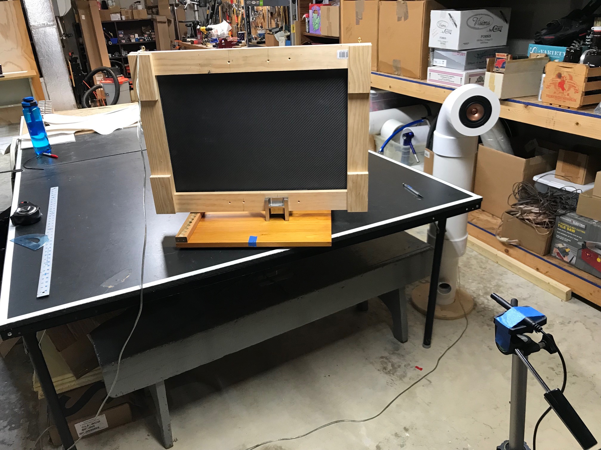

hi eric.Some more details on my cf skinned balsa core panels.
Thickness: 2.1 mm
Elastic Modulus: 27 GPa
Density: 450 kg/m^3
Stiffness (D): 20 Nm
Areal Density (mu): 0.95 kg/m^2
D/mu^3: 23
Fc: 4100 Hz
Size: 584 mm x 406 mm
Of course, to call these panels the holy grail is a huge overstatement. However, they do meet my goal, which was to have a panel with a sound as good and clear as wood but with much higher efficiency. I find they do indeed sound as good as wood, and put out about 6 dB more (if I recall correctly) than plywood at the same volume setting on my amp.
Already, I have an idea for an improvement. I recently learned that my cf fabric supplier has an even thinner (by half) cf fabric than I used, for a reasonable price (normally, very thin cf fabric is very expensive). Using the thinner fabric instead, with the same balsa thickness, I should be able to produce a panel that has even higher efficiency. Or, by using the thinner fabric combined with thinner balsa, I could achieve similar efficiency, but sginificantly lower stiffness, permitting similarperformance at low frequency but with a smaller panel.
Attached pic is of my prototype panel, in a test frame, when I was testing the frequency response at various distances and angles.
Eric

EricSome more details on my cf skinned balsa core panels.
Thickness: 2.1 mm
Density: 450 kg/m^3
D/mu^3: 23
Fc: 4100 Hz
Eric
Very clean your test frame. Is the speaker on the right here as a reference?
Thank you for the data. I'll put them in the material graph.
The gain in weight compare to the plywood is important. I understand the gain in efficiency.
The stiffness is what I estimate for a 3mm plywood. Isn't it a bit high for the areal weight you got? Less stiffness will increase the coincidence frequency and lower the first resonance for a same surface.
Christian
Compression "in the thickness" was mentioned a long time ago somewhere (where?) with the commendation if I remember not to be more thick than a quarter wave at the highest frequency... which make sense... and disqualify all the thick membrane. To keep in mind as a potential cause.Christian,
I must admit, I don't have a clear model in my mind for the loss of level in HF. I have seen it in materials with both high and low coincidence frequency (PMMA and PS foam), but perhaps there are different causes in each case. I always had a feeling that it was worse with softer materials, due the the exciter compressing the material under the coil, instead of bending the plate, but possibly there is an effect of fc as well. I'll have to look for it in the future.
Eric

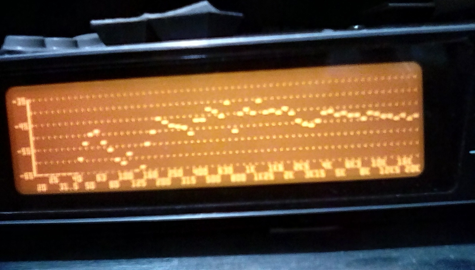

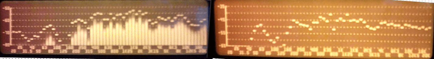

Hello Steve.Is it just me or does predictive text change words around just for fun ?
I had a quick play around with the corrugated panel today and managed to change the response a little ,it was resisting my charms to alter it in more subtle ways so had to revert back to very small 2mm blob of blu-tack.
I didn't want to spend too much time in my room as the heating is not on out there and it's freezing.
But it's not bad for a first attempt.
The hf looks a lot better I hope ?
This plot was taken with the microphone at about 30cm as I did not want to move everything around again.
Steve.
Yes more "quiet". Let us know your listening impression. If I remember, additional mass gives nicer FR but not necessary a much better sound. I have always difficulties with added mass. For me mass is synonym of delay, resonance while working with spring.
Anyway, it proofs again the role of the central area in HF.
Christian

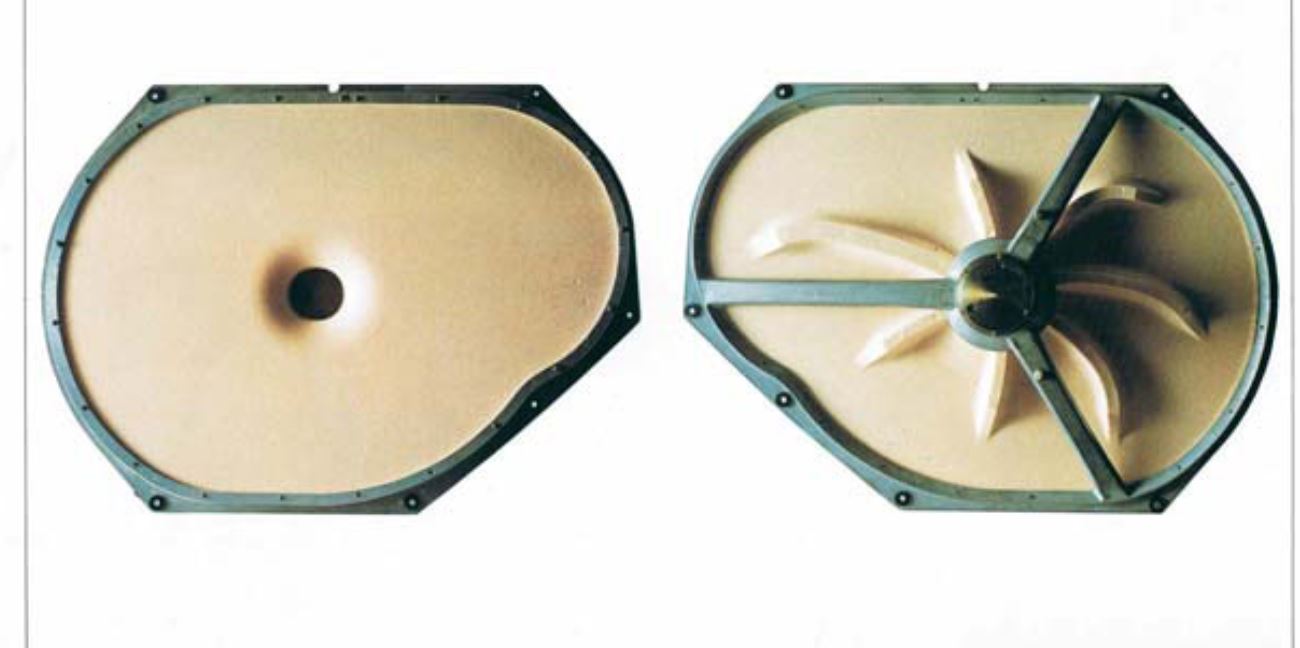

Could it be this Yamaha unit? I have been wanting to cut a panel to this shape.I don't know why but I always presumed that bertagni speakers would not use a spider ?
But I've never seen one without the cone.
I'm sure I've seen a polystyrene speaker without a spider , but I can't remember the model ?
Steve.

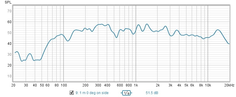

Steve,have you posted any frequency plots ?
Here's the response of the cf/balsa, at 1 meter on axis. This is in a frame with with foam around most of the perimeter (not the corners) and a Dayton DAEX25FHE-4 exciter at about the .45/.45 location. Frankly it's pretty similar in overall character to my plywood panel of the same dimensions, but 6 dB louder.
Eric
