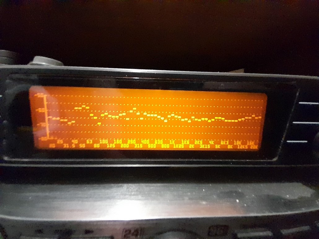

Foam panel 80x40 cm, exciter at 40% (length) and 50% (width). The 40% is chosen after Pettals software predicted slightly flatter response. The edges are clamped to the frame, but I have made some "tone relief" grooves around the panel, acting as a kind of softer surround. I use a lot of highfreq boost eq, and no PVA coating.
This gives a nice sounding panel. I think my aversion to foam (plastiky sounding) was because of the coating. Without coating you lose a lot of high end of course, but digital eq's are easy to get.
