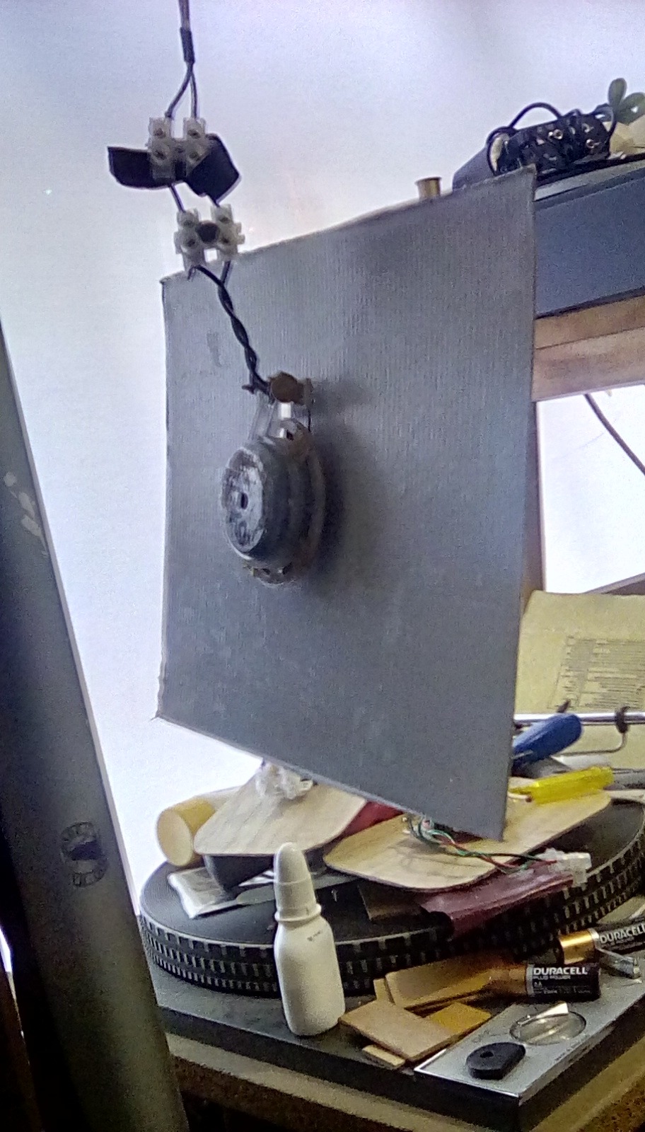

These are some photos of the 1mm corrugated panel ,I have coated the exciter side with a little neat pva and used that to glue the exciter in place.
I used a hair dryer to dry the pva quickly and then paced weights to flatten the panel and stop it bowing, when I do the other side it will try to bow it the other way.
I did intend to listen to the naked panel without the pva , but I could not wait !
There is a little exciter noise at about 1.6k , which I think is the spider ? This panel might be sensitive to this ?
But I will deal with that later.
I had to turn the volume down 3db to match the output of my 85cm x 60cm 5mm xps and epoxy panel.
So the card is more efficient and also sounds more alive , I think ?
It's early days ,and there is a lot more I can do to improve things, next I will pva the front side and see if this improves things or not ?
I will round the corners ,mainly because I think it looks prettier and may prevent wobbling in the corners a little ?
Anyway, my first impressions are very good, it covers the frequencies from 160hz to 20k , and actually plays down to 50hz on real music,
I can't hear any nasty sounds yet ,but I have only had a quick listen.
The microphone was at 1m and I left on the peak hold using pink noise.
Steve.

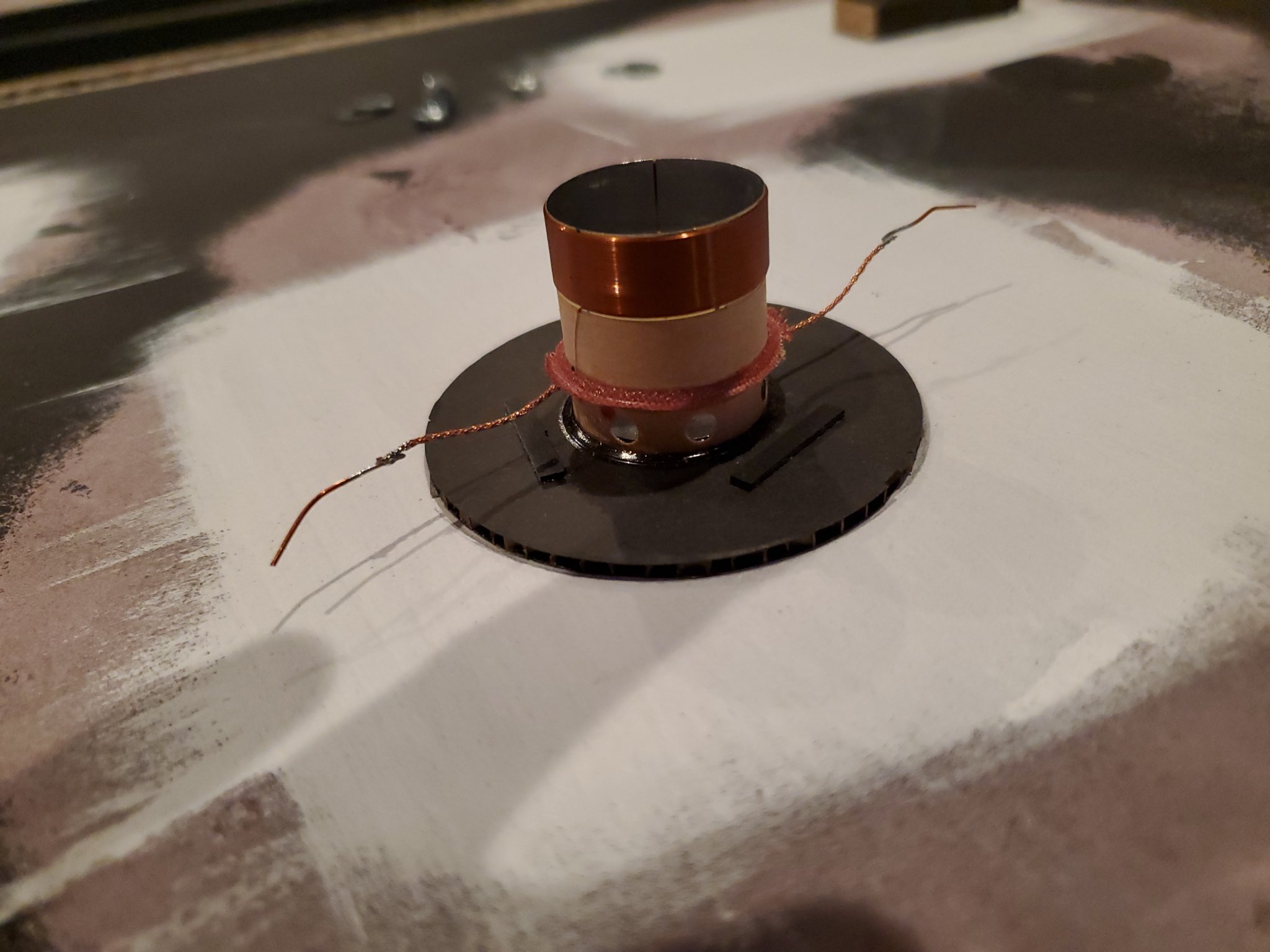

Thank you for this feedback Steve.
2 questions (quickly... I have to go back to other activities!)
  • which exciter position did you choose?
  • I understand you glue the exciter (and many other things!) with PVA on the membrane. Right? Is it an alternative for you to the double side tape without coming to epoxy (like I did for my canvas and being afraid if I could remove the exciter...)?
Christian
Christian.
I just glued the exciter in the centre of the panel, the beauty of card panels is that you can cut the shape and size to whatever you like and when you like.
I even recorded my small heart shaped panel .
this panel seems to cope well with the exciter in the centre, I did make a video recording of the panel vibrating while playing a 50hz bass guitar, but I don't have time to figure out how to get it shown !
I have only use pva to glue my exciters onto my panels, and some have been on my panels for over 10years.
I would not use the sticky tape supplied with the exciter , I prefer a solid mounting.
I only use double sided tape for quick testing.
With card you don't have to worry about damaging the card, just throw it from and start again.
A Stanley knife usually helps peel off the exciter.
Pva is never quite rigid like superglue but it works very well , and it is being glued on to a pva coated panel anyway .
Steve.
Christian.
Steve.

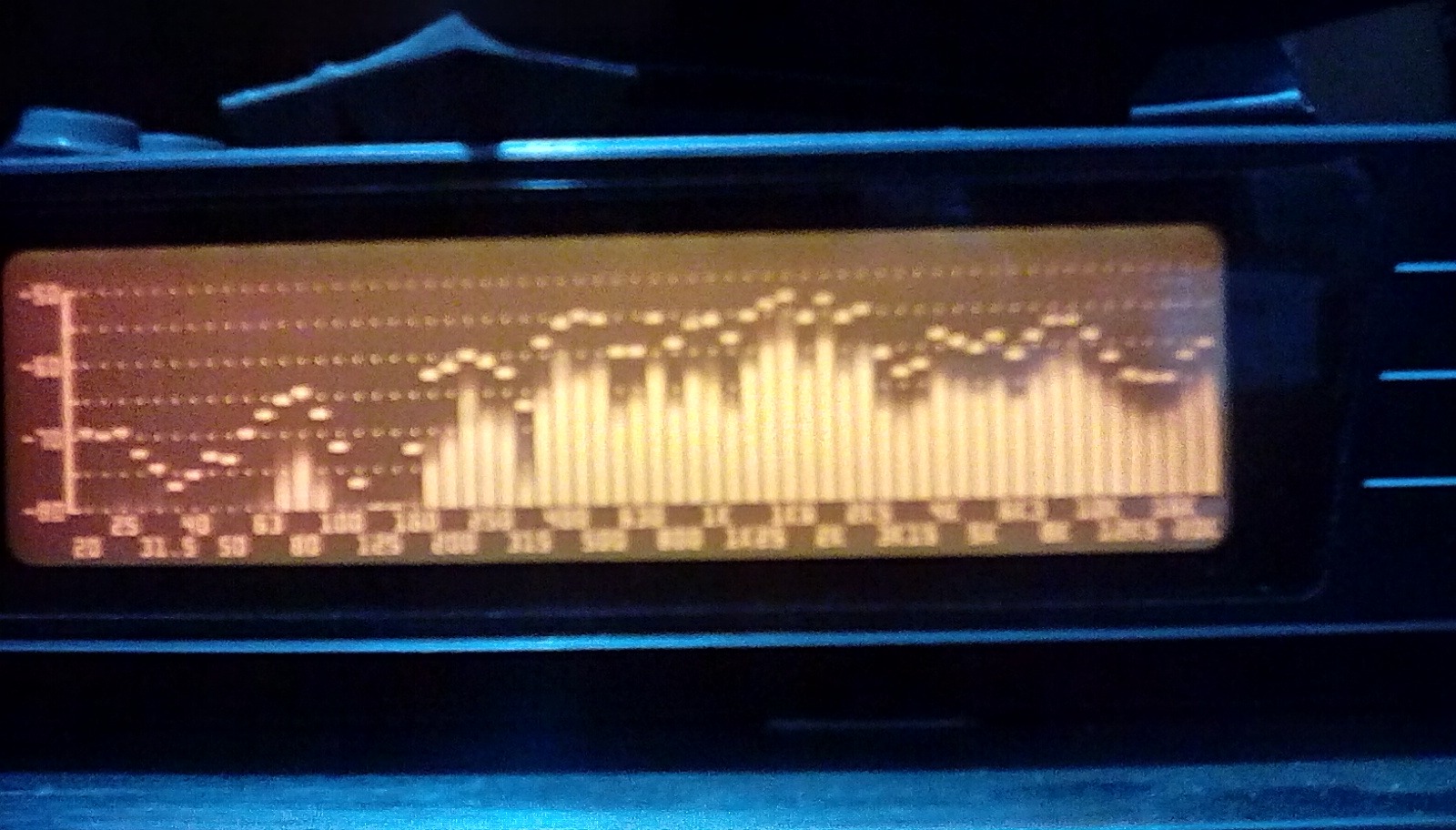

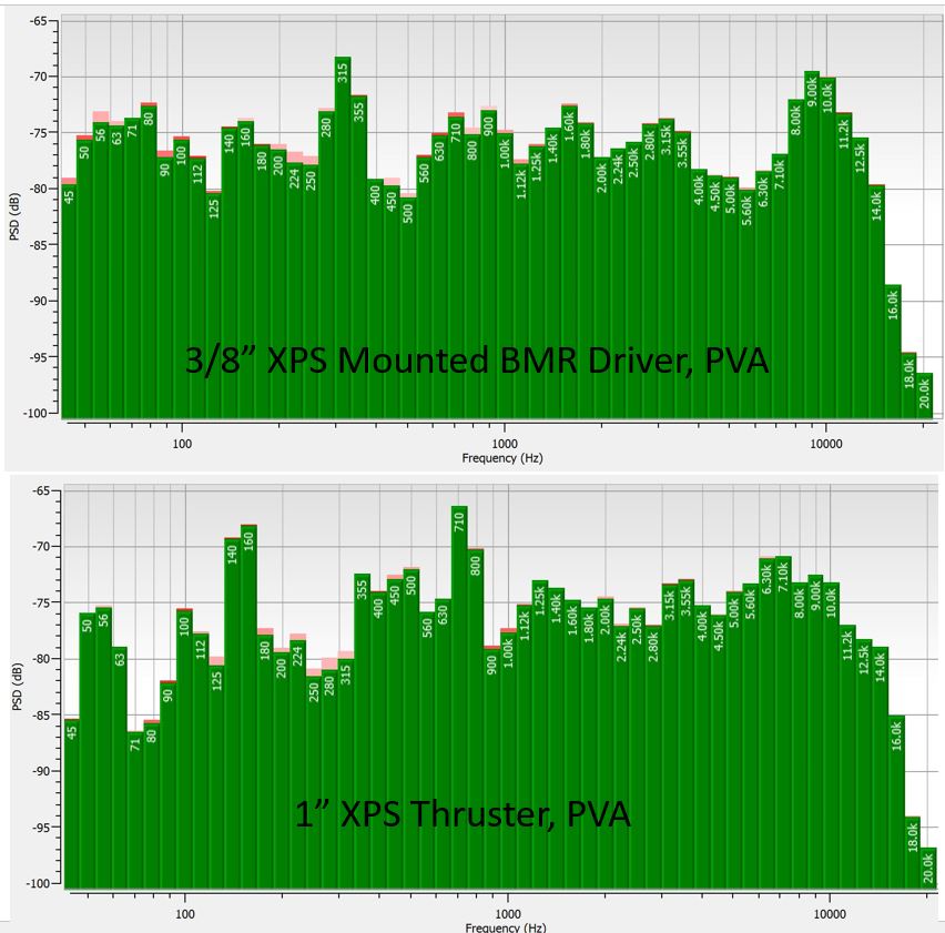

Steve
I didn't think PVA would glue to the coil. Nice to know.
About the first frequency response... not a bit "unstable"?
Christian

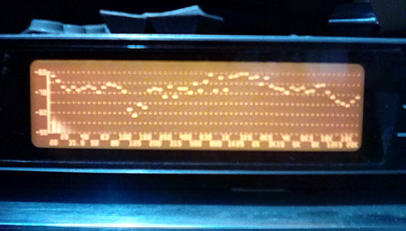

Christian.
don't panic !
these were just quick measurements in a very crowded room.
I was more interested in how much of the frequency range was being covered.
I struggled to get this measurement,climbing over a lot of junk in my room ,so ignore everything below 100hz.
If you disregard the hump in about the 2k area which I believe is exciter noise and I do include the spider noise that you were having.
I know this because I was trying to move the panel left and right to see how the response changed, but as soon as I placed my hand anywhere near the back of the exciter the hump increased in size.
The sound is coming through the panel and off the back wall, although I have not heard any nasty sounds when playing music.
If you look at the plot ,you will see that mainly the response stays within the 5db lines from at least 200hz to 10k that is if this hump is removed ?
This measurement was at 3m into the room moving the microphone to the left and right which fills in the response down to below 200hz.
The hf rolls off a little above 10k but then comes back up to 20k.
I have seen this problem before and I think I can improve on this ,with a little fiddling around ?
I have had a chance to listen to this panel today and so far I have not heard any nasty sounds.
Bells and cymbals ,voice ,saxophone, they all sound very natural ,which is the main objective as far as I am concerned, but it would be nice to flatten out that response, for peace of mind.
Steve.

Good Steve
Which is also very interesting is your "reading grid" of those frequency responses. You have pointed the role of the exciter with the spider at the back and the central area. There are 2 other areas in common to many FR : the hole around 150Hz (there is no big necessity to fill but it would probably better for a good filtering at 200Hz) and as you mention here the drop in HF. For the HF drop do you have an hypothesis? Might it be the area above the coincidence frequency where the panel starts beaming so the overall energy sent to the room falls?
By the way, yesterday I was on a paper about MMM (Microphone Moving Measurement) which is basically the technique you use (and I also use it with others based on logsweep). Do you have an interest for this paper here... most probably you have it already?
Christian

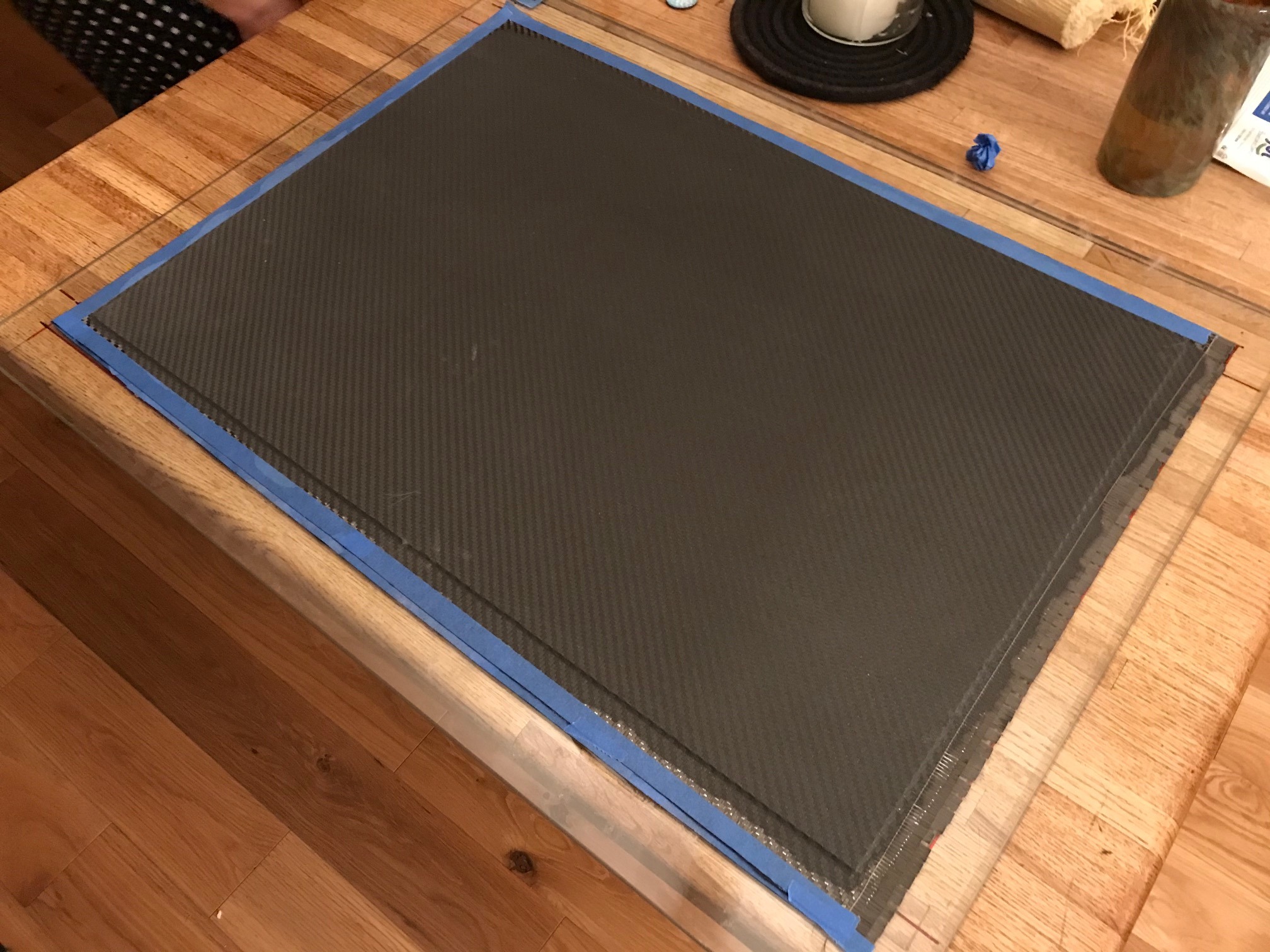

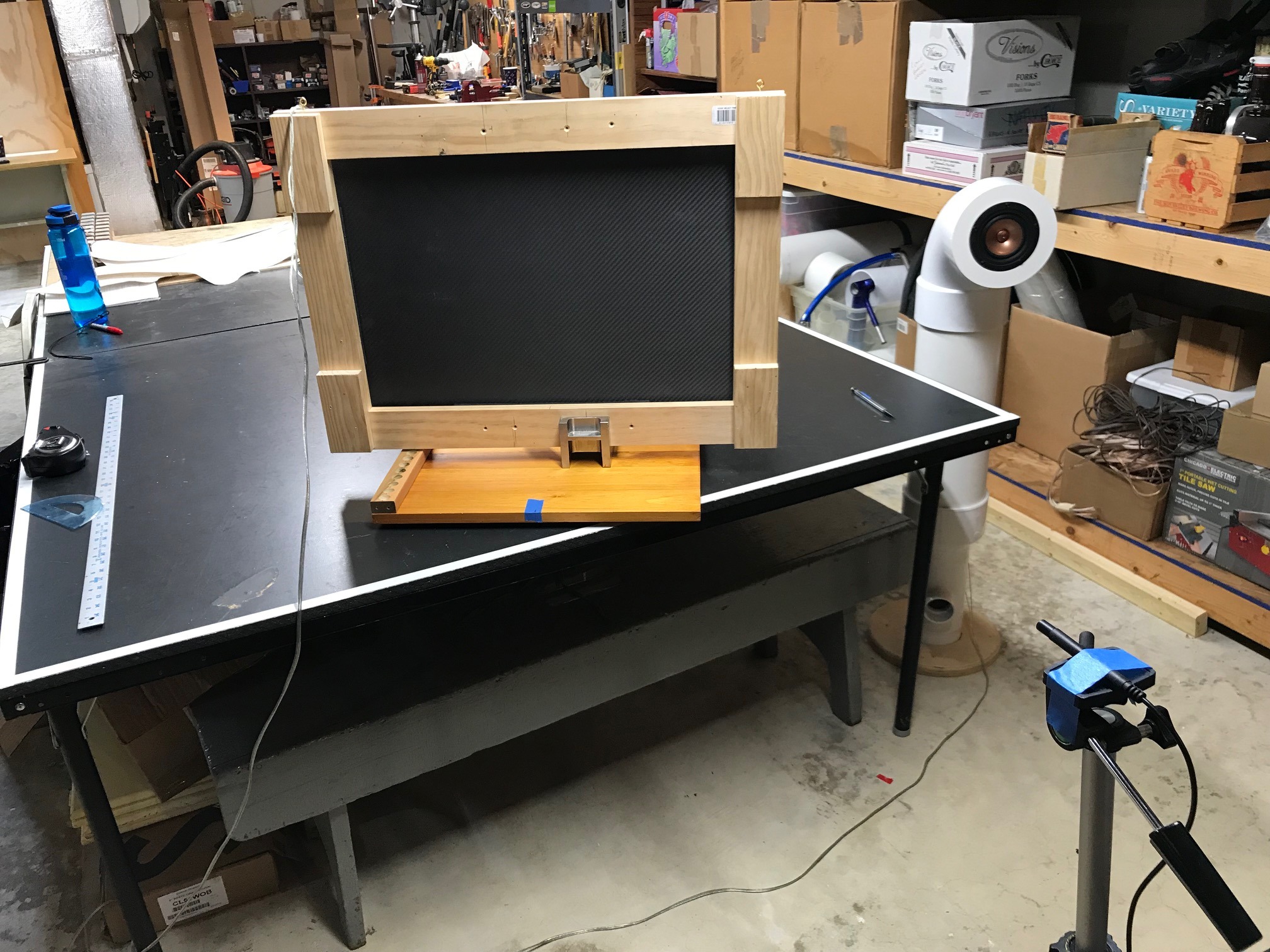

would you mind to share your "holy grail" material?
Christian,

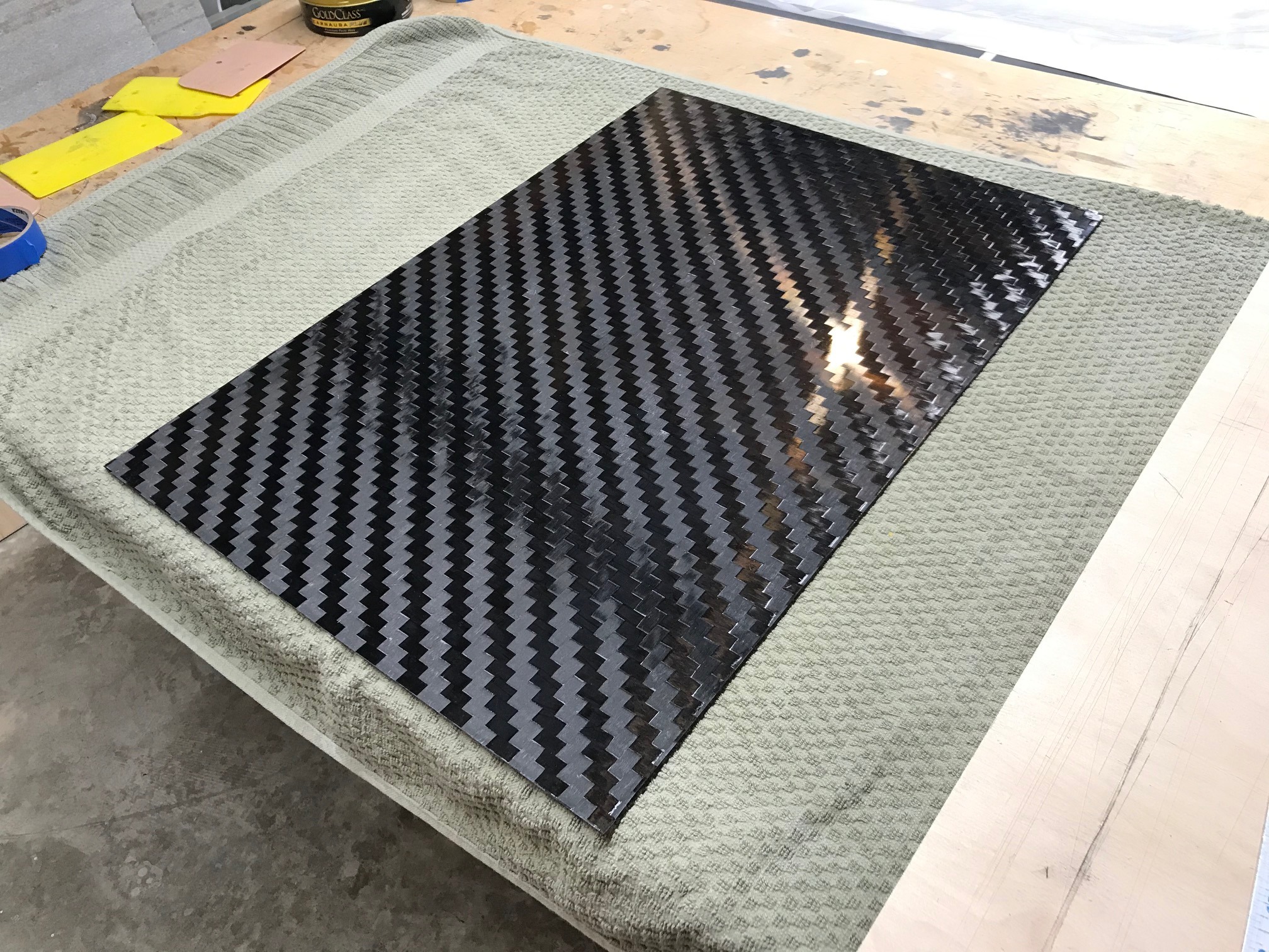

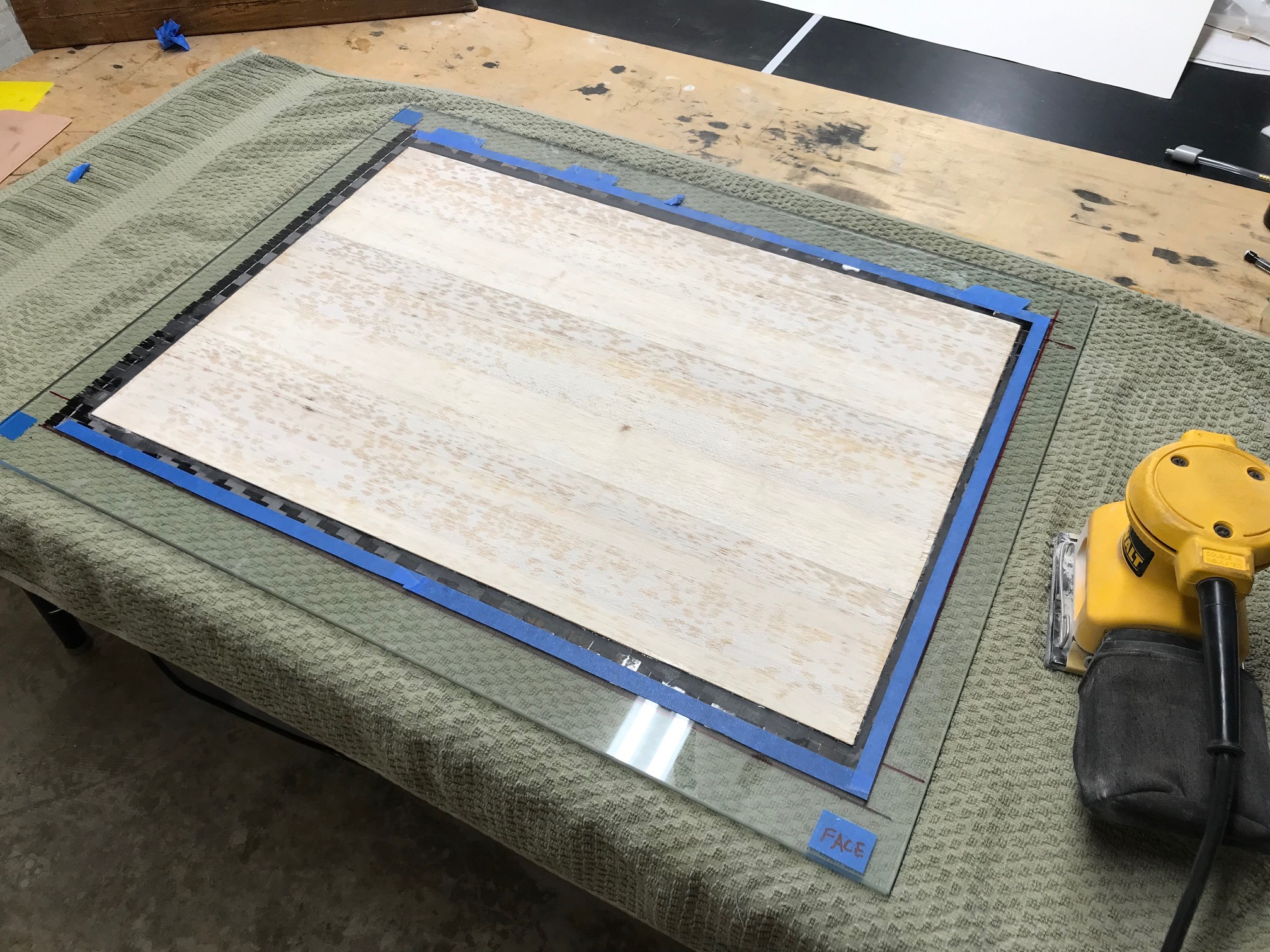

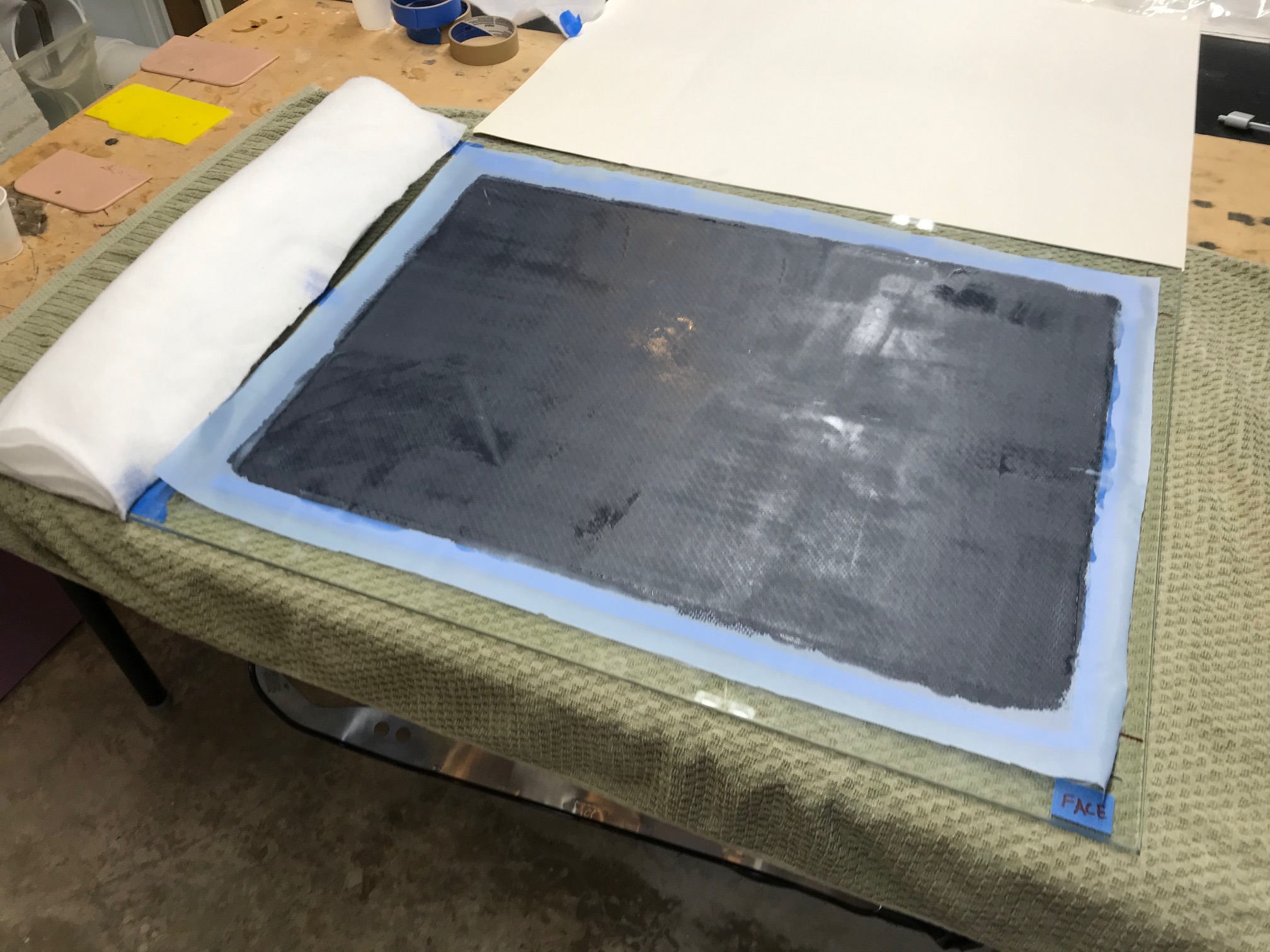

You took the bait, as I hoped you would! Of course I will be happy to share details about my holy grail. I have mentioned it before, I suspect, but perhaps not described it in much detail.
It is a carbon fiber skinned, basla core sandwich composite. The top and bottom cf skins are 190 g/m2 carbon fiber fabric with epoxy resin matrix. These densify to about 0.23 mm each. The core is 1.6 mm thick balsa, with a density of about 160 g/cm^3.

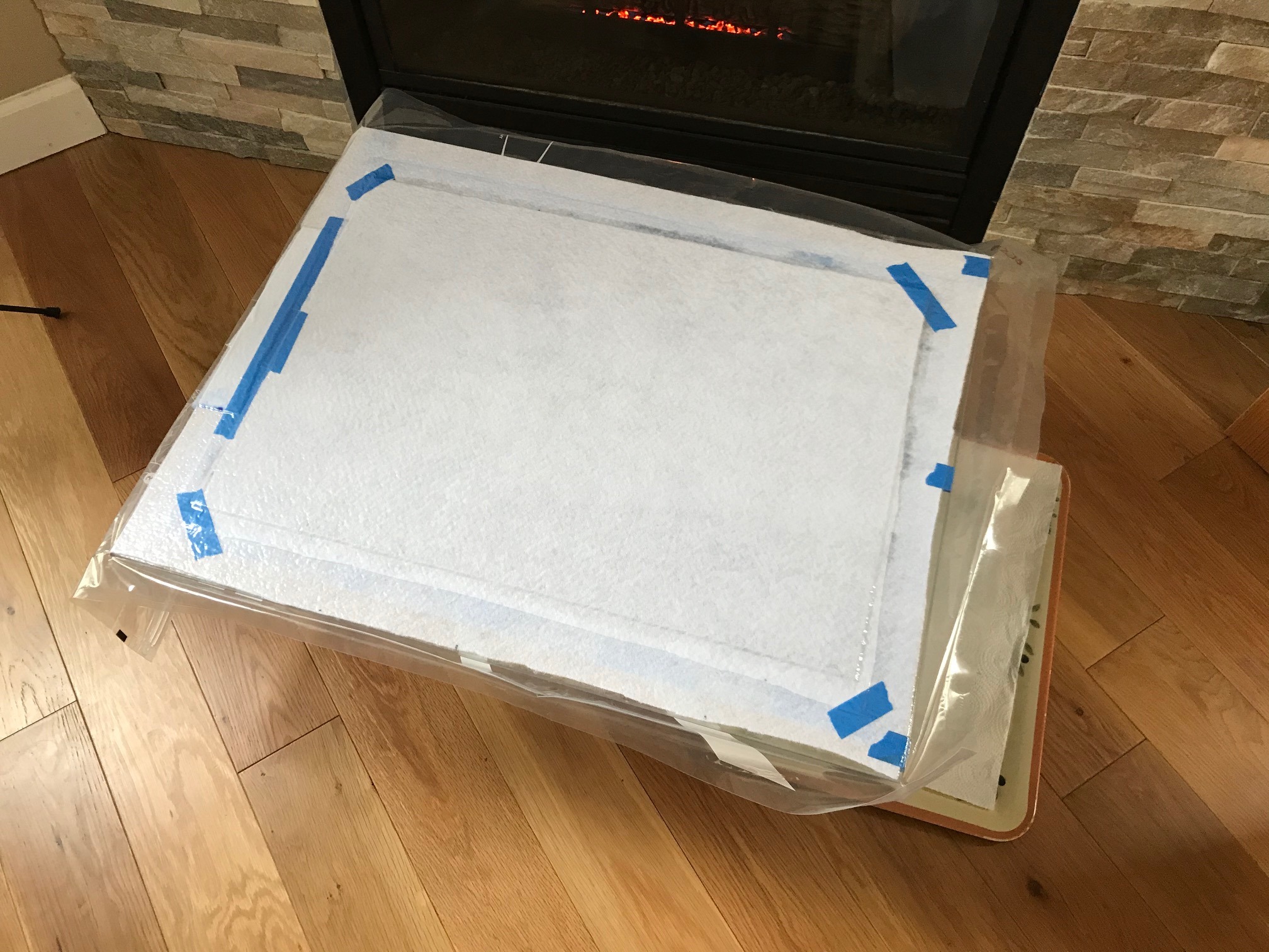

I make these panels myself in my workshop. I will share more details of the process if anyone truly would like to try it themselves. But the basic process goes like this:
1. Lay the first layer of cf fabric on a glass plate, saturate it with epoxy, and apply the balsa on top.
2. Apply "peel ply" and absorbant batting layers, then put it all in a vacuum bag.
3. Apply vacuum, then let the epoxy cure overnight.
4. Remove everything from the vacuum bag, remove the peel ply and batting.
5. Apply the second layer of cf fabric on top of the balsa face, and saturate it with epoxy.
6. Repeat steps 2-4.
7. Carefully peel the composite sandwich from the glass.
With this process I end up with one glossy side (the first cf layer that was directly against the glass, while the other side is matte and has the texture of the peel ply fabric impressed into it.
Some pics of the process are attached, more info to follow.
Some more details on my cf skinned balsa core panels.
Thickness: 2.1 mm
Elastic Modulus: 27 GPa
Density: 450 kg/m^3
Stiffness (D): 20 Nm
Areal Density (mu): 0.95 kg/m^2
D/mu^3: 23
Fc: 4100 Hz
Size: 584 mm x 406 mm

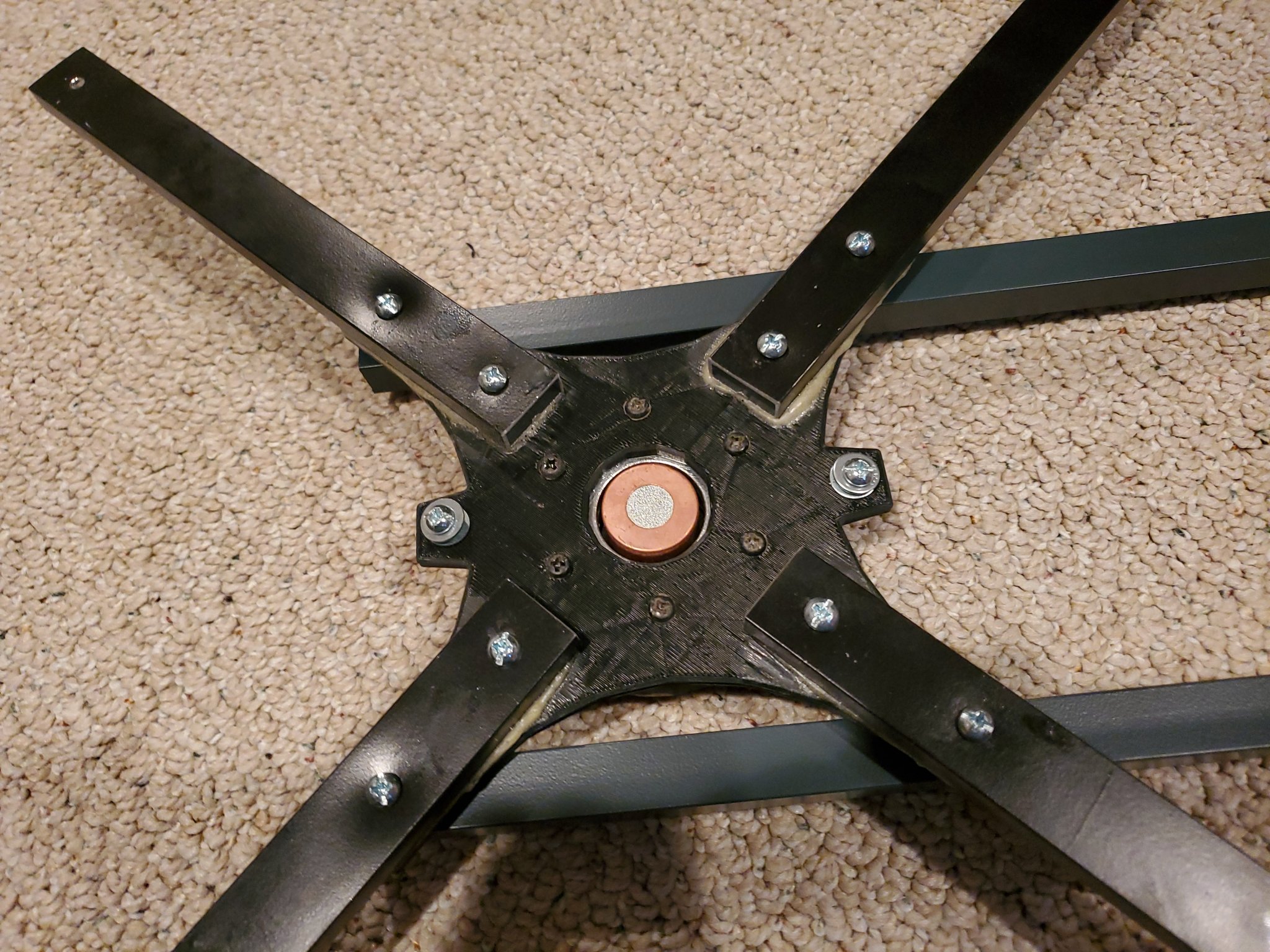

Of course, to call these panels the holy grail is a huge overstatement. However, they do meet my goal, which was to have a panel with a sound as good and clear as wood but with much higher efficiency. I find they do indeed sound as good as wood, and put out about 6 dB more (if I recall correctly) than plywood at the same volume setting on my amp.
Already, I have an idea for an improvement. I recently learned that my cf fabric supplier has an even thinner (by half) cf fabric than I used, for a reasonable price (normally, very thin cf fabric is very expensive). Using the thinner fabric instead, with the same balsa thickness, I should be able to produce a panel that has even higher efficiency. Or, by using the thinner fabric combined with thinner balsa, I could achieve similar efficiency, but sginificantly lower stiffness, permitting similarperformance at low frequency but with a smaller panel.
Attached pic is of my prototype panel, in a test frame, when I was testing the frequency response at various distances and angles.
Eric

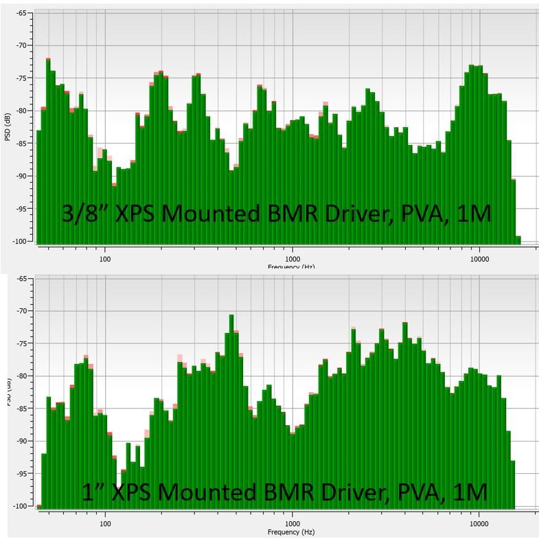

Christian.
If you go back to my posts on dml open baffle for pro use you will see on my reply 51 and 52 ,the response of a 6ft hardboard panel.
51, shows the hump in response above 10k and the slow dip up to the 10k point.
52, shows the corrections that I made using simple methods ( no damping methods or mass used)
in post 54 you see my 3ft ply panel ,which has AA batteries stuck to it's front surface.
and as it states ,I used the battery masses to fill in the dips in the 100hz to 300hz region. !
Even with some of my small panels , I could extend the frequency down to 100hz without the dips, but there is always a price to pay,regarding sound quality(in my opinion) but it is a matter of taste.
We must not get confused with the room suck outs and the panel cancellations as these two problems show up in the same area,
Once again looking at this picture from my gallery in NXT RUBBISH, you can see the small dip left after using the batteries, but when moving the microphone back 3m ,the room takes its toll,
https://www.audiocircle.com/index.php?action=gallery;area=browse;image=137096
Steve

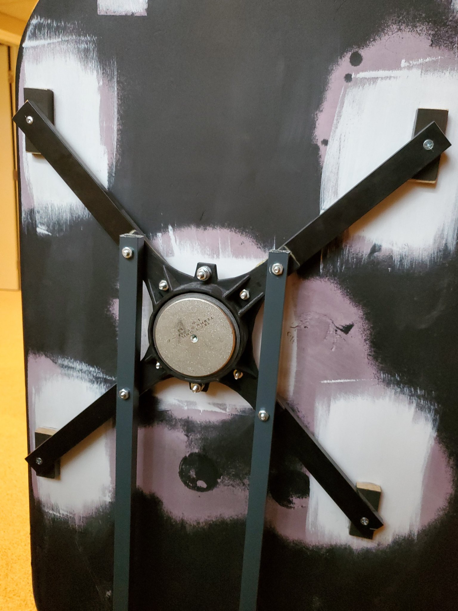

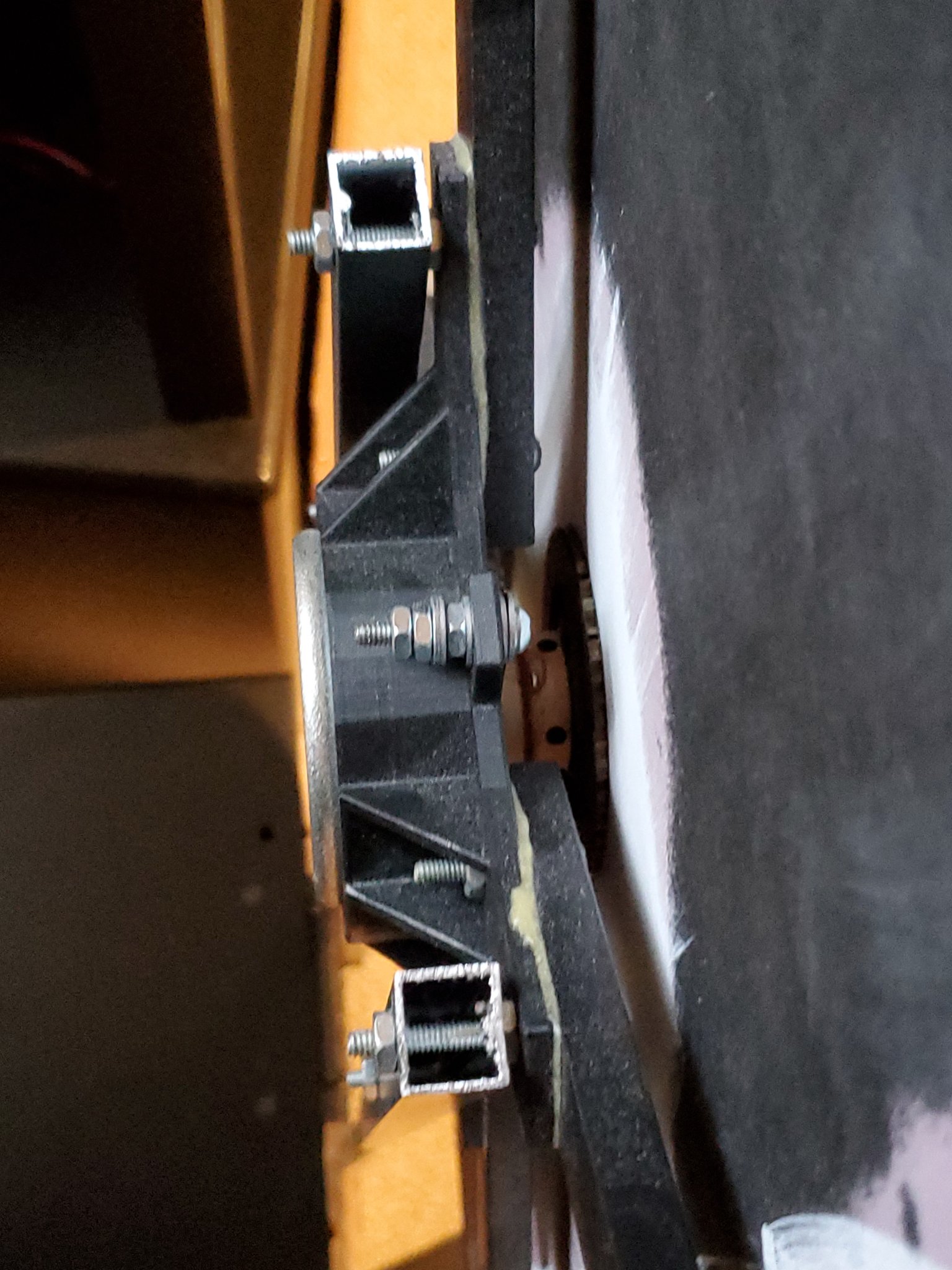

Greetings fellow DML’ers! I want to pass along something I’ve tried that seems to have some merit. It started after ordering a pair of the 3.5” 8 ohm Tectonics BMR’s. One of the first two came broken from shipping damage and so did the replacement. Since I had two unusable units, my concept was to eliminate the spider and suspension of a typical exciter and let the DML panel be the spider and suspension – to avoid wasted energy and mechanical resistance to the force of the voice coil.
I 3D printed a mount to support the driver. I put tape around the voice coil to keep it centered on the magnet while the support was glued to the panel. After that I unscrewed the mount from the glued pads, took the tape off and reassembled.
My original panels are 1” XPS with PVA coating. The attached pictures are of the experimental assembly using 1” XPS, 3/8” XPS, with and without PVA. Also a comparison of the 3/8 and 1" mounted PVA experiment and my original 1” with a Thruster with PVA.
I'd appreciate your insights, and if this has been done elsewhere, please direct me to it. Great work you have there, Veleric!
IMG_20220115_160115.jpgIMG_20220115_160024.jpgIMG_20220115_160701.jpgIMG_20220115_160712.jpg3-8 vs 1 inch pva.JPGmounted vs thruster.JPG3-8 PVA vs No PVA 11 ft.JPG
Reactions: BurntCoil and lenta
