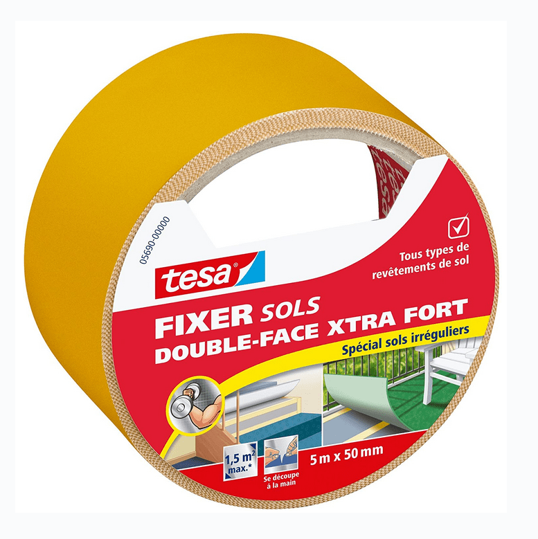

Following #4561about tape alternative...
For my last tests I used a Tesa 05690.
Typing that on tesa.com leads to Tesa 05681.

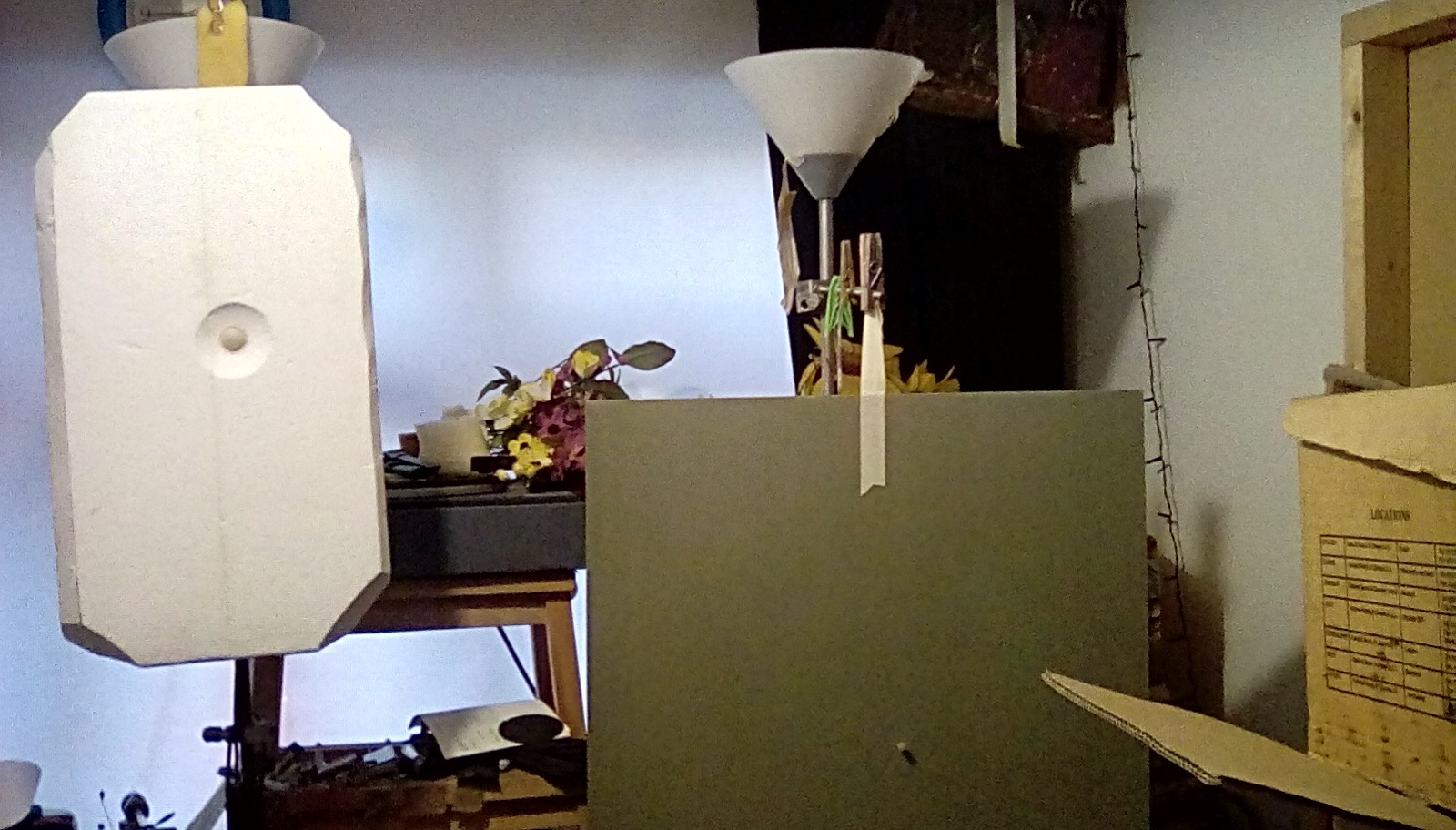

About the frame, I took the option to support the membrane at its lower edge by 2 small foam pad in order to test more heavy material (I have question about what makes the efficiency) and in addition for pads to press the membrane against the foam pads glued on the frame. The position of those pads is similar to Tectonic fixation position. The foam is the one I used tor my plywood panel. A 17x17mm foam from 3M for a garage door sealing.
In my view, 2 or 3cm long pad was supposed not to applied an important strength... my balance says when the pad is about half pressed, the equivalent needed weight is somewhere between 150 to 180g; Is it too much?
In an other hand, when the membrane is kept in position in this way, it remains completely flat even at the pad. The outside pad is pressed but the one (same size) between the membrane and frame not.
As the dimensions are quite large (60cm wide for 80cm high), I thought it would be ok; probably modifying the low end but not let say above 100 or 200Hz.

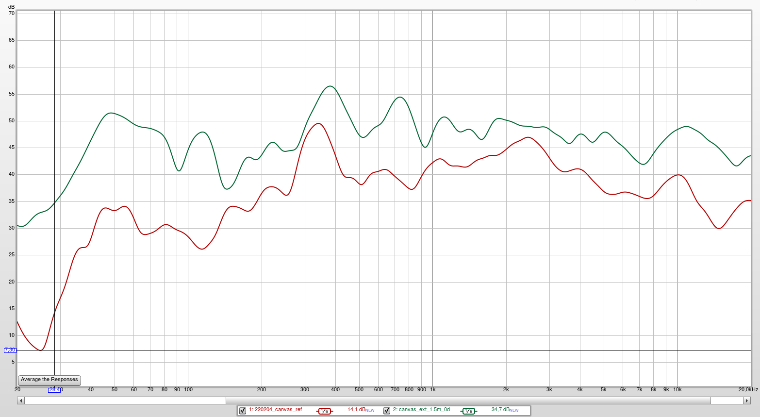

I was looking at your plots of the canvas panels on post 4541 and 4558 and apart from the large hump at 400hz there seems very little similarity ?
Below 1k you now have two large humps, and a far higher output in the low end ?
They look like two different panels ?
Steve.
Below the 2 FR on the same graph.
Frankly speaking I can't explain the differences except by invoking the role of the room.
So yes it is the same panel in both. No change. It is also the same electric chain (laptop, DAC, amp, mic, setting of REW). I am in a phase I keep my panels, canvas and plywood, as they are before deciding what to change.
The main big difference is one is outdoor in my garden (I posted some pictures), the other indoor. In indoor condition, I can't say I keep the mic position between the different records but it isn't the point here.
I already observe with the plywood panel that the low end is higher outdoor than indoor. Which make sense because of the possibility of combining earlier the rear wave indoor.
In our living room (indoor), the canvas has a wall (painted one, no damping or diffusor) 30cm behind it.

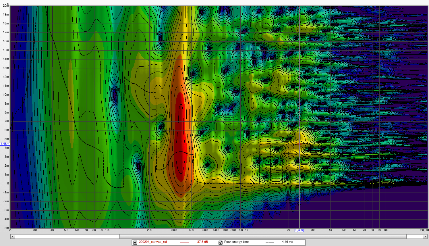

In the spectrogram below, we see that the dot line which shows the position of the maximum for each frequency (which is hidden in a pure FR without windowing) is far to be at t=0 which says there are strong reflections.

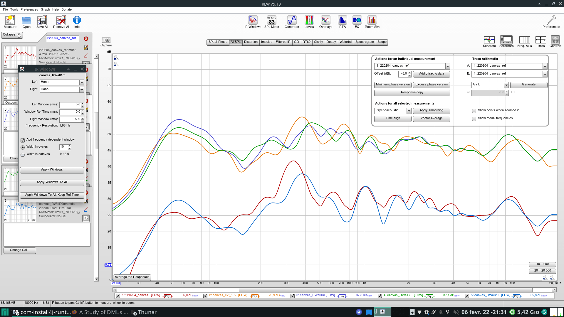

Precision : if there is no change in the panels, it might be one measure is with one panel, an other with the second one explaining some change in the location of the peaks.
Consider also one is indoor around 20°C, the other outdoor around 5 to 7°C
REW offers options for windowing, one is frequency dependent window. When applying it, the differences are more limited. For now I don't use it because I have found no detailled explanation of how it works.
Before that, I limit my use of REW to compare FR coming from the same test cession (ie test of central mass). I started with outdoor last August in order to try to explain "local" differences (ie the bass level or what is a reason of a peak : from the panel or a reflection)
All advice for a better measurement quality welcome!

I just played a little bit with REW options after reading quickly around the frequency dependent window. There are posts from Bob Katz about that. A good reference even not recent.
So on the same records than before, I applied a 10 cycles window with a psychoacoustic averaging. Not sure it is exactly the best settings but it remove part of the reflections and the method seems said to be more close of what we hear (window to be between 6 to 15 cycles)
Below the result for :
up
2 - orange : outdoor mic @1.5m
3 - purple : indoor mic @0.75m back wall 1m
4 - green : indoor mic @0.75m back wall 0.5m
down
1 - red : indoor (an other room) mic @2.2m, back wall 0.3m => usual listening situation
5 - blue : indoor (same as 3 and 4) mic@0.75m back wall @0.2m
Is it less confusing? A better reading of the panel characteristics?

Christian.
The idea for recording measurements outside that would match the inside wall reflections would hopefully give some sort of consistency.
If there is a similarity between the two without all the other reflections ,then you know how much the back wall is affecting the plots.
at the moment you have a lot of plots of the art panel, all showing different results and the other poly panels all showing very similar responses ? When I know they are very different.
It is very confusing .
I usually concentrate on one panel only(that's the idea anyway) and if I like the sound I see how I can improve it, swapping between many panels and not understanding what is happening in and outside would give me a headache.
You need some consistency, measuring in the best sounding position in the room .
Even in my overcrowded junk room I can still get good measurements.
I just took this measurement in my room, this is the normal panel position in my room,shown in the other picture .
There is also a second panel showing another type of panel suspension using an old sponge,
It is far from perfect but it matches the near field response quit well.
Giving me something to work with that I understand.
