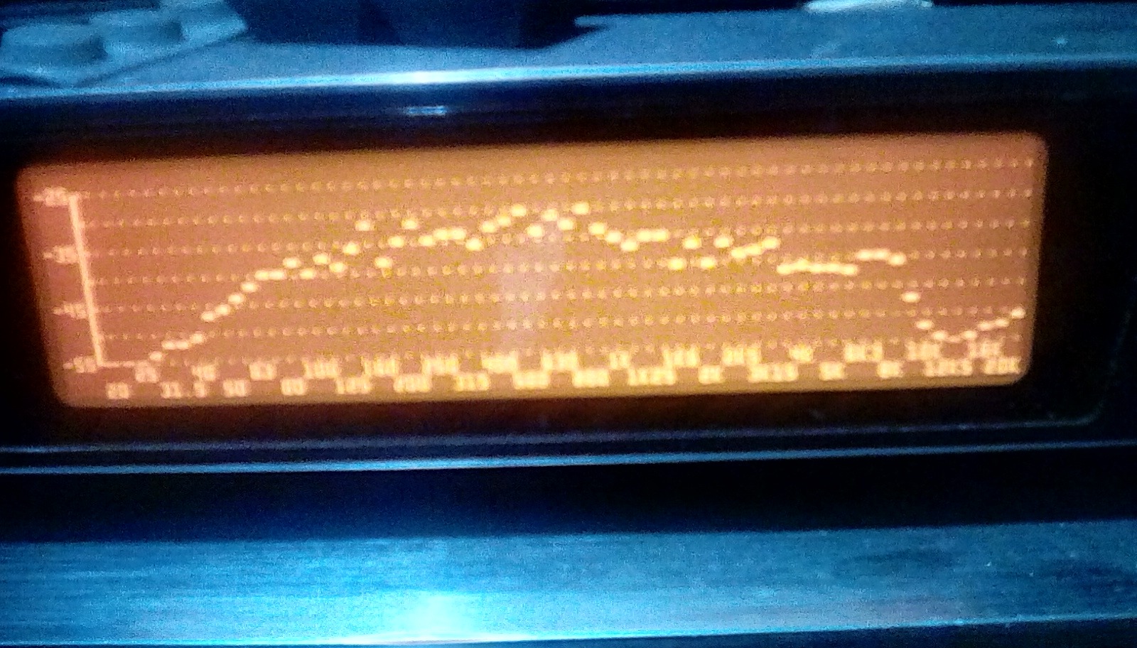

Hello Steve,Christian.
I usually concentrate on one panel only(that's the idea anyway) and if I like the sound I see how I can improve it, swapping between many panels and not understanding what is happening in and outside would give me a headache.
You need some consistency, measuring in the best sounding position in the room .

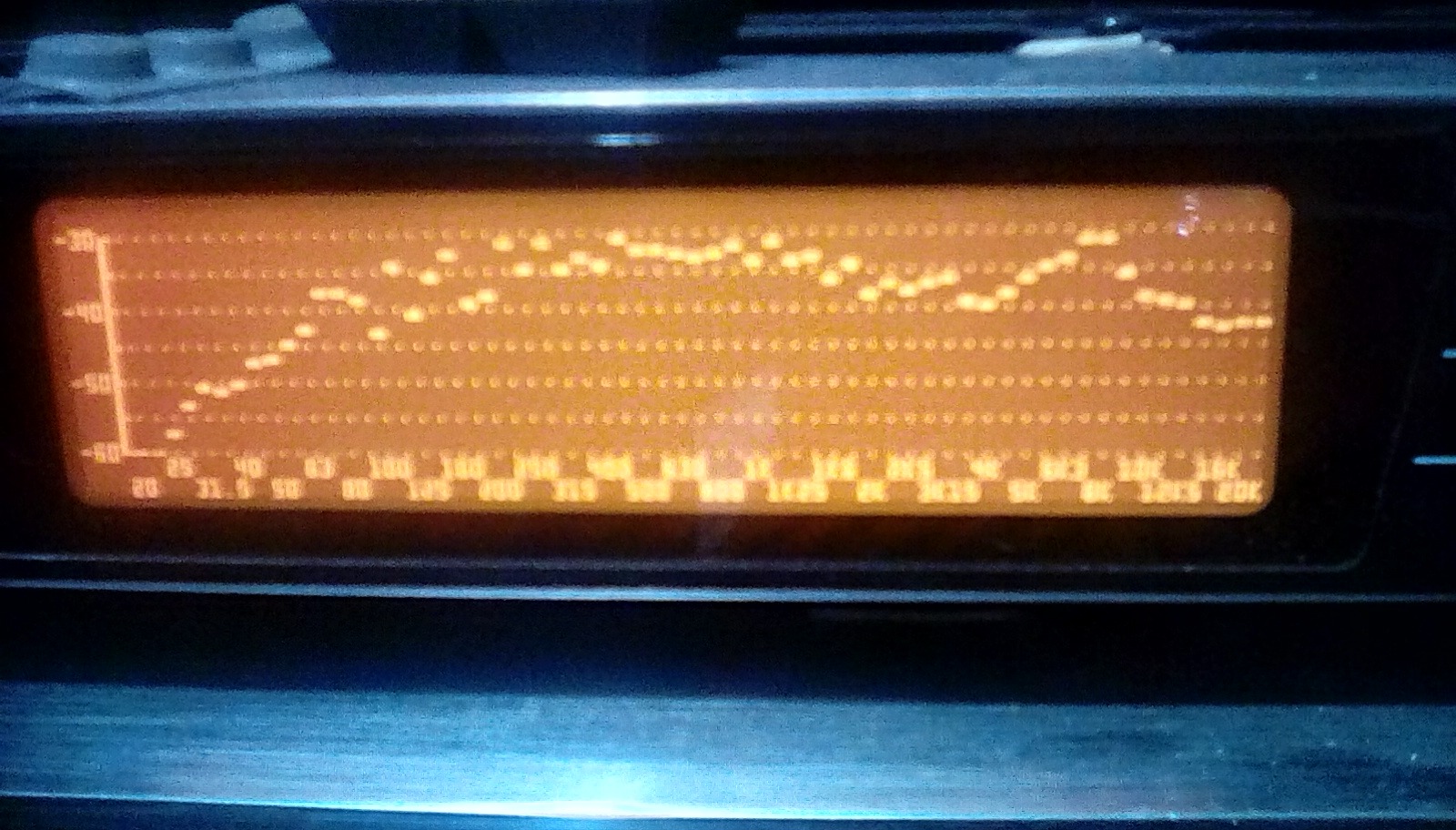

Yes!!!! Upper traces more than 0.5m, lower traces : 0.3, 0.2m from the back wallChristian.
ok so the lower traces are very close to the back wall which is causing a large hump In the response at 300hz to 400hz .
And a rolling off of the frequencies below this hump, which makes sense.
When you are playing the pink noise ,do you listen to the harsh tinny sound that is produced , the closer to the wall the panel gets ?
I described this hollow tinny noise, as I would call it ,in the recording I made ,when I moved the art panel closer to the wall.
Steve

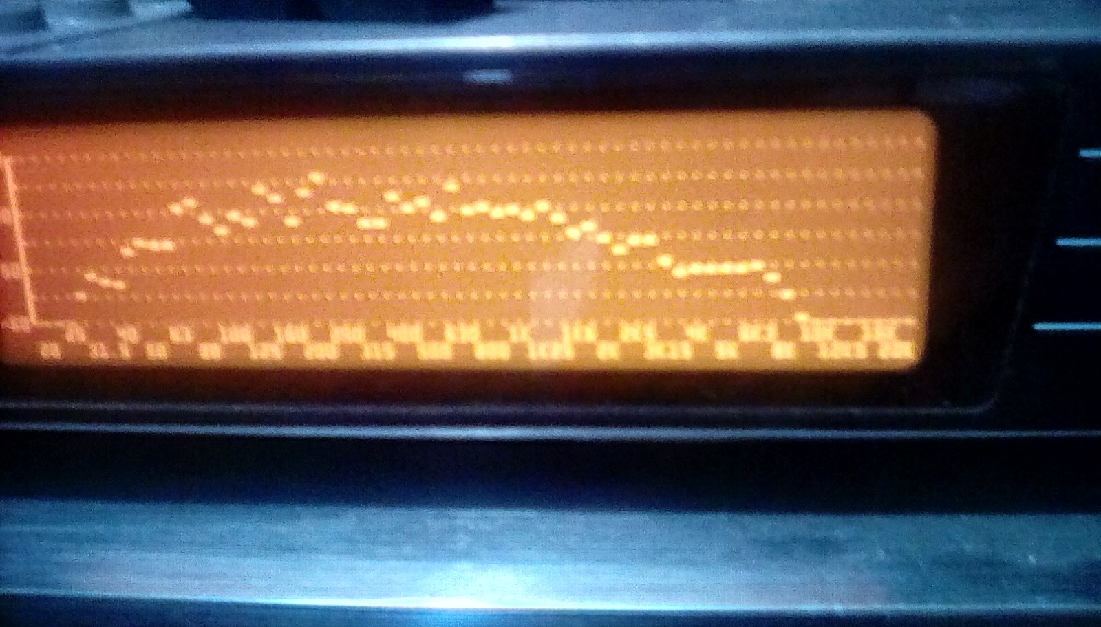

I just went into my room and had a quick look at the frequencies changed by holding the 5mm panel at the edges with my hands.
I zoomed in to a 15db window in 5db steps which only went up to 8k, but the frequencies were being moved about up to the 6k point.
It was too difficult to judge any higher than that. ?
While I was on the floor I made some measurements of all around the edge of the panel response , then 3inches from the exciter area, and last in front of the exciter, this was all at 1inch from the panel.
This is why microphone positioning is very important.
Steve.
I have clearly in mind that the position of the mic at short distance changes completely the FR.
I am not sure to understand your conclusion of the first picture : you were holding the panel at edge by hand, the mic was... away? 1m or more perhaps? and you see that level above 6k/8k is lost ? Correct?
Christian
Christian.
Sorry, that was my fault, not being clear enough.
The first picture has nothing to do with holding the edges.
I could not see a way to show The difference using my setup, and my old knees were hurting 😬
The large 5mm epoxy coated xps panel is a little too large .
The hf does not reach the edges of the panel, I have in the past described this type of panel as being lossy !
But I was mainly referring to the hf, which travels only a few inches from the exciter area.
The first picture is the frequency response at the edge of the panel, I moved the microphone all around the outside edge of the panel on peak hold, to show what frequencies were reaching the edge.
On a smaller panel using this same material the hf would reach closer to the edges ?

Christian.
Holding the panel edges.
Basically I just propped the microphone up about a couple of feet, 60cm, away (not very scientific) and watched how or if the frequencies moved using pink noise.
I did not really need to see the measurements as I could hear the sound changing well up into the upper midrange.
This is the problem when using this method and also weights to fill in the response below the 400hz point.
it affects all the other frequencies.
This should be easy for you to test yourself.
Steve.
