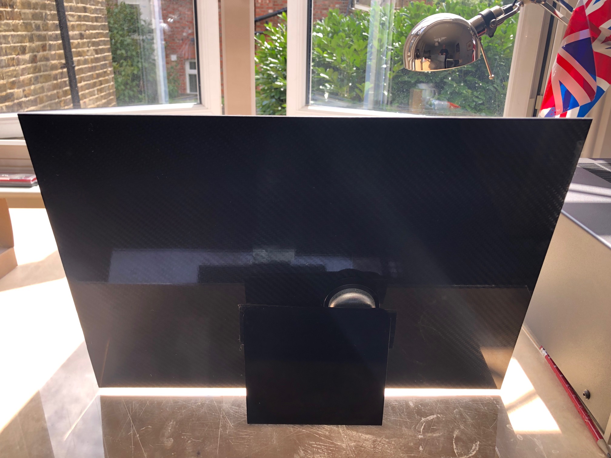

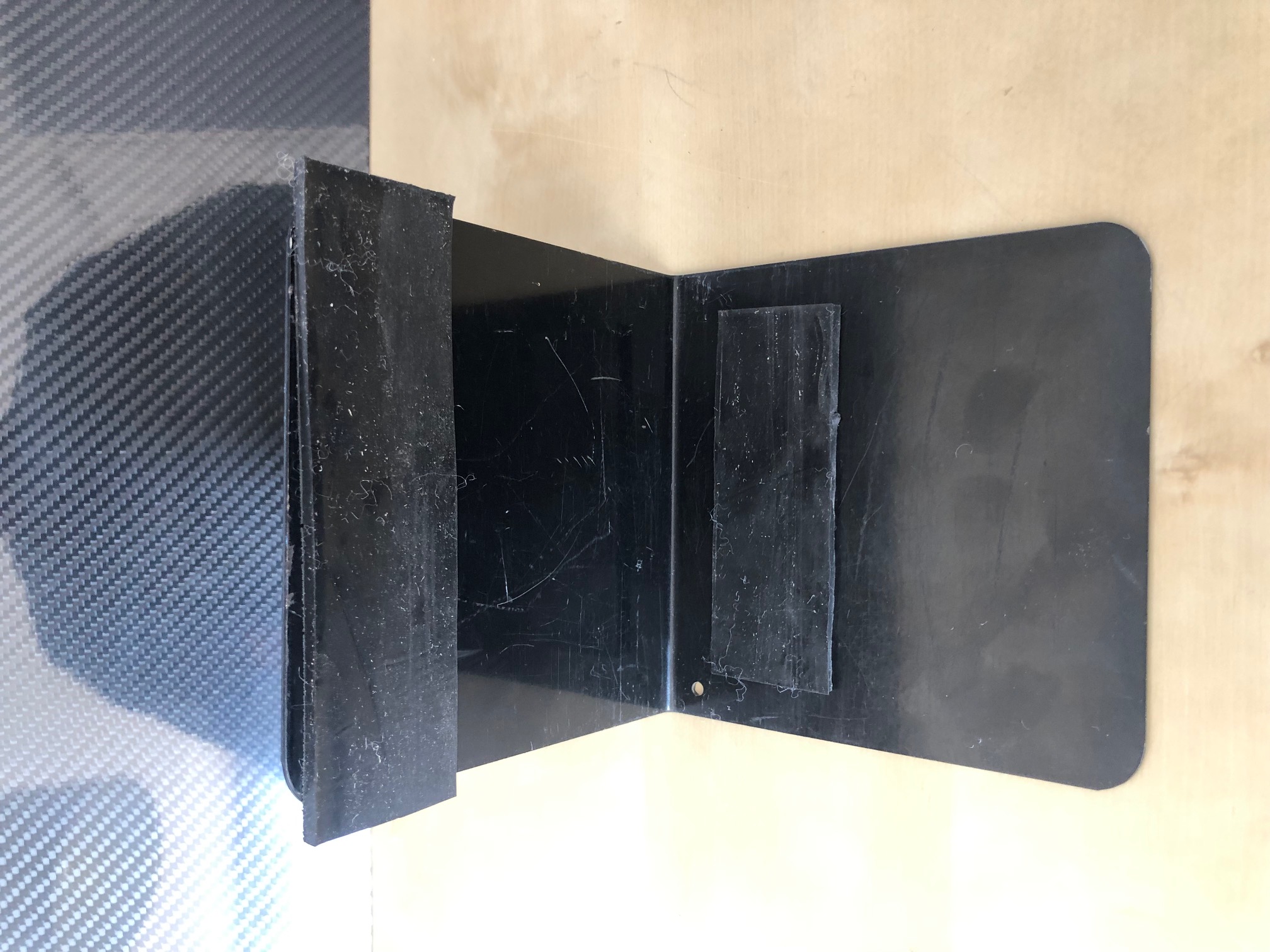

This is just a quick update on how I plan on testing panel materials.
I am not aiming for an absolutist measurement or subjective study at this point, just a comparative look see at the differences in the listening environment I have in the UK. This is a normal room 5m by 4m with the usual clutter, a sofa, bookshelves, carpeting hard wall surfaces.

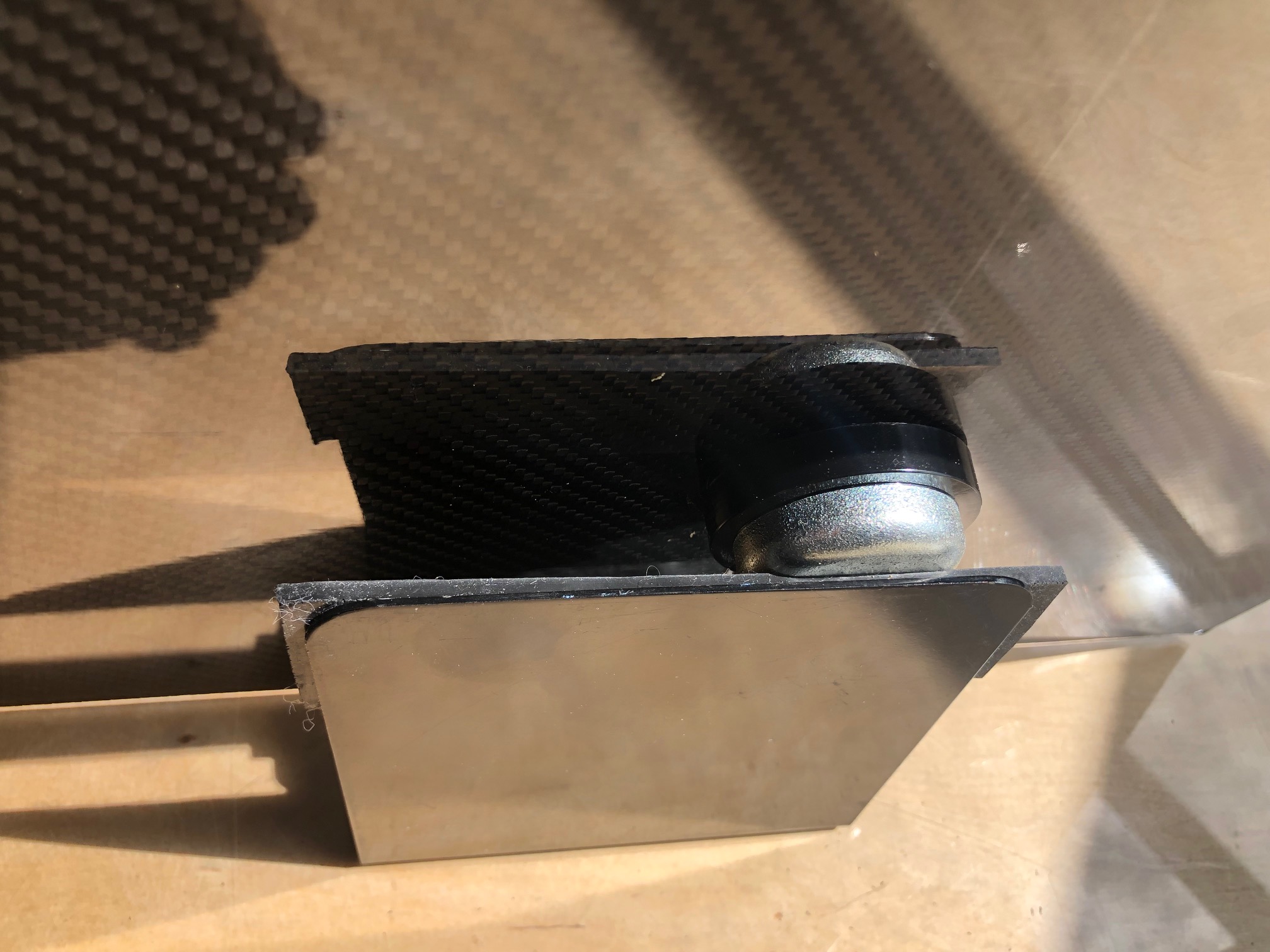

Test panels will be 430mm by 300 mm without rounding the corners.
Why?
Well the first test material is 2mm Carbon Fibre and thats how that sheet comes. I don't want to sacrifice the sheet for some quick tests as CF is expensive, so I will cut ply and XPS panels to the same spec so they are comparable.
I have an L bracket as a stand with the panel standing on a soft polymer pad with the exciter resting against a soft polymer pad.
The exciter will the the Tectonics TEAX32C20-8 I bought before the Daytons.
The spec for this exciter can be viewed here. TEAX32C20-8 - Tectonic | Tectonic.
The exciter has been modded to remove the foam outer ring as recommended.
This mod does make a noticeable difference.
There are pictures below of the CF panel and the stand.
I am alway a bit impatient during development so while I cobbled this together I could not resist a quick white noise test measured using that dB app I found , image also below. I was surprised to see not that much of a difference between CF and the ply I have been using but thats a very quick test and you should not take much notice of that at this stage. When I have finished with all the materials I will post a proper comparison with measurements and subjective impressions.
I also could not resist a quick listen using a few tracks I know well. CF sounds great. Brighter than ply but with great clarity and lots of detail. I see no reason not to include CF at 2mm as a viable material, although it is very expensive compared to ply.
It does look very cool though.

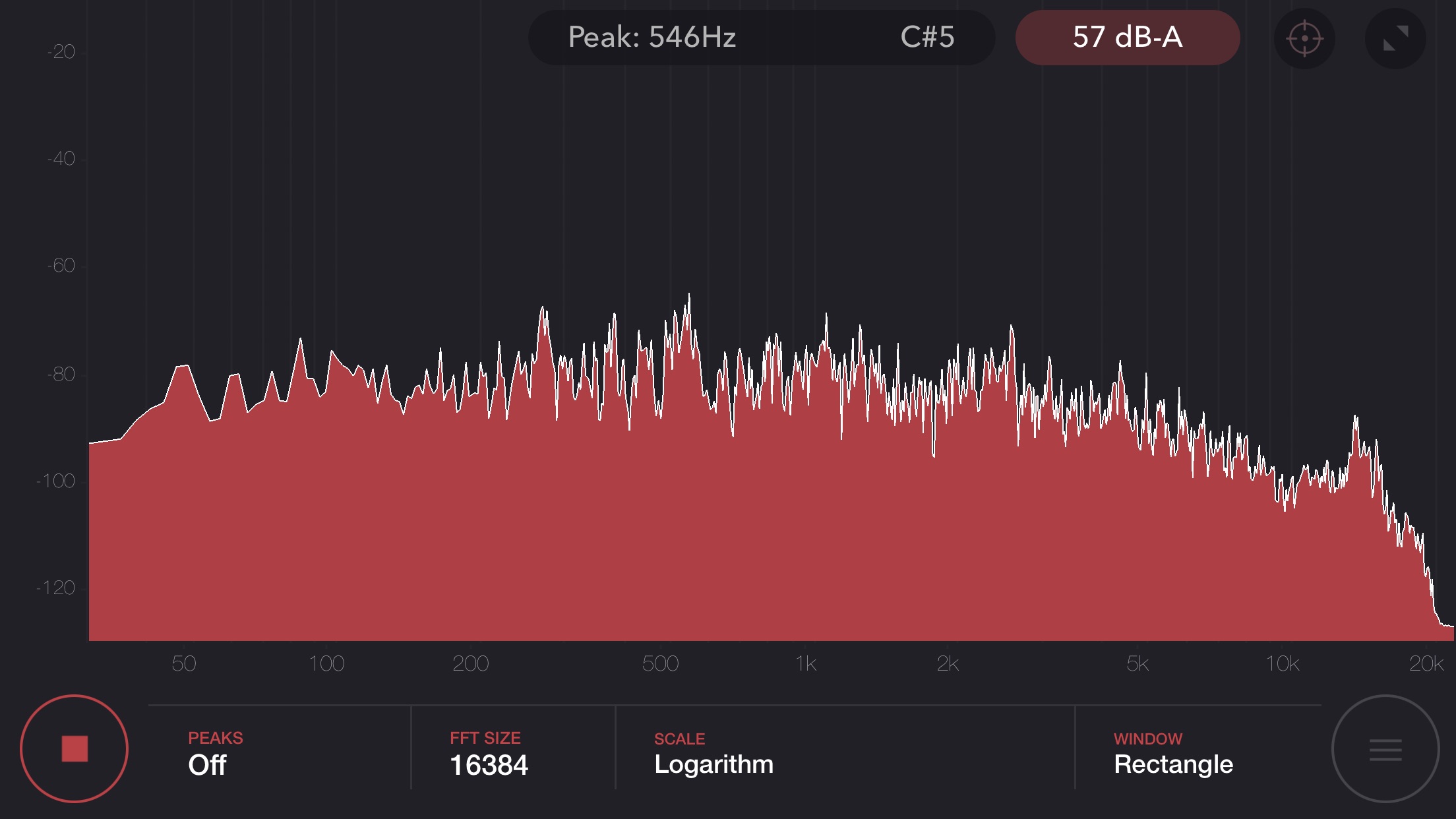

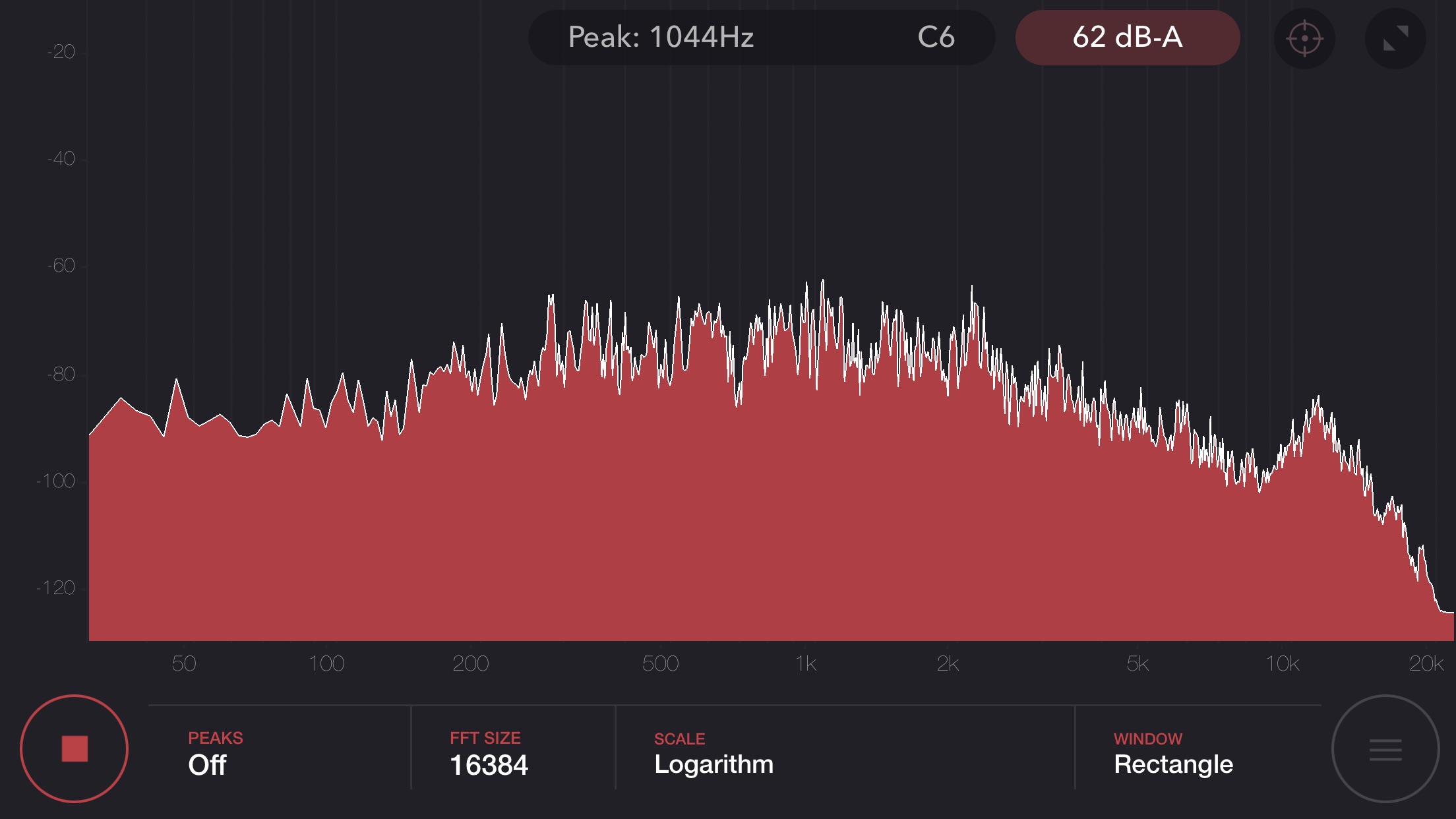

Carbon Fibre 2mm
+ves
Best frequency balance of the three reaching lower and no overt coloration. Better bass, more of it than the ply panel.
Great clarity- reveals an overall coloration in ply which is a mid range ‘sheen’ . This is slight but obvious in comparison with the CF panel.
Cleanest female vocals - clarity and fullness
Brass nice and raspy.
Percussion instruments clear, piano sounds full bodied.
Cello full bodied and resonant
High end clear violin again on ‘Lark Ascending’
-ve
Possibly slightly thin balance?
So on this very casual test Carbon Fibre is a clear winner. Ply is also very good and with eq can have its mid colouration dialled out. Foam board was a big surprise as it is frequently highly recommended. I will try Foam board again with another batch next weekend as it performed so badly there must be a problem with this sheet.

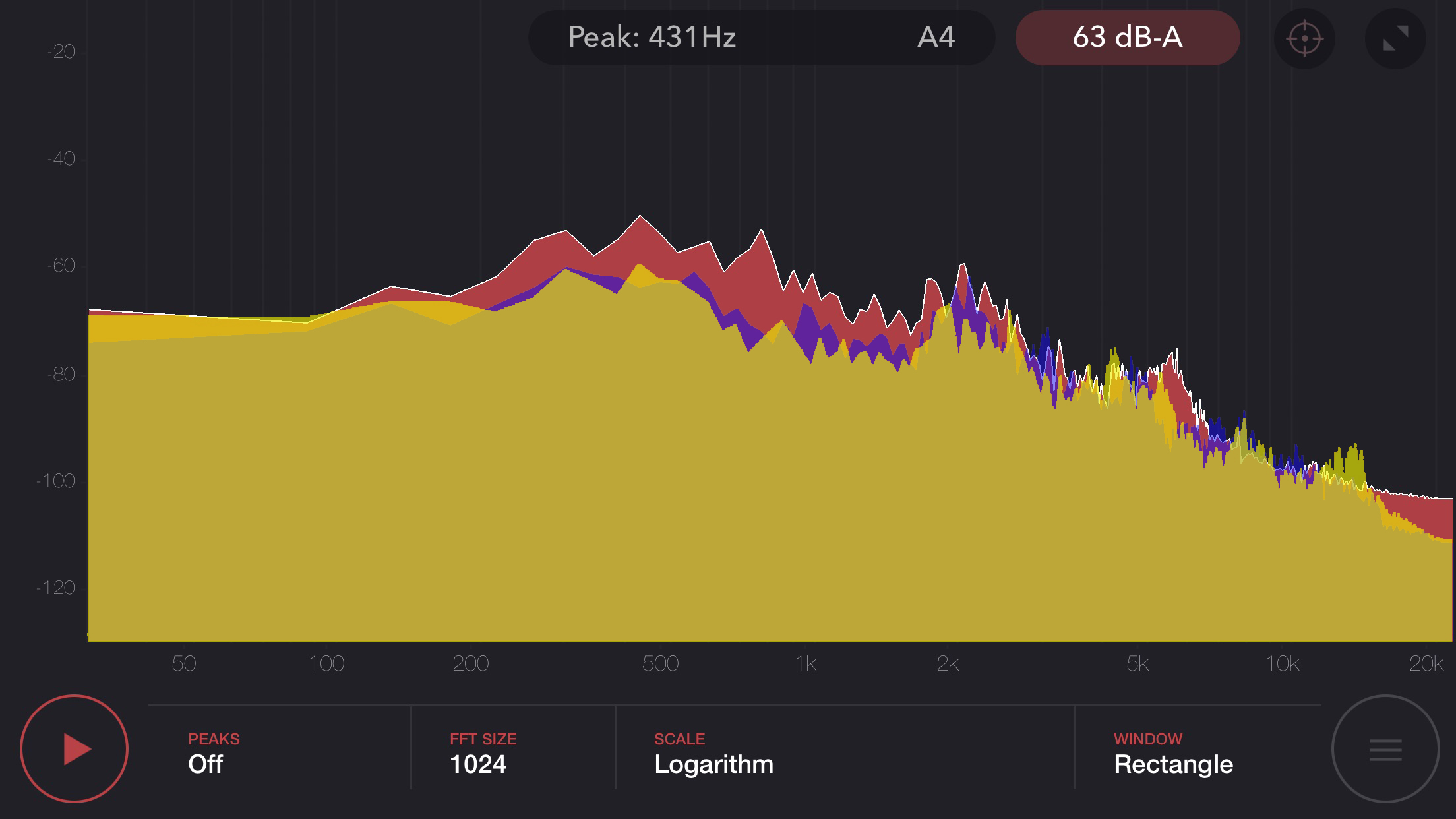

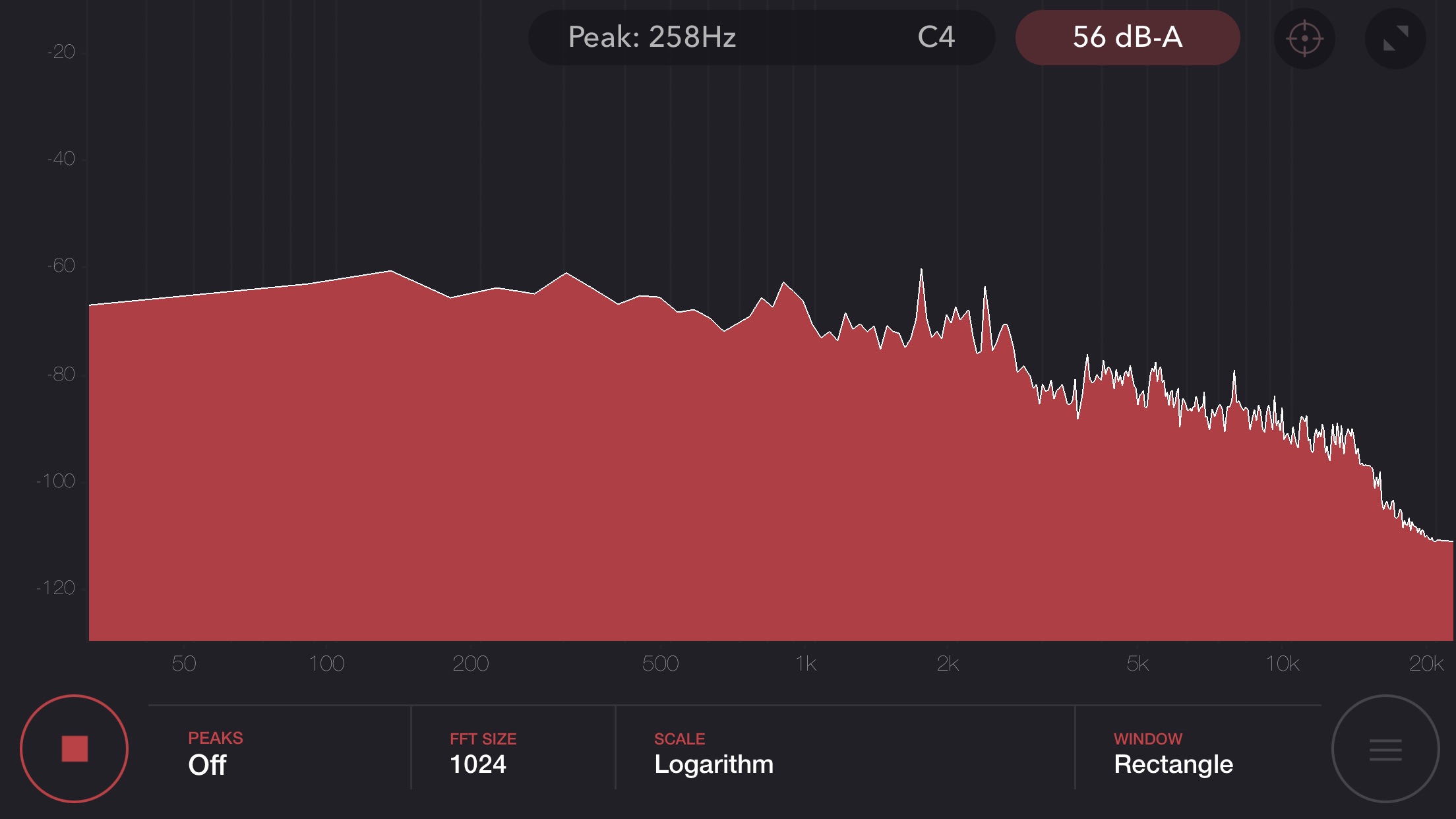

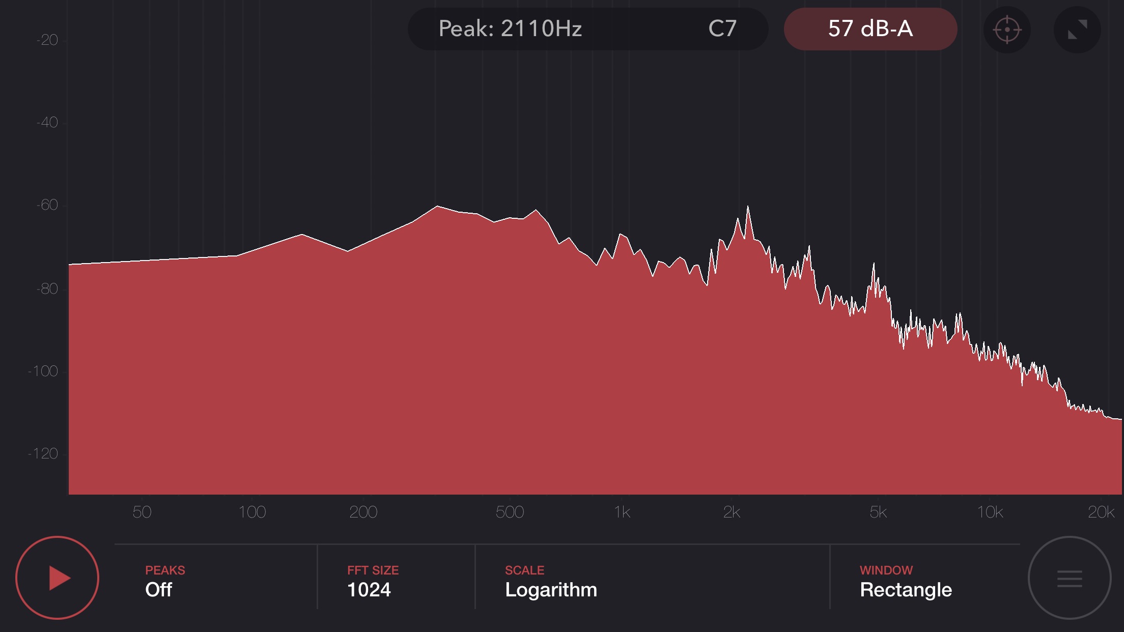

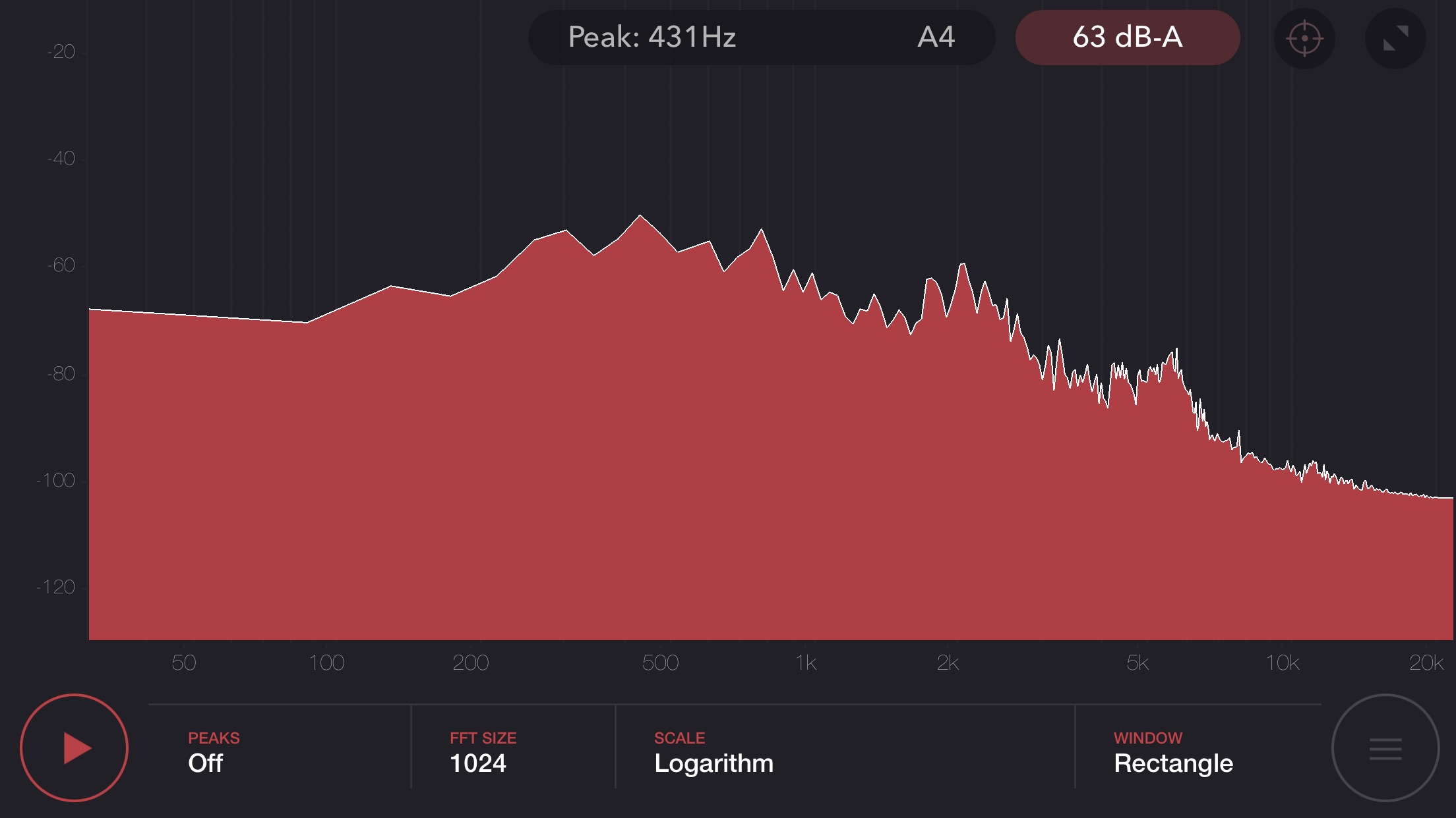

P.S. A note on the images. The images included below are frequency responses based on white noise recorded at 1 metre using the dB App. Image order is 1) Foam board 2) Ply 3) Carbon Fibre
I have also included 4) a composite overlay of the responses for the three panels. Foam board is Red, Ply is Purple, CF is Yellow.
I have also included two additional high res frequency responses I repeated this morning 5) Ply 6) Carbon Fibre.

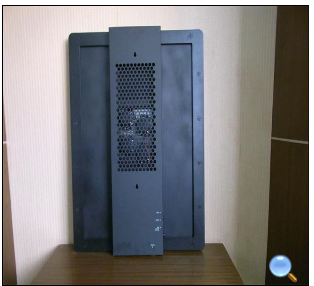

Have you seen the Billionsound sub woofers?
http://www.billionsound.com/products_detail/productId=379.html

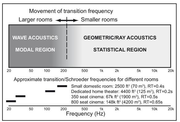

Here's a composite style with brief discussion of MAPs. He includes research paper citations at the bottom of the post.
Jose J. Lopez | Home page
Now, the one thing Dr Lopez says that I think he gets wrong is low frequencies in living rooms. Much of the MAP research was intended for live sound reproduction. It was intended for large rooms and venues. Earl Geddes and others proved long ago that low frequencies in small rooms are modal, similar to a DML. Depending on the size of your room you don't need a DML with good low frequency response. So you wouldn't operate under the restrictions Dr. Lopez notes.
Instead, you'd have two systems of DML speakers in a small room. One designed for ray acoustics and one designed for modal acoustics, separated by the Schroeder transition region frequencies.
Basically, if your goal is small room listening, you want a material and geometry that works well above your transition region. Then you'd want a material and geometry that works well below the transition frequency. Finally, you'd locate and equalize the two systems using different techniques, one for ray acoustics and one for modal acoustics. Which is a godsend because trying to find only one material and only one geometry to cover the entire frequency spectrum is hard and forces too many compromises.

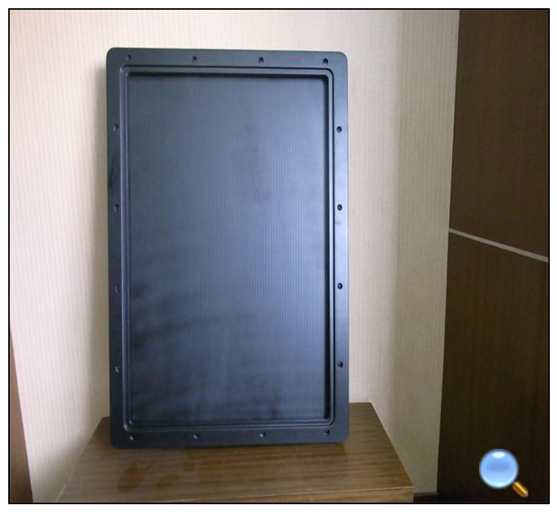

Thank you for the information Bradley. It will be a while before I get to that level of sophistication! I tried the links, thank you for them, unfortunately the
billionsound site is so slow it times out for me so if you have another source I would be grateful.

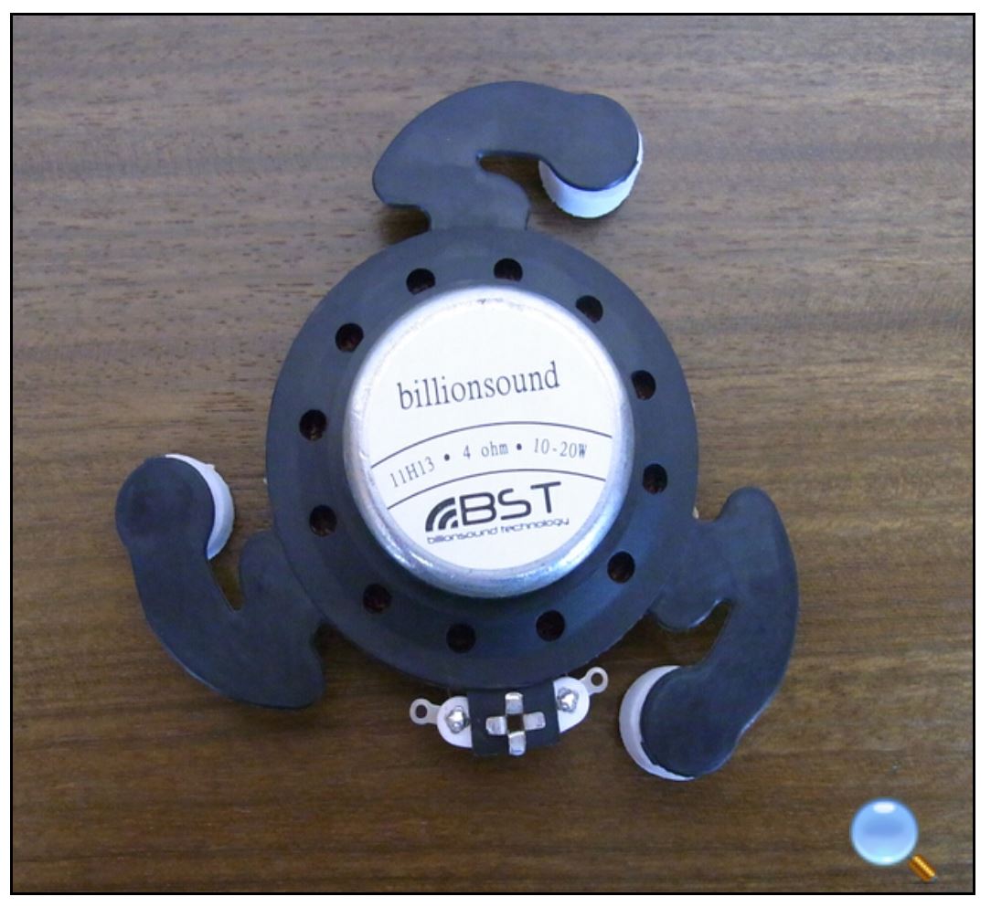

Billionsound supplies Dayton branded exciters. It's a Chinese web site so maybe that's why it's taking a long time to load. It's an interesting site to browse when you're building DMLs.

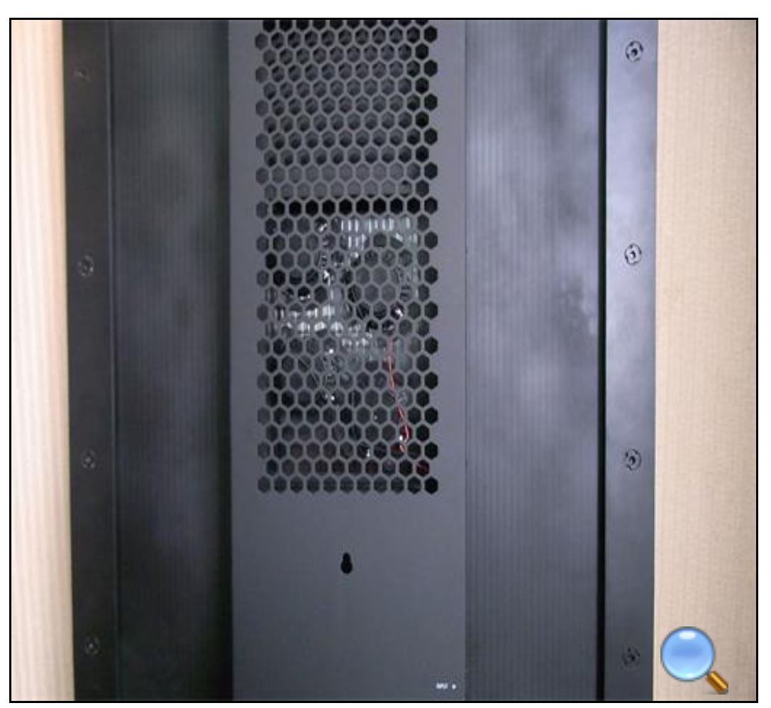

sub woofer Geometry: 750x550x85mm
Exciters: 6 exciters, 100-150W
