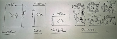

There are a couple of Post on Audio Talk forum relating to Cabinet sizes, here is one I posted in the past, that was agreed on as a correct size, the image with the cutting list never copied, so the Audio Talk site will need to be visited to get the Dims,
as well another cutting list offered by another member in the PDF.

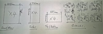

I,ve just done a cutting list for 25mm Marine Plywood.
The Dimension for the Longitudinal Brace is now on the Plan as 765mm, not the 465mm shown.
I've also changed the hole quantity, worked on the dim of 25mm from the top edge of the brace, with 50mm between the holes, this allows for 6 holes on the longititude. So approx 12 holes in this baffle.
Any corrections to offer, let me know, as I will be cutting tomorrow.

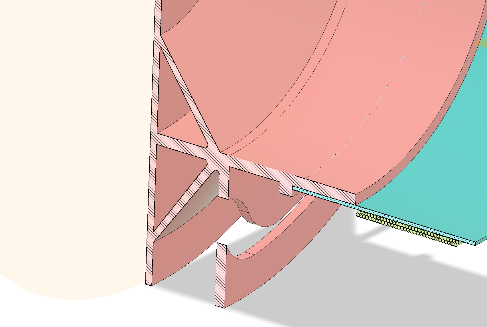

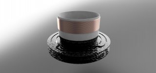

exciter design thoughts

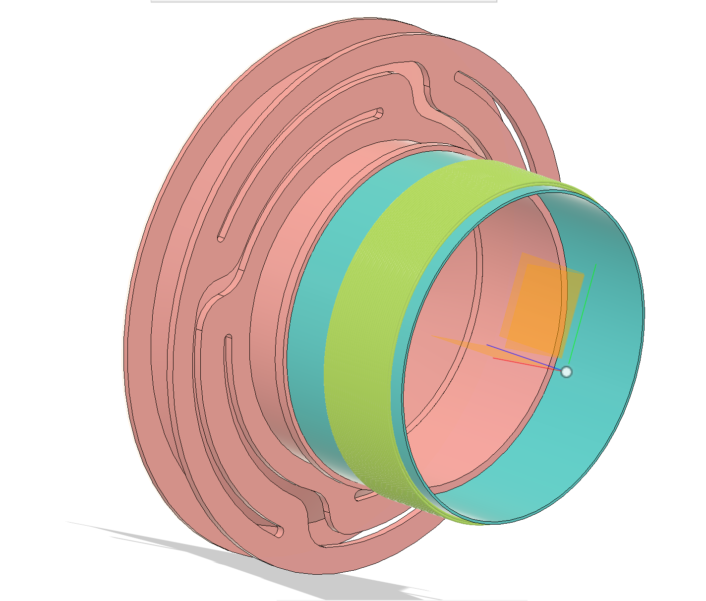

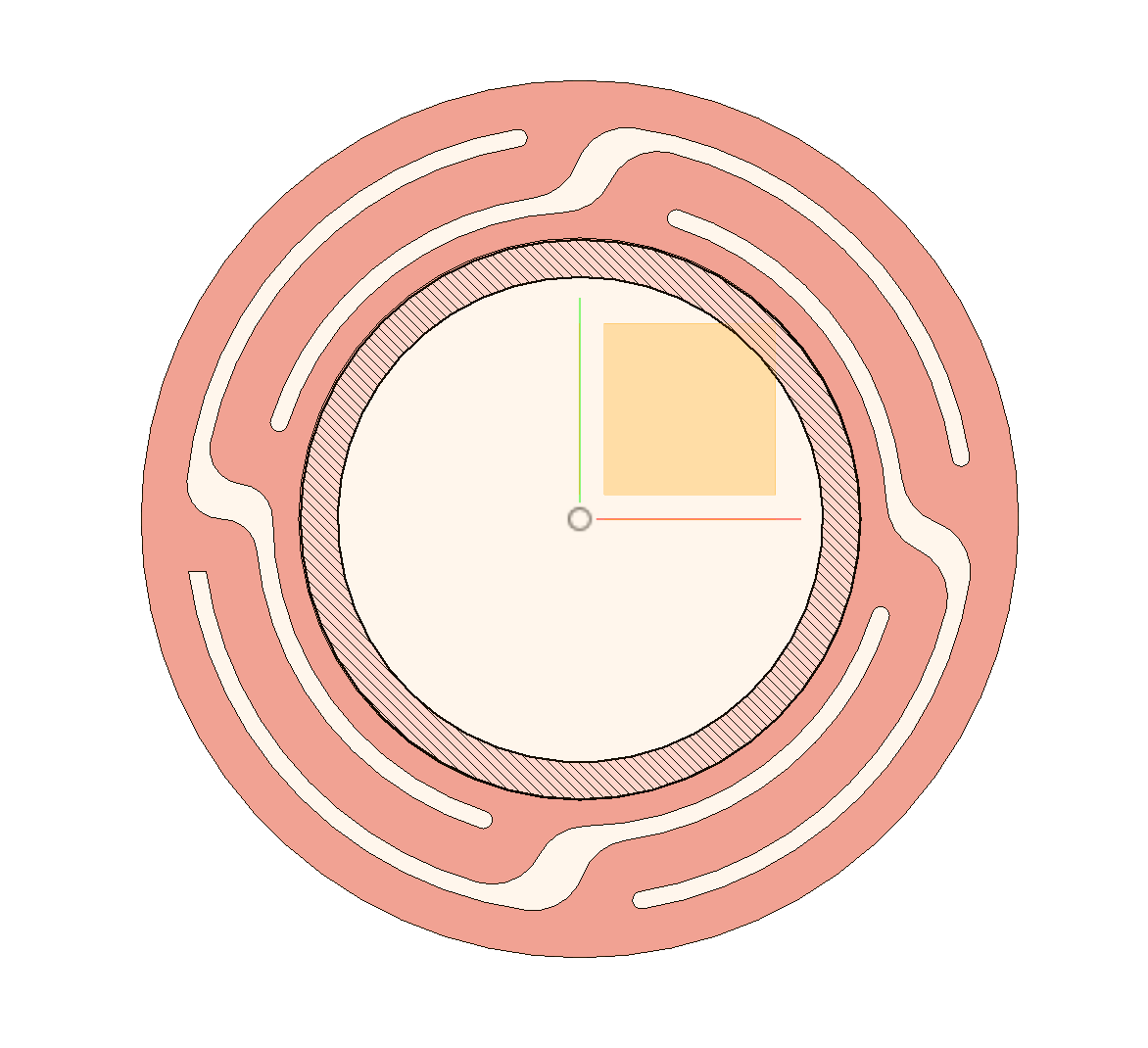

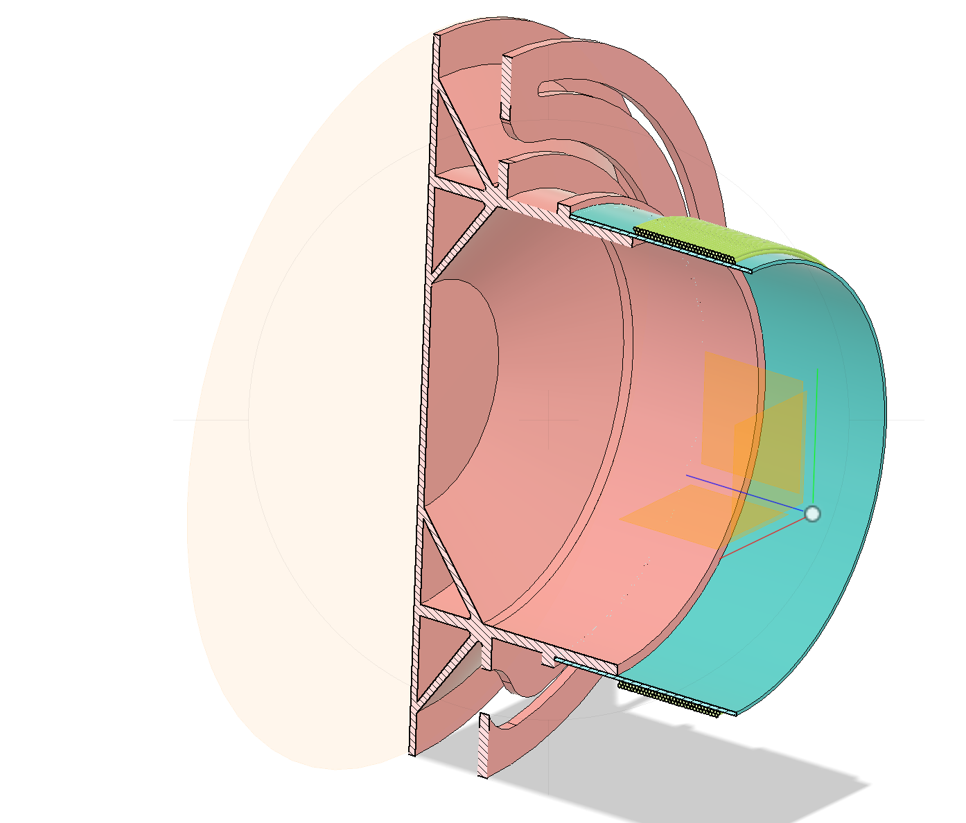

So I have been thinking about exciter design and have had a doodle in Fusion 360 to collect my thoughts. These are early ideas so all criticisms are very welcome.

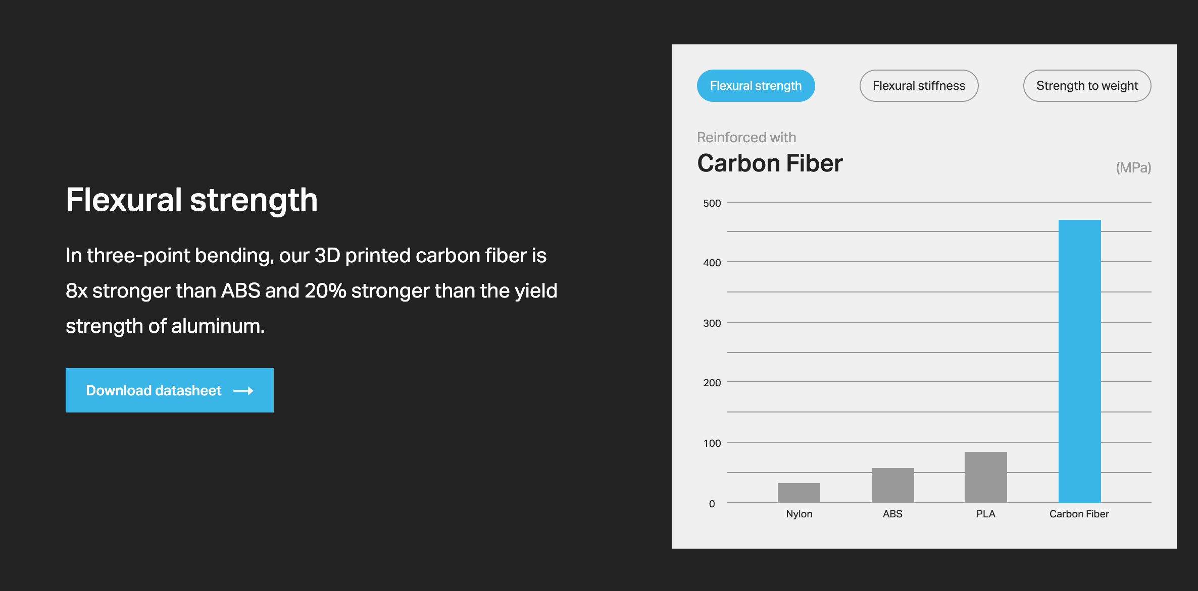

The pictures attached are views of a 3D printed Carbon Fibre reinforced component that combines a spider and a thrust structure that has a much larger contact area for the panel. Sorry about the crap pink colour for the component but F360 applies the colours automatically.
As you will see in the images below, for the spider/ suspension I am using a 2D spiral design as used by Dayton and others, which is flexible along the motor axis but stiff in all axis radial to the motor axis to support the weight of the magnets ( not shown). The only change here is the use of CF reinforced polymer which is stiff ( 10X that of a conventional polymer) but self damping. This will remove the ringing that can happen with a steel spider/suspension. The stiffness of the spider can be changed by altering the thickness of the printed part locally without adding too much weight.
Integrated with this in the same print is the thrust structure that expands from the voice coil in three ‘branches’ to pass the energy from the exciter to the thrust plate. This is a bit controversial as we can anticipate a number of problems.
The first of these is an increase in the moving mass. I hope to offset this by the choice of material and keeping the sections as thin as possible. Currently the CF component weighs 5.2 grams. Looking at the Dayton exciter this is circa twice the thrust structure they use. This can be compensated for using larger or more powerful magnets.
The second problem is that inevitably the ‘branches’ are different lengths. This means that any impulse from the voice coil will reach the plate at different times. The inner and outer branches are longer by 2mm. However the speed of sound in CF is much higher than in air, around 5 km/sec verses 0.3315 km/sec or 15X faster so I doubt that this will be a significant issue. However the added flexibility provided by the additional length may make this more complicated as the structure may flex to a greater or lesser extent. Assuming a very worst case and that the longer branches flex all that happens is that the additional branches are redundant and the additional mass is a drag on responsiveness. However, the 3D printer I use, like most, will not print a large solid volume. Instead it prints the outer skin of the solid and replaces the bulk of the volume with a honeycomb structure that provides sufficient stiffness. This could be a good option for this design if the mass increase is not too great. I will be looking at this option.
I will make the CAD files for this component available once it is finalised. You are welcome to use them in your own experiments and adapt them if you discover some improvements. All I ask is, just like the incomparable Mr Nelson Pass, you reciprocate so we can all share any discoveries. Just like Mr Pass any commercial interest please understand the files are not available for you to exploit. I am a product designer of 30 years experience so I know exactly what to do if you attempt it.
The material is available here
3D Printer Continuous Carbon Fiber Filament Material | Markforged
Other suppliers are available with a search online.

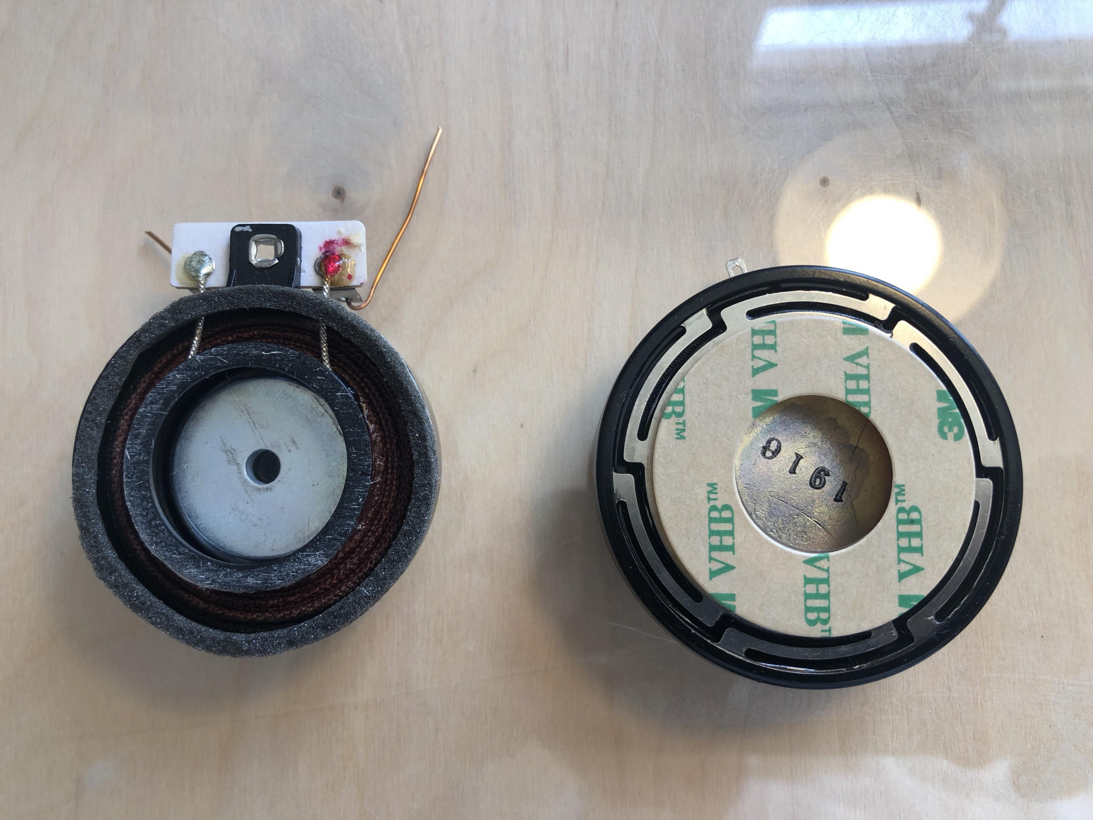

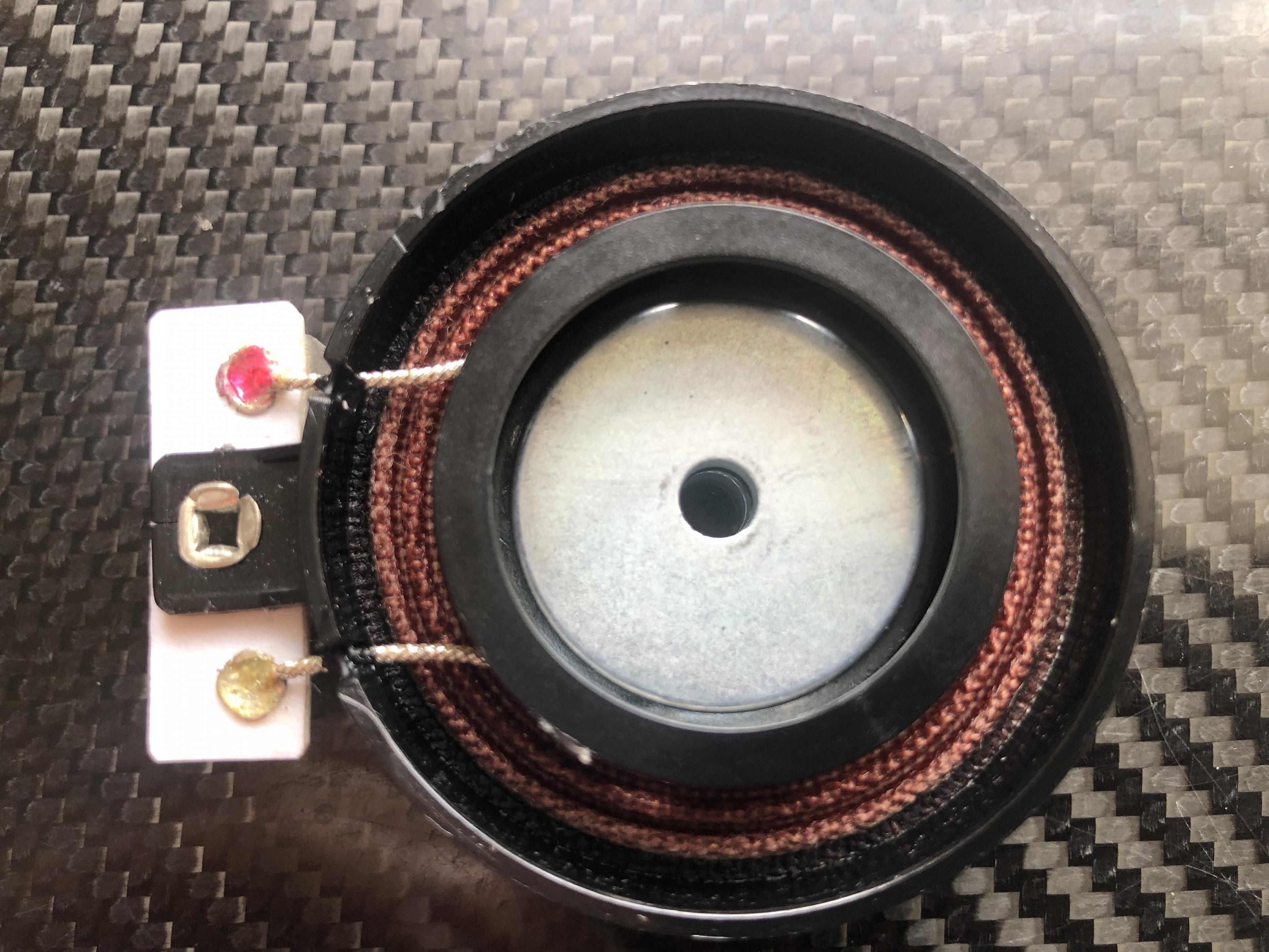

Just a quick additional note on the Tectonic exciters. I think it would be better to use the central hole to mount the exciter motor to a spine using a bolt than rely on the outer support ring. I am going to try this and will report back.
The first image below shows the Tectonic exciter without its support ring foam and adhesive. Note the inner circle is the contact area with the panel which is too small in my view. A Dayton exciter included for reference in second image.

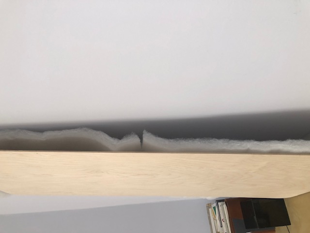

Thank you Destroyer that worked out well. I tried some 35mm thick polyester fibre mats for lining speaker cabinets and the panels sound more open.
I tried the close up to the wall while I am revising the hanging method and to my surprise the sound absorption still worked pretty well, picture below.
I am now back at close to Varaize levels of sound quality with just the sound stage more 'compact' than the big space I have there but still very enjoyable.
I will still follow up on the different panel materials to feed back on the last of the variables.
With the Tectonics, maybe extend the inner ring to gain some clearance from the outer, then could possibly use some form of damping on the outer ring as required. Start with little foam squares?

You are thinking just like the Tectonics designer. The central ring is raised and the outer ring had a foam ring that acted like a damper/support that isolated the mass of the exciter from the panel.
