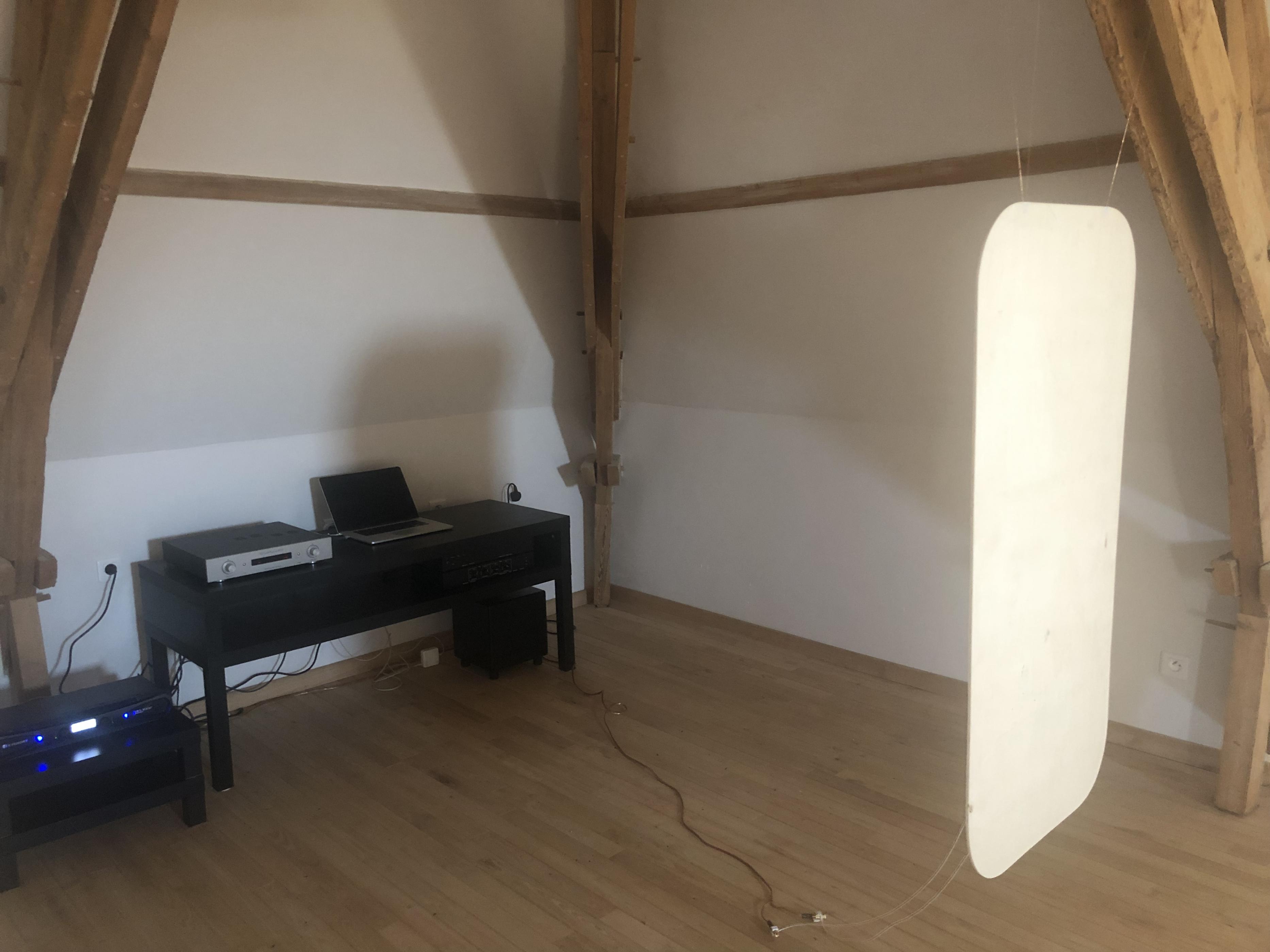

So I am back in the UK and I was keen to try another DML experiment at home.
I thought I would try a different exciter, the Tectonic TEAX32C20-8 32mm, because I was intrigued by its design. I am an industrial designer by training and I liked the dual ring attachment method. I also wanted to try out a higher quality ply, and, to compensate for the lower power of the Tectonic exciter compared to the Dayton Audio DAEX32EP-4 Thruster I had used in France, I went for a thinner board, 3mm. Also, because I had read that bass response could improved by placing the panel closer to the wall, I opted for hanging the panels closer to the rear wall. All of this had the additional benefit of giving the Panels a higher WAF.
Just about the only thing I did not change was the panel size, 1220mm by 615mm.
Soooo. I hooked it all up and…..got Mid-Fi at best.
The sound is compressed and peaks in the midrange. There are dynamics but a cartoonish cardboard cutout dynamics, not the dramatic richly timbral explosions of sound the panels in France had delivered. Detail was subdued, female voices were had a mlld nasal quality. Hmmmm.
Well it was my own damn fault, I had changed almost every element of the system other than the panel size.
I tried some severe EQ which helped but the detail loss and subdued dynamics remain. I am using way more EQ than the panels in France.
This is a shame as, given all the results reported using all sorts of exciters and all sorts of materials, I was beginning to think the DML system was very robust. Not true, implementation appears to be important.
I am going to do a rebuild next week using the same sort of cheap (very) ply stock I bought in France and I am going to order up some Dayton Thruster exciters so I can replicate the French system. I will let you now how that goes, but generalising from the result to date.
Thin boards don’t work as well as thicker boards
As the weight of the new panels are similar to the French panels that suggests material density is a critical factor
The thicker board is also stiffer- so high stiffness and low mass works best.
There may be a relationship. probably is, between exciter size and the energy it can impart and board size- all of the Pro-Audio panels use four exciters per panel.
Close to the wall is a problem, not an advantage, there is a lot of colouration introduced by close proximity to a wall. It might increase bass, it didn’t in this case, but I can’t live with the colouration.
I am not going to comment on the Tectonic exciter other than to say one of them appears to be developing distortion after barely five hours of use. I am not impressed with Tectonic’s QC but that doesn’t mean the design is wrong.
More news latter.

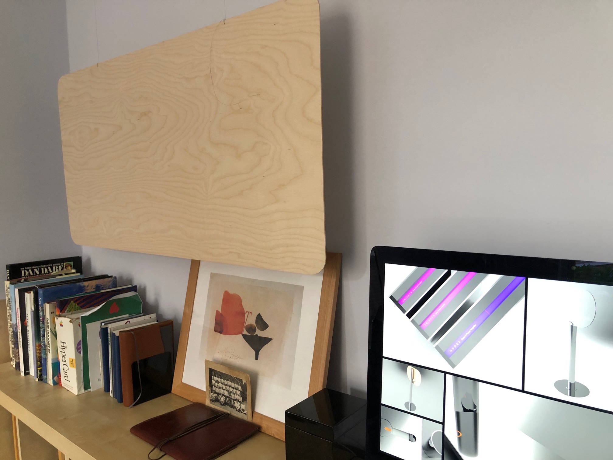

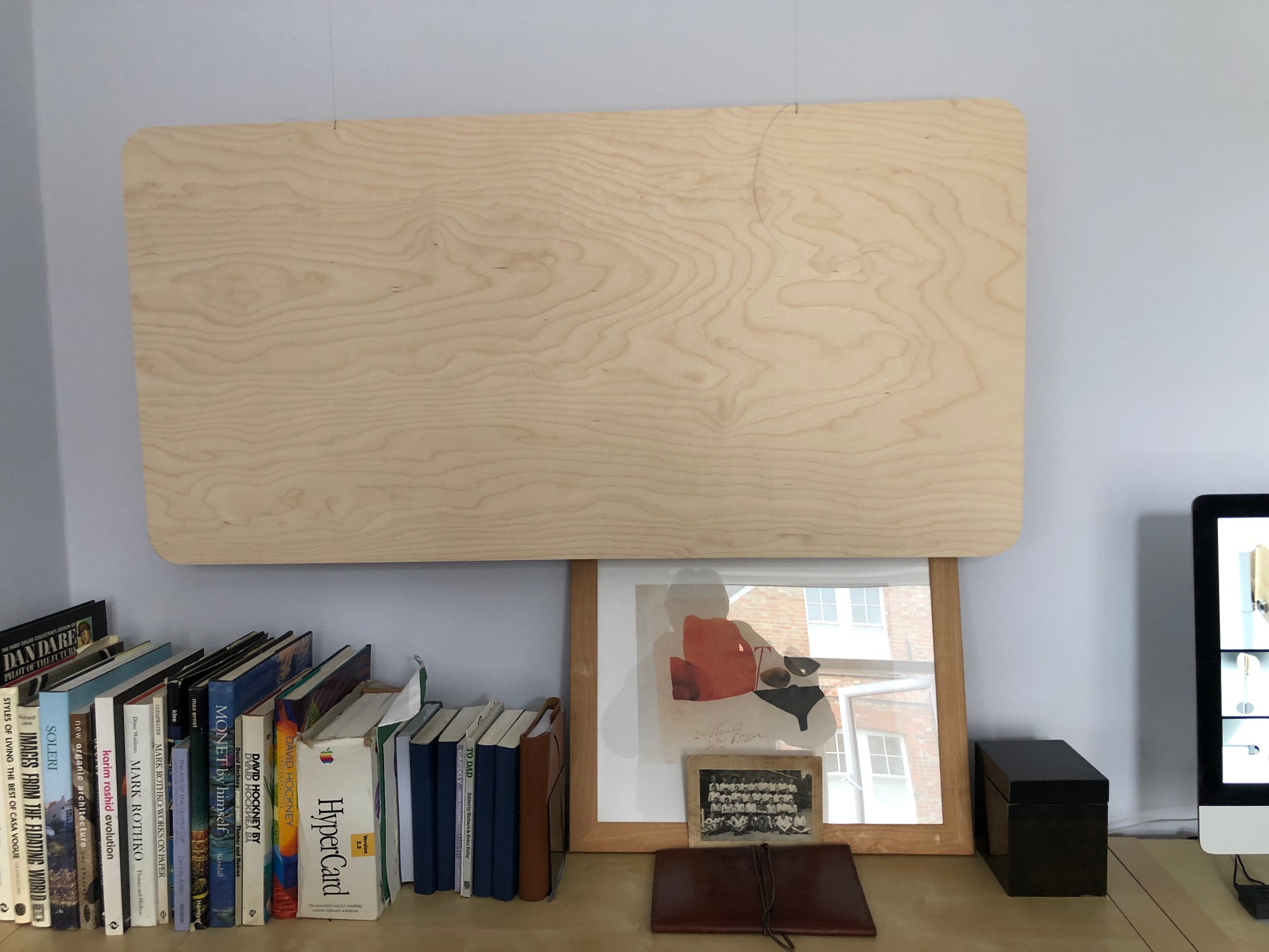

On WAF I am sure that varies from wife to wife! I am getting away with the images attached. The panels are about 6 inches from the back wall.
I spent some more time last night EQing and setting up the subs which helped, however one new thing I have discovered this morning. There seems to be a minimal volume/energy level at play with this combination of exciter and board size. When played louder a lot of the colouration, in particular the nasality on female voices, disappears. I also get a better sense of timbre and dynamics. This is a speculation but I think the panels were not getting enough energy into them to allow a fully modal condition-just a guess but thats what I heard.
