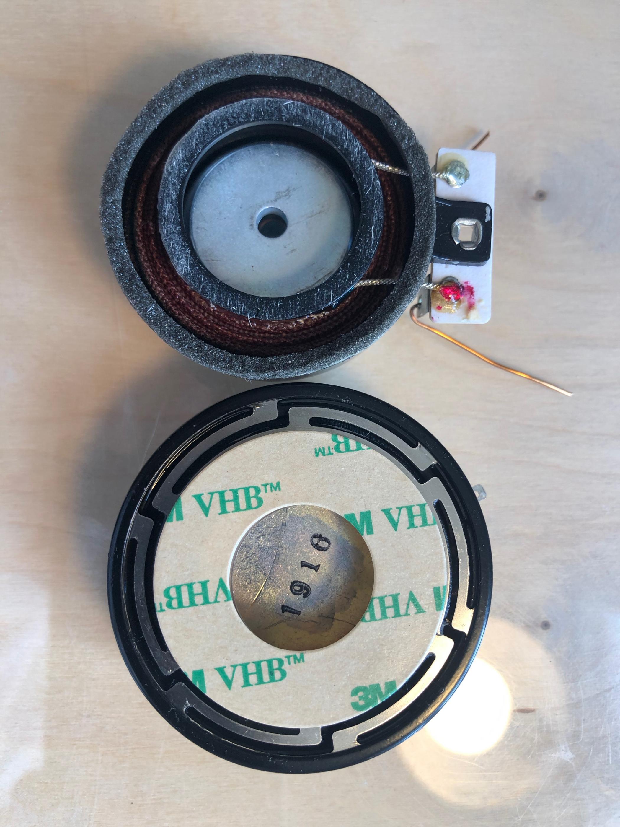

I received the Dayton exciters today and will begin to experiment with them over the weekend.
One of the things I want to do first is a small mod to the spring steel spiders you can see in the photo attached. With the Daytons on the panels in France I noticed the spiders would ring at certain frequencies. This was not noticeable with music but I did a few frequency sweeps and they really take off when you reach their resonance point. I am going to damp them with a small line of silicon sealant mid point on each arc.

So this is the first feedback on the tests I have been trying this weekend.
All I have tried so far is swapping out the exciters and the Daytons are a much better match with the panels I have. As a reminder this is a 3mm thick birch ply panel 600mm by 1200mm.
I stress the Daytons are a better match to the panels I have. This is not to criticise the Tectonic exciters in anyway. I note that the Tectonic exciters are usually used in multiples of up to 4 on the Pro-panels I have seen and I have no reason to believe that a similar arrangement might not work fine on a panel the size and material density I have. Certainly to my ears there appears to be a volume threshold below which I get a lower quality sound using a single Tectonic. Above that and the Tectonics sound acceptable if not a good as the Daytons. The Tectonics also run into distortion problems at high output levels that the Daytons cope with happily. I think multiple Tectonic exciters would not exhibit this limit.
So how do you explain it?
This is just a hunch and needs to be taken with a bucket of salt but I think it might be how well the exciters are able to transmit energy to the panel. The contact area of the Tectonics exciter is about half of that of the Dayton exciter ( 51% by calculation) which might be a factor. In addition to that the Tectonic masses 150g, there is no figure given in the Dayton spec sheet but it feels a little heavier using the patented BurnCoil juggled mass method. This mean a bit more 'resistance mass' to the reaction force as currently the exciters a free mounted and do not have the benefit of a strut to support the rear.
Then there is the motor design where, surprisingly, the Tectonic has better numbers if I am reading them right. The 'Force factor" or BL for the Tectonic is 76% higher for the Tectonic exciter so for a given voltage it should generate more energy. Bit of a puzzle that one.
Then there is DMLBES's suggestion that the support ring on the Tectonic is a bit of a design flaw and needs to be removed. It needs to be explored, but if you will forgive me I am going to save irreversible mods until a little latter.
I stress that multiple Tectonics might work fine with large relatively dense panels and using a smaller lighter panel might suite a single Tectonic exciter just fine.

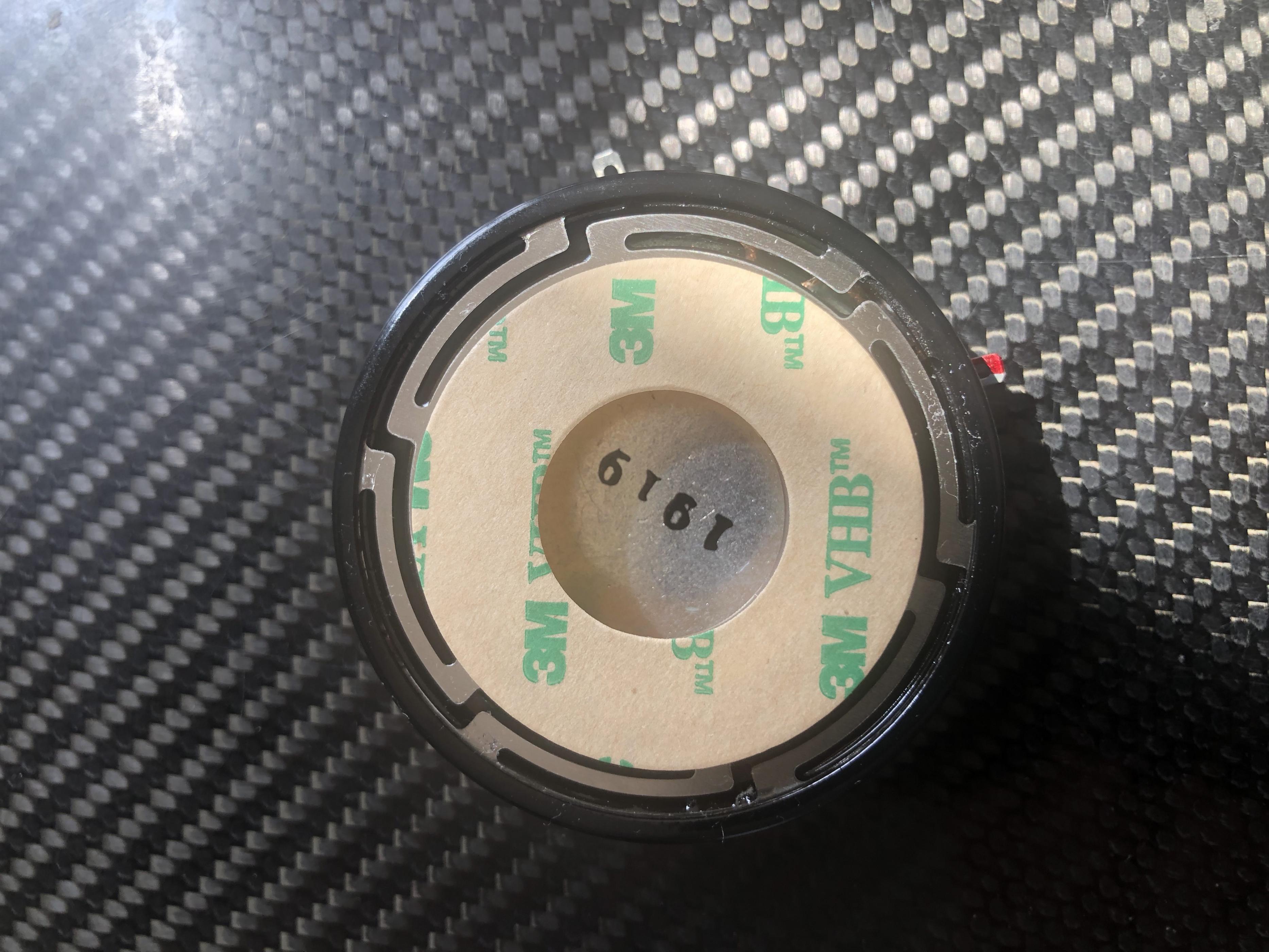

Next up
- Dealing with rear reflection
- Alternative panel materials- including CF jimk04

Just to add that there are differences between the motor design that might compensate for the difference in BL. The Tectonic exciter is an 8ohm coil whereas the Dayton is a nominal 4ohm. Force is provided by BLI so as the current flow will be higher in the Dayton that means the two motors real world performance may be very similar, which leaves the contact area as the most significant differentiator, maybe.
Sorry xrk971 just catching up. No I am still using the birch ply. Carbon Fibre is further down the road.

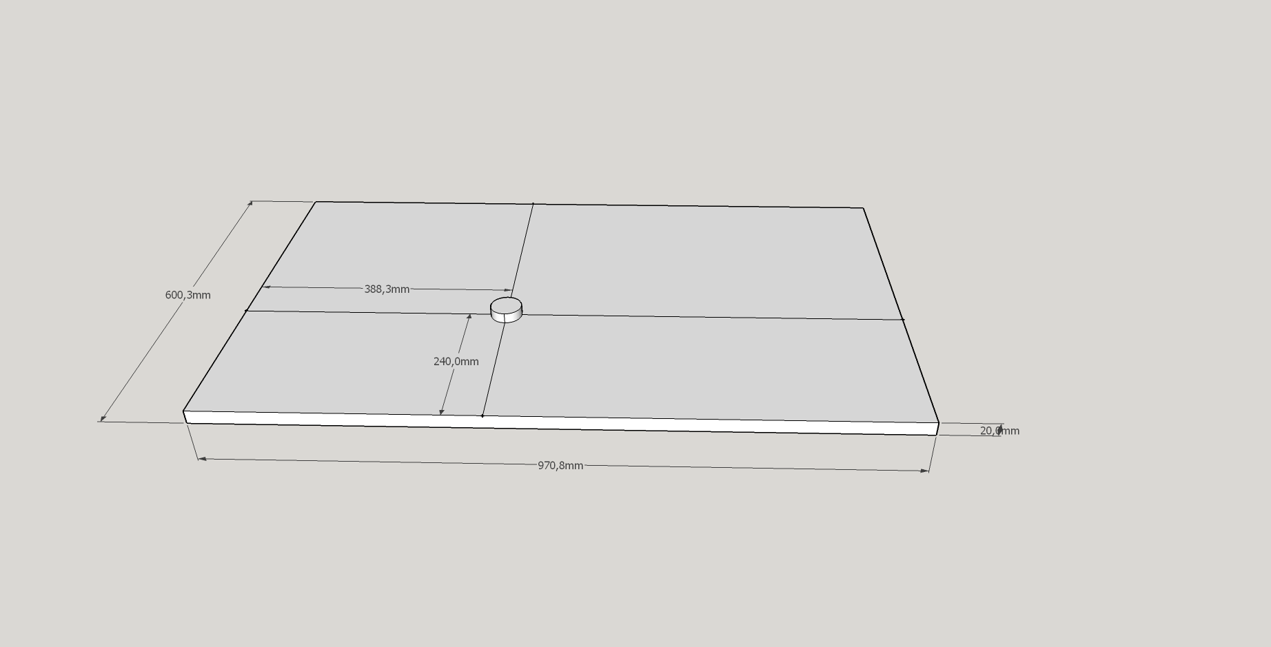

I just recently heard about Distributed Mode Loudspeakers and it sounds quite interesting. I've been trying to read up on it and find some guidelines.
Being an thinker I prefer to have things planned before I consider starting so I am looking for some guidance here on whether my findings are at all accurate.
Sources
Sound Solutions Vol. 2: Building a Simple 2'x2' Distributed Mode Loudspeaker
DML Flat Panel | Parts Express Project Gallery
DIY Distributed Mode Loudspeaker | HiFiVision.com
Materials
The board
Firstly, the materials suggested seem to range from Carbon Fiber, to Plywood to Balsa wood and XPS Styrofoam.
I've been looking at Styrofoam, more specifically This sheet of XPS (2400x600x20 mm)
STYROFOAM 300 BE-A-N 423-020 | Beijer Byggmaterial
I've seen several build from 1" thick styrofoam but this being Sweden we only do inches for lumber and nails.
Driver
Dayton Audio DAEX32U-4 Ultra 32mm Exciter 20W 4 Ohm
The listed driver has been mentioned in several builds related to XPS.
Plans
So, what dimensions to use?
I think using the full width is a good start. But how long should it be? I saw someone mention the golden ratio, so I multiplied the width of 600mm with the golden ratio. This means my board will be
600*970
Placement of the driver has been a bit less specific, but I think I saw someone mention 2/5 from the edges. I've drawn an image to show how what this would mean in my case.
I am not sure what is up or down, nor do I know whether the left speaker has its driver away from the right speaker.
Treatment
As far as I understand, the XPS needs to be sanded on both the flat sides to remove the outer layer. they should also be rounded around the edges in accordance with the first link amongst my sources.
They are then to be treated with a 1:1 mix of water and wallpaper glue.
Questions
Are my plans anywhere near valid?
do I mirror the left and right speakers?
Will they work ok with my Nad 356BEE?
Can I just screw these in at the top to get mounting points or do I need to reconsider? https://www.jula.se/catalog/bygg-och-farg/beslag/inredningsbeslag/skruvkrokar/skruvkrokar-313509/
Please ignore the lines on the drawing, they are only there to help me with placing the driver.

@ blompa; I have not made any DML panels, but read a lot and that looks good to me. I would use the golden ratio for the driver placement as well and mirror them for L and R.
I would round over the edges and the corners.
Paper and wall paper glue is an interesting choice. But will this stick well to the styrofoam? Will it stay firm over time?
//edit:
I made the paper up 🙂 but would add it as the idea of putting something on top is to make them stiffer right? Paper is light and stong and would make the panels stiffer.
Why would you only coat them in wall paper glue?
My thought is that polyurethane spray glue might work better. (with paper)
Super thin woven fiberglass cloth (model airplanes) and epoxy (add UV blocker to prevent yellowing over time and/or coloring pigment if you like) would be the lightest, strongest and most durable option I can think of.
NAD 345BEE drives 4 - 8 Ohm and the exciters are rated 4Ohm; so they will work together but be carefull not to burn the exciters as the amp can put out more power then the exciters can handle.
I would make the mounting eyes on the panels as light as possible; 2 pieces of bamboo or tooth picks pressed flat in the top of the panels, which you laminate over with the paper and glue. Drill a little hole under them so you can tie the wires to them.

@blompa your approach is great. one detail. The mix used to coat the sanded surface is 1 part water to one part PVA glue, not wallpaper paste. That might work but the tested method that people report as being successful is the use of PVA glue. You might know this as wood glue, it’s the white glue you may have used to assemble wooden cabinets for loudspeakers.
In my experience the panel aspect ratio is not too critical but the golden ratio always works well visually. The 2/5 guideline on exciter placement works well
You will also need to eq the panel output to get a flat response as the EPS foam is reported as raised at high frequency. I would also recommend a subwoofer crossing over at 100 hz as bass is limited.
