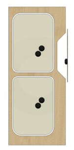

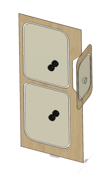

Yes through out the years I have built many prototype DML panels.
My favorite designs are ones that use a Frame to support the panel material and a brace/spline to support the exciter in place. They are basically Floor standing DML panels, instead of the hanging from the ceiling by a string.

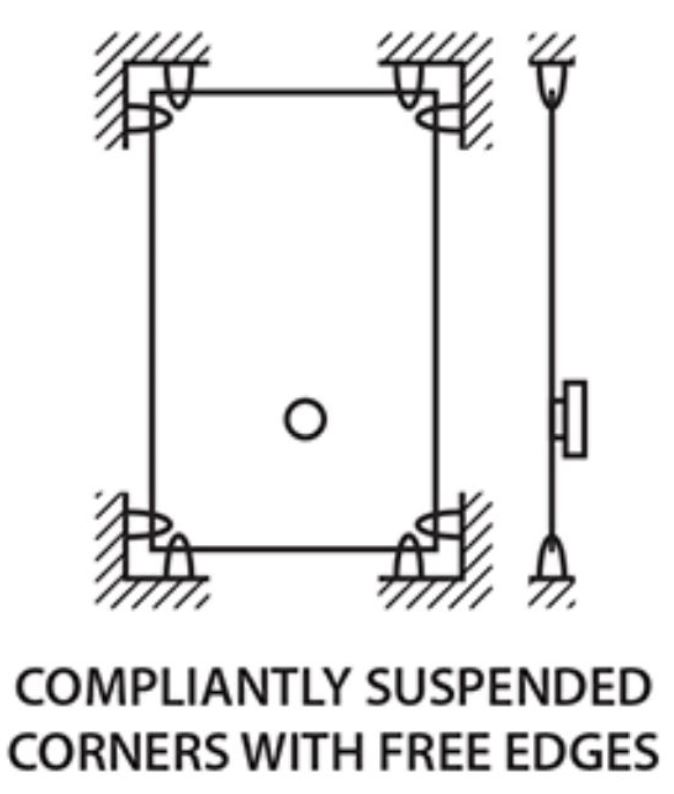

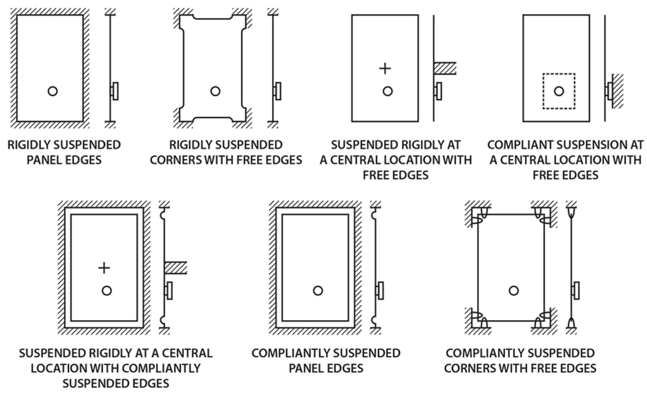

Frames, edge dampening, and panel suspension are all different things. Frames are mostly protection for shipping and handling as well as cosmetic. Edge dampening, in contrast, influences panel modulation. The goal of dampening is to encourage the panel to vibrate as randomly as possible by controlling edge reflections. However, edge dampening isn't the only way to encourage random modal behavior. For example, one common alternative is to round the corners of the panel.
Finally, the panel can be suspended in various ways, too. Even from the center as you can see in the image attachment. (source: Dayton Audio Exciters Buyers Guide)
Suspending a panel with strings is one option among many. If you think it looks nice to suspend your speakers in the air, do it. If you like how suspending your panel in a frame looks, do it. Then, choose a dampening strategy that works with your choice.
Once you understand the various methods and what they accomplish you'll have a lot more flexibility in your design. The Dayton Audio site is an excellent source of good DML information. When you see Dayton's notes about bass in their reference just remind yourself that you might not need bass in your DML.
