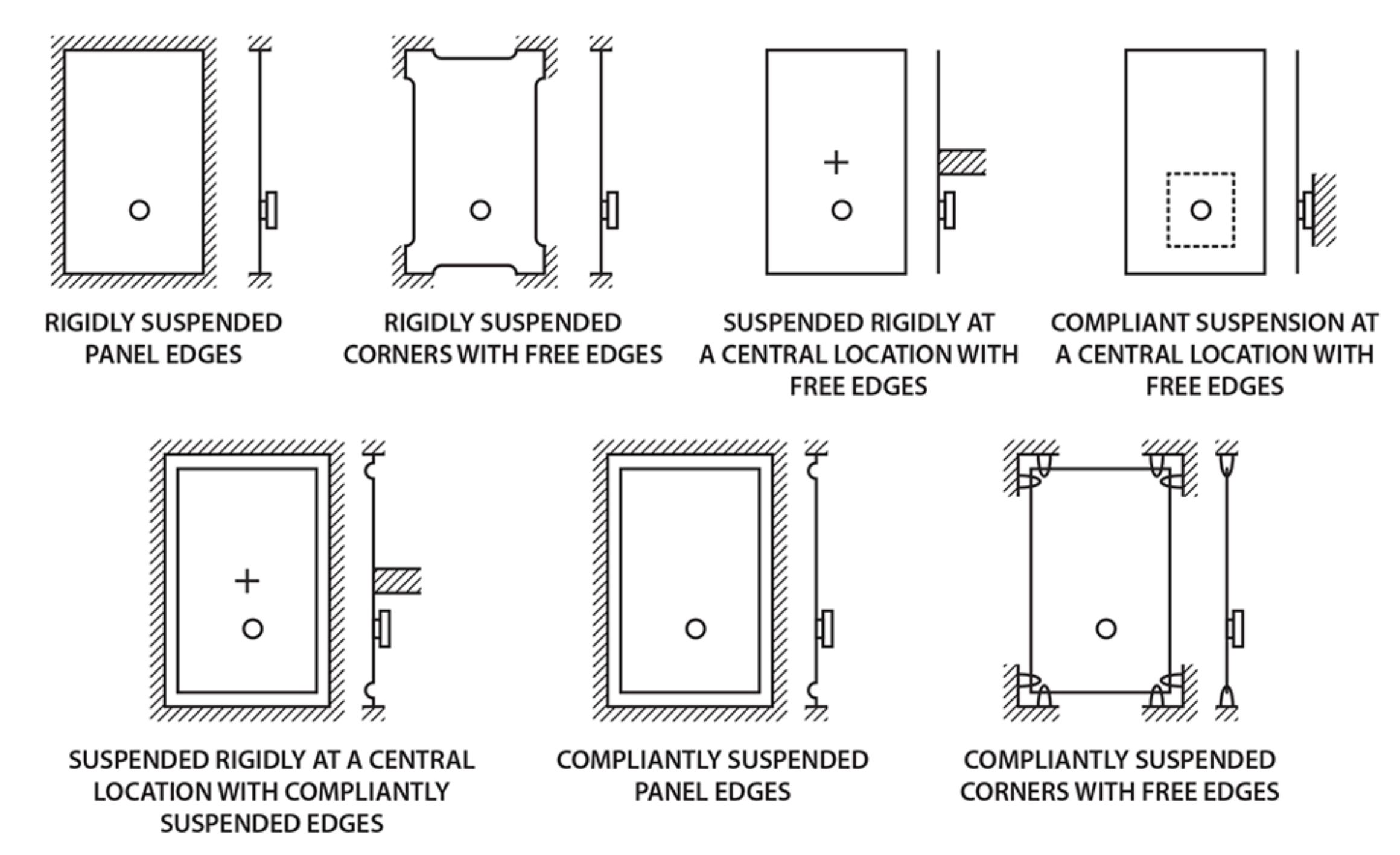

This image from Dayton's web site is always a good one to remember when designing DMLs.
The method you use to dampen your panel (mitigate ringing/resonances) will help you choose how to support your panel - or vice versa. For example, if you use internal damping you might not want to use a surround. It all just depends on how your design fits together as a whole.
Its in plain site as those Dayton images show what I have been saying forever that damping is done on the edges like the surrounds on a conventional cone speaker.
