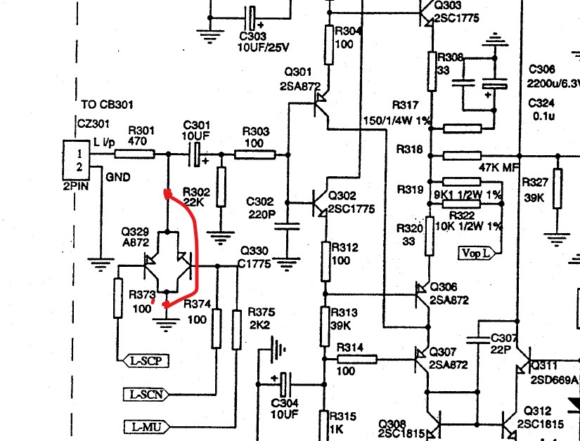

So is it a power amp problem or a sudden change in input voltage. Try linking out those mute transistors and see if it alters the fault.
I linked Q330...
Before hooking up the speaker I measured at the terminals.
Now the protection/bulb lighting cycle takes much longer (6 or 7 times) before the relays close.
When they close it looked like a smaller spike unless i'm mistaken. Before the short i'm fairly sure the DM showed OL in the V range as well as mV range. With the short OL did not appear with V but only with mV.
After trying with the speaker it still causes the pop.
I used the min/max feature on the DM to check:
power on...
Bad side: Max => 1.3V ... Min => -3.3V
Good side: Max => 1.16V ... Min => -1.17v
power off...
Bad side: Max => OL ... Min => -0.02V
Good side: Max => 0.04V ... Min => -0.01V
So the powering off spike is clearly different - but powering on is not such a huge difference but there only a pop on the bad side.

Thanks for all those readings... and I'm struggling to think where we should begin with this tbh.
You haven't got it accidently set to bridged mode (little switch at the back) ? Nope, didn't think so...
I think we also have to try this on full mains before getting to heavy delving any further. You should turn the bias back down first for safety though.
This may sound a strange thing to do but when the amp is on and the offset is near zero do you still hear a pop if you select/deselect the speakers using the front panel switches?
I'm just wondering if there is any kind of instability present which wouldn't show on a DVM (that needs a scope). That could cause a DC shift in the output but because it is an AC quantity you could think you are seeing zero volts DC on a meter when in fact there is an asymmetric high frequency signal present. That's a bit of a far out theory however 🙂

hmm, that short in the left channel really does seem to affect the right channel too!
with short..
Bad side: Max => 3.3 ... Min => -2.03
Good side: Max => 1.13 ... Min => -1.17
without:
Bad side: Max => 1.14V ... Min => -3.23V
Good side: Max => 0.008V ... Min => -0.072V

The original issue of crossing the wires over on those two small plugs could have caused the channel that blew to oscillate intensely.
Is R359 OK. Its a 10 ohm resistor in series with a 0.1uF cap.
Check this before doing anything else.

Does the right channel audibly pop with the short in place?
The output side of the relay is effectively floating until the contacts close so you have to measure from ground and to R20 or R21 to get a true result. It doesn't matter which end of the resistor you measure to as they are across a coil (which appears as a short at DC).
It remains silent with or without - which baffled me after seeing the measurements.
Good, that's how I was measuring.
OK. Check that resistor I mentioned above... we were posting together.

R359 measures 10 ohms 😉
