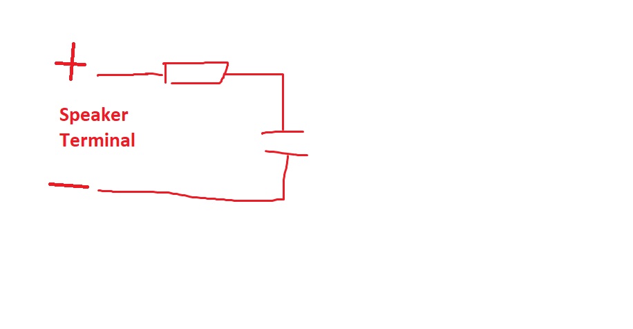

I'm assuming you haven't a scope so lets try a little trick instead. If you connect a resistor and a cap in series across the speaker output do you see the same offset voltage across the cap as across the terminals. Lets say use a 1k to 10k resistor and a small cap. A non polarised type would be best like a 0.1uF but even a small electrolytic would do.
The R and C form a filter that will remove any high frequency AC and leave just the average DC value.
Any big difference in the steady state offset result.
No scope i'm afraid.
I wired up a 10uF electrolytic in series with a 10k resistor.
The steady state offset is pretty much identical across the cap as across the terminals. 😉

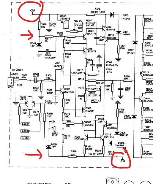

We should always measure the rails in any fault-finding exercise. In particular are the - and + 68 volt lines correct. These feed the front end section of the power amp.
We need to measure these and confirm they are OK.
Are the - and + 18 volt supplies OK? These are across the Zener diodes D301 and D302.
The 10k feed resistors R310 and R316 would be prime suspects as they are listed as 0.25 watt parts and they dissipate... 0.25 watts 😱

Those rails are OK but how about these? Are we on full mains now or back to the bulb?

I tested D302 and got 17.4V.
I went to test D301 and slipped - a small flash, not really any bang just a small fzzt.
Anyway, I frazzled D301 and will need a new one. I tested all the resistors around it and they are OK...bah!

Hmm... accidental shorts, it is so easily done. Do you know what you touched and to where...
If it was a rail to the Zener then the Zener is probably short. If it was 'something else' to the Zener then you have pulled current through other parts which may have caused a problem.

Pretty sure it was the little bar that runs directly underneath the zener - 3J24.
This appears to connect R309 with R310 along the +V68 track - fingers crossed it was only the zener that got hurt.

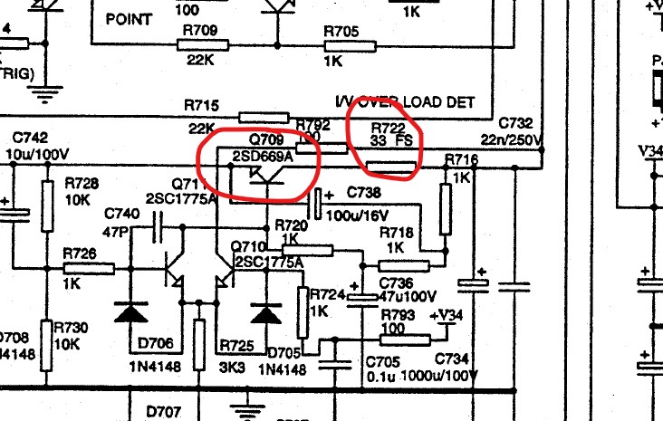

So it looks like the +68v line got shorted to the Zener. If it was the striped end of the Zener then the Zener will be zapped. If it was the other end then that is ground and the Zener would be OK.
Either way the +68v line took a hit. Now that line is stabilised and so it's worth checking the 33 ohm fusible resistor and also that the transistor isn't short circuit. The resistor should protect the transistor but you never know.

Yes, that resistor looks like its gone open - the transistor looks OK.
