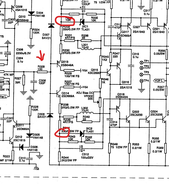

I've given this some thought and I think we have to concentrate on the theory that the original fault was pretty much self contained around the output and driver stage and so that at this point it would be illogical to go looking at weird and wonderful reasons elsewhere for the problem.
You are going to need steady fingers for this but measurement rather than random swapping of parts is always key if possible.
Look at R328 and also R428 in the other channel. When the amp is on lets see what voltage you have across these resistors. It should be very low and similar between channels.
Lets set the bias preset to give minimum bias on both channels for consistency (so the bias transistor in circuit and not linked out. Preset to appear as 500 ohm, all as before).
This measurement will see if the front end is trying to compensate for some imbalance within the output stage. That's the first measurement.
The second one is to measure the voltage from ground to these two resistors. I would expect the voltage to be quite low, perhaps just 0.5 a volt or so either way of ground potential. This measurement also helps see if there is an imbalance.
A further set of measurements is from ground to the two points circled here. Again compare to the good channel. You should see similar but opposite polarity voltages on these two points.

Sorry for the slow response - I got an emergency call from work to fix something.
So - with preset on max for both channels.
R328 (left channel)
Across => 0.6mV
To GND => 28.6mV
R428 (right channel)
Across => -1.4mV
To GND => 95.3mV
To GND
Checking these now...
