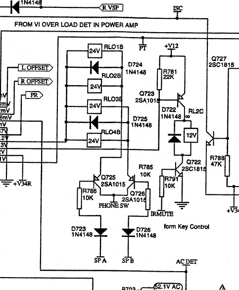

Look at the circuit.
The offset should be present on R20 and R21 on the relay board. One is L channel and one R. See if the erratic offset makes it that far.
If it does then check the appropriate relay has voltage across the coil. If the L channel relay is active then so to the right one should be.
There are two relays per channel, one for speaker set A and the other for speaker set B.
Q725 and Q726 drive the relays. You can see the coils in parallel but the labels don't make sense.... but forget that for now.
When Q725 is on it shows as powering RL01 and RL02 but they don't match what should happen on the relay board where it shows RL01 and RL04 as being left and right.
It should be easy to suss out though. Both speaker sets selected, all the relays should be closed and passing the output to the sockets. So see where the offset goes missing :)

So lets troubleshoot the 'no signal at the output socket' issue. If you study the circuit it should make sense. Each channel output goes through a relay contact. There are two sets of contacts per channel with each corresponding to speaker set A or speaker set B.
So if you turn both speaker sets on then all the relays should be closed. To close the relay the appropriate transistor Q325 or Q326 (or both) needs to be 'on'. Each transistor runs two relays, one left and one right, the other transistor does exactly the same for the second set of speakers.
So if one channel works then the other should as well.

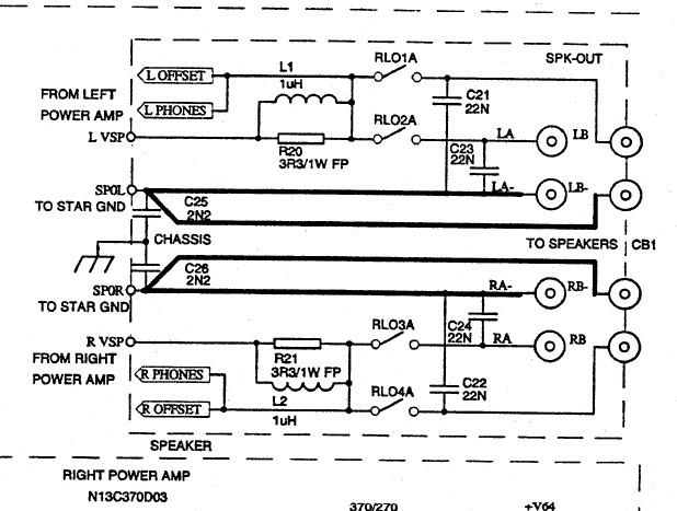

Checked the resistors leading into the relays. The offset from the right channel is present on R21 so it does make it that far around 30mV.
Across the corresponding coil L2 there is 0.3mV.
I tried the same on the left channel and it looked about the same. The offset from the left was present on R20 and across the coil it was 0.3mV too.
I suppose this points towards the left channel relays themselves?

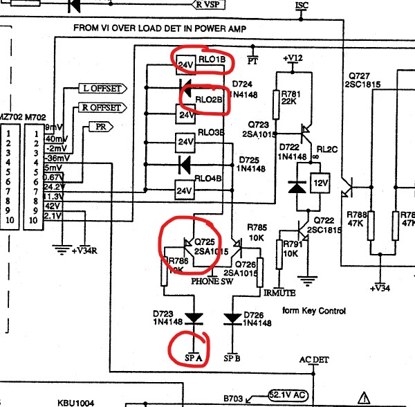

If RL01 is closed then so to is RL04 (that's one speaker set) and if RL02 is closed then so is RL03
But
those numbers don't agree with the driver circuitry where they show RL01 and RL02 as a pair and RL03 and RL04 as the other pair.

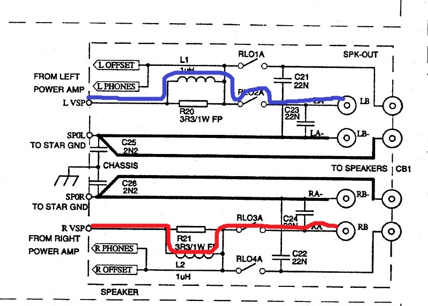

The offset should appear on the other side of the relay... if one channel works (and we know it does) then the other channel should as well.
The left and right channel relays work together, not independently.
Yeah, I was looking at the diagram and it looked like RL01/02 are the pair responsible for the left channel terminals and RL03/04 for the right.
But you say that's not correct? In that case i'm very confused :confused:
If the signal reaches R21 then there don't appear to be any other components between that point and the speaker terminal - except for the relays and the capacitors C22/24.
The first diagram shows RL01 and RL02 passing audio to just the left sockets. One is for speaker set A and the other speaker set B
The diagram showing the relay coils shows RL01 and RL02 driven together when they should be driven independently to allow A or B or neither to be on.
For speaker set A to be on you need one upper and one lower relay to be on.

It's a very strange issue for sure. It's important the logic of what should happen makes sense in order to troubleshoot it.
The diagram shows left channel in blue and right channel in red. Speaker set A is selected. So RL02A is closed and so is RL03A. So far so good.
Now if we look at the drive to the relays we see that for Speaker A to be on, and Q725 to be on to drive the relay NAD show relay coils RL01 and RL02 as being active. So something is in error in the markings.
So although the error could be anywhere in the markings it's not important because we know that if one channel works the other relay for the other channel should also be powered.

I checked all the caps C21/22/23/24.
With only speaker set A selected:
C23 sees the left channel offset
C21 => zero.
C22 => zero.
C24 => zero.
With both speaker set A & B selected:
C21 sees the left channel offset
C22 => zero
C24 => sees the right channle offset.
So it seems that the relays for speaker set B are all OK (RL01/04)
But that only RL02 is OK and RL03 is suspect.
We know that the R21 and the coil L2 must be seeing the correct voltage because speaker set B would need them to work which it does.
Does this sound reasonable?
