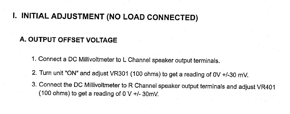

So... all sounds basically good actually up to this point. The protection circuit behaviour may be unpredictable with only one board powered/fitted so I wouldn't worry to much at this point.
The DC offset should be adjustable as per the manual which is the next thing to try.

Great stuff. Adjusted the trimmer and now getting 30mV on the output.
That fantastic so far then...
Ideally we want it as close to zero as possible. NAD say within -/+30 millivolts and historically we used to reckon anything under -/+100mv was fine.

It is very important (mission critical) that the 500 ohm preset VR302 is first set to its maximum resistance which means it appears as a 500 ohm in circuit.
The amplifier is then tested as before first checking the DC offset.
If that is OK you can carefully adjust VR302 to give around 2.5 millivolts (yes that low) across either of the 0.2 ohms that connect to the pair of transistors you have replaced.
As you turn the preset the bulb may glow dimily as the output stage conducts.
Hopefully the distortion will vanish as you turn the preset.
Be careful measuring, one slip of the probes and it all goes bang. This is all done with no speaker attached.

OK - I tried to do as you explained and it worked - no distortion 🙂
I removed the short then checked the offset again - it was a bit high around 70mV so I trimmed it to 20mV. I left it a good while because I first trimmed it to around 10mV but it slowly crept upwards. I was worried it would continue creeping but eventually it stabilized around 20mV.
Next I measured across the resistors - 0mV with VR302 at max resistance.
I slowly adjusted until I had 2.5mV.
I then rechecked the offset again. It had changed from +20mV => -70mV.
I adjusted to bring it up to around 0mV.
I rechecked the voltage across the resistors again and now it had moved from 2.5mV => 1.9mV
I felt this was a reasonable state to retest with some audio and it seems to be good. No audible distortion - the piano sounded clean! 🙂
Is it expected that you would need to balance the two pots to achieve the right values for offset vs voltage across those resistors? Should I continue to tune it to get closer to 2.5mV with a healthy offset?
