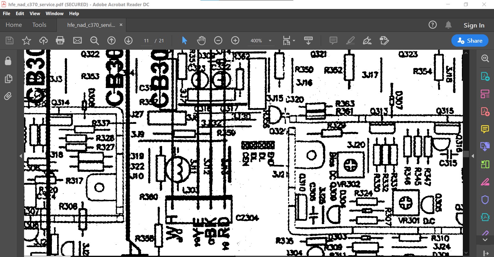

I must be missing something - I can see the test points on the schematic but I don't find them on the actual board.
I've worked on Synthesizers before where the test points are to be found on the board, clearly labelled, is it not the case with amplifiers?

When you say `in circuit` I take it that you mean whilst soldered in place but not with any power going through right?

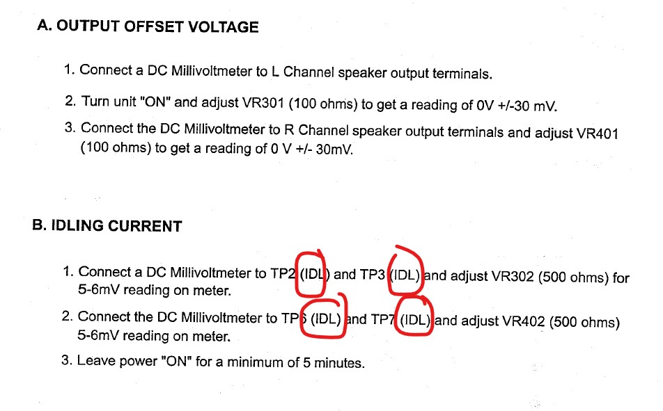

I'm also curious about those test points - they are not actual points on the board are they? Some boards do have test points which are labelled as such on the board as well as the schematic.
Soldered in = in circuit. Shorts will always show as a short and also any low value resistors that read high in value or open circuit are detectable.
The test points are listed (centre of first image) 🙂 The IDL ones are just for measuring the voltage across the low value resistors in the output stage and from that result the current can be calculated.

Ahaaa! Right - there they are 😉

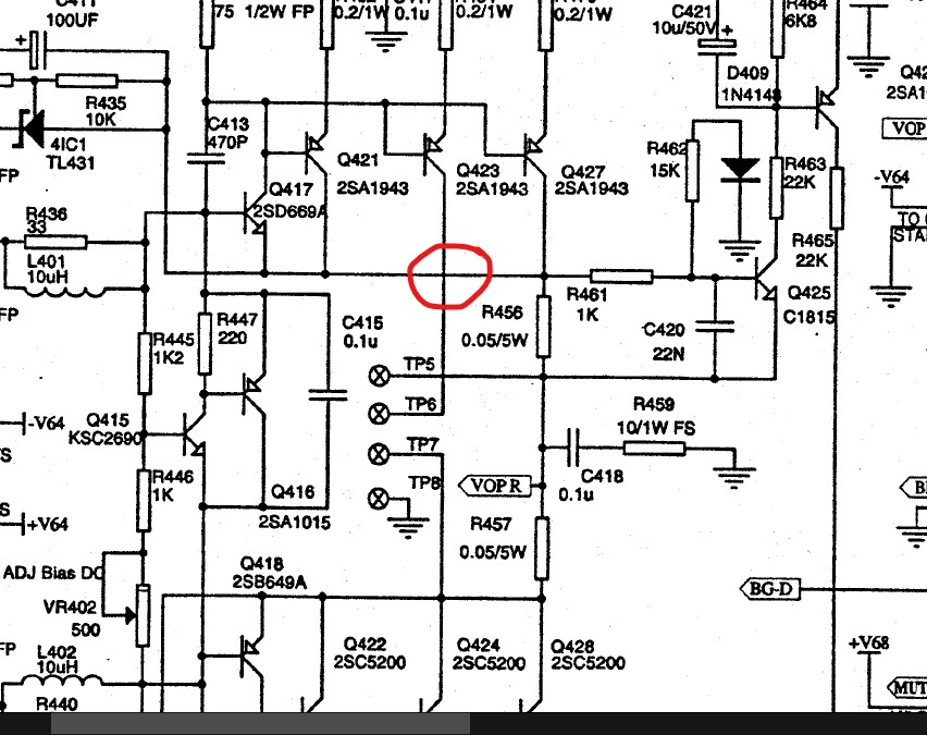

So earlier, when I wanted to test the voltage between 50 millivolts between R456/457 I should have connected one probe to CEN and one to GND as shown below?
You would measure between TP6 and TP7 which are both marked IDL (will be short for idle current).
The circuit is missing a 'blob' as shown.
CEN will be short for centre or centre point and is the main speaker feed output. That point would be used for measuring the DC offset. If there is a DC offset fault the relay would not connect the speaker terminals and so you wouldn't know there was a problem (beside noticing the relay didn't operate) if the voltage at the terminals was zero.
GND would be the reference point for the offset measurement.
Hmm, you seemed to say it was TP5 earlier to check the junction between those two resistors - but it was actually TP6/7?
I would begin by checking the basics.
1/ That DC offset is below -/+50 millivolts as measured at the junction of R456/457 which seems to be test point 5 on the board.
TP5 is to measure the DC offset which ideally should be zero. That is always measured with respect to ground. Any DC offset appears directly across the speaker which is always a bad thing as it causes DC current to flow in the speaker. If the voltage is high (a fault) then the speaker is in danger of being burned out.
TP5 is the main amplifier output point that would drive the speaker.
TP6 and TP7 straddle R456 and R457. The voltage across these points (not measured to ground) indicates the static bias current flowing in the output transistors.

I have worked my way through all the components on the left channel looking for opens/shorts and any resistors that are significantly out of spec. Luckily I have the working left channel to make comparisons. Finding quite a few bits that need replacing - all marked here in red...
Here are the failed bits on the schematic...
