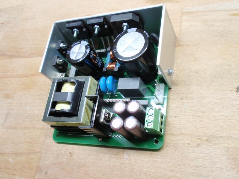

These Würth xformers work nicely. I designed a high efficient 400W LLC with synchronous rectification (single supply voltage for full bridge TPA3255). If you are interested I could support you with empty sample PCBs and documentation (KiCAD Design).I note you don't even have to wind your own transformers these days...
Wurth Elektronik WE-LLCR Series Power Transformers – Mouser Australia

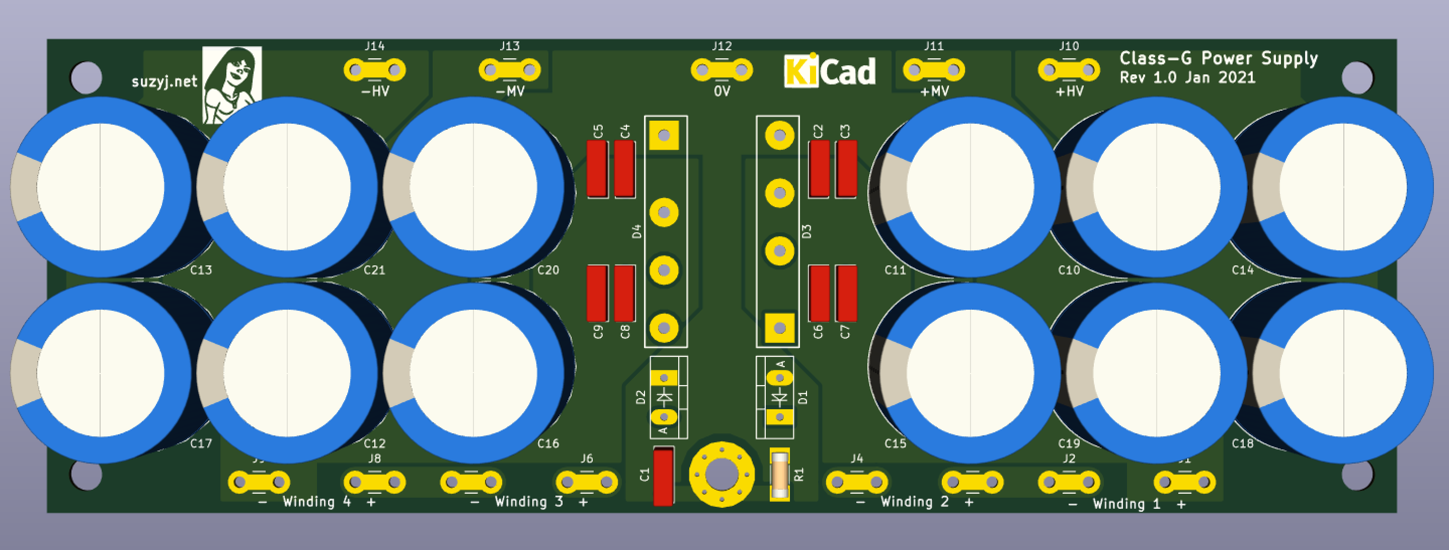

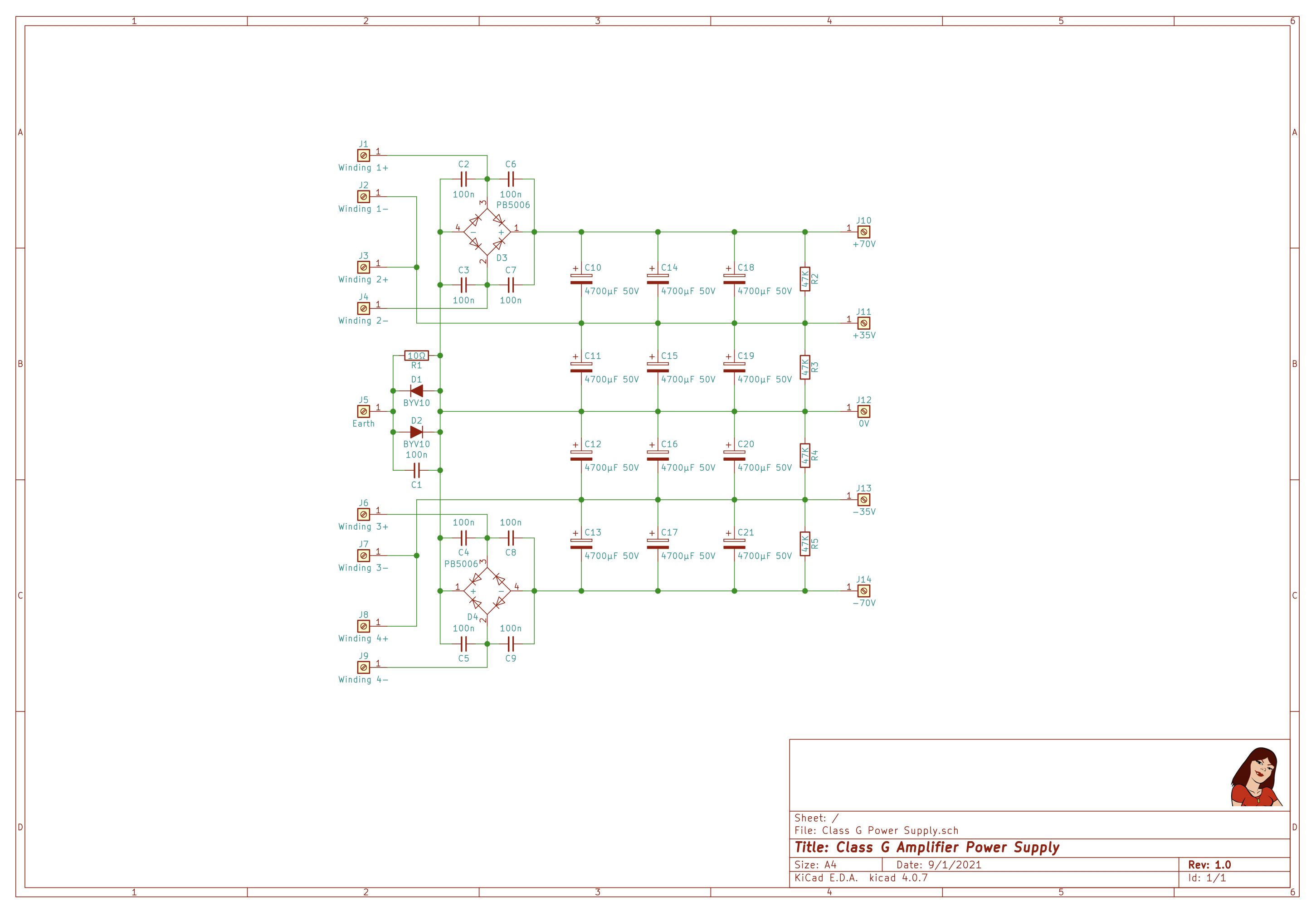

For the final product I'm designing a straightforward four rail supply using an identical pair of toroids, as shown below. One of the neat things about class G with the lower voltage rails is that I have a ready-made supply for running lower voltage stuff like preamps and active crossovers etc.

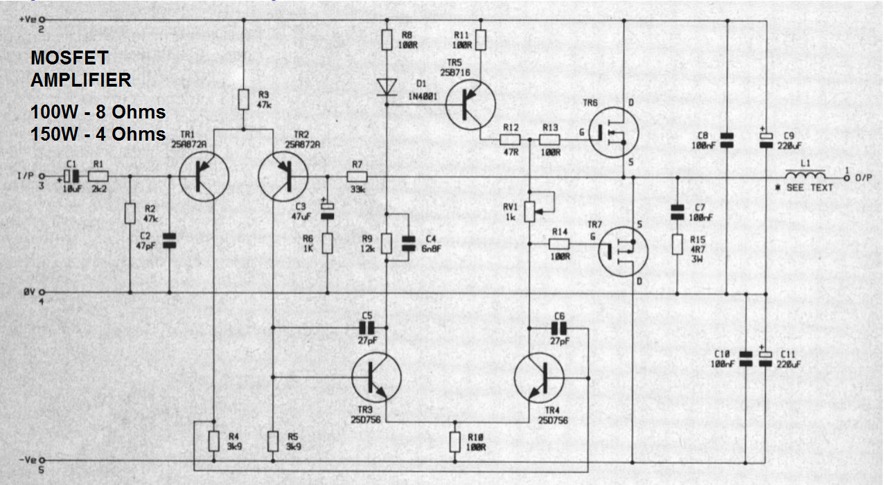

Perreaux had a neat solution for this in their pre-amp design
I may have a schematic if you8 want a look ......🙂
Their preamps are interesting, the gain stages are little lateral mosfet power amps based on the Hitachi application note. Their power amps use the same topology.
Interesting indeed.
Dual rails 45V and 90V with the mosfet output stage (capacitor coupled)
Robust design that served them well for many years
Interesting indeed.
Please share the design. Thanks.

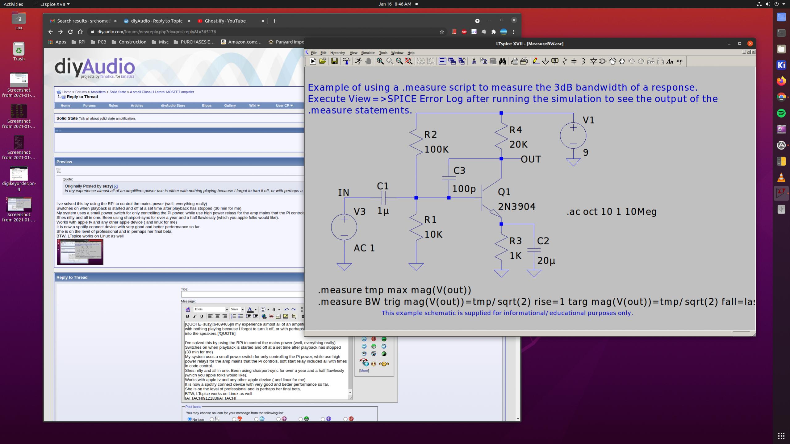

BTW, LTspice works on Linux as well
Sm3 ( basically the same as the sm2) first post of this thread
Loading plugs Perreaux SM3 Preamp
All stages look identical to the Hitachi Lateral Mosfet application note from the late 70's later distributed by Maplin as DIY kits.

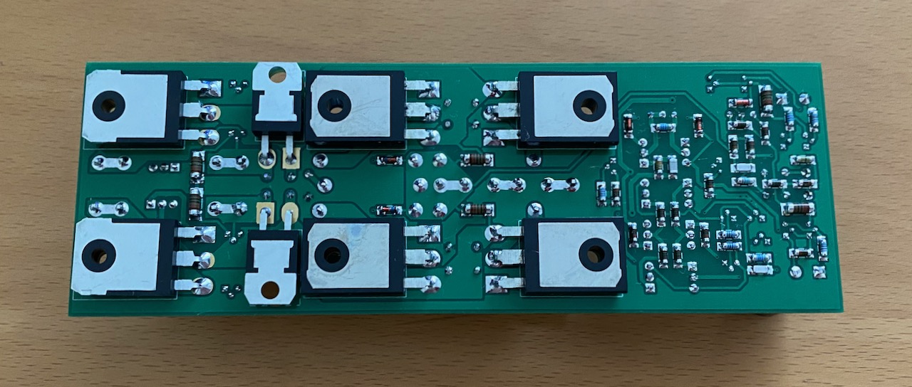

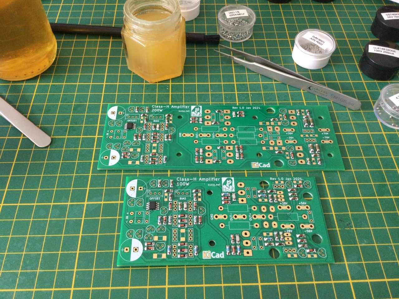

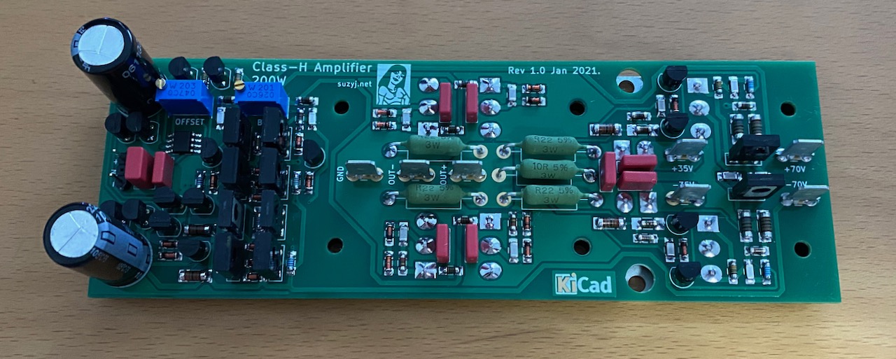

Some progress. The PCB goes together without issues.
I've fully populated the 200W version, and the 100W version is most of the way there. I forgot to order 100K and 47K 1W 0207 MELFs, so I've substituted 400mW 0204 parts instead for those for now. In each case the resistors are only dissipating ~120mW, so it'll work at least for testing purposes. I'll swap 1W parts in later.
I can test it as a class-AB by simply using the same supply for both MV and HV rails, so I'll probably do that initially while I keep designing and building supplies.
