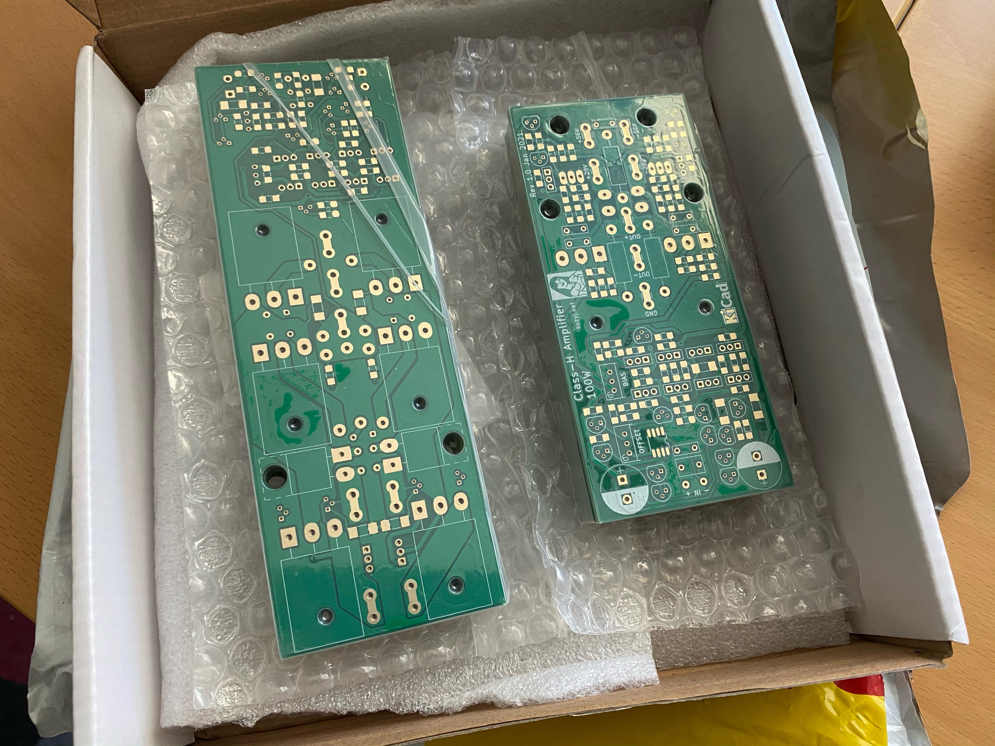

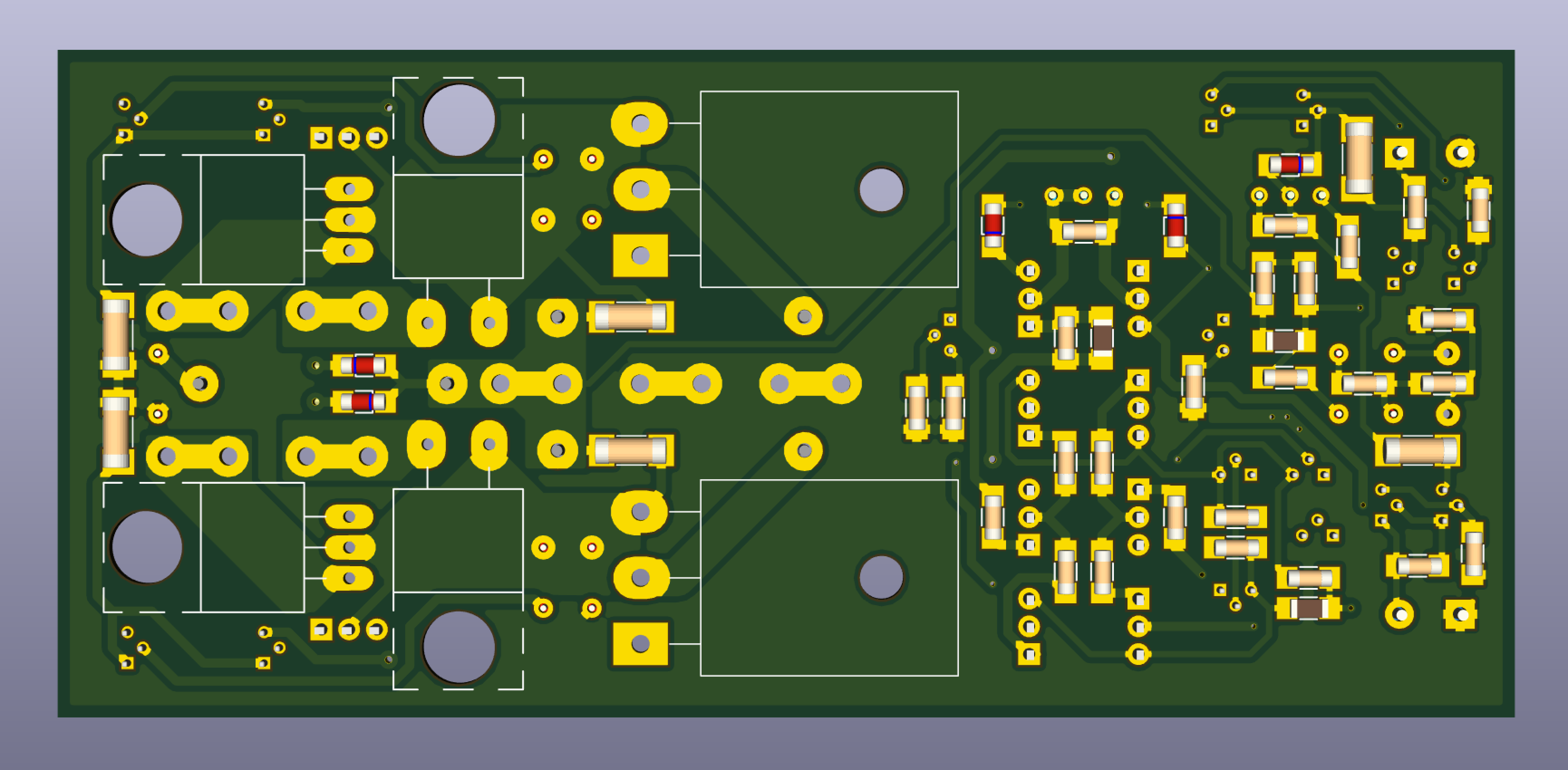

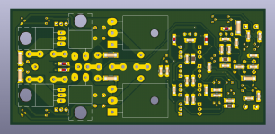

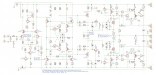

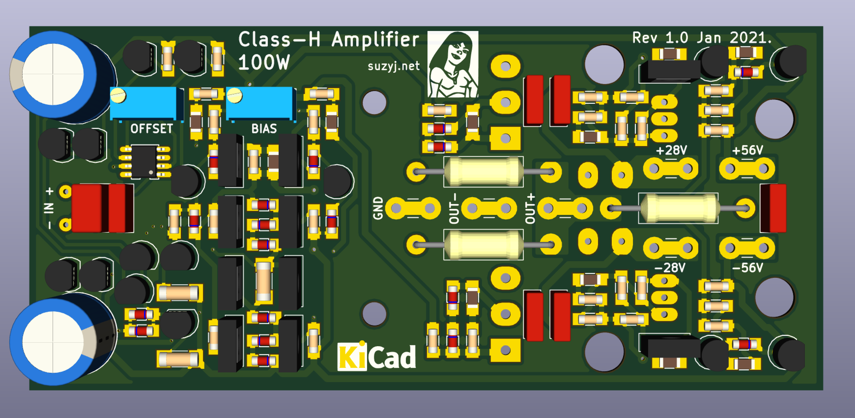

And here's the little 100W version. 120mm x 55mm, so a little larger than my normal 100W class AB lateral MOSFET amp (100 x 50), but really who's counting.
I think this one is really cool.

....and while I was further mucking around I've gone with 6.35mm spade terminals for the power and speaker connections.
