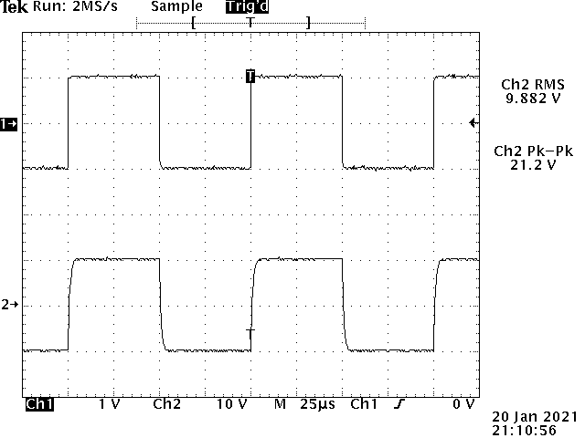

This is the 100W flavour, with both rails driven from +/-40V, and a 2V pk-pk 10KHz squarewave on the input.
I am yet to put it on a heatsink, and am yet to really work on DC bias, so this is _very_ preliminary. However it's nice to see it's not an oscillator. This goes a decent way to validating the folded cascode on the front end, at any rate.

Both my 100W and 200W flavours are running very happily. I had to remove the G-S cap across the N-FETs, as that was causing it to burst into song with heavy loads.

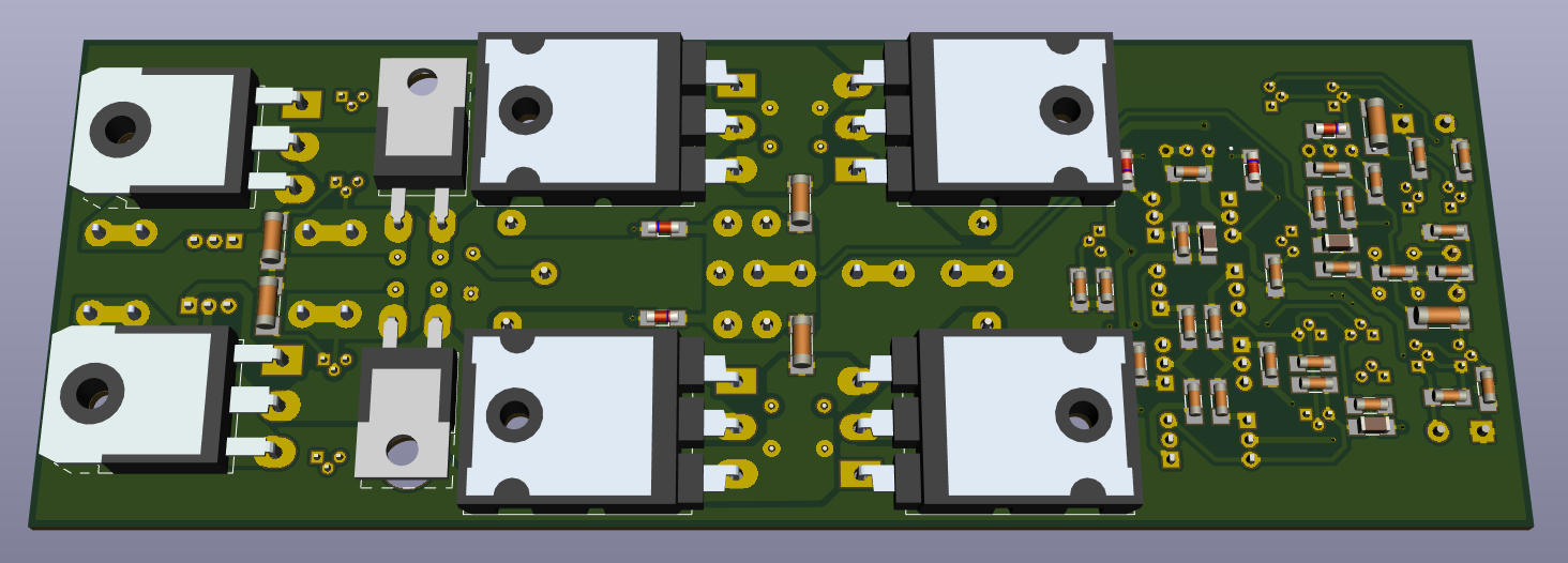

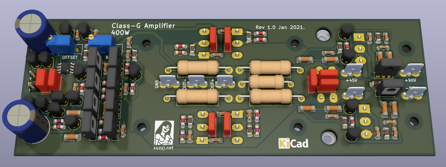

I've installed a new version of KiCad, and I took the opportunity to build some decent 3D models for transistors, starting with the TO-126 (no, they don't have 0.1" spaced pins), then TO-220 in horizontal tab-up format (I mount a lot of power devices on the underside with their tabs away from the PCB - this makes it easy to heatsink the mess). So then I did TO-247, TO-3P (I know, they're so similar to TO-247 it's not really worth the bother) and... TO-264.
So once I had the TO-264 model I needed a board to try it out on, so meet my completely ridiculous why would you ever need that 400W class G amp, which is quite simply a 200W one with bigger double-die MOSFETs. It's 8mm longer and 5mm wider than the 200W version.
400W into 8Ω needs +/-90V supplies, which is getting mighty close to the 200V Vds spec for the transistors. But hey, I could build a pair of these with lower 70V supplies and bridge them, and use that to set fire to stuff.
I've decided we need a new metric, of power to board area. Bigger numbers are better. My boards so far do:
50W class AB: 37.5cm^2, 1.3W/cm^2.
100W class AB: 50.0cm^2, 2W/cm^2.
100W class G: 66cm^2, 1.5W/cm^2.
200W class G: 88cm^2, 2.3W/cm^2.
400W class G: 101cm^2, 4.0W/cm^2...

I just read through the rest of the thread more carefully. Without actually calculating anything yet, I think i could just swap in the double-die MOSFETs, keep the +-70 v power rails and have roughly 400W into 4Ω.
4ohms is pretty standard for bass rigs and keeping the rails at +-70V keeps Vds safely away from the 200V spec for the transistors
With +-70V, and driving two pairs of double dies, are you still within SOA for the 1381/3503?
They are a pretty good and robust 300V device, and a short or overload on the output does not have the same implications as on a BJT output as the mosfet is a capacitive load.
