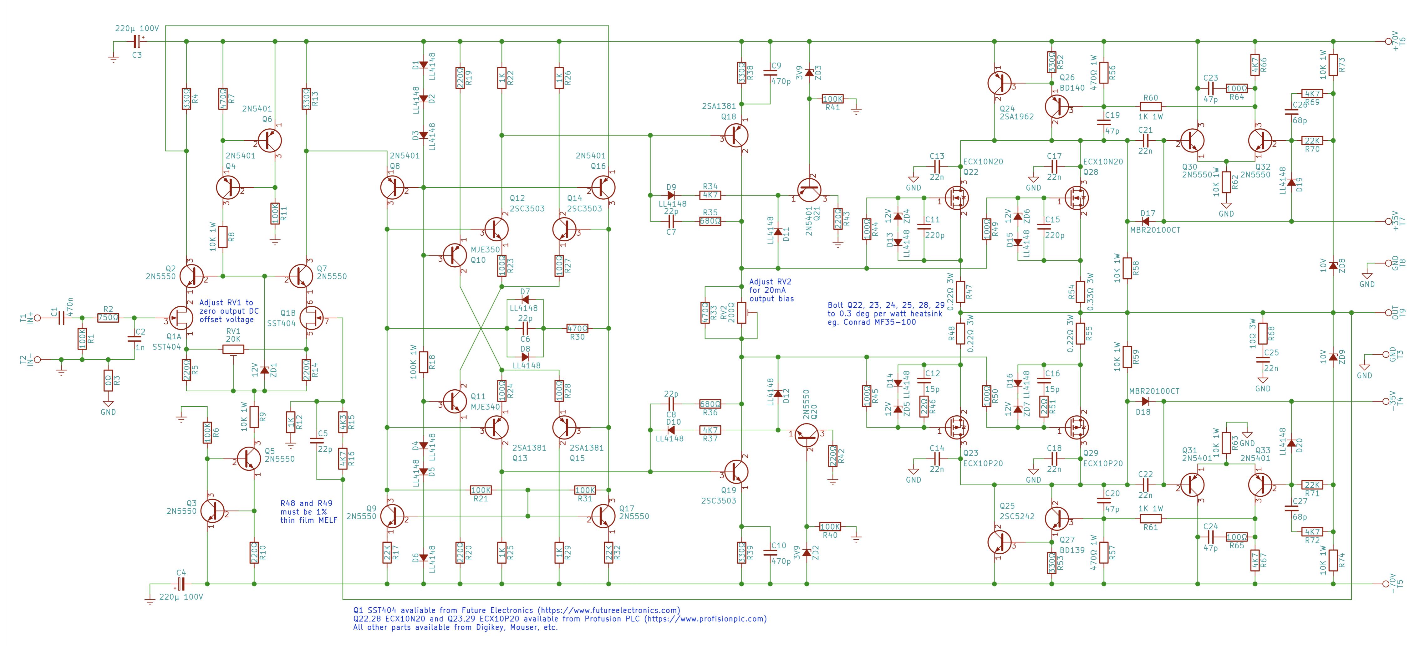

I like my lateral MOSFET amps, but I dislike excessive quiescent power consumption. I'm enamoured with my lovely old NAD 3240PE amps (I've gotten a couple working, and they're a nice amp). So what if we combine the two. A Lateral MOSFET version of the 3240. Aim to improve on the distortion specs by, say, 20dB. And don't waste current to get there. I've got some ideas on how to speed up the AEM6000 topology, so use that and wrap a NAD inspired class-H rail switcher around it.
I've attached my circuit. It uses 2 pairs of Exicon 10N20/10P20 devices for the main amplifier, and is approximately based on the AEM6000. I've added a folded cascode to the front end, with a current mirror load. That improves the AEM6000 design by enough to mask the badness that the class-H rail switchers do.
The rail switchers are based on the 3240PE, but I've used a diffamp on the input. The whole mess is able to switch cleanly to envelope a 20KHz sine-wave without clobbering it, but when it starts turning on and off it imparts about a 20dB penalty to THD.
Power budget wise, I run the input diffamp at ~800µA per side, then ~2.5mA per side for the second stage, and ~6mA for the VAS (which is not differential). I've biased the MOSFETs at a paltry 20mA per device. This keeps the overall power budget to around 7W (compared to 13W for my 100W amp), which I think is an improvement.
THD is in the single-digit ppm figures up to 50W, after which the rail switches do their thing and the THD rises to about 0.003% at 1KHz. Still quite a lot better than the NAD. I'm confident it'll reliably do 200W into 8Ω, as the rail switches really do help to limit dissipation in the output drivers. I've set the supplies up to +/-35 and +/-70 V, so I could use a pair of 25VAC dual secondary toroidals, and run the other amps off the +/-35V rail. Input is my standard SST-404 JFET, so I expect something like 8ish nV/√Hz input referred noise.
I've set the gain for 20dB (X10). It's really very stable, so the gain can be pushed pretty-much as low as I like to improve the distortion figures. I can run a pre-driver as part of the active filter network to increase the gain with no distortion penalty.
I played around a lot with the compensation for the rail switches - there's a maddening compromise there between fast switching to keep up with transients (so it doesn't mangle square waves), and not pushing heaps of current into the output quicker than the servo system can compensate for.

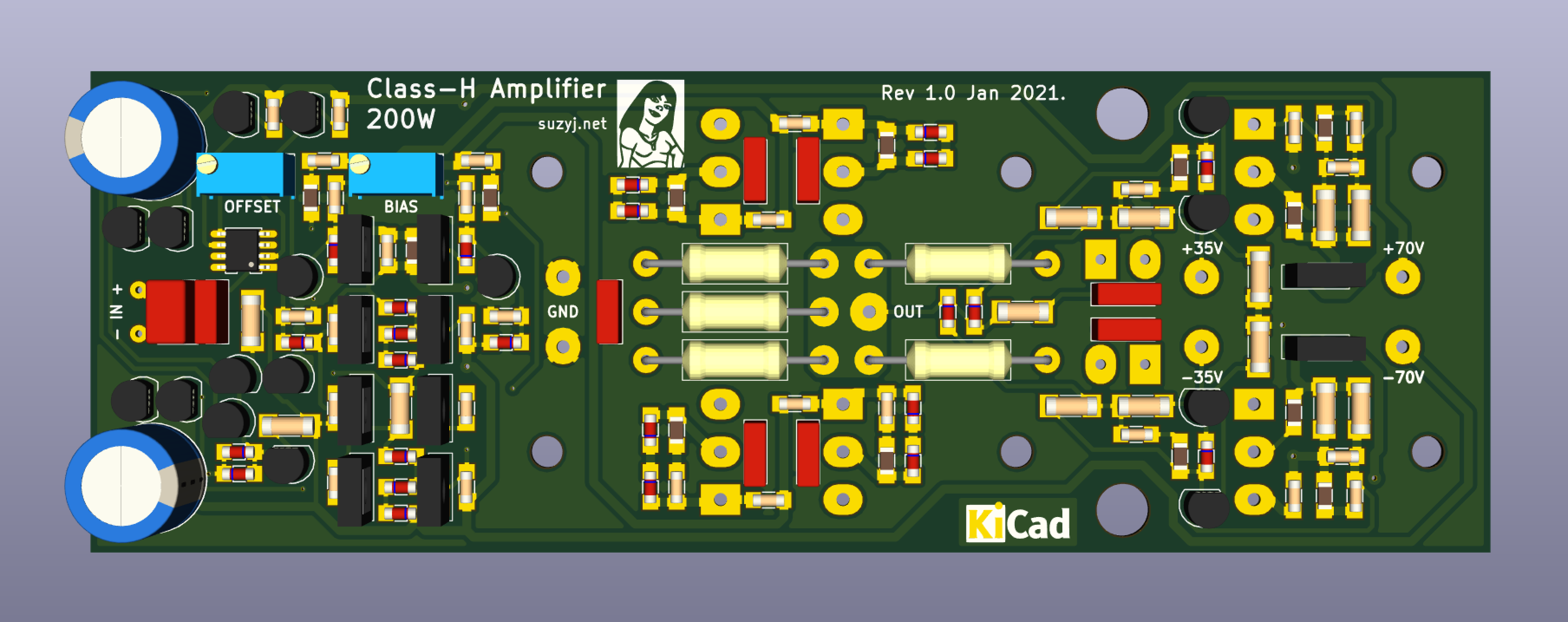

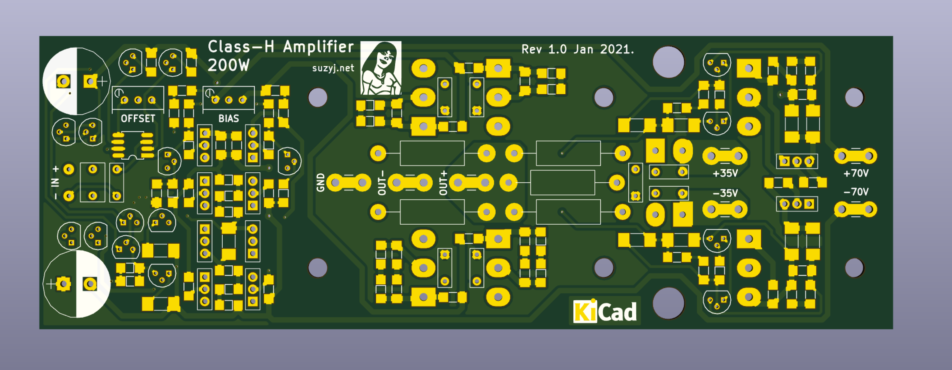

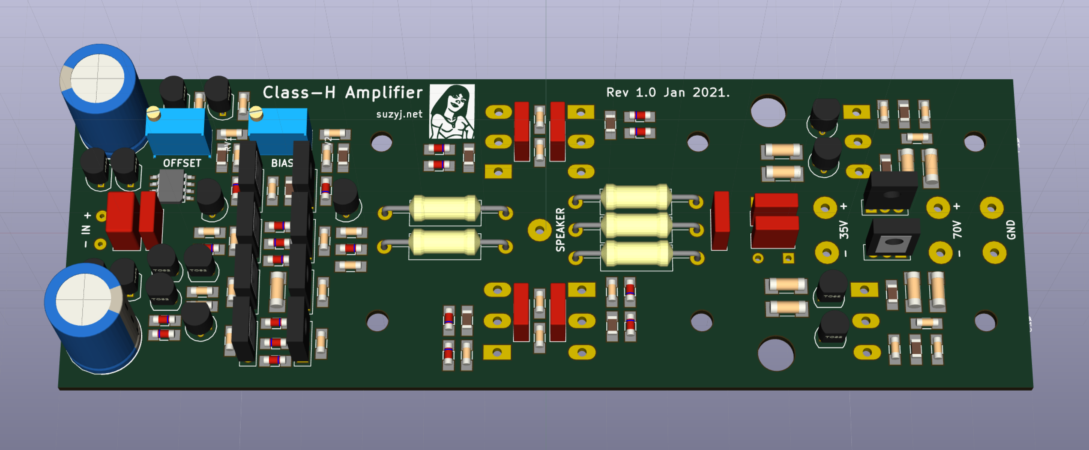

Now I'm up to laying out the PCB. I've eschewed SOT-23 transistors in favour of TO-92s, and grown the pads on my MELF and 1206 footprints a little to make it more soldering iron friendly. The PCB is currently at 160mm x 55mm with placement pretty-much sorted, but will likely change a tad while I do the routing.
As with everything I do now, schematic and layout are done in KiCAD, so it's easy for others to play with once I've finished.

Hi ,
It looks really nice , What shall be the theoretical efficiency?
At 200W out, I measure input power as 305W, so 65%.

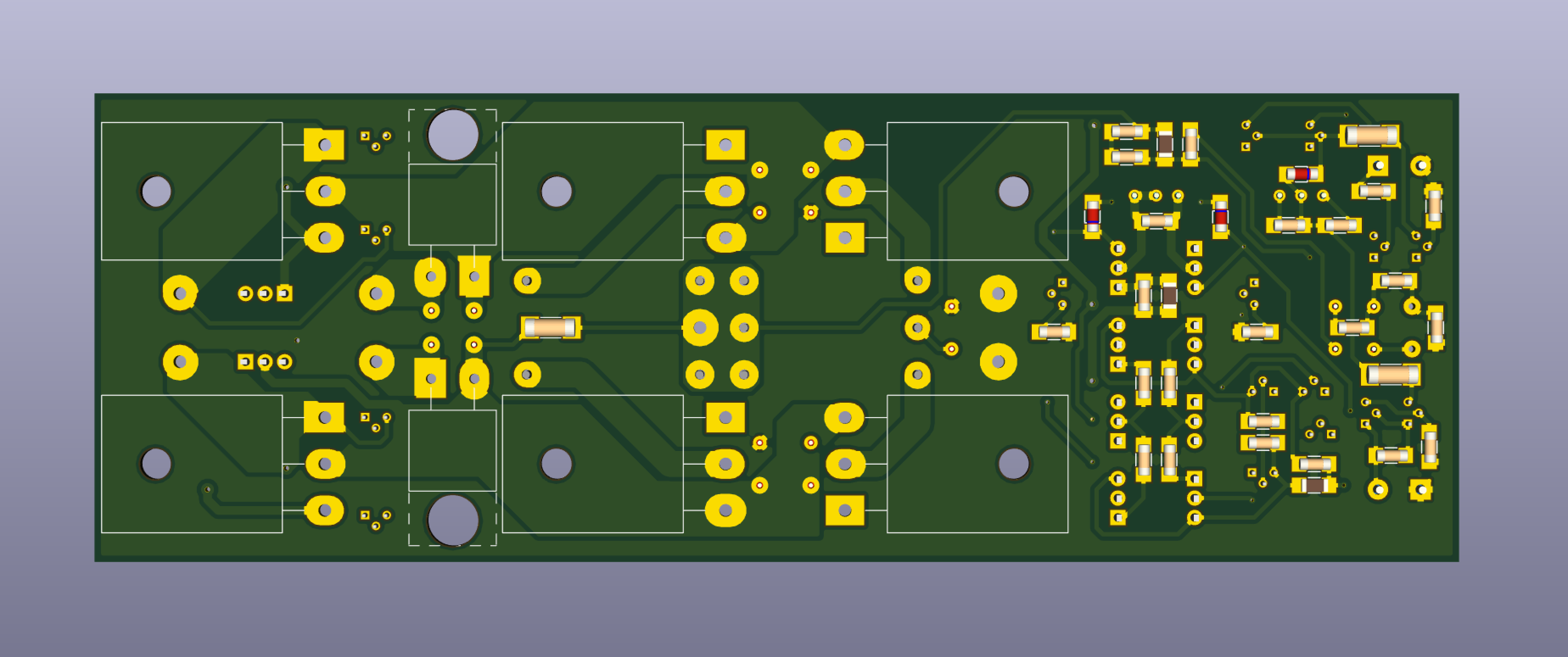

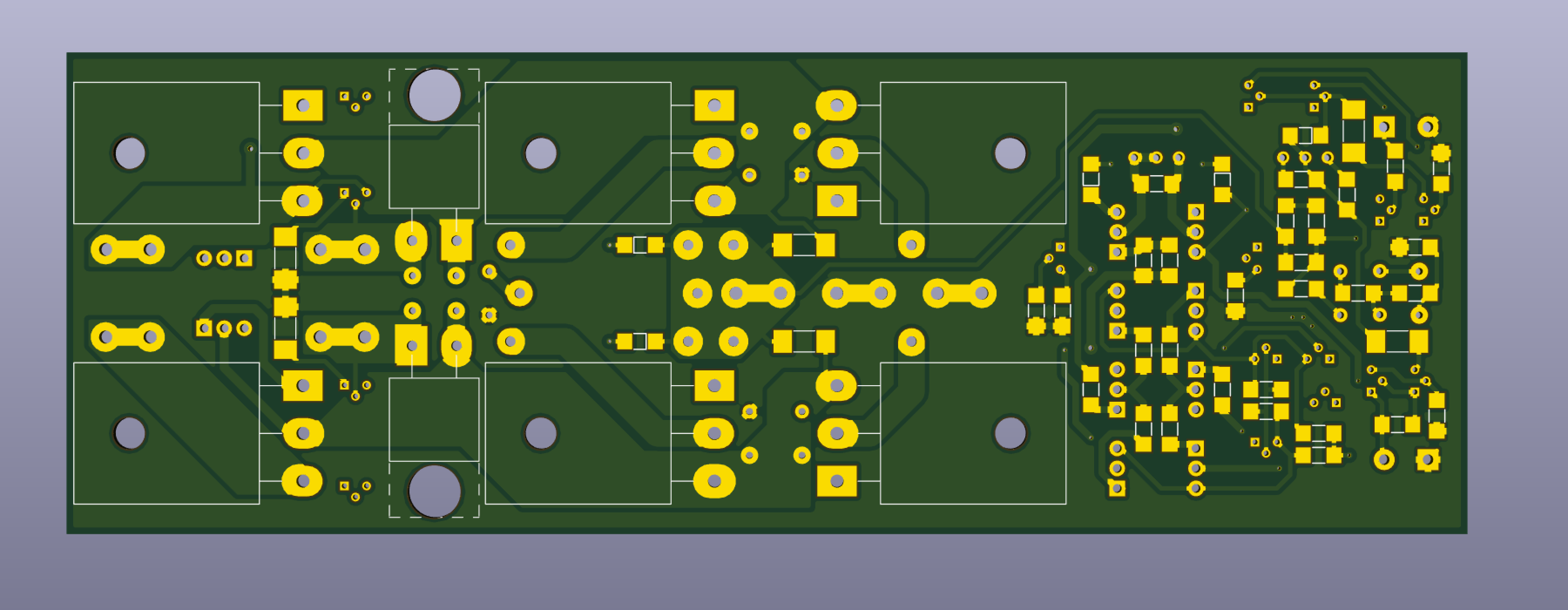

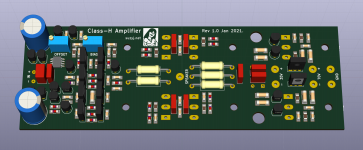

And here’s a couple of views of the PCB after routing. It’s still 160mm long and 55mm wide. I used pours to ensure the high current paths are suitably low impedance. Track width for everything up to the VAS transistors is 20mil. VAS to FET gates are 40mil. Similar logic for the rail switches. I’ve taken care to ensure I tap the feedback point from as close to the output node as possible, and done some work with the grounds to minimise any distortion contribution there too.
Clearance is mostly 20mil, but I allowed 10mil for some of the stuff in the front end where that won’t matter.
I made use of CMD-left click to figure the dissipation of everything, and that resulted in me swapping a bunch of resistors that do >100mW to MELF 0207 (1W) size. I’ve also gone for a series pair of resistors for Rf, both to keep them from getting too hot and allow an accurate 9K (20dB) gain using 4K3 and 4K7 in series.
So now to order some.

Suzy shouldnt you be taking the negative feedback from along the output line , currently the output is straight from the resistor commoning thus no output line ( Self distortion 7 )
Good point. I'd moved the ground pads from the far end of the board to near the middle, and moved the zobel network as well. That meant the zobel connection point was in the way.
A bit more of a shuffling sorts that. I also corrected a huge stuff-up with the 2SA1962 and 2SC5242 pinout, and while I was further mucking around I've gone with 6.35mm spade terminals for the power and speaker connections.
Thanks! I think it's looking pretty clean now.

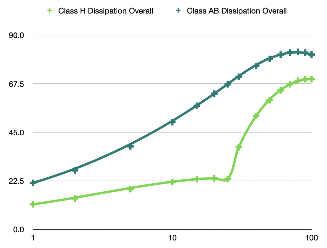

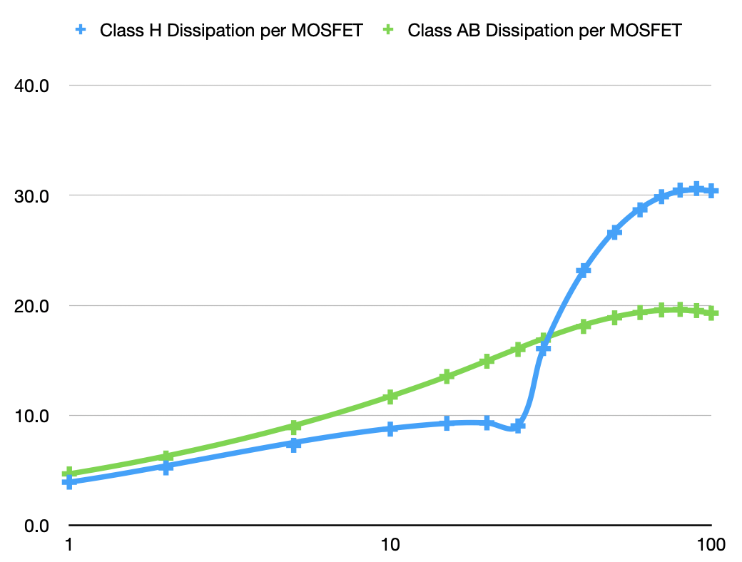

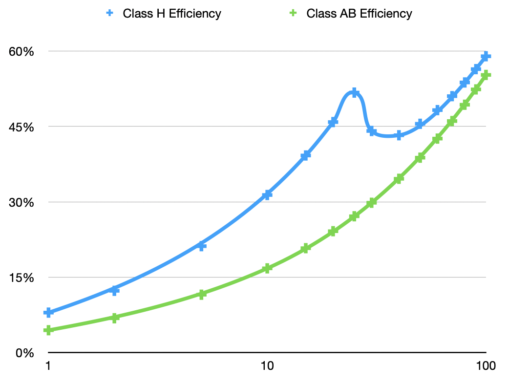

I've been trying to get a decent handle on the efficiency of this little guy. Lacking a fully designed 200W AB amp to compare against, I knocked out a quick 100W Class H, essentially by omitting the second set of lateral MOSFETs, and substituting D44H11 and D45H11 for the rail switches, plus dropping the supplies to 4x28V.
The class AB amp I use for comparison purposes is my AEM6000 based 100W one, which I designed back in 2007. It's a reasonably good amplifier in it's own right, managing much better than 0.001% THD at 1KHz all the way up to 100W.
So then I calculated power in plus MOSFET dissipation at a bunch of output power levels from 1 to 100W. The little 100W class-H absolutely blows the doors off the Class AB in efficiency terms up to 25W, which is where the HV rails turn on. After that the efficiency drops off, but in all cases it's significantly more efficient than the class AB amp.
The bad news is that after 30W, omitting half the output transistors can be seen in increased dissipation per device vs the class AB. Worst case (90W out) it's just a tad over 30W per device, so well within SOA. Totally manageable as long as I size the heatsink accordingly. This is where the bit of folded tin in the 3240PE means that I can get blown up amps for cheap :).
I rather like this little amp. Given that I've already done most of the design work for it I shall knock out a PCB.
