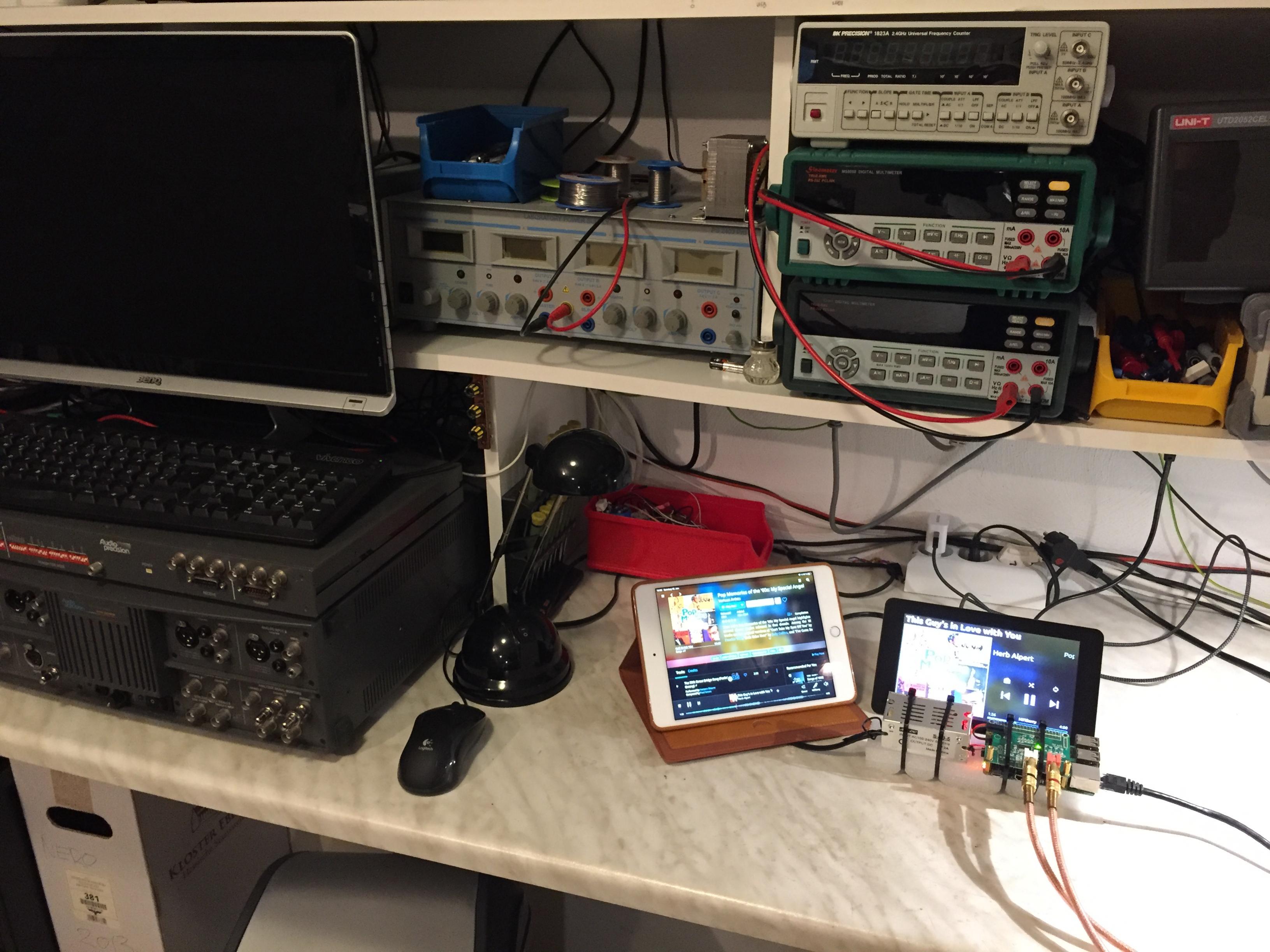

😉 LOL a quick Solution for a simple Roon Endpoint for the tests I am planning 😛
It was nice “building” something not so high end ...
Correct, BUT ONLY for the first functional test. I built everything in my DAC yesterday evening (for testing again, not final assembly 😀 )
I power as follows (this will be final for now)
*DDDAC Board - Magic Power Supply (Audio Creative) 12V
*Wave IO - DDDAC 5V
*PI3 + FiFo (the stacked / non-isolated part) and the Relais Board - 5V SMPS
*FiFo - Isolated Clock Part - LDOVR 3,3 Volt through RC coming from Magic 12V
*Arduino Control Board - Small LM317 PS 12V
see the pics (Christmas is over, but it lightens up as a Christmastree 😛 )
