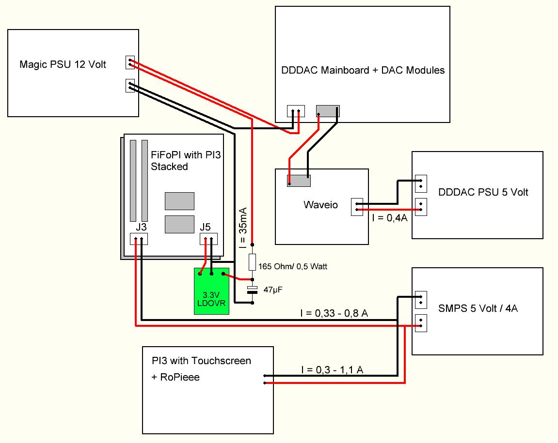

Just to be sure I get this right:
Magic 12 V PSU --> DDDAC board --> LDOVR on DDDAC board 5V* --> RC filter (drops to 3.3V output) --> FiFo
(*) this is where normally the WaveIO isolated I2S part is connected
The RC filter between the DDDAC board and the FiFo might be nice because it decouples the regulator from the FiFo, so the "imperfect" load response of the regulator is "hidden" behind the RC filter, and the load response is controlled to a large extent by the C of the RC filter.
no... I was unclear again I believe :eek:
So I made a drawing :cool:

If i will start using Ian's fifopi board i want to use the lifepo4 board he developped. In Doede's attachment it is indicated I 0,33-0,8 A going to j3 but it is much lower because that would mean something on that board would get hot. So i presume both j3 and j5 can be fed by a separate 3,3 volt supply from Ian's board with each a pair of supercaps added.

Hello,
I think adding these parts with the special clocks will already give a nice improvement.
Greetings, Eduard
The 0,33A is when also the PI3B is attached to the fifopi… 0,8A is at boot - the PS must be able to deliver that or the PI will not boot.
The Fifo itself takes like 90mA at the non-isolated side and the clock part 35mA

Finally I have managed to get isolation between unisolated-isolated side of waveio and Fifopi. J5 (isolated) is feed by it’s own 3.3v psu, when J3 (unisolated) share the same psu as waveio 5v in (usb side).
