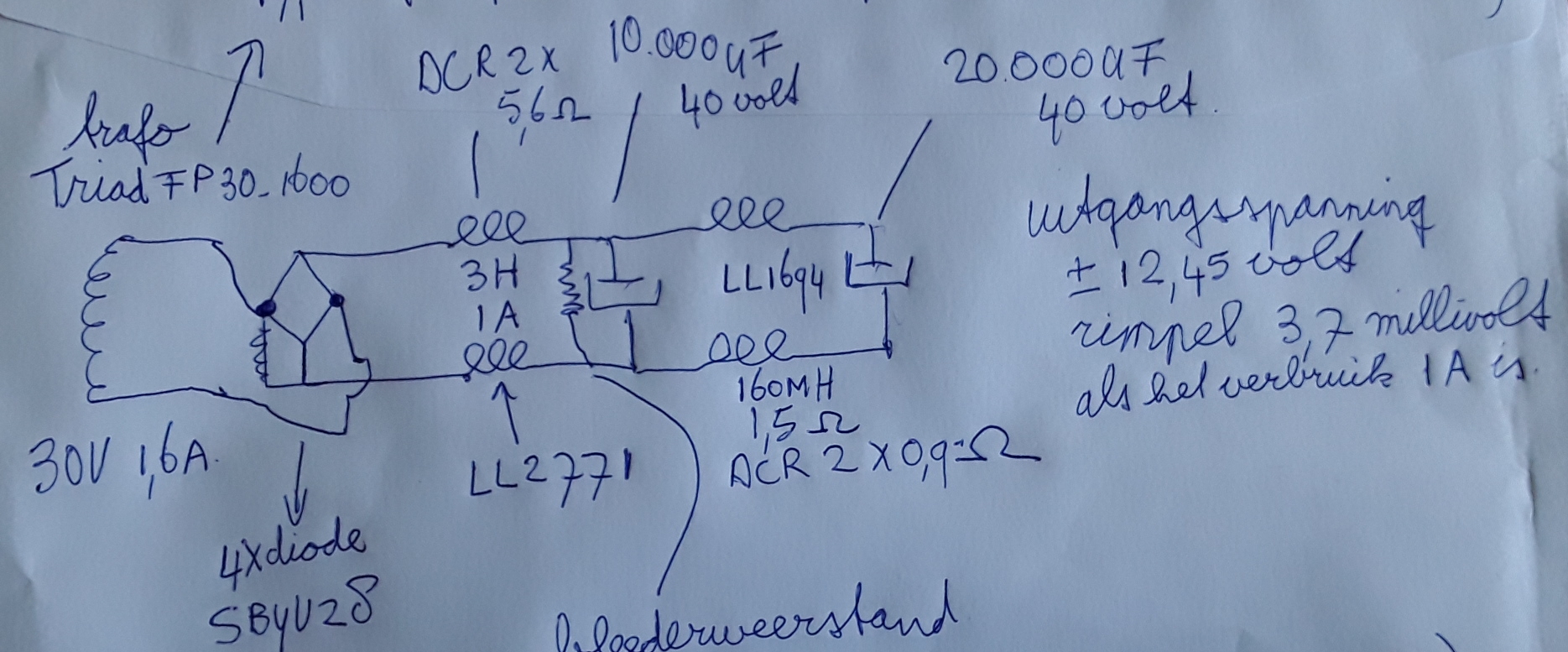

Hello,
Found a drawing on my tablet.
This shows a choke input for a 4 board dddac so drawing around 1A
It is a LCLC with a 1A rated ll2771 but with two boards better use the 500mA because it will not give you 3 but 6 henry!!!
You will need less than 30 volts ac from the transformer because the voltage drop across the transformer will be less because current demand is the half.
Second lc network can be changed into an rc network but lc will be better.
Of course you must use a bleeder resistor to take care there is always a minimum current running.
You can mount the 4 diodes right onto the secundairy transformer connections and from there two short wires to the ll2771. Some of my photos are from the test set up.
Greetings, Eduard

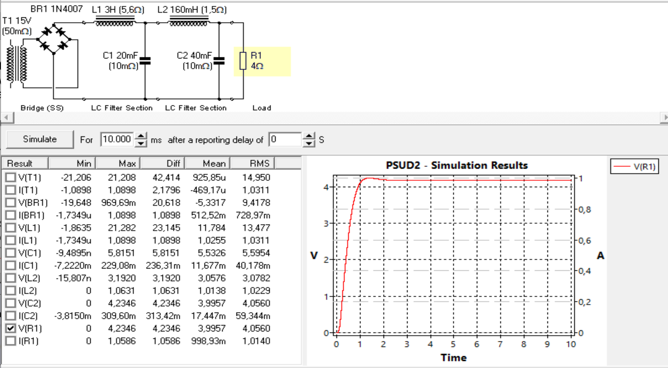

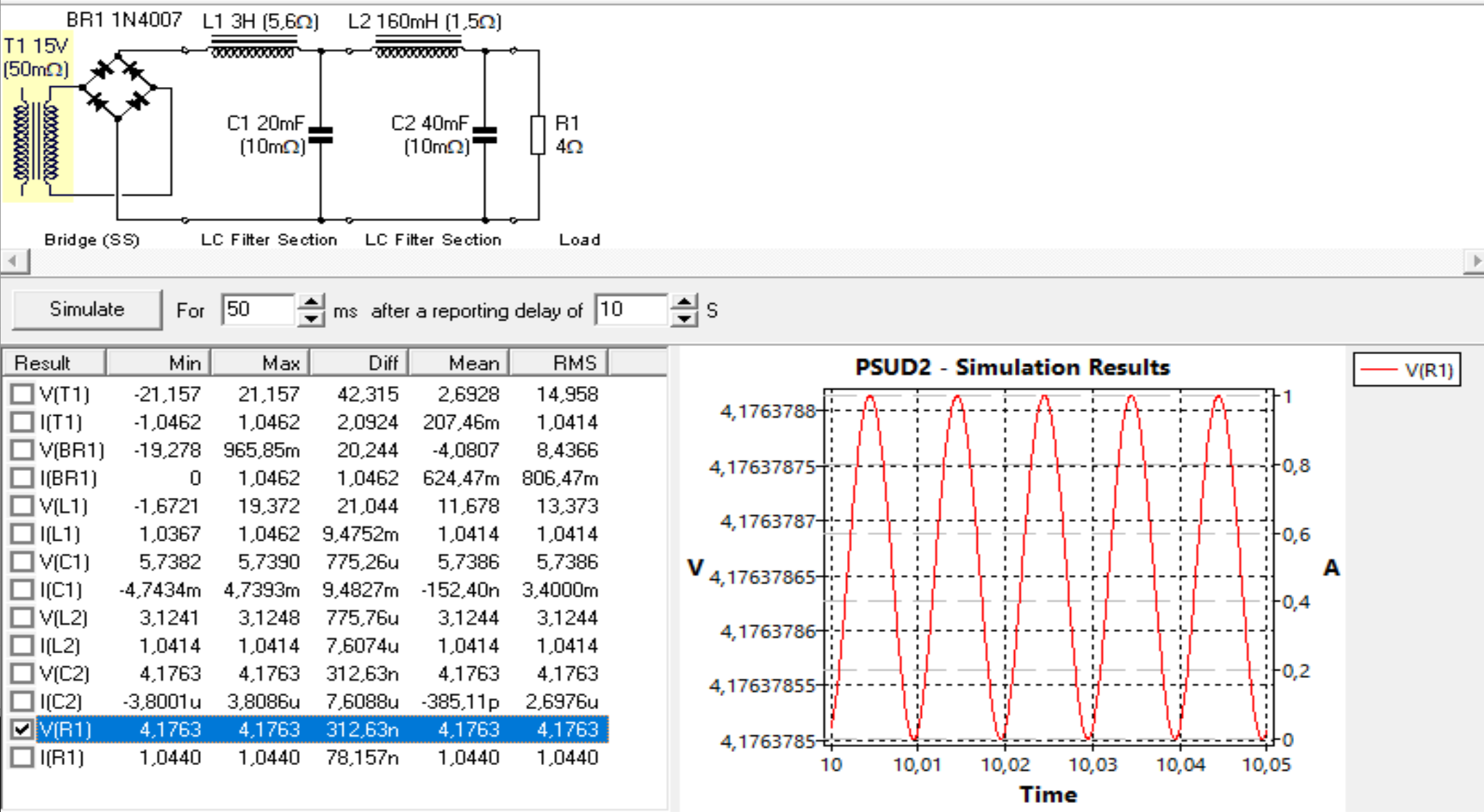

I simulated this using the Duncan PSUD2 tool, assuming a constant current of about 1 A. Note that your circuit is "symmetric", and PSUD can't do that. I therefore included only the "upper" half of your circuit. The voltages are therefore only half of what they would be in your real circuit. Imagine the second half (mirrored) stacked below the one included in the simulation. See attachments.
Results:
- The circuit has a tendency for instability (see overshoot during start up)
- The output voltage of the "upper half" is about 4.2 VDC, which means the full circuit would have 8.4 VDC.
- The peak-to-peak ripple voltage comes out as 312 nV (!!!!) for the "upper half". The full circuit would be 624 nV(pk-pk), or about 220 nV-RMS.
I don't think the ripple will work out so low in reality, but it does seem like an impressive result!
To avoid the oscillation (overshoot) you'd have to use much larger caps. Say 100 uF each.

Hello,
This was a circuit i send to some other member in my country.
The actual circuit i am using in my dddac was simulated by Doede himself and he told me it looks very good.
There are a number of people here on this site who say we should pay attention at what happens at start up. I am no technician but i tend to believe them because the choke can behave " a bit strange " when there is no steady load present, Some people are concerned by the high dcr of the first choke. But if i remember well Doede confirmed that because of the shunts the load will be steady so dcr is not that important..
What will give the highest return on investment nobody knows. I started with 4 decks and Sowter right away. The choke input was also there from the start just moved to a much bigger choke.
Moving from a choke most people use and the one i am using is a small investment so once you go for choke input and you know how much current it needs to handle better get the best one right away.
Greetings, Eduard
