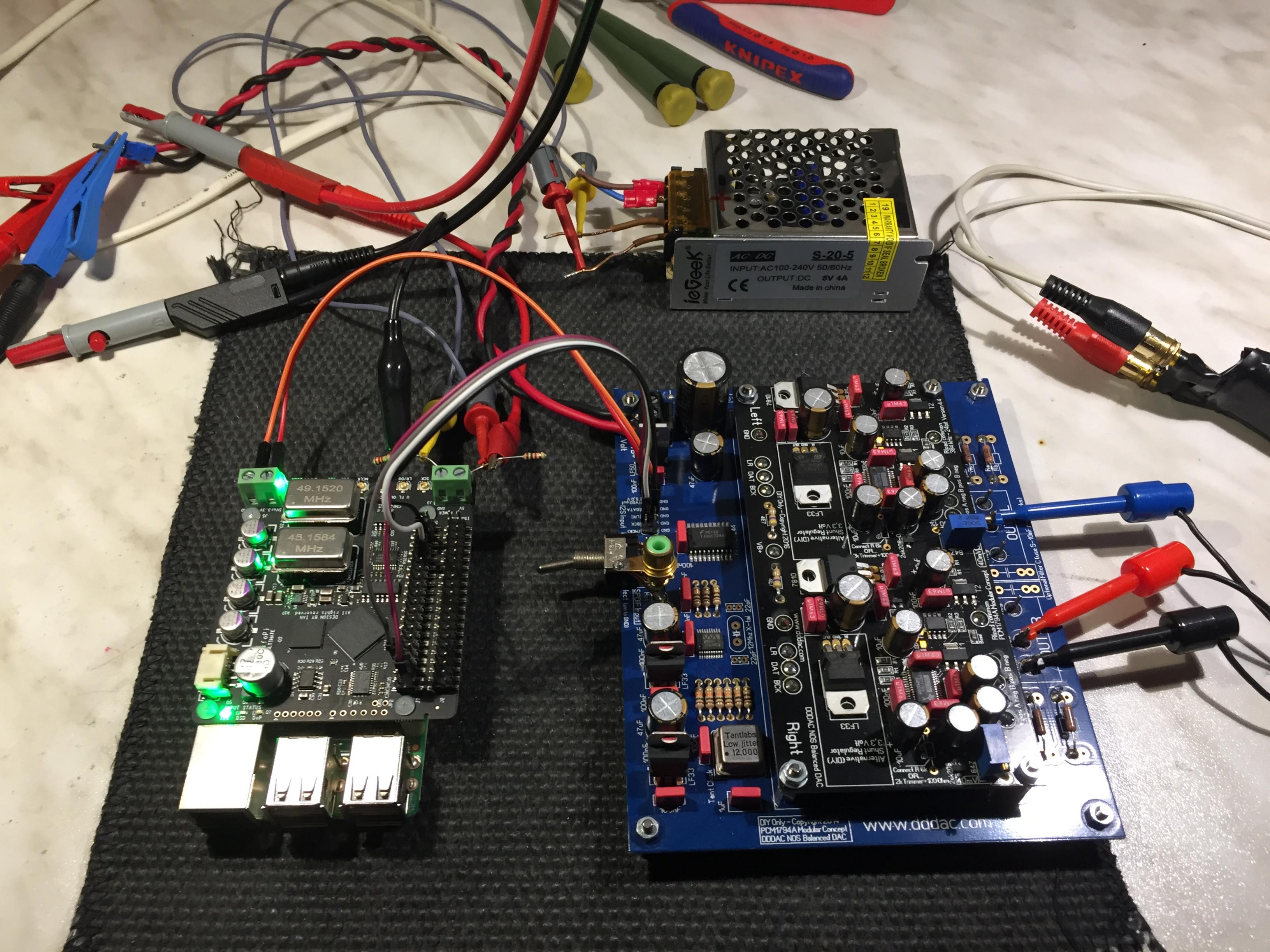

Well said Eduard ! Sure it will not take months I hope. At least a good start. On the picture you see the test setup. Everything worked fine from the start... Next step, build it in my music room DAC :cool: ps This works over WiFi .. I will also listen to wired and WiFi

Looking at the photo it seems you are feeding the FiFoPi like this:
  • add-on SMPS for the RPi power
  • DDDAC board for the "clean" power
  • Everything at 5 V
Correct?

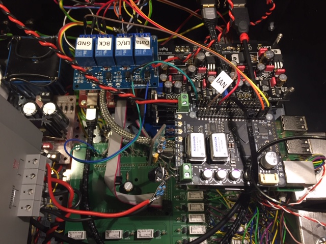

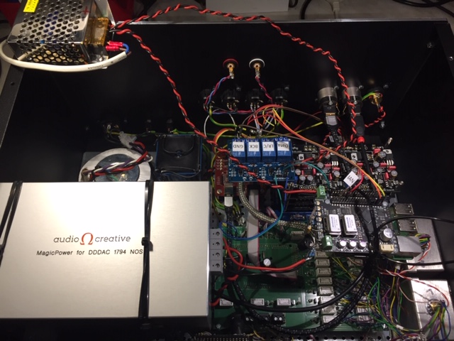

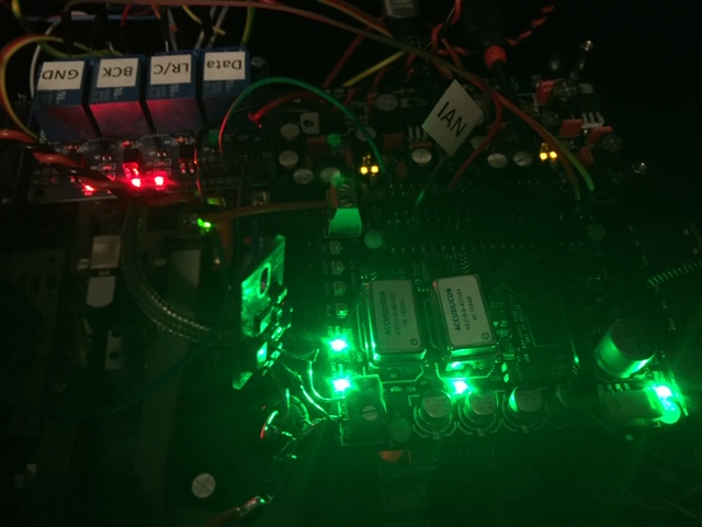

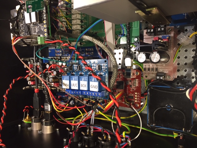

Correct, BUT ONLY for the first functional test. I built everything in my DAC yesterday evening (for testing again, not final assembly :D )
I power as follows (this will be final for now)
*DDDAC Board - Magic Power Supply (Audio Creative) 12V
*Wave IO - DDDAC 5V
*PI3 + FiFo (the stacked / non-isolated part) and the Relais Board - 5V SMPS
*FiFo - Isolated Clock Part - LDOVR 3,3 Volt through RC coming from Magic 12V
*Arduino Control Board - Small LM317 PS 12V
see the pics (Christmas is over, but it lightens up as a Christmastree :p )
Will do real listening tests later this week
Just to be sure I get this right:
Magic 12 V PSU --> DDDAC board --> LDOVR on DDDAC board 5V* --> RC filter (drops to 3.3V output) --> FiFo
(*) this is where normally the WaveIO isolated I2S part is connected
The RC filter between the DDDAC board and the FiFo might be nice because it decouples the regulator from the FiFo, so the "imperfect" load response of the regulator is "hidden" behind the RC filter, and the load response is controlled to a large extent by the C of the RC filter.
