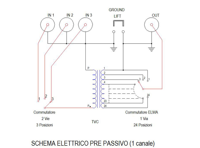

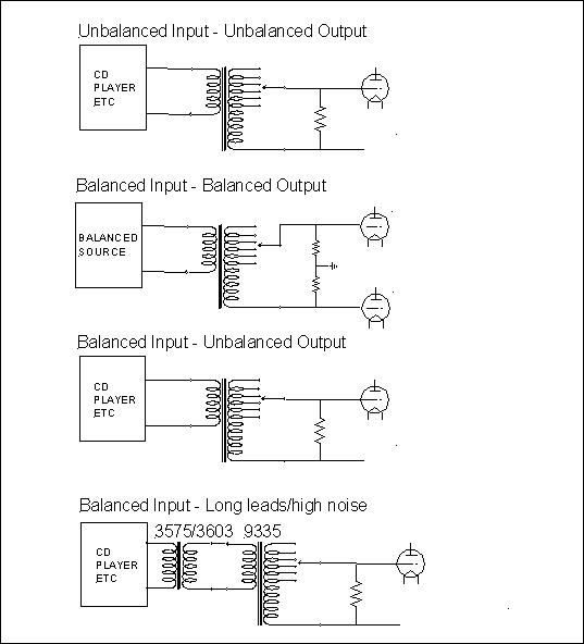

Welcome to the club!
I'd suggest you add a transformer volume control (TVC) somewhere to the top of your list. You need a volume control anyway, and you'll want to move from the SE/capacitor output to a balanced/transformer out at some point. A suitable TVC will do both. I am running both my DDDACs through a TVC as their output transformers, and they are connected directly into the power amps without the need for a pre-amp. Avoiding the usual (lossy!) volume pots and pre-amplifiers was a real eye opener to me!
The Sowter 9335 are good TVCs and have been tried and tested with the DDDAC a few times now.
