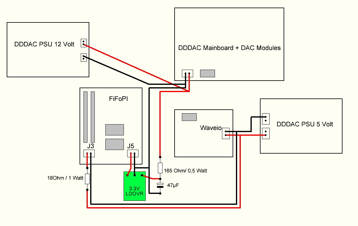

However, I am getting confused about the PSUs. Could someone provide a drawing showing the boards (WaveIO, IAN, DDDAC), the PSUs (12 V, 5 V, 3.3 V), and the connections of the PSUs to the boards?
sure 😎
you are right, a picture tells more than 1000 words 😛
Still need to supply 5v to the waveio isolator of course
of course, and this is (may be not so clear) done through the J1 connector flatcable at the bottom at the FiFoPi.

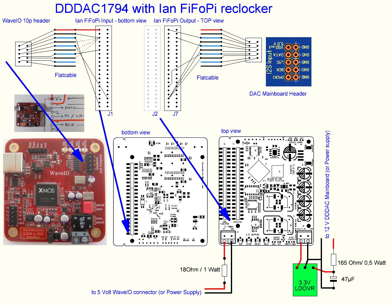

here is the scheme…. It is always good to document - One year later and you have clue anymore what you actually did 😀

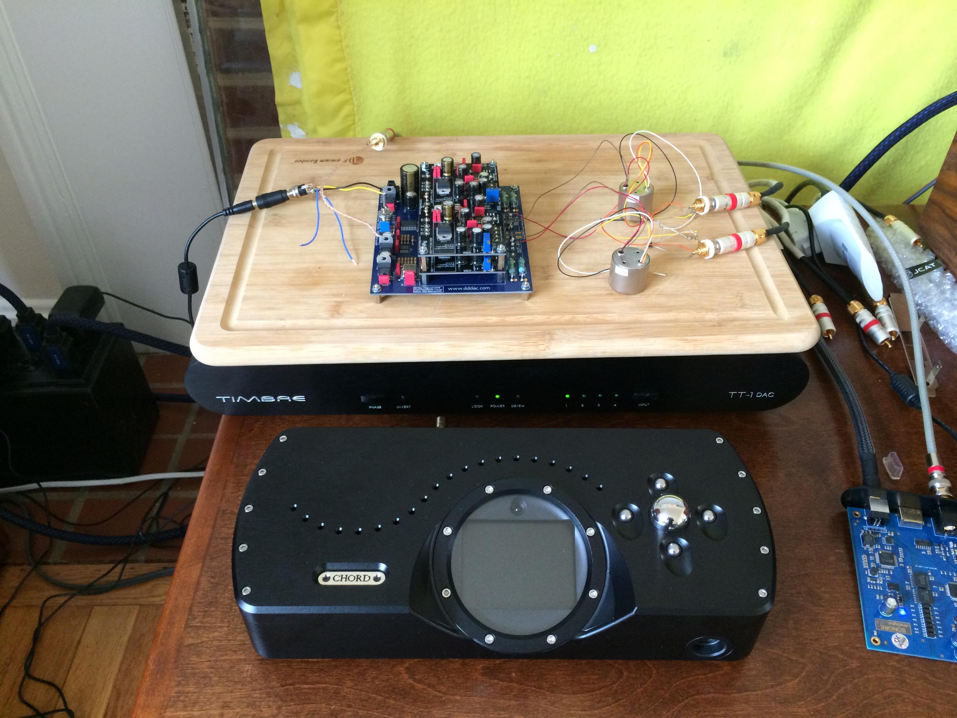

Hey everyone. I'm relatively new to the DDDAC 1794 world and have been listening, learning the circuit, and reading the previous 700+ forum pages for the past few months. I've been thrilled with the sound.
So, I'll play along. Here's a pic of my Chord DAVE (retail 10,000 EUR or something) next to a 2-deck DDDAC built by Dick/AudioCreative.
I use an inexpensive iFi iPower 12v switching power supply, the S/PDIF input, and the stock Mundorf output capacitors. As basic as it gets.
Comparison
The DAVE separates voices/instruments a bit better and gives a slightly deeper soundstage. DAVE has a built-in digital volume control -- with a remote -- that offers a nice bit of convenience. It also seems to improve less with a high-quality USB cable than anything else I've heard. My current SPDIF source, a Sonore ultraRendu, got far, far better when I added a Danacable TruStream USB cable (about 600 USD/540 EUR). Gobsmackingly better, actually. The DAVE got somewhat better with this cable but it was an incremental improvement at best. Its USB input is very impressive in this regard.
All great attributes.
Unfortunately, for my tastes, the DAVE sounds so much less like music than DDDAC. The "natural" timbre the DAVE is known for was a disappointment in my system. I have played in many bands and the DDDAC is the first DAC I've owned that gives me the instrument texture, weight, and detail I expect and recognize. And it gives you all this without sacrificing the acoustic space and recording hall information that is equally important to me. Cellos have all the resonance, full body, and biting timbre that makes them great. Through the DAVE they sounded thin and utterly disengaging. In general, all instruments through the DDDAC sounded much more palpable and convincing.
DDDAC has a particular strength at eliminating all treble fatigue without blunting the music. In addition to classical, jazz, and acoustic blues, I listen to pop punk, EDM, and 90s alternative rock. I have never heard those electric genres sound so good and non-fatiguing in my life.
Finally, DDDAC has a smile factor that I can't quite put my finger on. There is just something very right about it. I think it's the sonic weight -- it gives you a physical sensation in the room that has nothing to do with the usual audiophile/hi-fi attributes.
DDDAC sounds perfect played directly into my SET tube amp. I control volume digitally using JRiver Media Center. (My server is an Intel NUC i7 with Apacer industrial RAM running Windows Server 2019 in core mode, Audiophile Optimizer 3.0, Fidelizer, and Minority Clean.)
I tried the DAVE via SPDIF and USB, with a preamp and direct to my amp, with my digital volume control and its own internal volume. DAVE is known to sound quite a bit better with its M Scaler upsampler, which I have not heard. But I don't think any amount of upsampling will change the DAC's fundamental character. I don't know, and probably never will. I listened through speakers exclusively.
