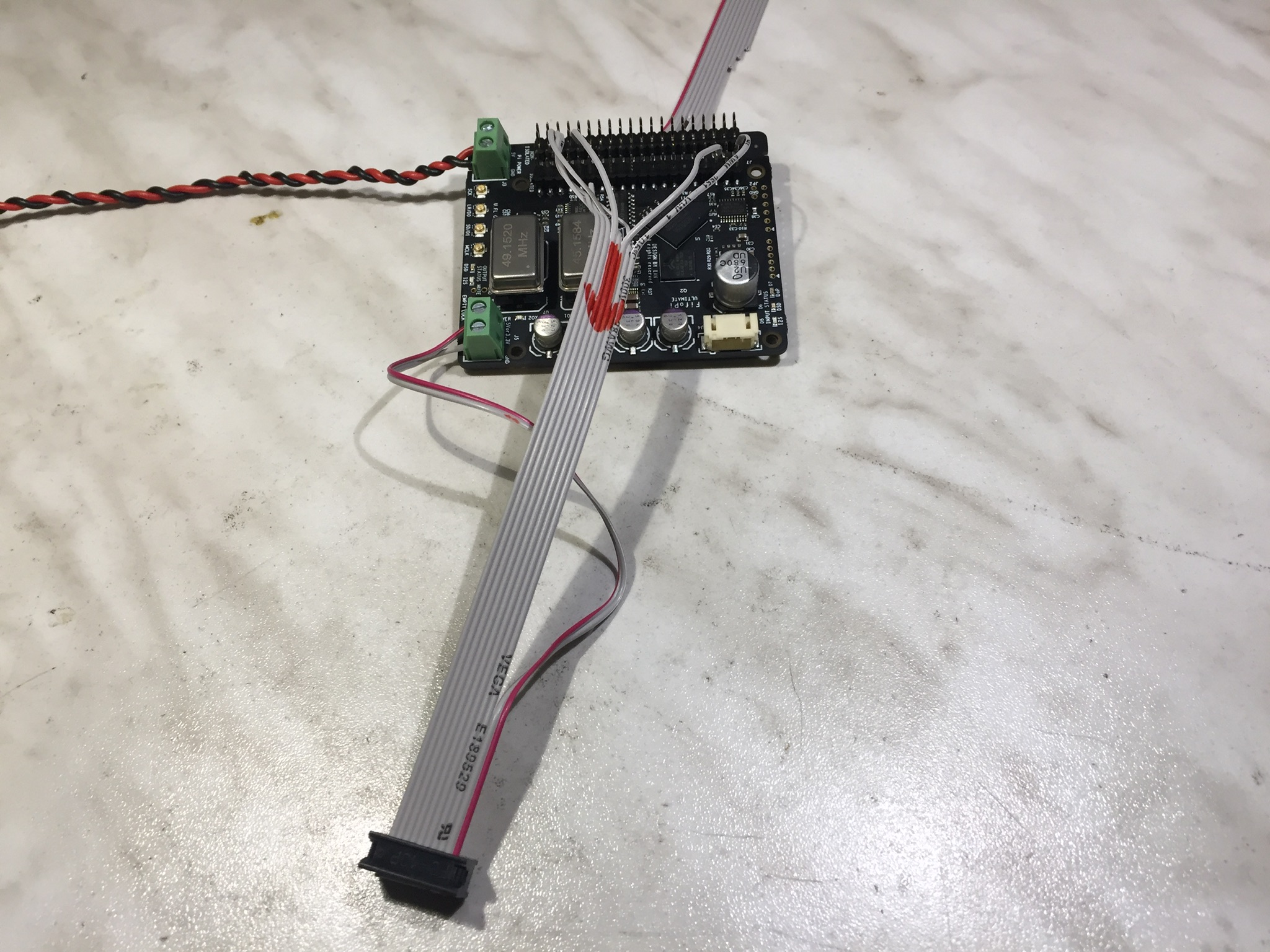

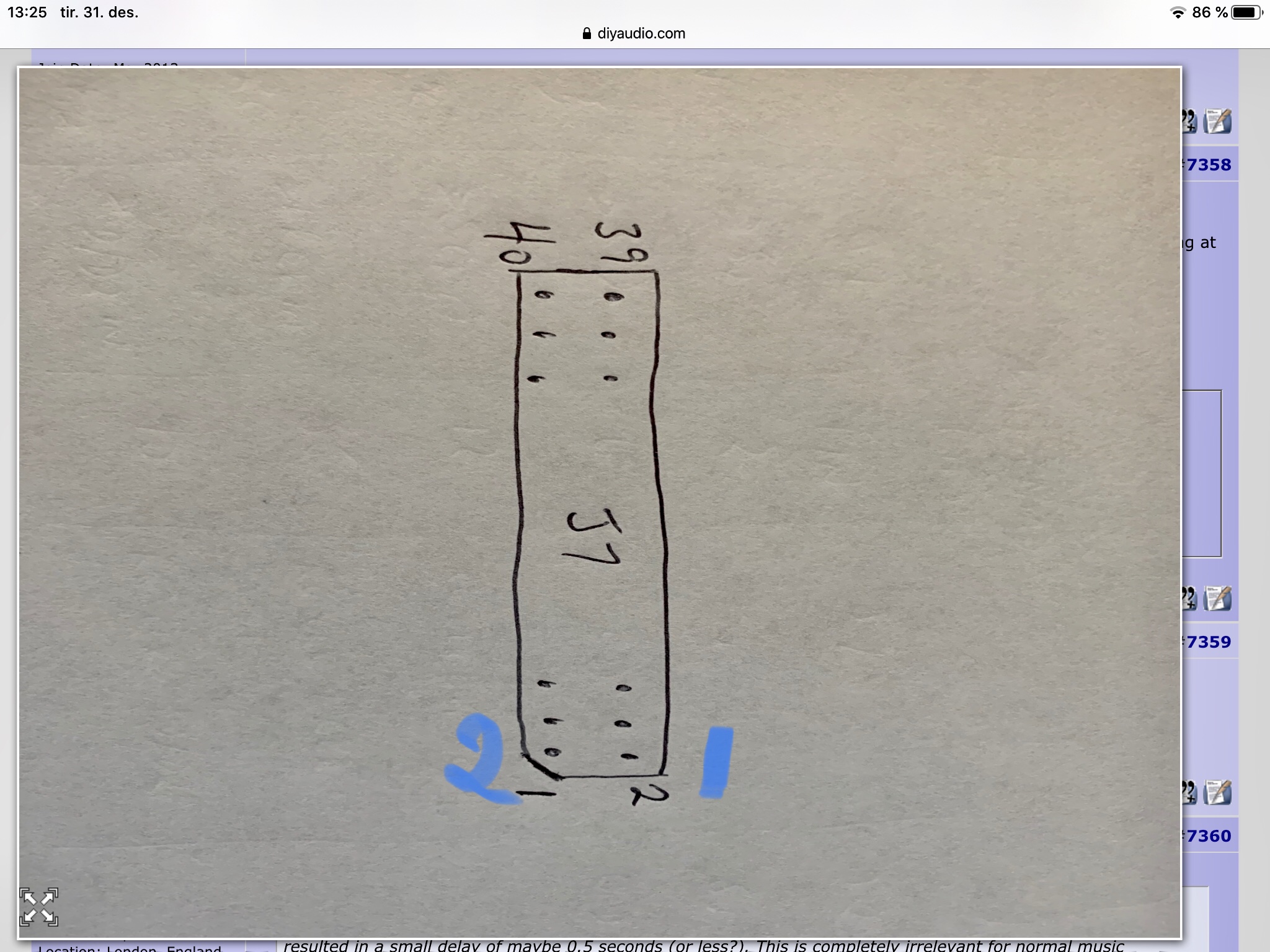

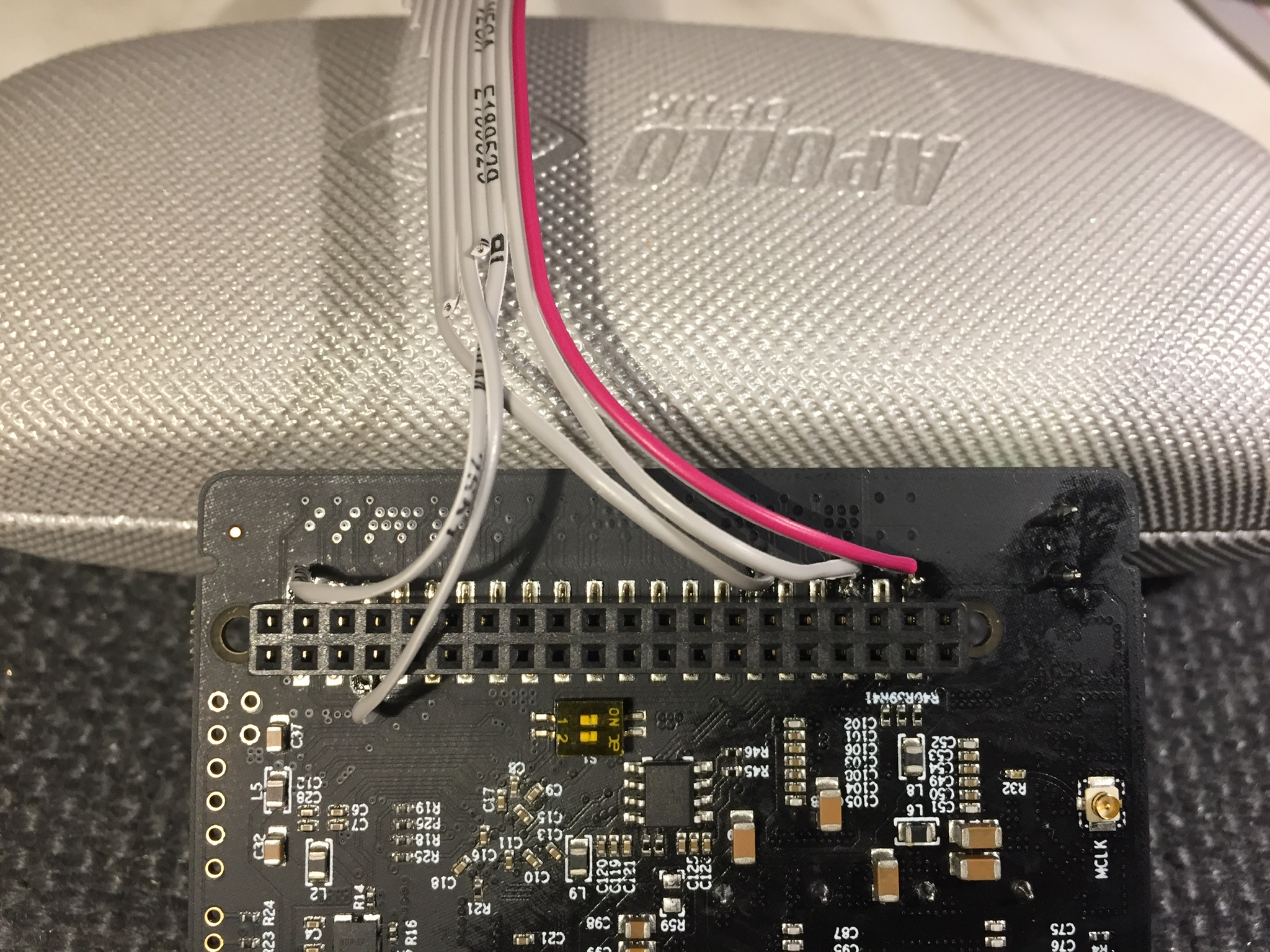

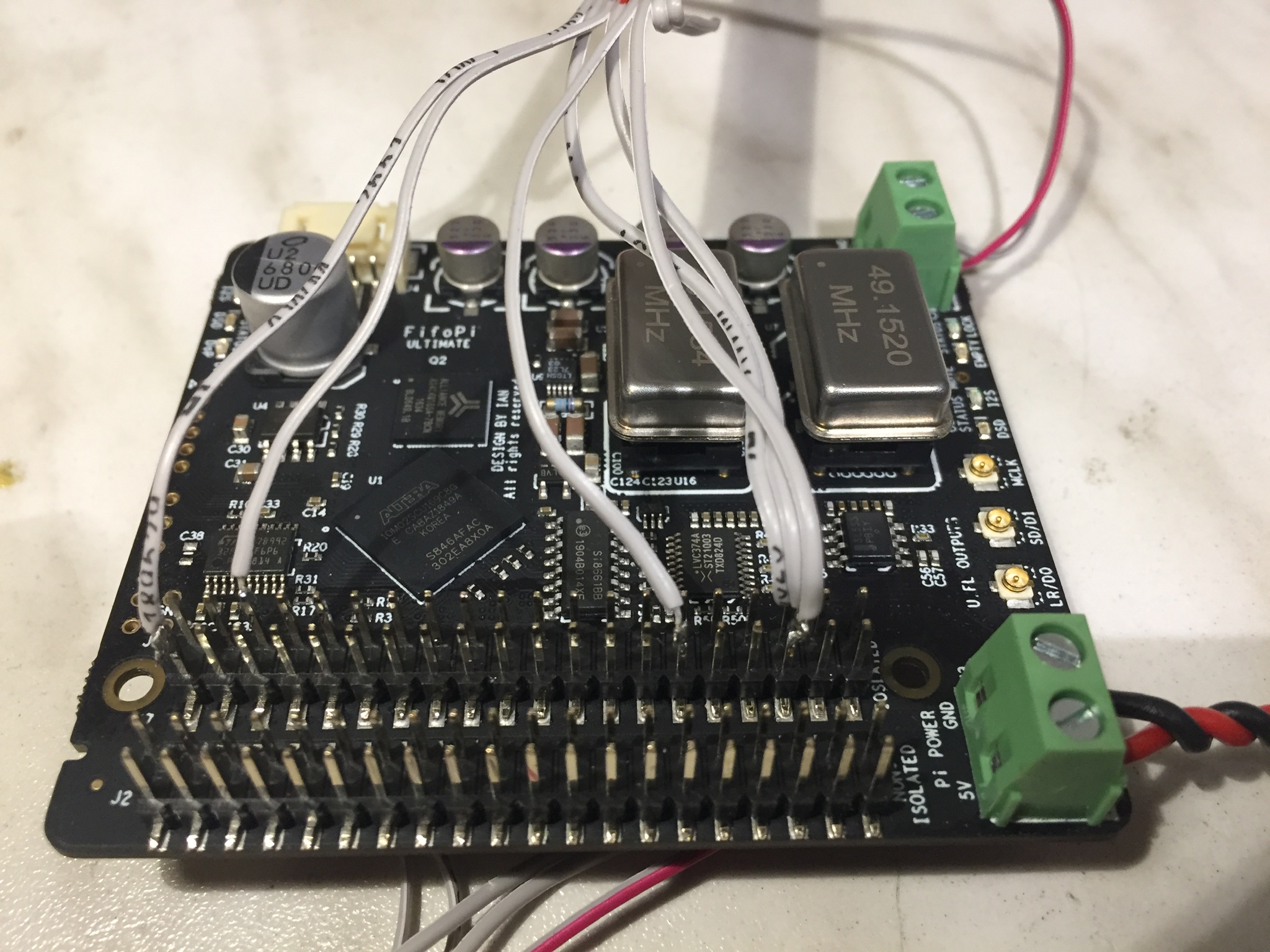

I see that smooth dancer only connects power to J3, this is one reason why Doede....needs investigating 🙂
I think you may have seen an old picture Simon. If you look closer you will see that there is two wires from dddac mainboard , 5v and gnd, which goes to pin 2 and 6 on the 40 pin J7.
I ended up with two 5v psu’s. One for J5 on fifo, and the other for waveio and J3 on fifo. If you do it like Doede did it, you need only one psu for the isolated side, and that’s the one from i2s output on mainboard to J5 on fifo. Your dddac 5v psu take care of waveio and J3. BUT, if you run into trouble as Doede did, you must copy what he did with the 18 ohm resistor before J3.
Since I have already built and everything play’s great, I will leave it as it is.
I recommend to do it like Doede did, Simon.
Yes I see those wires now and all makes sense now. I will make mine like Doede has

I see on your pictures that you have 6 wires on J7. Do you have one gnd wire for each i2s signal wire ? I’m asking because I only use one gnd wire for the i2s signal wires (it work’s fine with one gnd wire). But I don’t see a gnd wire for i2s on J1, only wires from dddac mainboard for i2s signals, + 5v and gnd.
I’m asking because I’m still learning. 🙂
