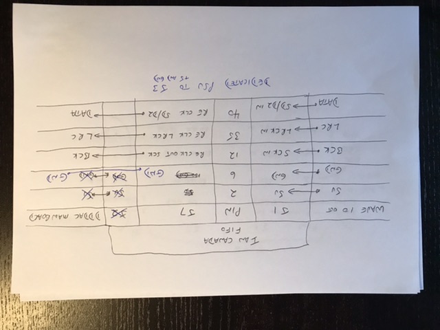

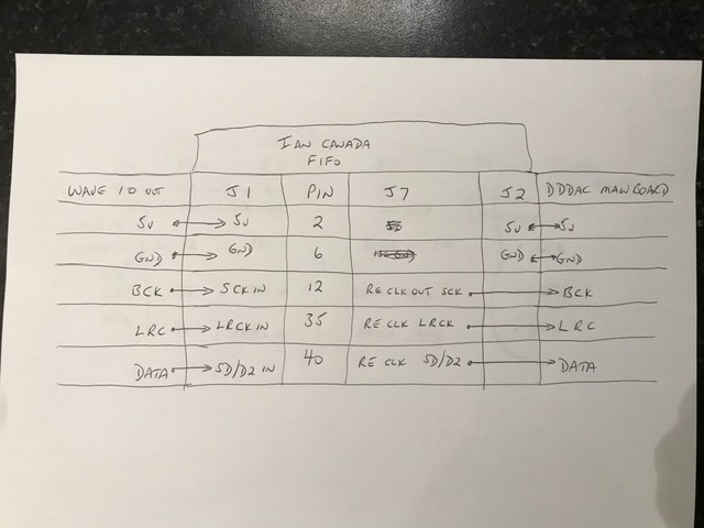

Would you mind confirming I have this all connected correctly in the attached diagram? Thanks 🙂

@Simon.
Your diagram is correct if you need to take 5v from dddac mainboard to waveios i2s isolated side. . If you have a dedicated psu hooked up to J3 header on ians fifo, you can skip 5v and gnd on pin 2-6 on J2.
From J7 to mainboards i2s, you only connect pin 12,35 and 40 + one of the many gnd pins, f,ex 6 or 39,,,,

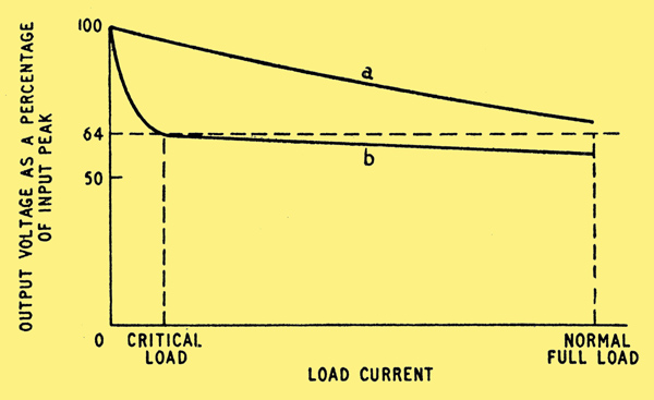

Choke input with a high dcr value big choke will force you to think about how things can be done safely
First there is the use of a bleeder resistor that will stop the dc voltage at the first capacitor going up to the same value as if there is no choke at all.
Of course if there are 4 boards with each tent shunts and you use the BIG choke i am using there will be a big voltage drop on the choke so i am still using the 7810 regulators.
Guido Tent told me a big power zenerdiode can stop the voltage rise just in case there is no load present at all.
Because the zener will only act if there is something wrong it will not have negative effects when everything is working as it should.
I remember some years ago when i was just reading this thread and waiting for the boards with the shunts on board waiting to appear there were some people busy with chokes. Power supply changes are not that difficult and the results can be great compared to the money invested.
What i like about chokes is that if properly used they will work and have infinite lifetime.

@Simon.
Thanks 🙂
I did think the 5v was not needed on J2 but your post number 7309 stated this but you probably was not aware I will use a dedicated supply as I have a spare DDDAC 5v PSU I can use.
So I have updated the attached which I feel is now correct, agreed?

I think it is important to separate 5v from waveio and 5v out from mainboard. If not, waveio will be on the same side of the fence as fifo’s isolated side. I only connect the i2s lines +gnd from J7 - i2s mainboard. J7 have dedicated 5v psu.
Doede, can you confirm if my thoughts about 5v between waveio and 5v on mainboard are correct ? As I see it, only i2s lines + gnd, from J7, shall be connected to mainboard, and fifo powered by a clean psu (J-5 header).
