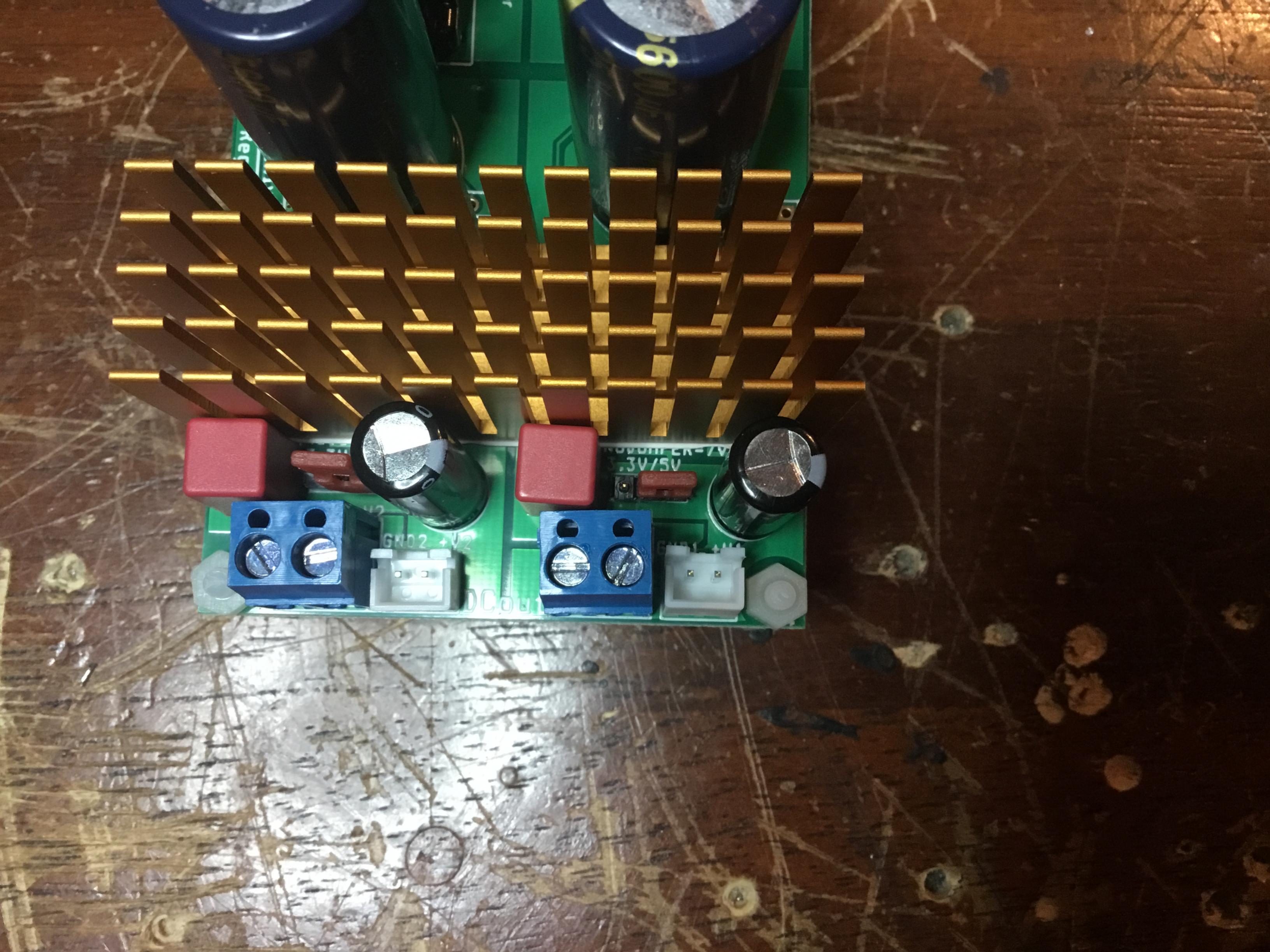

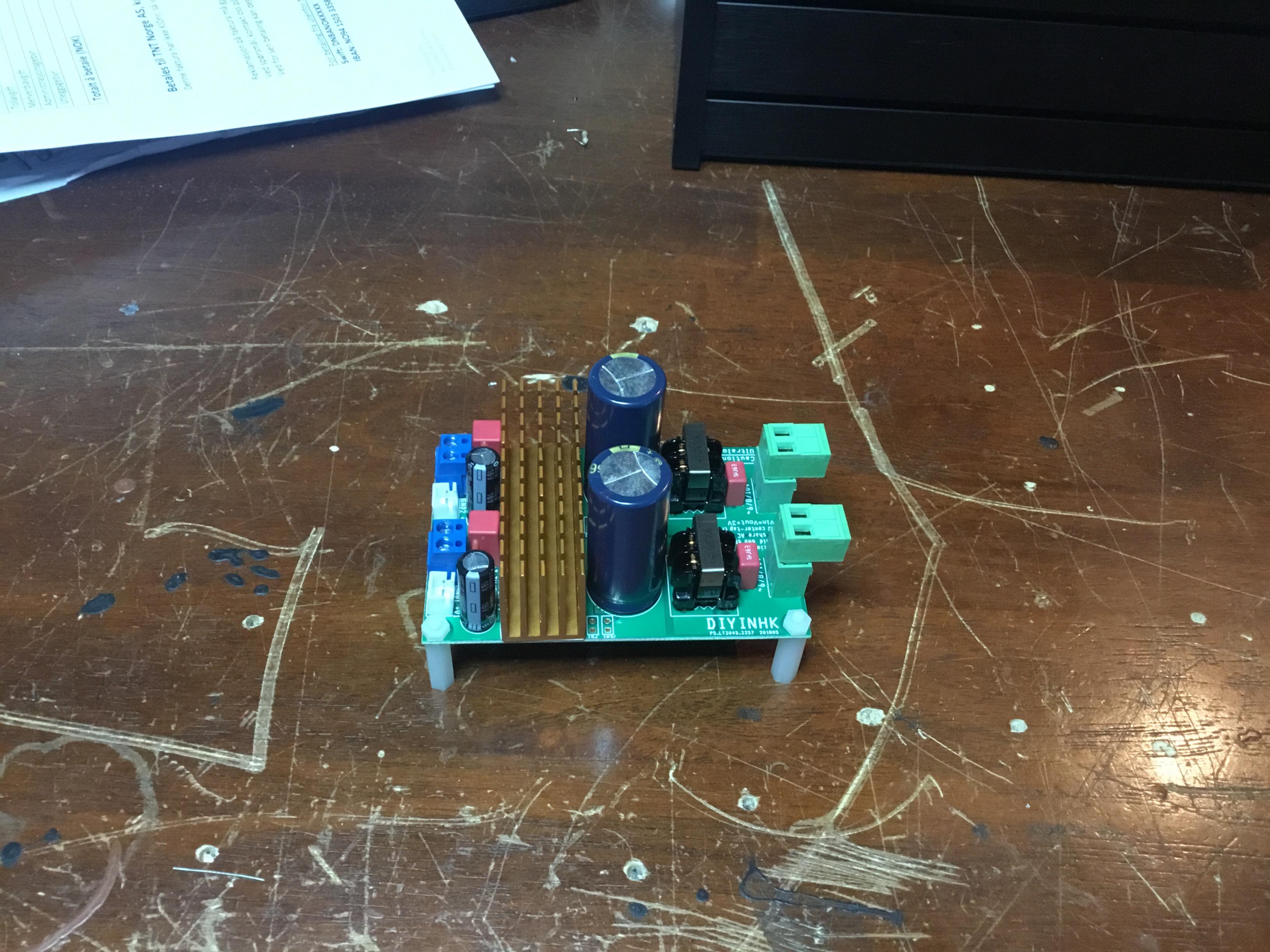

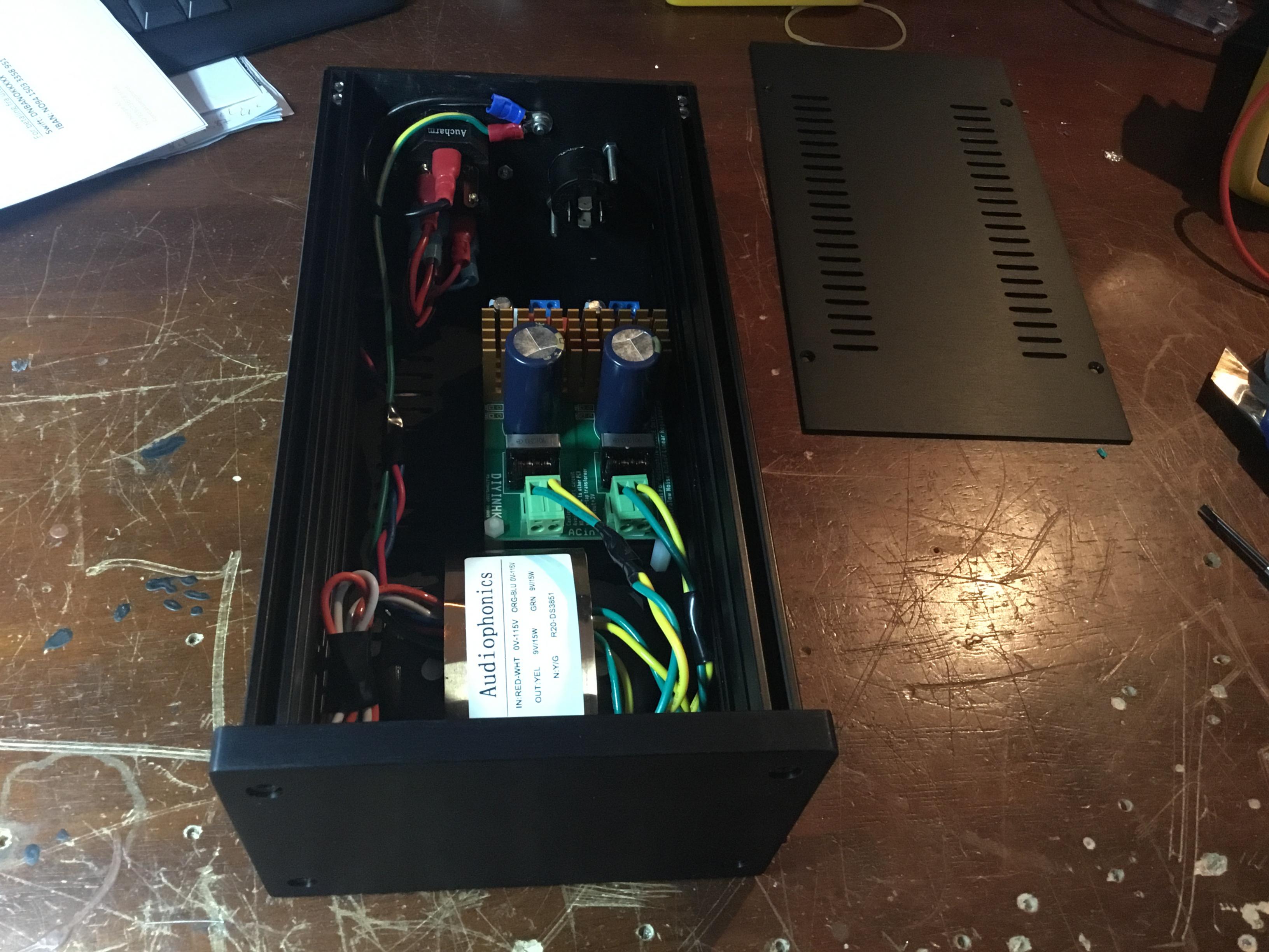

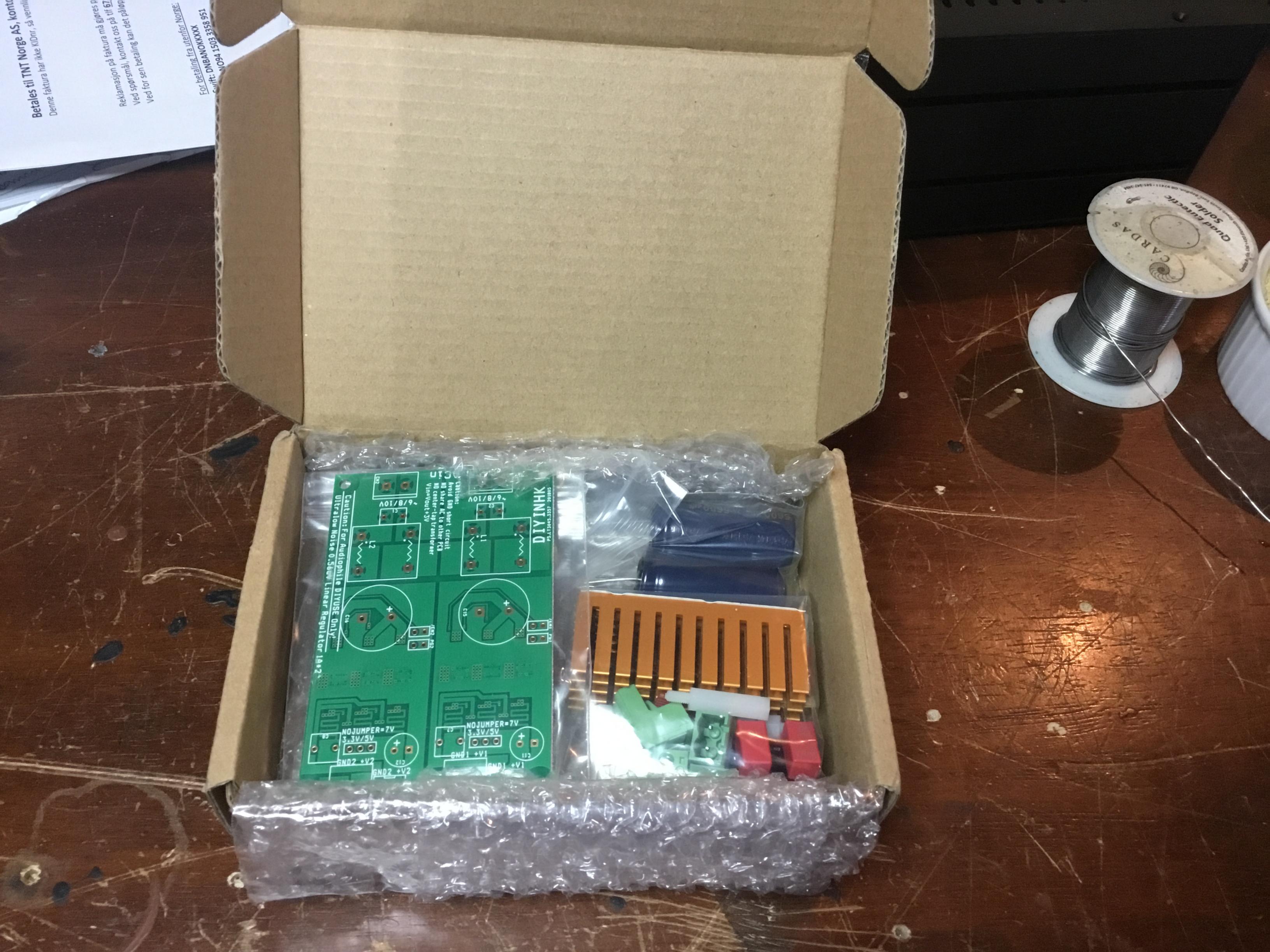

Some relaxing soldering/building today. After Ian’s fifo arrived I needed a small psu. Order placed a week ago with Audiophonics. Arrived yesterday, and 5vdc psu from dyink arrived today.

Perhaps I get a new case for my 5v psu too, as the case I had at hand was bit to small to fit the choke 😀

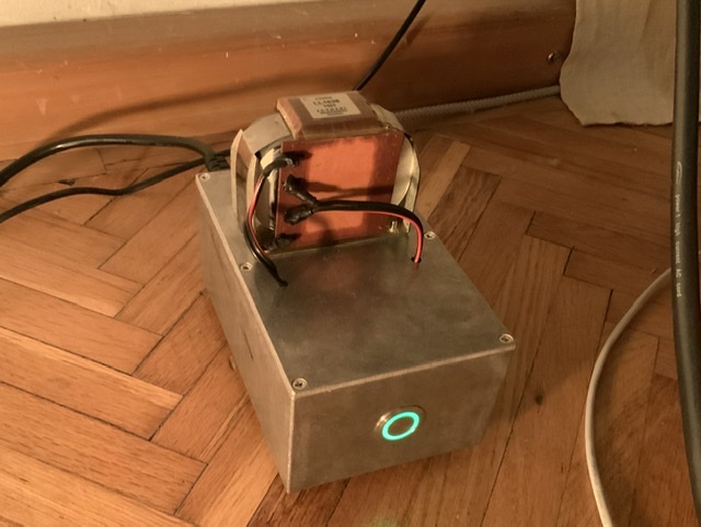

BTW. Where did you get the 300va r-Core for your 12v psu? I’m unable to find a big r-Core and it seems selectronics doesn’t sell directly anymore (or I can’t find it on the site). And the biggest r-Core on audiophonics is 60va and I think it would be nice to go bigger. Or doesn’t that matter too much?
It was not easy to find a big R-core, I bought it from Selectronic, but this is 4-5 years ago so you are probably right. Just buy a Toroidal. I would rather have a 2-300va Toroidal, than a 60va R-core. Theoretically 60va should be enough, but as always, practical experience has told me that a big trafo is nice. I see no point in too big, but around 2-300 va for 12vdc - 1A-5A.

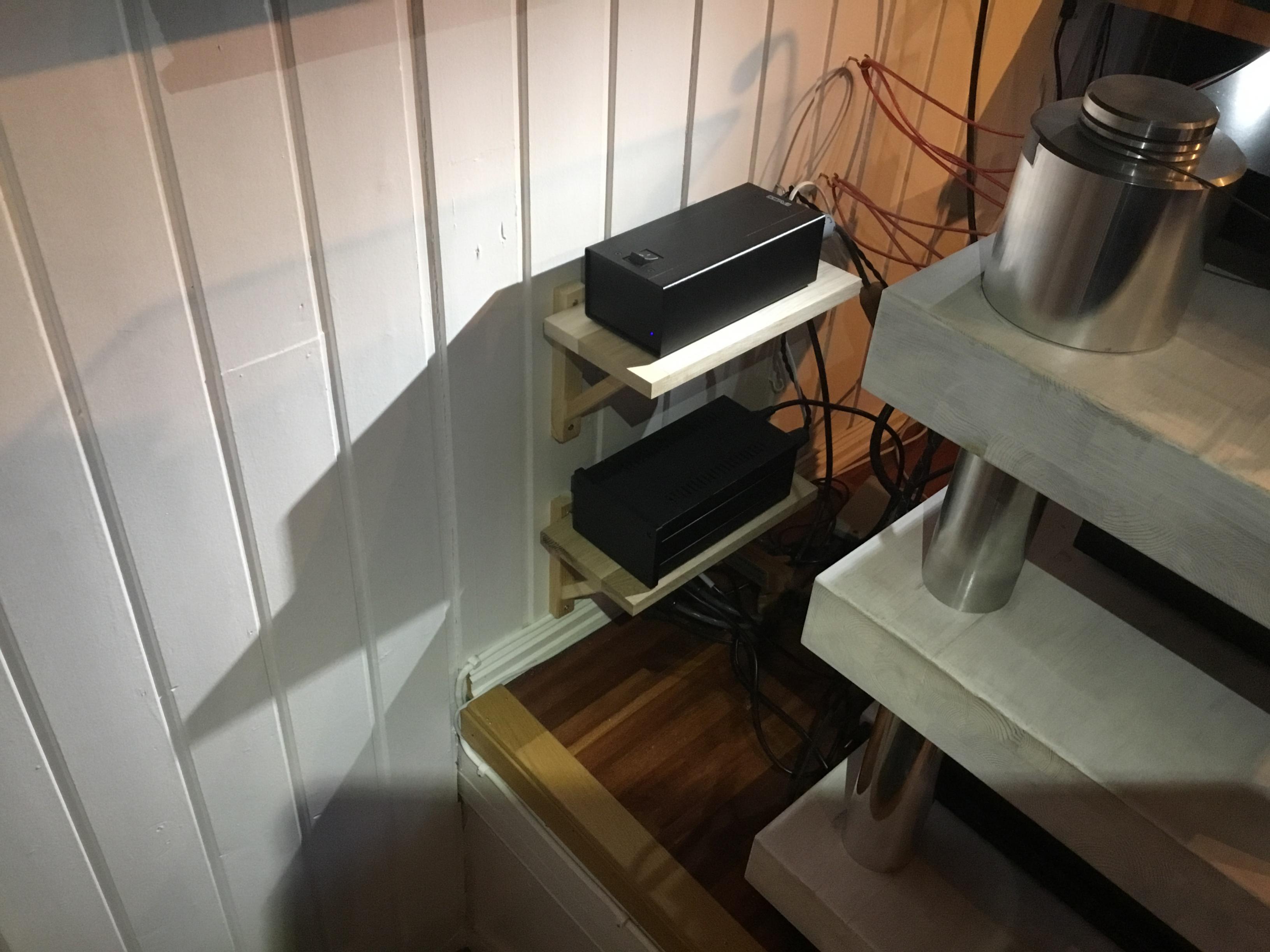

Hello,
Allready use the aurender with wave io with pimped power supply. My diy chassis is big enough to offer space for replacing the wave io with a bigger circuit but it seems not that sure that an improvement will be made. I will wait for Doede , smoothdancer or other Aurender users to share a light on this.
Like i wrote before a bigger ( more mH or even H choke) will give a bigger improvement than switching to a bigger transformer. Triad makes some nice so called split bobbin transformers that offer a bigger separation between powerline and circuit ( Rod Coleman tells us to use these for his direct heater supplies) t
THIS is understandable because the secundairy side is not on top of the primary side but next to it.
The right choke also offers the situation where power consumption is a steady current because the charging pulses to " supply the capacitors " with energy are gone.
So rearrange the money spend on the power supply put 75 % in the choke and 25 % in the transformer.
By the way Selectronic , the French company that sold R cores ( from India) went bankrupt some years ago.
Greetings, Eduard
