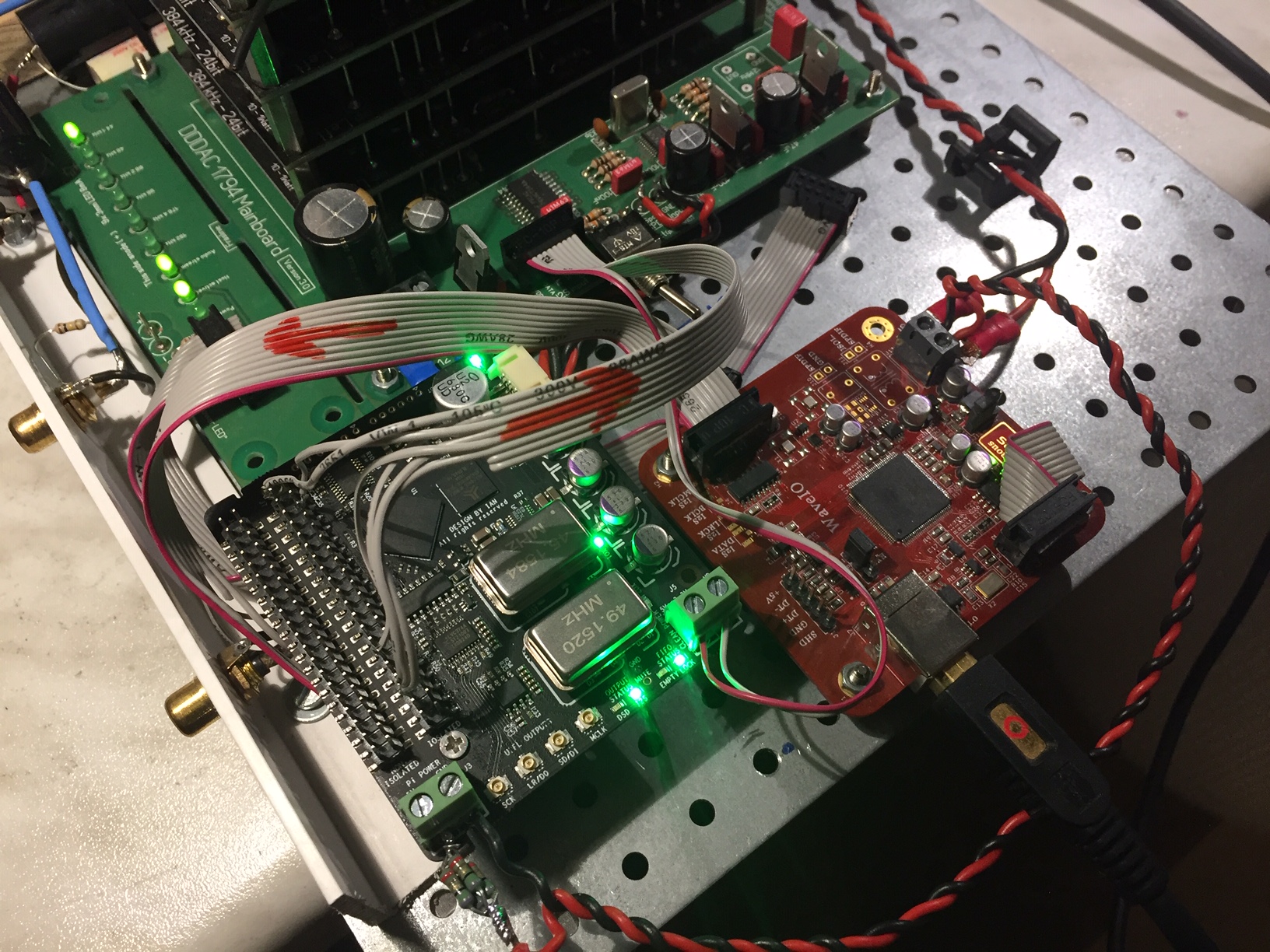

Ian FIFO problem - and.... solved
Need to share this right now... :wrench: :wrench: :wrench:
The Ian was NOT working till for 10 minutes ago. I was very frustrated yesterday evening as the FIFO status LED stayed red (empty buffer). I had to sleep a night over this - ask a few fellow DIY and even thought the board could be defective (already ordered a new one 😀 this one will stay for a RoPIeee server next to build 😛 )
today I had the smal lightbulb flash and tried with a lower voltage on J3, the connector for the power supply input for the not-isolated INPUT side of things and where all the controlling is happening. My idea was that the PI works with 3,3 V logic and maybe this was the issue, that the 5 Volt I am taking from the Waveio was too much and the 5V logic I2S signals were not working correctly. Well indeed...……
NOW it all works perfectly well between roughly 3 and 4 volt on J3 (J5 stays 5 volt from the mainboard at the isolated side to be 100% clear)
Now to avoid an extra 3,3 Volt power supply just for the controlling side of the Ian FIFO I still take the 5 Volt from the Waveio but with a 18 Ohm / 1 Watt resistor in series to arrive at 3,34 Volt at J3 (The current draw is pretty constant between 85mA and 90mA depending on FS 44.1 - 192kHz)
As this makes the earlier "recommendations" basically wrong, I wanted to post this ASAP... Listening tests I will do tomorrow 😎

Ian FiFo test rig dddac
here is a pic from my Ian FiFo test rig

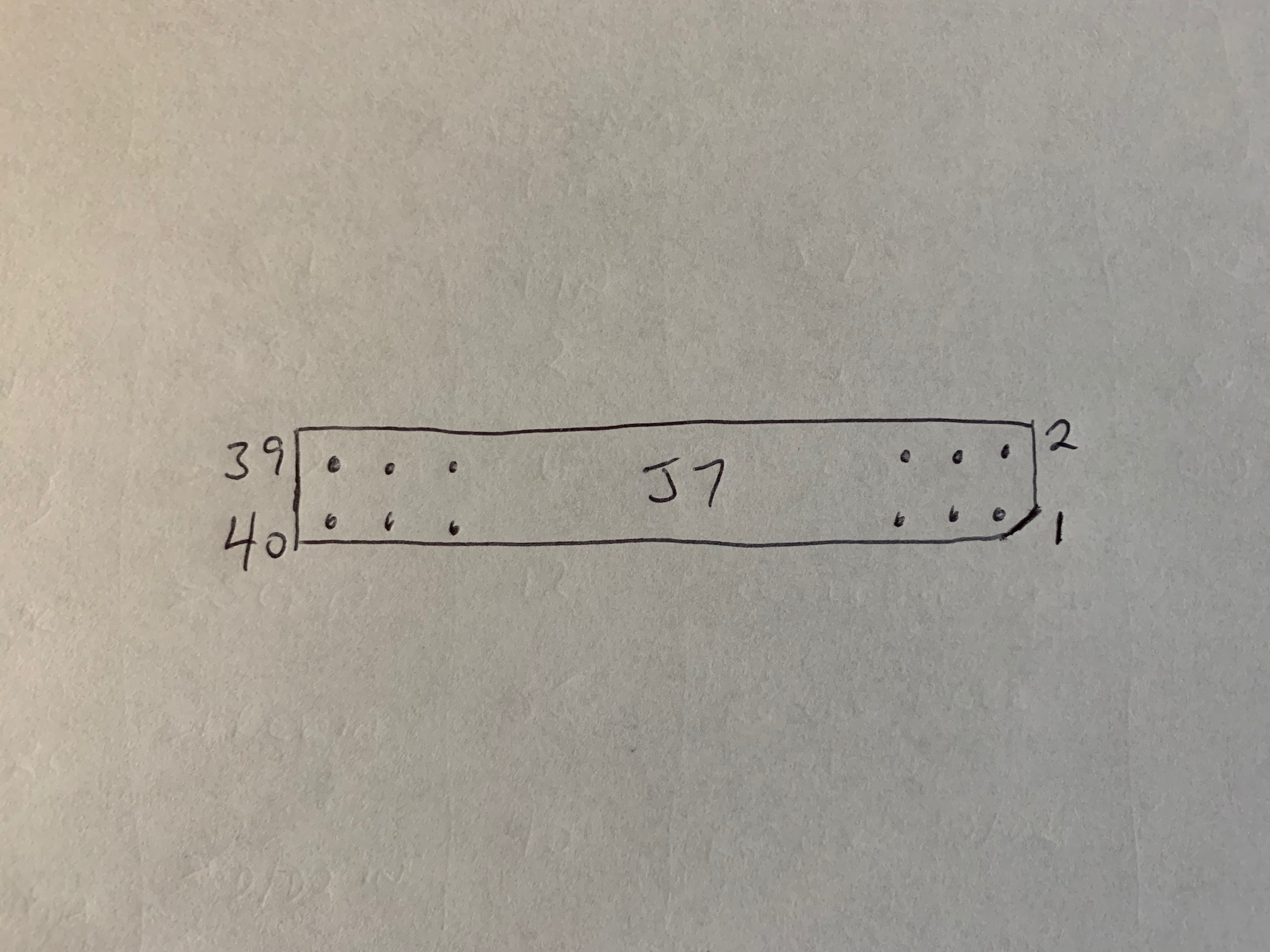

Me again 🙂
Ref the PIN numbers on the 40pin connectors for the IAN. I thought the numbers were as in my diagram but looking at peoples pictures I see a wire attatched to PIN 40 as expected but then counting back does not align, what am I missing...if anything and its just me?
Dont want to make mistakes
