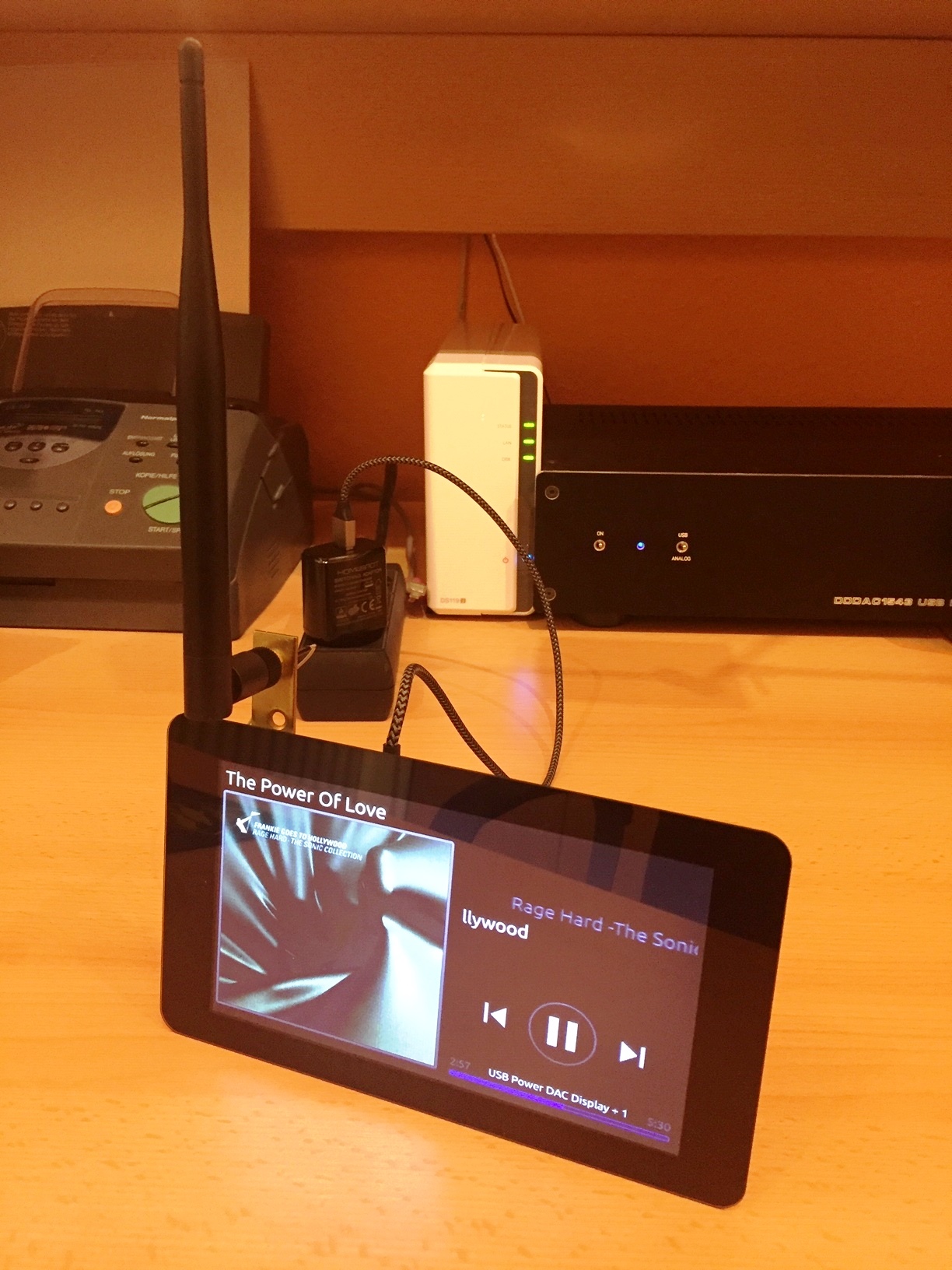

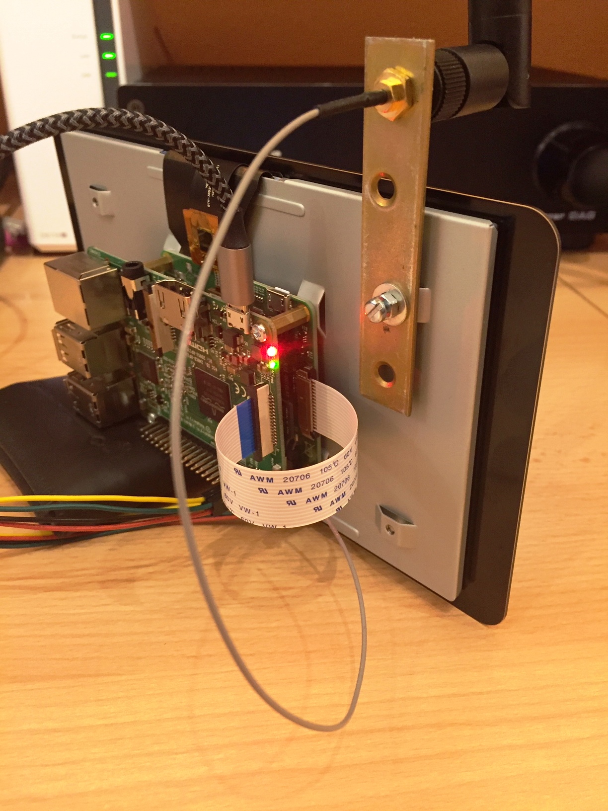

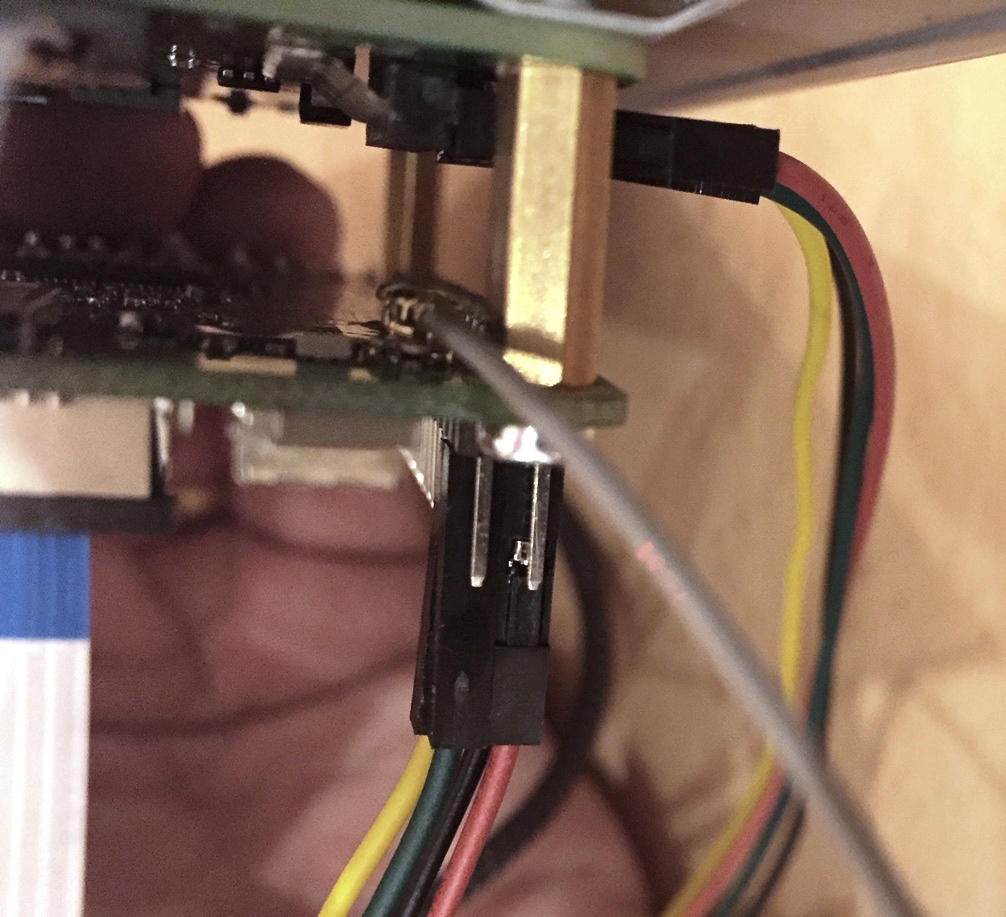

I spent a little time to prepare for WLAN streaming. The PI itself is totally useless as of the micro on board antenna. I read this nice story and actually mounted an UFL connector at the back of the PI and added a 10€ Ebay Antenna with the result that 10 meters from Router with walls and refrigerator in between I could stream display information + 192kHz track without problems. The PI already makes problems at a few meters away 🙄 Nice mod and no need for expensive Ethernet cables? Still need to compare of course….
link to UFL mod
easier mod without UFL, with some background
my pics:

Are those jumper wires from the RPi pin header going to the IAN FiFo? Wouldn't it be better to keep those I2S connections as short as possible by plugging the IAN board right onto the RPi?
watch closely… this is just the remote control with its own PI3. No FiFoPi attached. The jumpers are V+ and GND and the two serial control signals for the LCD screen. I uses this as a test with "Raspberry I2S" in ropieee to see if the 192kHz stream reaches the PI board. Normally the remote PI/Screen will only be configured with "no HAT"
So in my DAC, I will most probably and finally end up with two PI's …. One with FiFoPi & antenna (and yes, the FiFoPi is plugged on top of the PI ) and one with the touchscreen for basic control and a "now playing" kind of function
Ok, I see. I thought the RPi on the photo feeds the FiFo board.
Is that a little spoiler? Is this a hint saying that the RPi + IAN FiFo is the way to go in terms of sound quality? 😎
Can't you connect the IAN FiFo and the screen/display to the same RPi? Using two RPi computers for this seems complicated.
I have stopped worrying about displays at my HiFi devices. Roon, Volumio etc. do a very good job in telling me what's going on and in controlling the music over my smartphone or tablet in my seat (or in the kitchen or garage or ...). Since the whole music system has moved into the home computer network I really have no need for a display or controls on the DDDAC box anymore.
