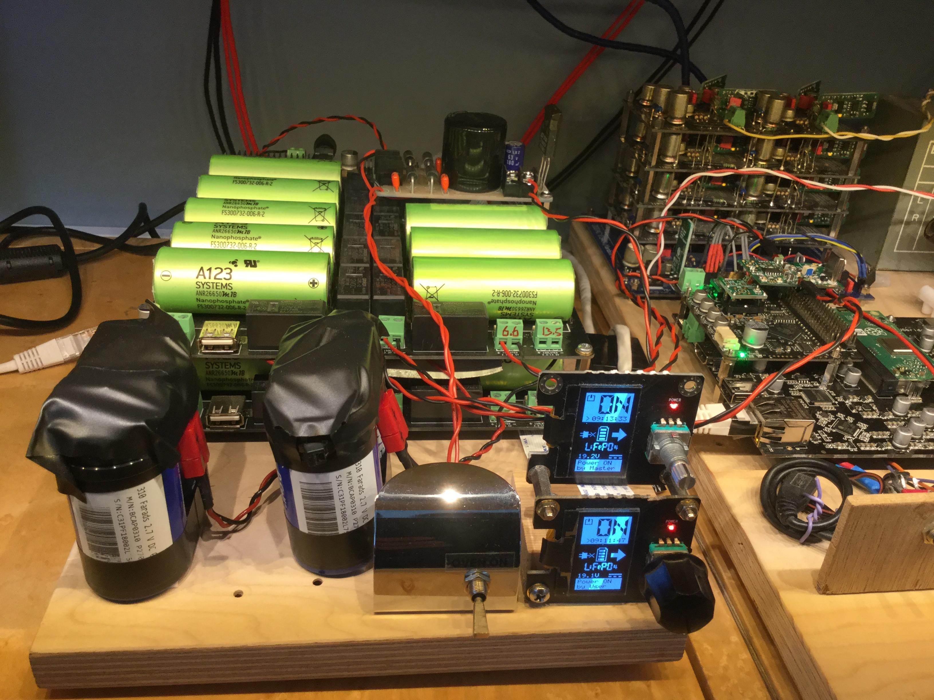

I saw this supply from Ian with some supercaps added. Of course these supercaps will give optimum results if they are as close as possible to the load. With some extra work that can be done. If some kid,cat or dog start pulling some wires they and the diy audio member will have some memorable experience. After testing put it in a sturdy enclosure!

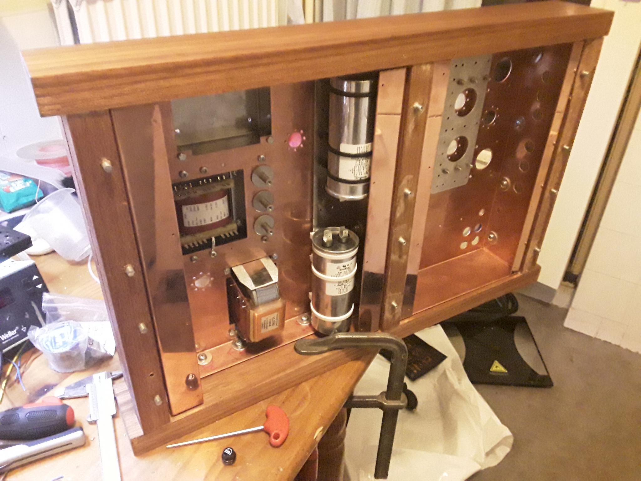

Because i can make my own chassis at work that is easily said but i honestly think that wood is for furniture and birds not for electronic devices.
Wood and red copper is a nice combination as you can see in the picture . But all the electronic parts are mounted on the copper. There is one part for power supply and one part for the pre amp itself. The two copper plates are bend on all four sides and the wood it just there because it can handle some abuse and polished copper so easily damaged. The wood just joins the two copper plates and prevent stains on the copper during handling.
Greetings, Eduard

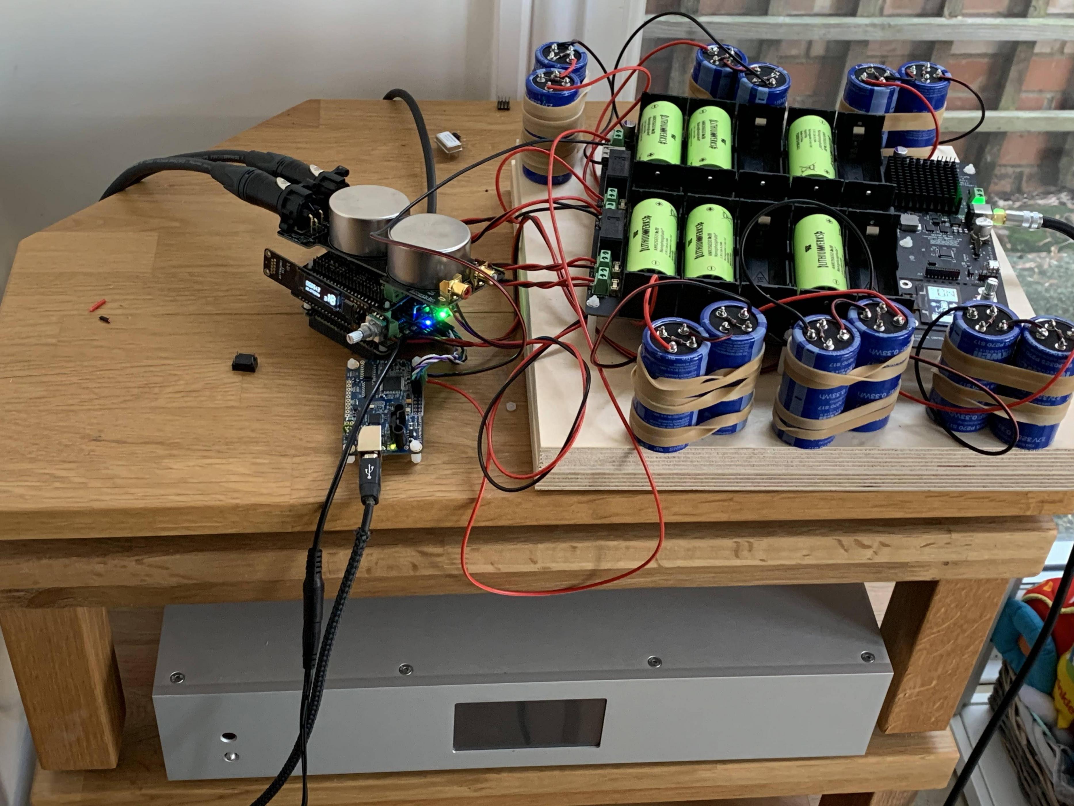

I did some nice improvements on the streamer side that are worthwile to mention:
-I am using an Allo usbridge sig instead of the rpi (less noise) it can run all rpi software, I use moode currently.
-fifopi on battery supply
-Andrea Mori clock unit on battery supply (big improvement on all audible aspects!)
-battery supply with added supercaps (this makes the noise floor of the already quiet battery even lower, this is clearly audible)
I have been using the rpi as a streamer for a long while, first with the Allo isolator and kali reclocker. Changing to the fifopi made an improvement and changing to the usbridge sig made another significant improvement. This stuff is highly reccommended for all DDDAC users, you will not be dissapointed!
The improvements on the streamer part did make a big improvement in the overall sound of my set, there is certainly a lot to gain here.
