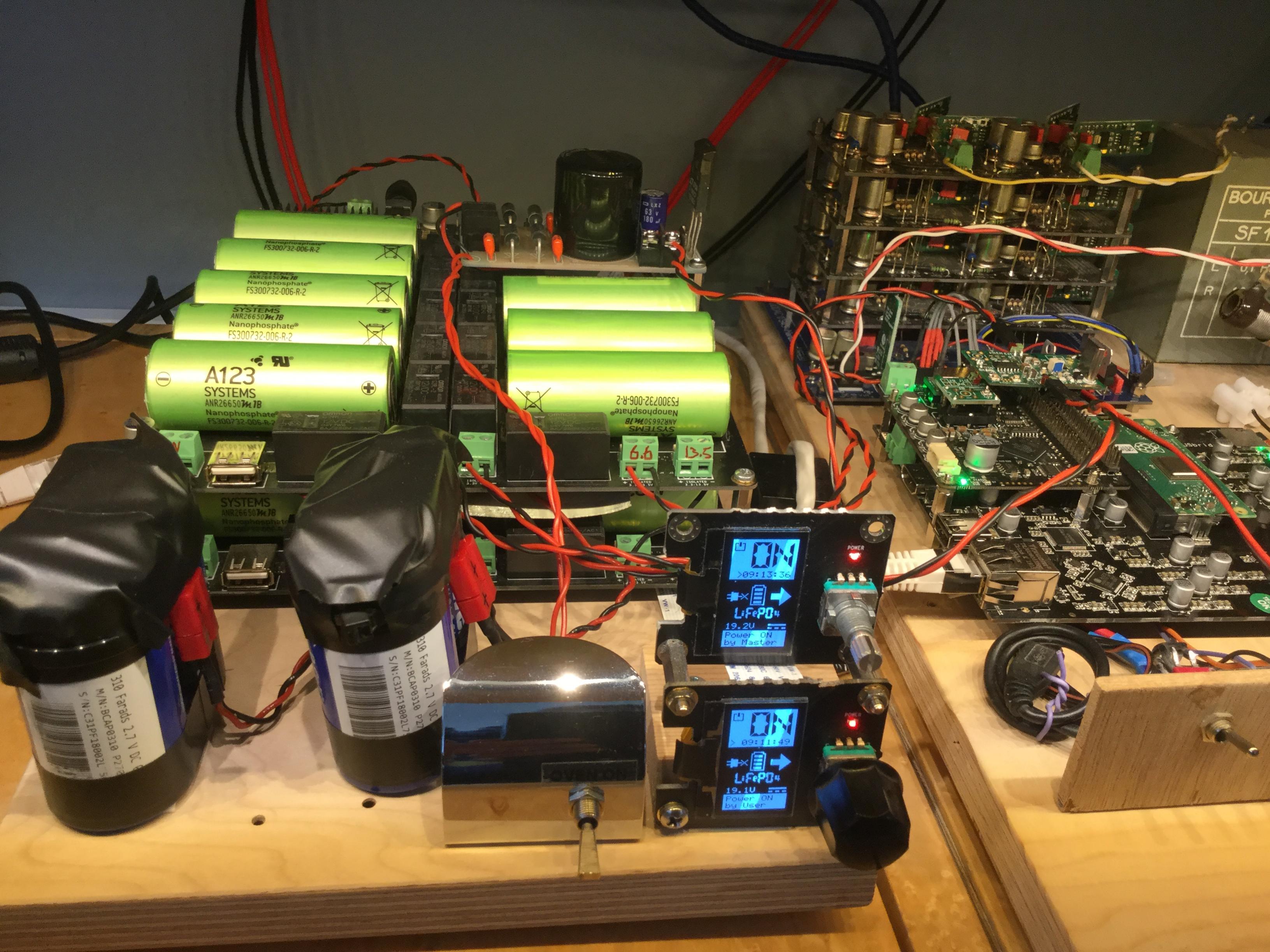

All clocks were used on an Ian Canada fifopi, battery/supercap powered and bypassed ldo’s, mounted on an Allo Usbridge Sig, feeding my, tuned to the max, 4 deck dddac.

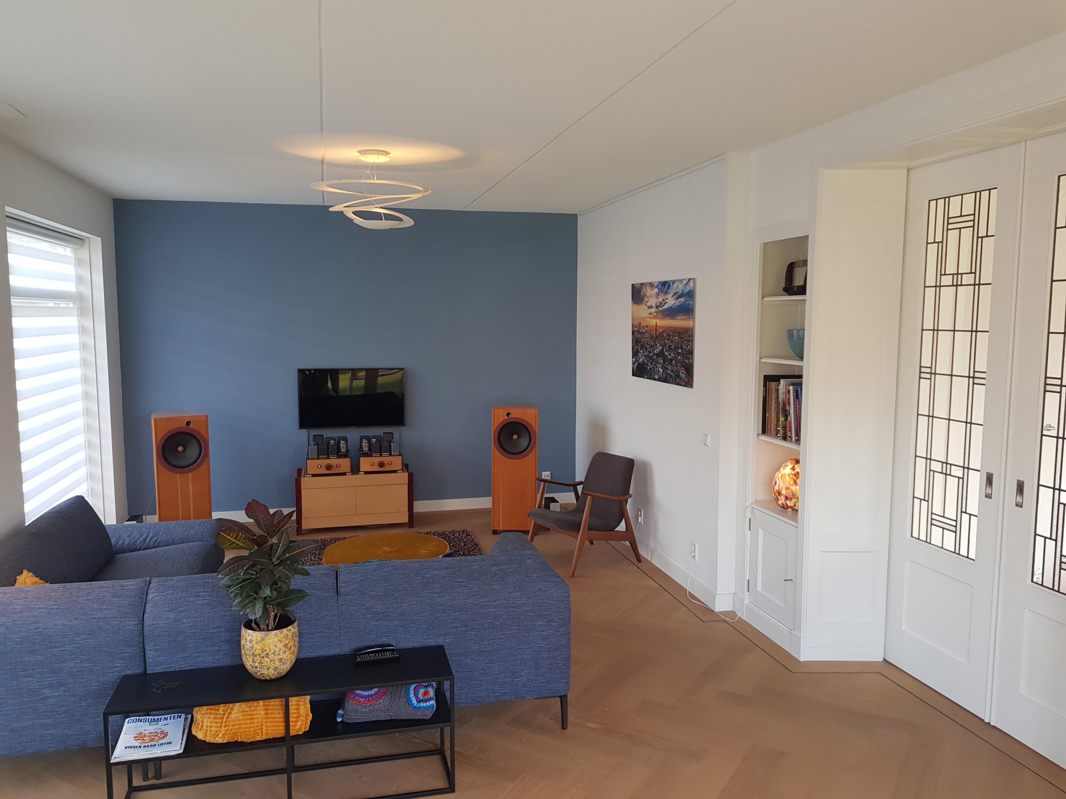

My set is all self build with quality components. Does this mean megabucks setup? I do not think so, there are many much more expensive amplifiers and loudspeakers out there. But I do dare to challange anyone with such a megabucks setup to compare with my humble diy stuff :D
The amps are build from directly heated triode tubes, interstage coupled. The loudspeakers are an open baffle system with a very nice field coil unit from EMS France, almost full range, with a Phy tweeter on top running from 15khz. This is a VERY revealing system. It resides in a living room without special room treatment.
But that does not mean that a better clock on less revealing systems are not a welcome improvement. After all your system is a strong as your weakest link.
