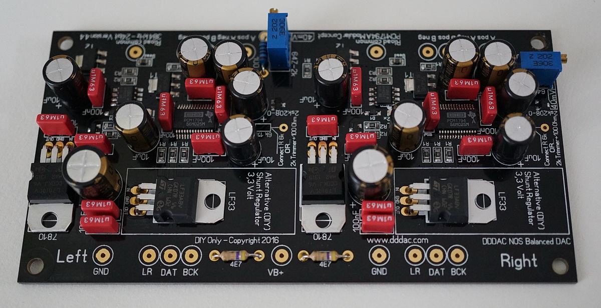

I just updated my website with a short reference to the new dac board with the Tentlabs Shunt and pin20 Current Source, so you can download the technical documents if you like.
or directly here ---> Click here for link to document
Audio creative is updating their web site as the kits are available now... Click to go to web shop
have fun :cool:

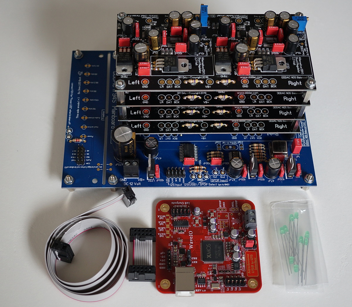

Just did order a 4 board dddac kit to be used with my rega cdplayer. So oldfashioned i know!
Now i will need to find some time to construct it. Hope it will come with an updated manual but it surely will be easier than modifying the old boards with Tent shunts.
I honestly believe that the incorporated shunts will be more reliable than the diy solutions seen so far and adding the other shunts to these boards ( but there will be mods that will offer a better return on investment if we should believe the almighty Doede) will be easier because there is the right space available.
Will ask Doede soon for a pair of output transformers.
Greetings, Eduard
Great!
I just have a question, the 7810 regulator is mandatory?
I'm powering my (2) dddac boards with low noise regulated 12V, one for left side, one for right.
Tent shunts can accept 12v directly?
Thanks for your work, ones again! :cheers:

Of course that will work as well.... Guido Tent recommended the Pre-Regulation though... you can easily try it out for your self of course?
Can you reduce the 12 to 10 Volt? That would be even better for heat dissipation in the transistors
Thanks Doede,
I should be able to reduce to 10V, as I said, it is already regulated, but will power the right (or left) side of two boards at the same time, digital side included.

I understand the 7810 is Reg the 12 to 10v to improve the dissipation in the tent shunt. I thought the whole idea of the shunt was to stop having regulation for improved low noose supply so by putting the 7810 there it is not helping with that.
What do I not understand please as I am missing something here? Thank you
